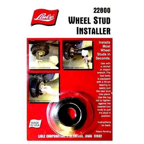

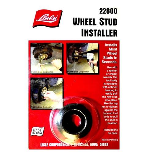

Cost like $30 at the parts house. This thing is smooth as butter installing wheel studs
I usually use a steel spacer from McMaster and a couple of washers for extra bearing area. I use a plain nut because it's disposable (chew it up with an impact and throw it away), and flat (no conical seat needed on the spacer), and open-ended, so there's no depth limits like a closed-end lug nut. It's the same principle as the stud installation/removal kits, they have a bunch of different spacers to get the length in the ballpark.
I use about a 1" ID nut over the wheel stud with a disposable lugnut. The lug taper will easily turn inside the rounded inside edge of the nut. Total cost- $2
I messed up couple lug nuts not following this procedure..stupid
That's why you only sacrifice ONE lug nut. Doesn't have to be pretty, just has to work. Isn't that the theme with this entire build anyway?
