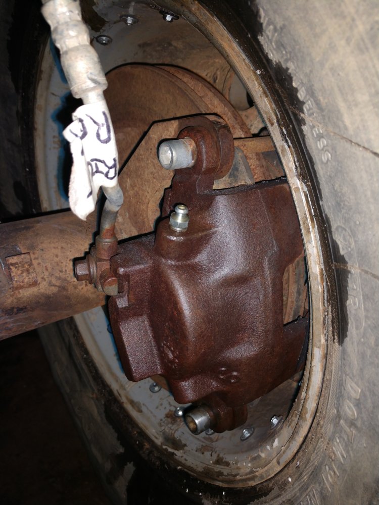

John do you have a picture of the rear calipers, most of the rear disc conversions used late 70's chevy front truck calipers.
I'll get some pics put up soon
Built Jeep tough with Chevy stuff, those are late 70's early 80's chevy front truck calipers! Super cheap, easy to adapt to any axle, and everyone and there brother has them sitting on the shelf. I think the last reman one I got was $12!
cool thanks Chris, dang that's cheap...even for my cheap butt LOL
if this is really the case, it's not even worth my time to take em apart and try to fix or rebuild...$30 for 2 of them (if that's the case) and 10min to pop em on is way better than an hour or more to dissasemble each one. tonight gonna get at it, today is my relax and chill day no work on anything
