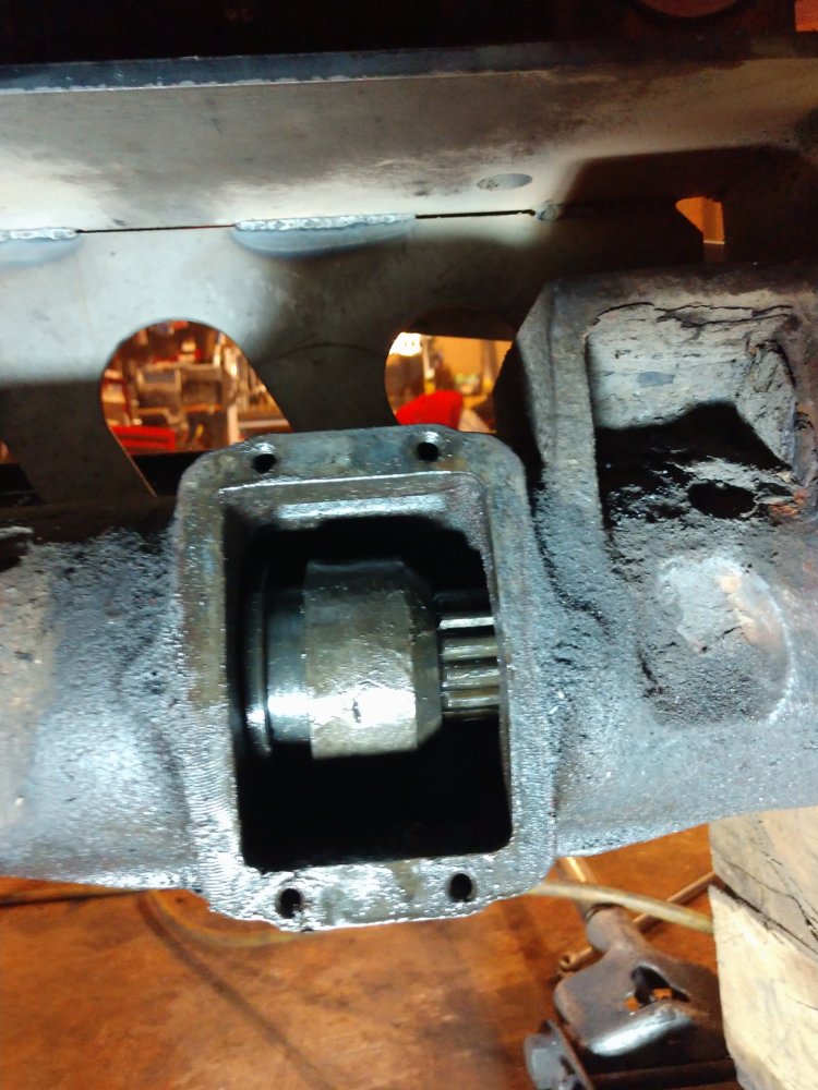

Okay so is it just me or is this shift collar like super huge I don't understand how does it unlock when it takes up the whole entire housing. Is this some kind of special collar that just locks it all the time
When the right outer axle is pushed in all the way the collar never unlocks them so WTH
The collar slides to the right to unlock them. With it slid to the left like that, of course it's locked.
oh no it's not buddy you have no idea. I'm not even gonna get into the shit wrong with this front axle...I'm welding the dam collar to each axle and welding the axle ends together and say screw it put the dam cover back on and send it...the day it breaks will be the day this useless hunk of rusty ass overpriced metal I bought will GLADLY go to the scrapyard and not look back....oh I'm just .....................this build is starting to really suck ass should've gone with my better judgement and stayed with what I had...but no i just had to pursue this one ton shit that I've overpayed for and now just to keep adding hundreds more just to get it moving.........
Sure....weld it. That won't make that hardened steel lock collar extremely brittle or anything and create the place where it'll probably break. Plus, I'm fairly certain if you weld it, the axle won't come out of the housing. Great idea.
To be fair, you used about the least desirable Dana 60 possible and then tried to cheap out and weld the diff so there's not much to bitch about. You either pay to play or do it the hard way. Swap that shit to a one piece inner and be done with it.

there was that thought at the very beginning but in my defense, these were already welded ...with a stick welder also (looked like butt in there).
so how the heck does one go and remove the inner stub shaft when you can't remove the center pin to slide the axle in and release the c clip that's my biggest problem right now which leaves me with no option but to roll with it. I actually wanted when I first bought them to run lockers so I could change gears and such down the road but it was too late
plus I really screwed up now cause I tried to cut the oversize collar out of the housing with plasma cutter, got it cut in 2 but still won't come out cause of the stub shaft so now i'm really screwed
Why would you do that? All you had to do was take the outer half out of the axle and the collar would slide right off and out.
You do know you don't have to remove the center pin to remove C clips to remove the shafts don't you?
i wish..you guys aren't understanding someone welded together two....2 collars grinded it down and slid it on this thing to remain locked at all times. found this out yesterday when i noticed and posted up the picture of how huge it is. i have the outer out, i cut the collar down the thinner side of the groove hoping it would clear the stub shaft but still no good....

You don't remove the center pin to pull the clip on a 30, just slide the inner inward just a hair. This axle will be the same way.
If the PO welded to c clip to the stub for some reason, you've got your work cut out for you. I can't imagine why anyone would do that. Especially since that clip is just installed during initial assembly and isn't needed if ever removed.
It is starting to sound like you didn't do your due diligence with the axle purchase and may have jumped the gun a little...
You don't remove the center pin to pull the clip on a 30, touch slide the inner inward just a hair. This axle will be the same way.
yep that's my problem, someone went crazy with the stick welder in there, leaving big chuncks of rod in there and big huge welds. it was all a hot mess in there when i got it all apart but didn't think it would affect the collar at a later time also not realizing the collar was made bigger. i guess i'm gonna have to try and cut out what I can to get the C Clip out so i can remove this collar and put a new one on to go with my original plan of having the disconnect ability which was my reason for buying a dodge 60 besides what i thought at the time was getting a deal ....yes now i wish I would've bought a superduty front for same price as these 2 and kept my rear 60 and just rolled with it.
