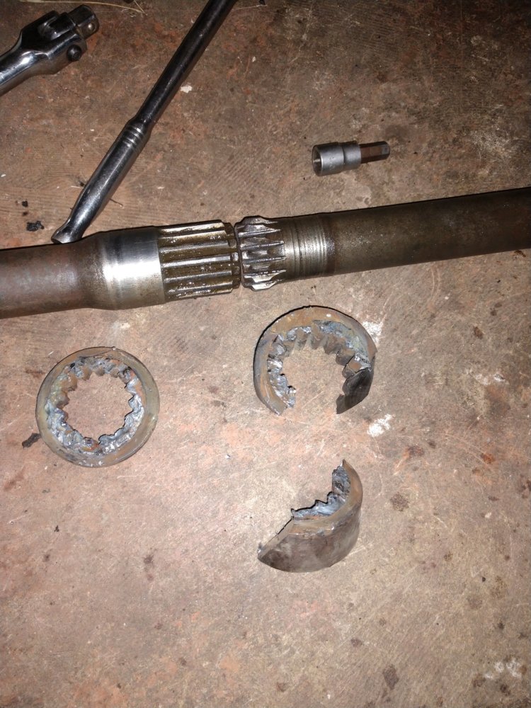

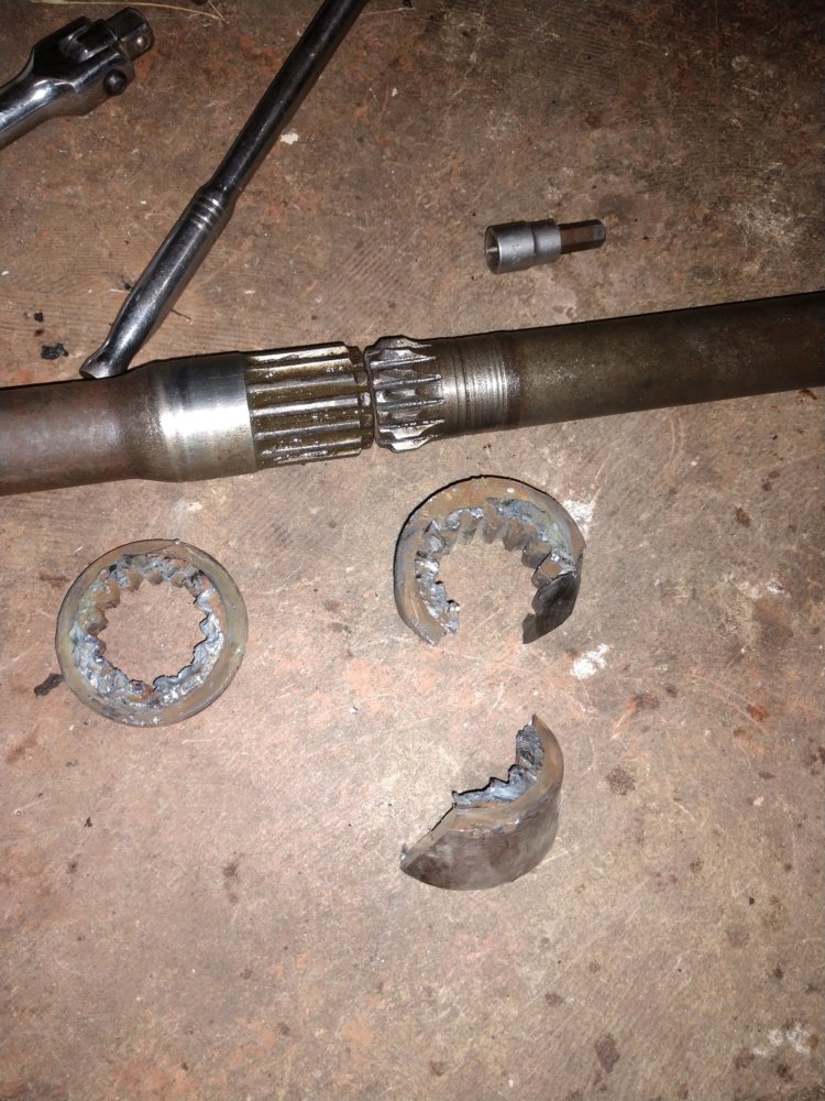

Wow little grinder work and patience and holy cow..
To me, youre too far into this axle to get another. Carriers are cheap/free and 1 piece shafts arent expensive.
Or you could get a SD axle, if you're scrapping this one.
Wow little grinder work and patience and holy cow..View attachment 266090
So was the collar welded to the shaft after all, or just rusted in place?
No there were 2 welded together, just got everything I need so will be back to test run this week soon

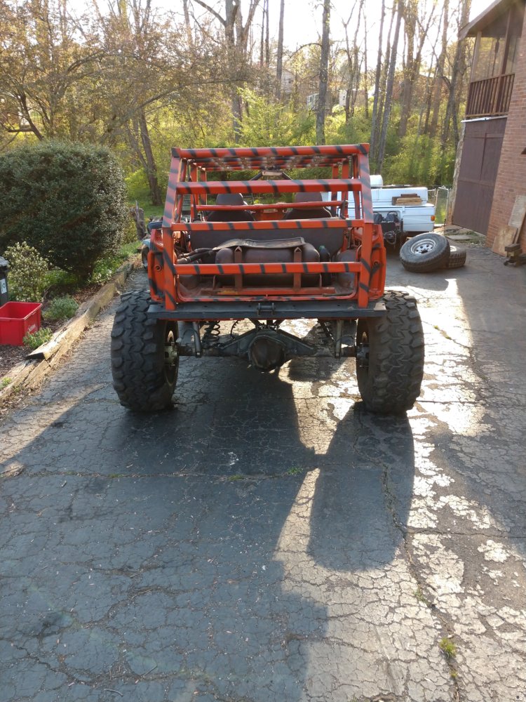

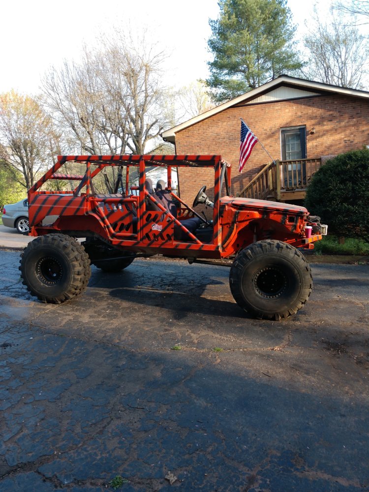

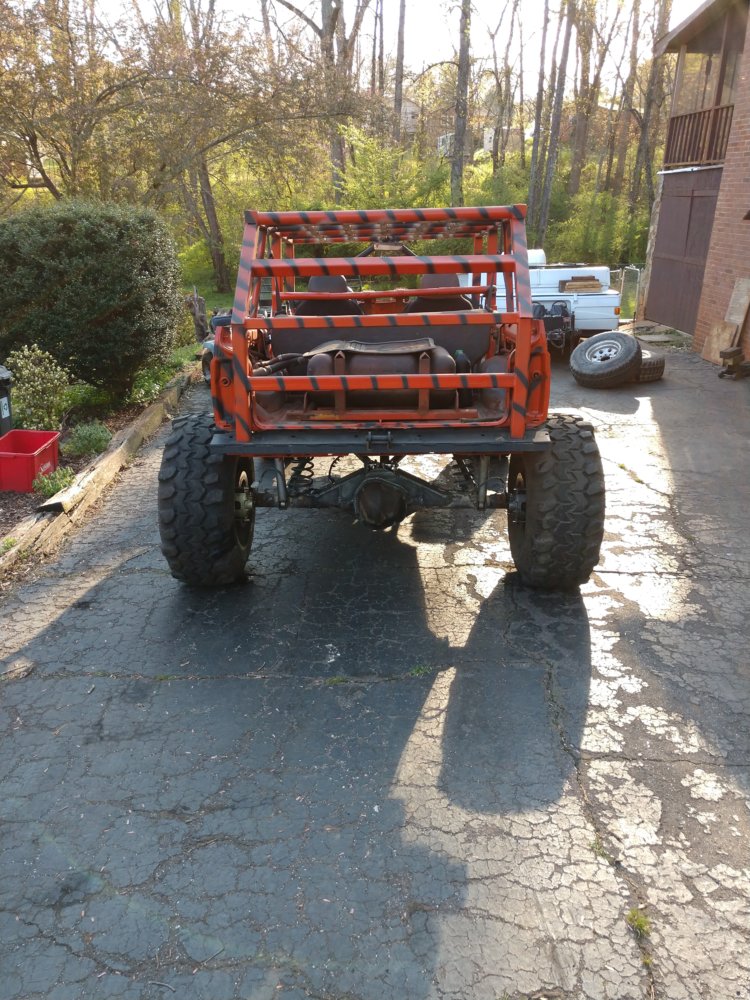

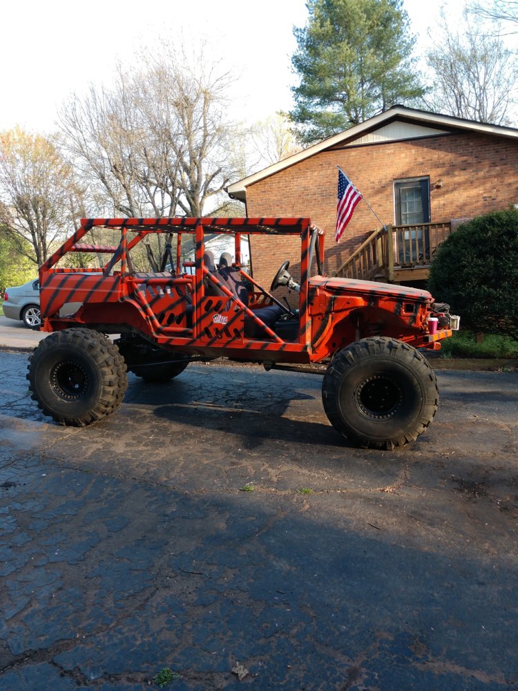

Well it's out of garage but gotta make new track bar still and looks like brake booster went bad I guess
Pedal holds strong with engine off, when running it goes down almost all the way and spungy
Sounds like air in the lines
That's what I keep thinking but it didn't seem to keep getting air..and weird part is engine doesn't change rpm or no hissing sounds so seems odd for booster to just go and be faulty all of sudden..
Any advise. Master sat empty for last 3months
1986 Ford E350 master cylinder will fix the pedal feel.
Been there, done that on 3 different XJ/MJ with same brake setups.
so your saying it is the booster? or master? or is that just an "upgrade" your giving. I just want it to work for now, no money for upgrades at this point.
I've got to build a beefy trackbar. Then I've got to do the Hydro Assist. This is about all I can handle right now to finish it lol.
