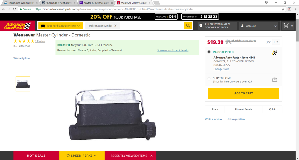

I know you want it to be something easy, but using a troubleshooting mindset--where in that process does "spongy pedal" equal "bad brake booster"? Your xj master doesn't have a large enough piston/push enough volume for those bigass chevy calipers in the rear or the mediumass dodge calipers in the front vs the old baby jeep ones. Either way I'm sure there is air in the lines. If you pump the brakes do they work or does the pedal still just sink to the floor? And you realize that the master cylinder Jody occasionally-knows-what-he's-talking-about Treadway is suggesting is only $20 at autozone, rite?

1986 Ford E350 master cylinder will fix the pedal feel.

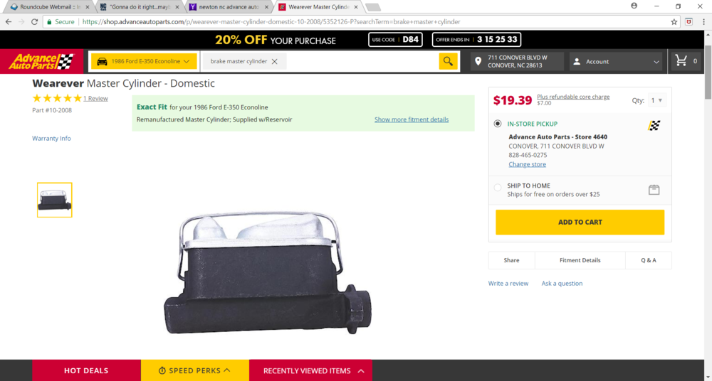

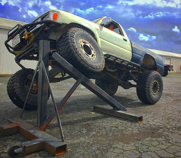

Build a ramp. I know you can throw something together quick from the scrap yard.
I wanna see some flex pics.
Here is a simple one as inspiration.

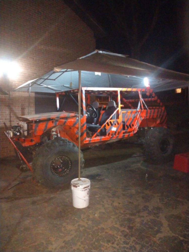

When your rig won't fit in garage anymore, you know rain is coming but you still got work to do....lol
