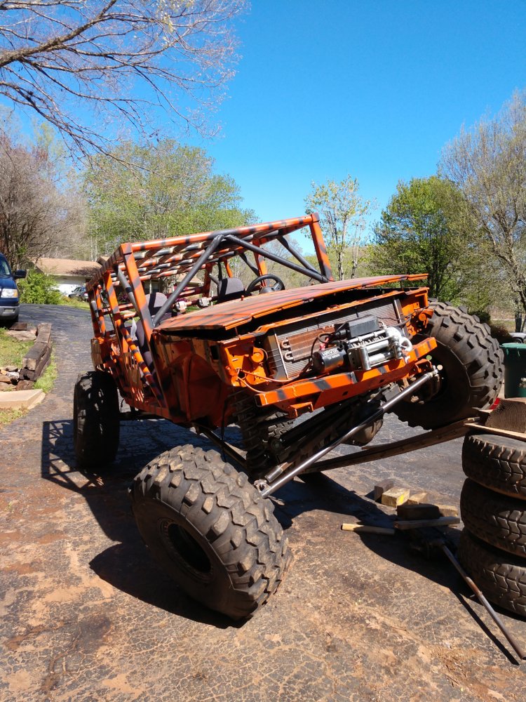

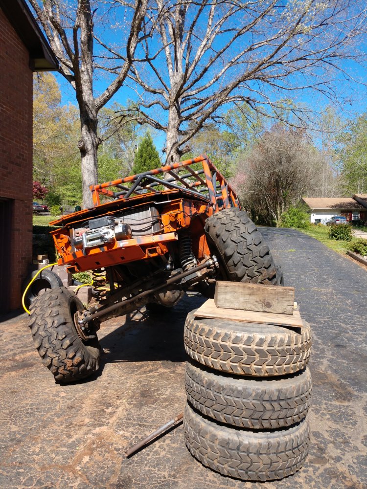

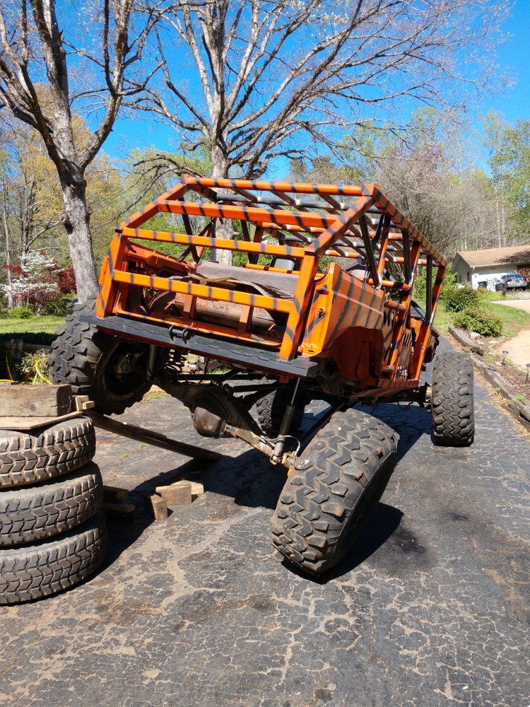

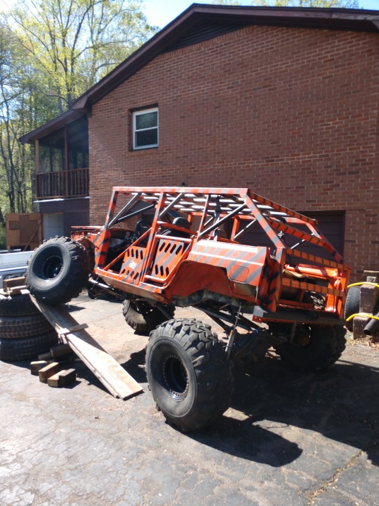

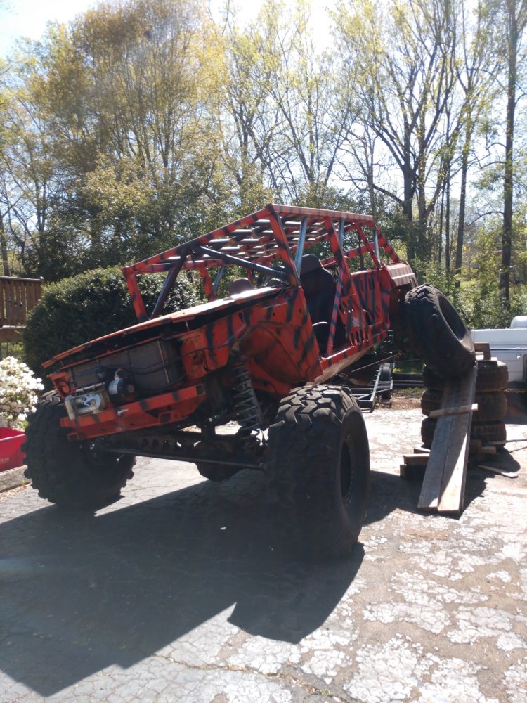

I spy a very un-seated coil in that rear left 3/4 shot. So...nope! I'd be careful with that one...would bring the suck to come off of being crossed up and suddenly have a gangsta lean.I wanna know final weight... lol also if it wasn't tiger stripped I think it would have a more aggressive look to it! If ya don't buy a tiger costume to ride in then all that paint was for nothing! Just sayin... looks good you have something holding coils in on top and bottom? Or just limit straps?
Same here...chances are, as long as the bottom of the coil is mounted VERY securely, and the axle doesn't have any/much side to side movement...it "should" come back down on the spring. But...strange things do happen.I'd give it hell as it is no doubt, just a thought about coils tho...
Nah y'all them springs ain't going nowhere. They are very very secured to the bottom.I spy a very un-seated coil in that rear left 3/4 shot. So...nope! I'd be careful with that one...would bring the suck to come off of being crossed up and suddenly have a gangsta lean.

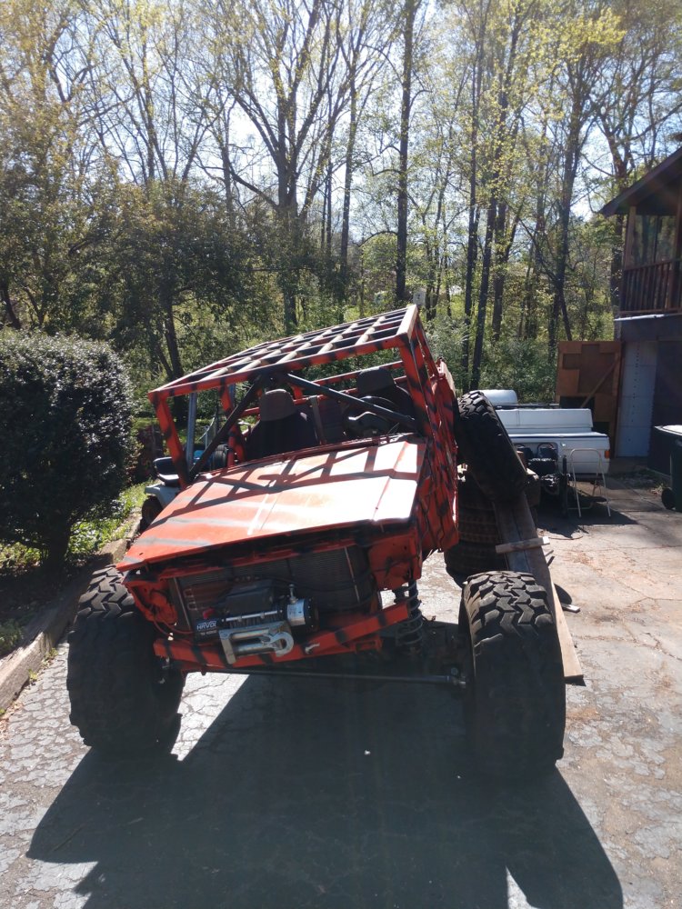

Really don't think you want my advise lol, but I used 1/2" thick tabs under sections of it then 3.5" tube in center, little L brackets to secure it down in several different places. It's simple, ghetto but it workshow did you secure the springs?
