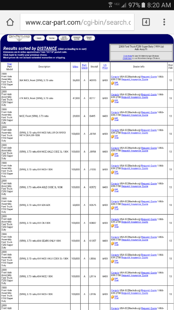

A F250 HP44 is no more than $300. Find one with 3.73 gears, they are out there.
You WILL spend more than $300 half-assing the exhaust, tranny cooler lines, etc and STILL have crappy driveline angles.
