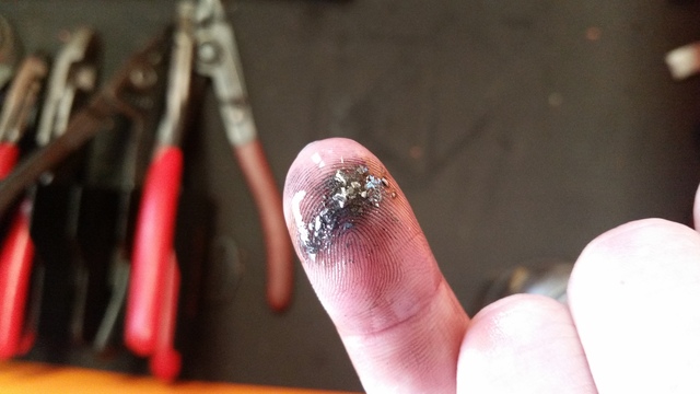

Does seem to harsher on acceleration, but doesn't go completely away on decel.
i honestly seem to recall the FSM mentioning the trans output bearing. Ill see if i can find it
Magnet was full, this from the bottom of the trans.
Trans is out and at A&A Transmission for a look-see.
Thanks for the help guys!
