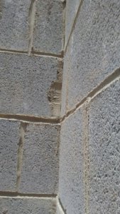

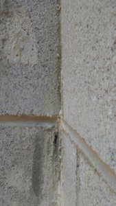

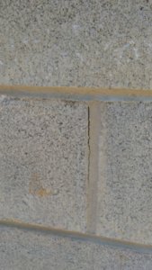

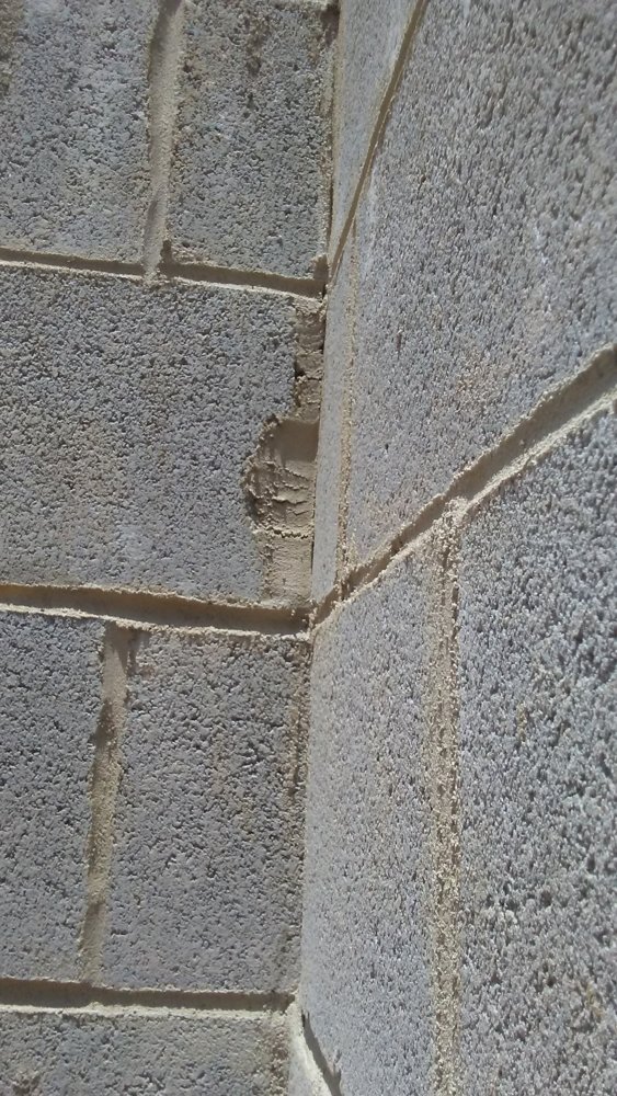

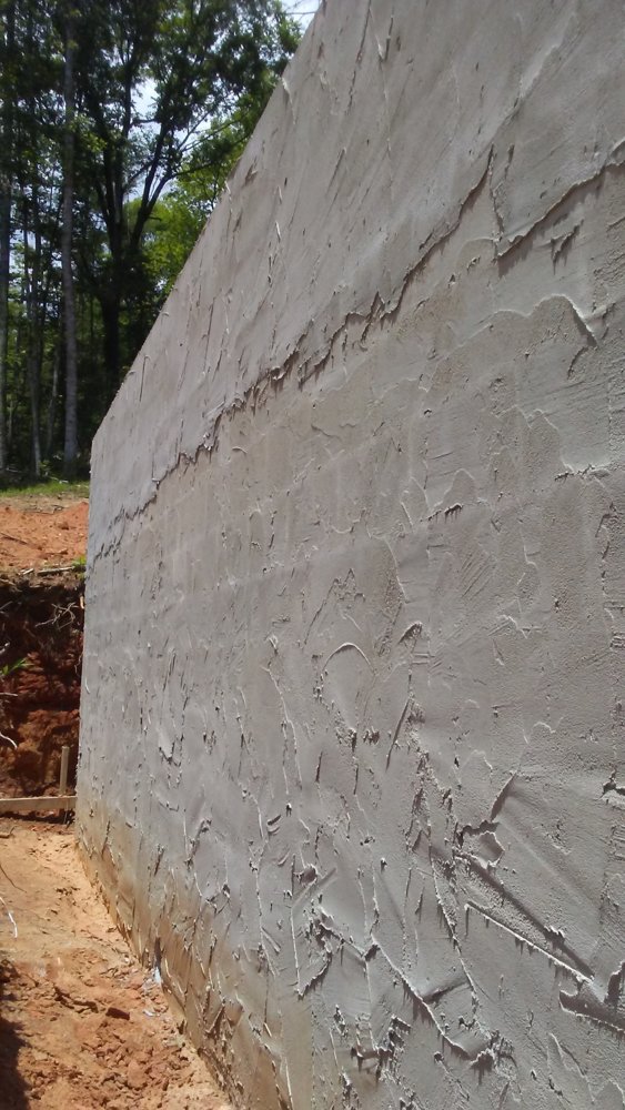

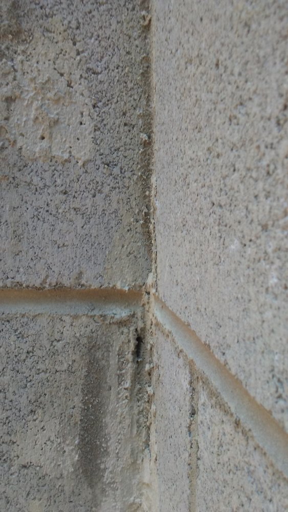

Here are a few more concerns. A good friend of mine describes it as "looks like shit on a white rag"...any comments are welcome.

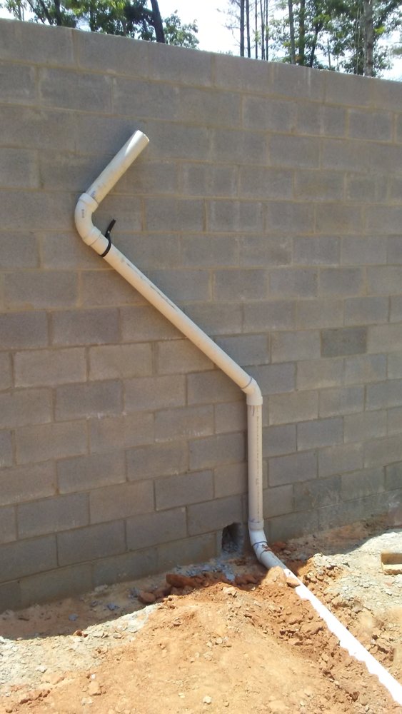

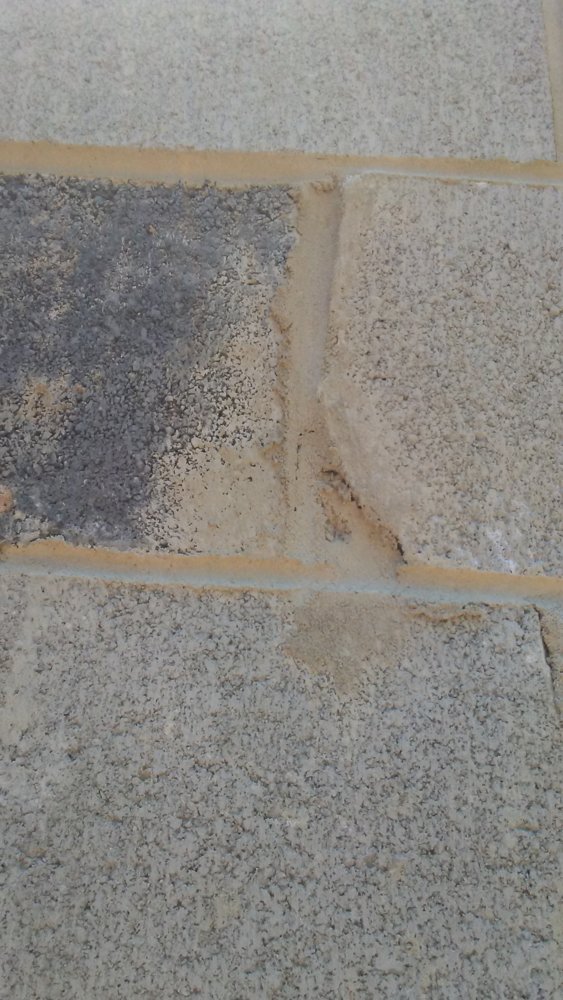

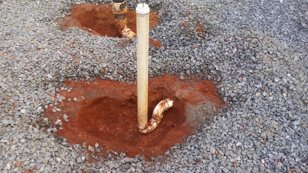

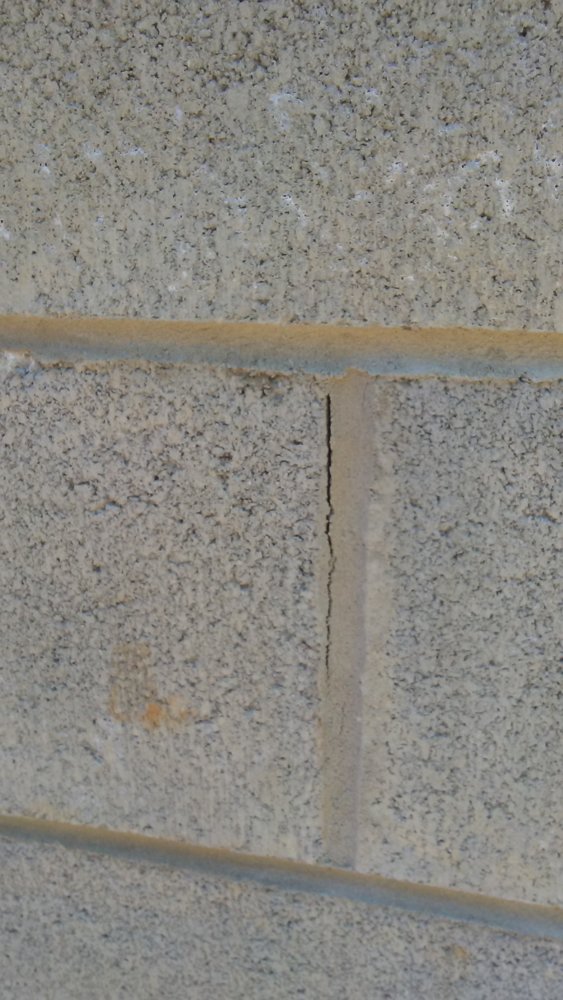

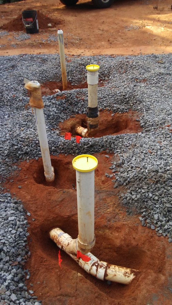

meh the block is fine. all that is below grade. i saw one spot id have them touch up. but id rather use a rubberized liquid as a water proofing than that. idk what the hell is going on with the piping
Masonry looks fine.
Not sure what's going on with the plumbing. Hard to tell. Kind of looks temporary for some reason and not sure why he used two street 45s instead of a regular 90
As far as the plumbing he said those were the only fittings he had so he zigzagged it. He said it is supposed to have a 10' head? At the washer and says should eventually have a y fitting 3-4' off the floor joining the washer drain and then go up through the roof.

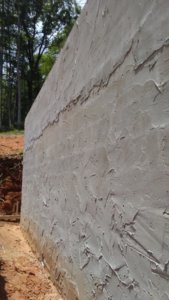

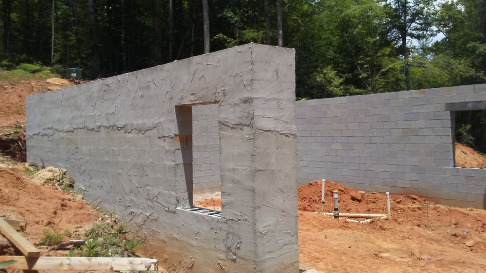

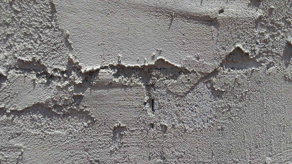

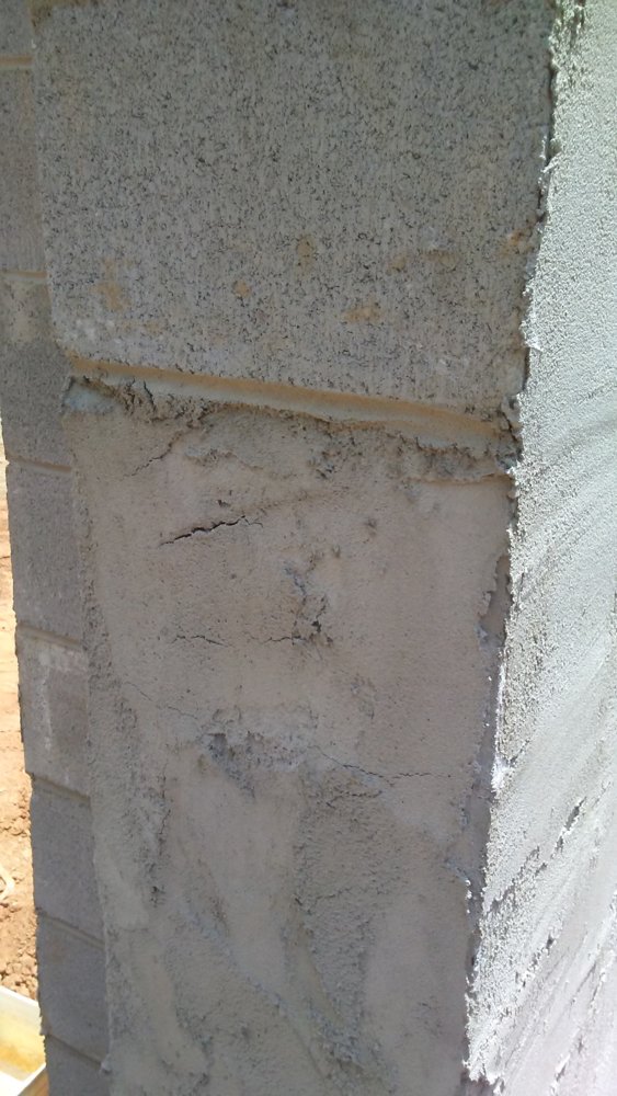

As far as masonry it will work but I will fix it. Many of the pics are from inside the basement and are the finished deal. On the stucco'd outside there's no way that no mortar in a joint even after being stucco'd is acceptable. Also it may look like the bad lap of stucco is going to be below grade but most will be visible because positive grade will be below the frt windows
Looks like he is leak testing it with the zig zag fittings. Like I said, looks temporary.
I'm betting the piece on the wall is pre made to fit through the outside wall and he will use that once he leak tests it.
I'm betting there are other stub ups the same height.
honestly looks like your making mountians outta mole hills. grout shrinks they pic you showed looks like they pulled it to late and pulled the edge or did it to soon and removed a little and it shrunk a little no big deal surface imperfection. and for the stucco if you expected a brick mason to do a A+ job on stucco your high they would be a stucco guy if they were any good at it. most apply a stucco coat as a base for ( rock, stucco, brick or whatever)
We are going to finish one half of the basement for the kids. The other half does not need to look nice or professional it's just what I would prefer. Will corners that were made by breaking blocks with a hammer and then halfway throwing mortar in the holes work... probably.
Are you not finishing with batten strips and drywall? If so, it will cover it up. Are you expecting to have a perfect finish on the block for a finished room? Does the mason know this?
If I'm installing block, it's rough because it's either going to be unfinished, painted to be an unconditioned basement storage area, or will be covered by some type of wall coating. Anything other than that is expecting too much of a mason. If you expect more than their norm, your going to pay dearly for it and likely still won't be what you expect.
If you plan to finish, might as well figure on batten strips with drywall for a true finished surface other than looking like an old painted block wall in a rest area on I 40

As far as the plumbing...he was too lazy to dig a 5/6"deep trench 12+/-' long so he knocked a hole through my block wall and was gonna circle the house with 50' of pipe!
That quality is par for the course for residential block masons unless you have performance specs saying they should be doing different.
The important question. Do you know if the mason even used the correct mortar? That would be my question before picking out 5-6 minuscule areas where they are missing some mortar.
I'm using a local contractors subs. He supplies the subs including the masons. As far as the mortar it was type s.

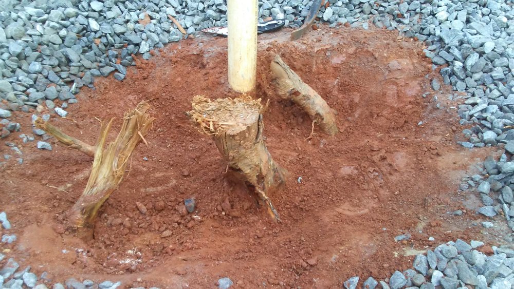

1)There were three large roots after they did the final grade removing excess dirt from the basement. The roots were right next to some plumbing. I asked them to cut them out before spreading the #57 stone. They didn't.... they just covered them with rock. I removed the rock, cut the roots and put back the rock.
2)As mentioned earlier in thread, I had trouble with the plumber. First he forgot to install pipe for washer drain line under slab. Next he came back to ad line and decided to sledge hammer a hole through the basement wall at footer... right where French drain would be. I made him install it correctly and then patched the hole in wall myself.
3)After the plumber left I checked all the plumbing for correct layout. Turned out that 3 out of 4 pipes were in the wrong place. For example the toilet drain was positioned 7" from center of drain to wall stud when a minimum of 12.5 is needed. To save time and do it right I removed the clean gravel from around the pipes, dug out the dirt for correcting the plumbing and left it for him to just cut and fix...

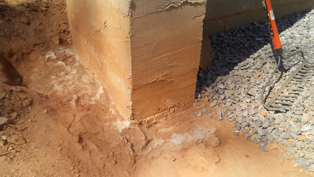

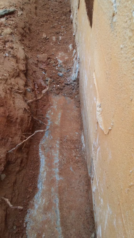

4)Yesterday 3 subs came out to apply sealer to the basement wall exterior and footer. I told them to wait for me to get there before sealing the footer/wall intersection because I wanted to make sure it was clean as possible. When I got there they had already dug dirt away from footers and halfway swept it. The lead guy told me that there were some places where my wall was barely on the footer but it was No big deal. I told him "you don't really think that's the footer do You?" His reply was "well... yeah". I quickly grabbed a hammer and broke off the concrete droppings and dug down another 3- 4" to show him where the real footer was. What he assumed to be the footer was mortar mix from when the mason had been doing the top section of the wall and dropping it on the dirt that had washed on to the footer. As a matter of fact I'm just assuming that. Today I'm going back out there to see if the mason put mortar to the footer or if he just ran it to the dirt on the footer. If there is no mortar at the bottom of the wall then guess what... there will be.

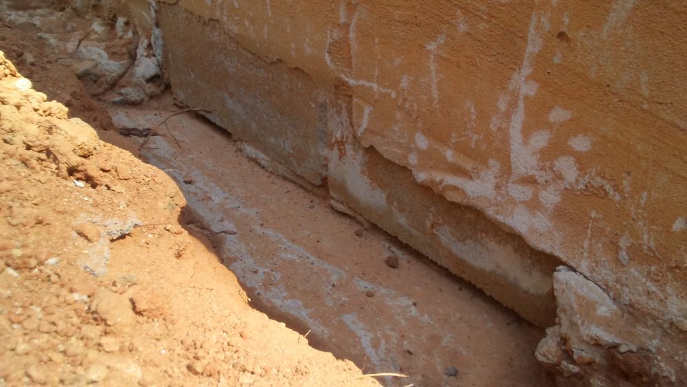

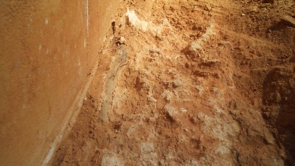

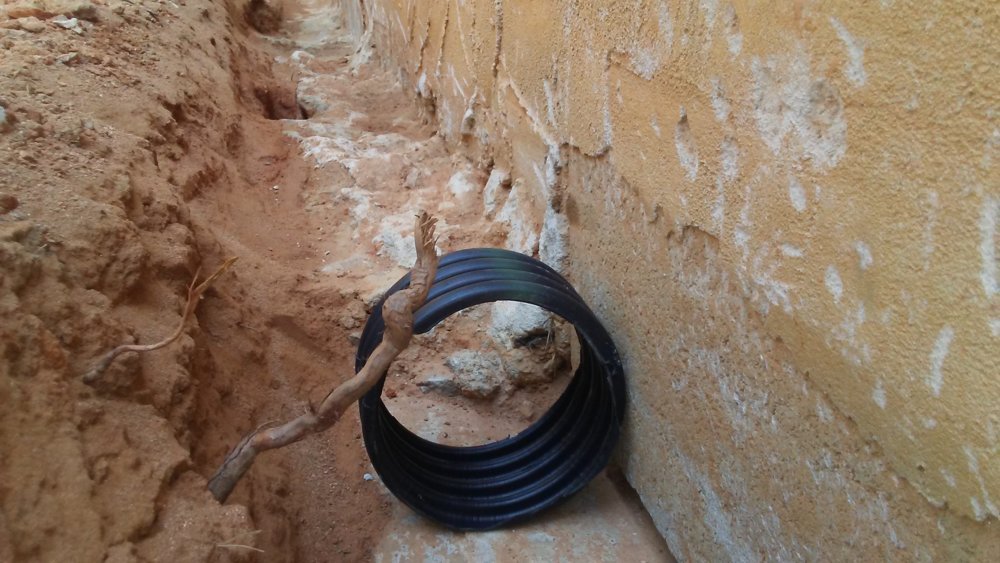

If I wasn't catching theses things then these guys would have sealed the wall and the ground 4" above the footer. Then they would have installed the French drain not realizing it was too high to even work! (in the footer pic you can see the concrete slag and dirt mixture at top of pic and footer at mid and bottom of pic.)
sounds to me like you should be doing most of this stuff yourself vs redoing it all?
I have experience in roofing, framing and most above ground stuff to some extent... 'but no experience with footers/foundations. Since I'm going to do all the interior including most likely the plumbing/elec....having the shell done seemed like a good idea???

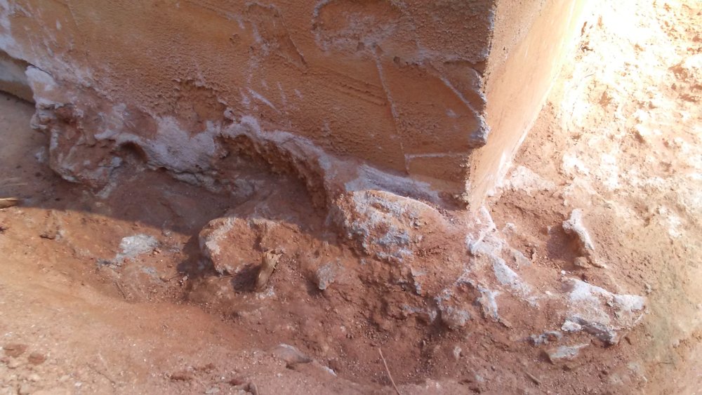

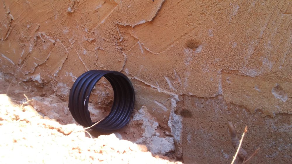

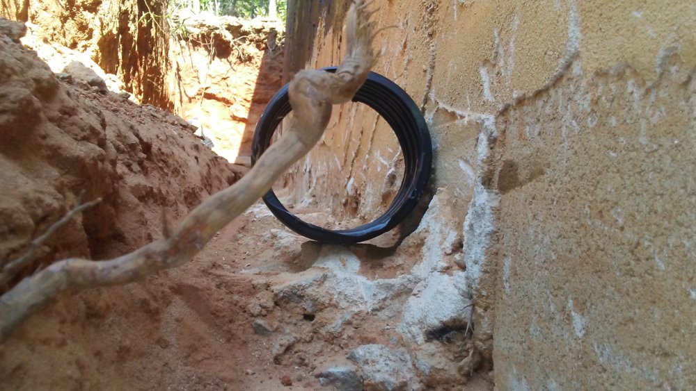

Went to get a better look at the footer today. I removed the dirt then swept it all up. Basically, when they laid the block there was a pile of mortar here and there all around the perimeter. I asked them at that time if it would be cleaned up and if places where no grout was under the first run of block would be filled. I remember him saying it was easy to clean up after it dried and they would fill gaps at footer and bottom blocks when doing the stucco.
They took 3 weeks to start the stucco so when they got there it had rained 3-4 times. And covered the footer and the slop with dirt and silt. They were too lazy to shovel off the dirt and concrete slop so they just stucco'd to the dirt leaving 4" without stucco and not filling the gaps I had pointed out.
Would you guys have them remove the slop and finish the stucco to the footer?
In one pic you can see a section of drain pipe I placed on the slop and then on the footer. Another pic shows pipe on footer and two wet spots(spit) on the block. Bottom wet spot is height of gravel and top wet spot is top of interior slab. To me pipe on nice flat footer below the bottom of interior slab would be correct. Any thoughts on the matter are welcome.
The last pic is a stick stuck in the slop(mortar) that fell when stacking the wall. It's about a foot long and 1.25" thick.
