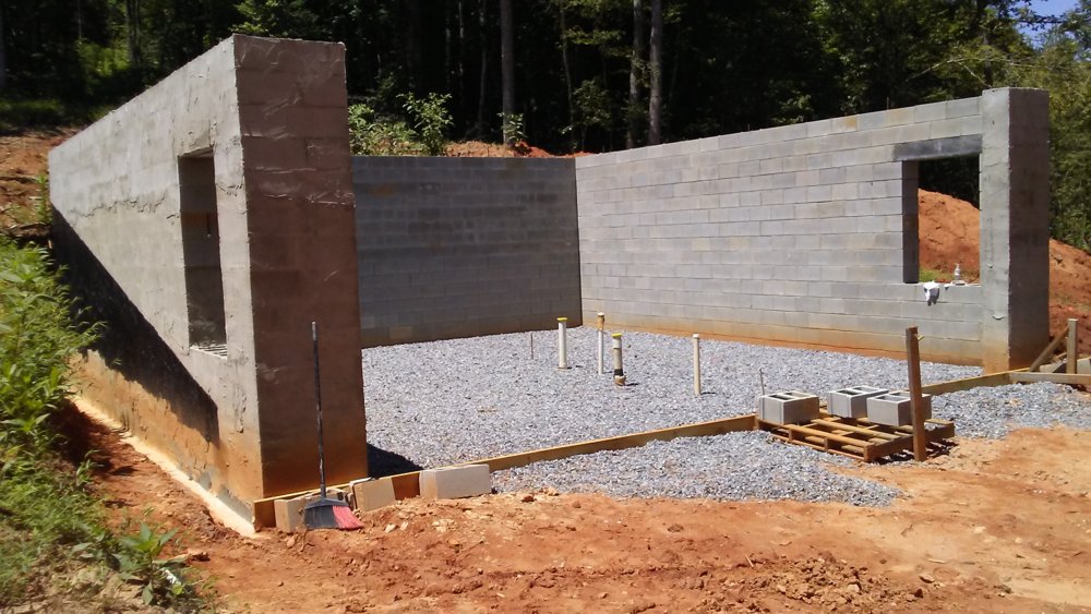

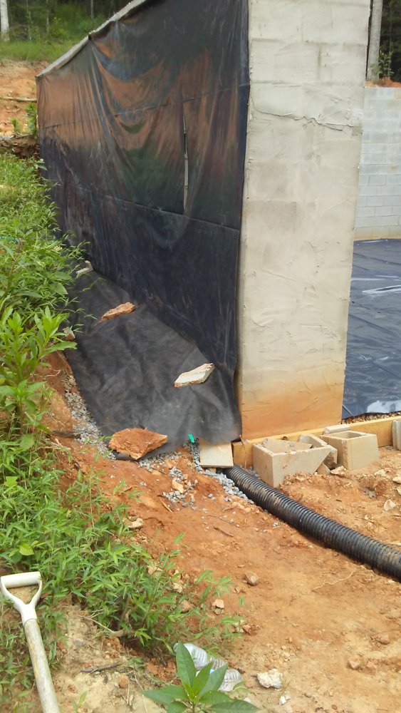

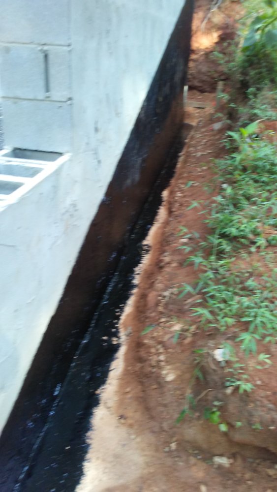

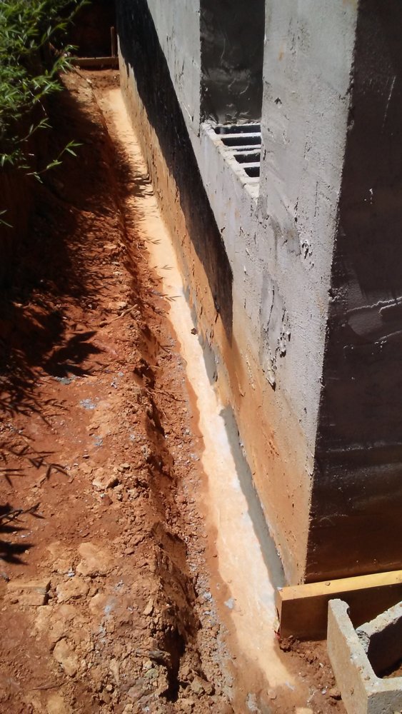

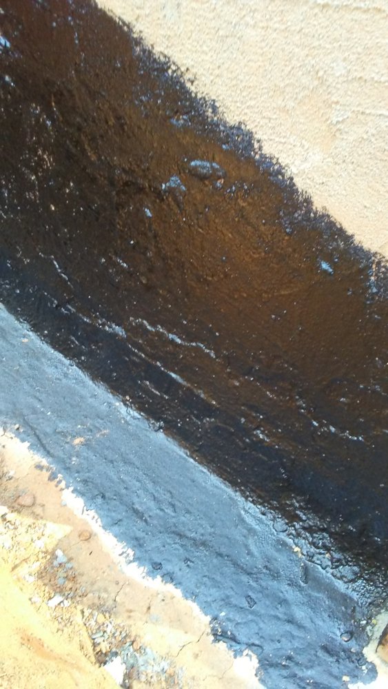

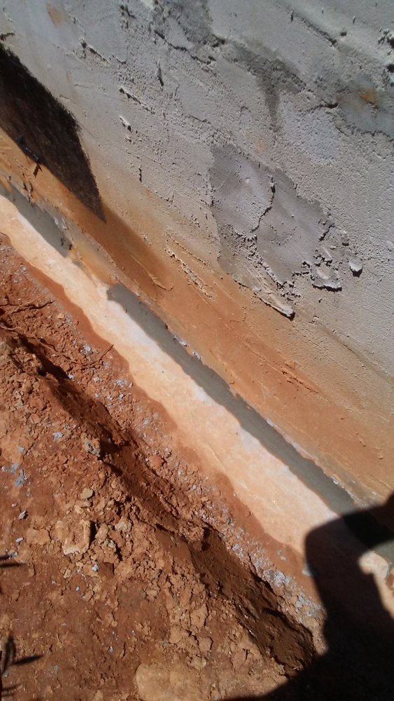

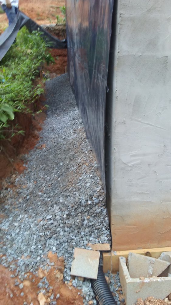

after having the stucco applied to the bottom of the wall we got 2 heavy rains and dirt covered the footer again. I shoveled off the dirt, let it dry and then cleaned out the intersection of the wall and the footer with a combination of broom,brush and pocket knife to remove all the clay and silt. After that I went ahead and re-did a small section that the stucco guy had missed...again.

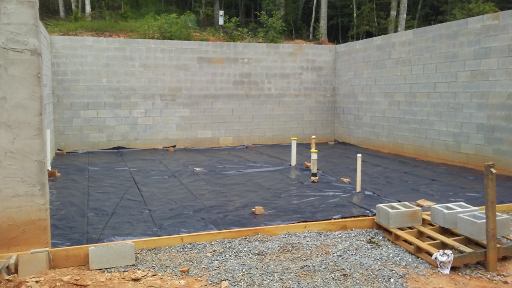

Looks like sunshine and decent temps this week so hoping to finish sealing the wall and footer,install drain pipe,rock and cloth...vapor barrier and pour slab and wall cells.

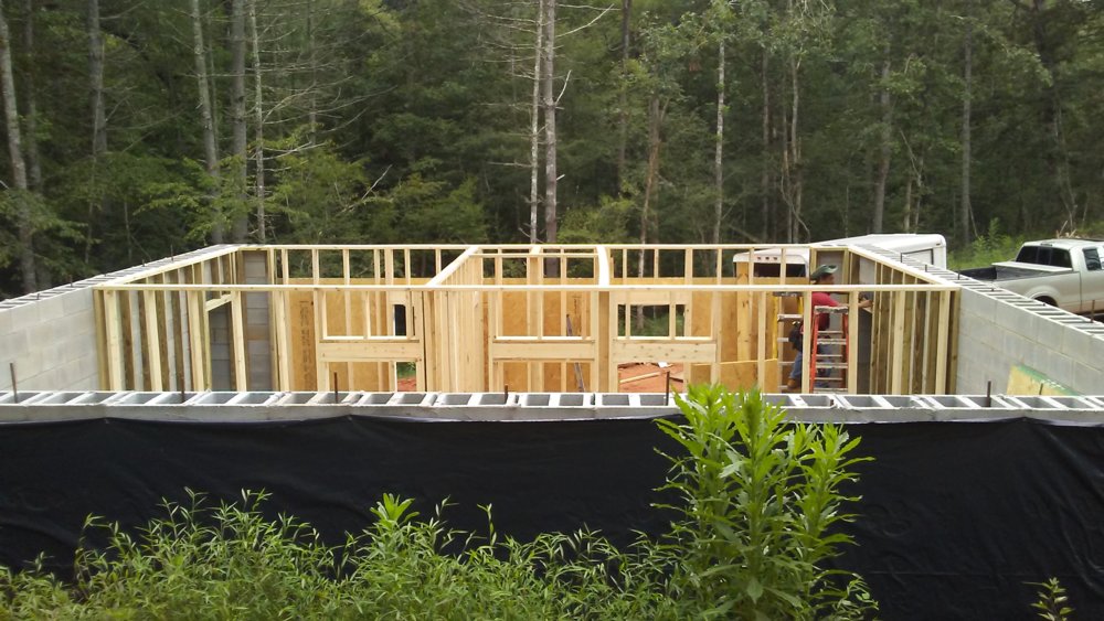

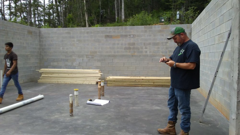

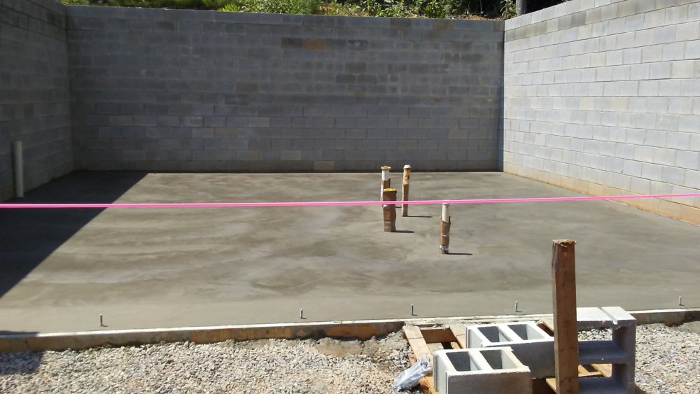

Got everything done and just passed inspection this morning. Concrete today or tomorrow before the rains come Saturday.

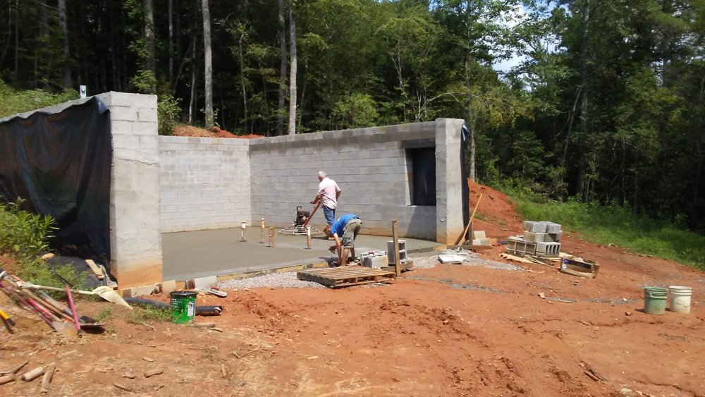

Well.....we passed inspection Wednesday and had the perfect opportunity to pour the slab but the GC I'm working with called last night and said it would be poured Monday.
Too bad Monday is calling for 80% rain and then it looks like 50% every day until the 18th:)

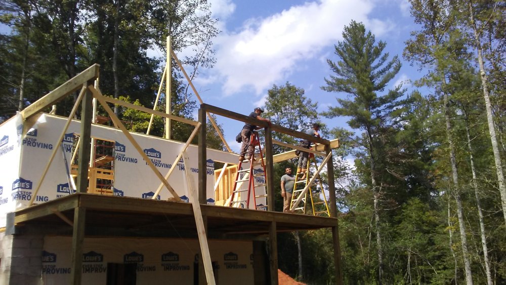

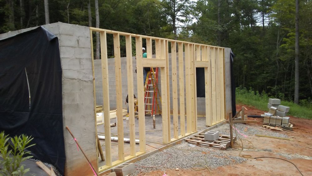

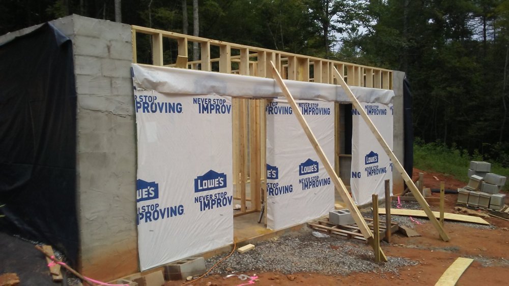

Made some progress since last post and things are going much smoother.

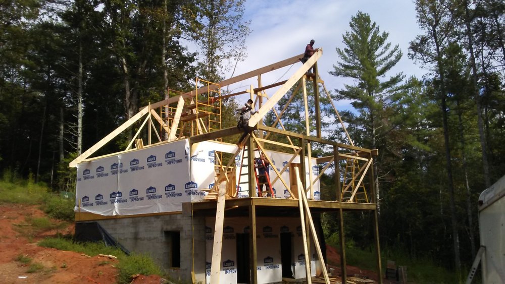

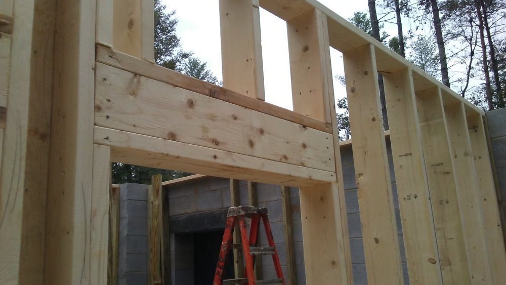

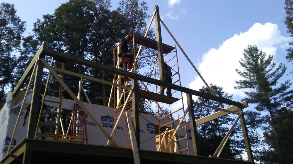

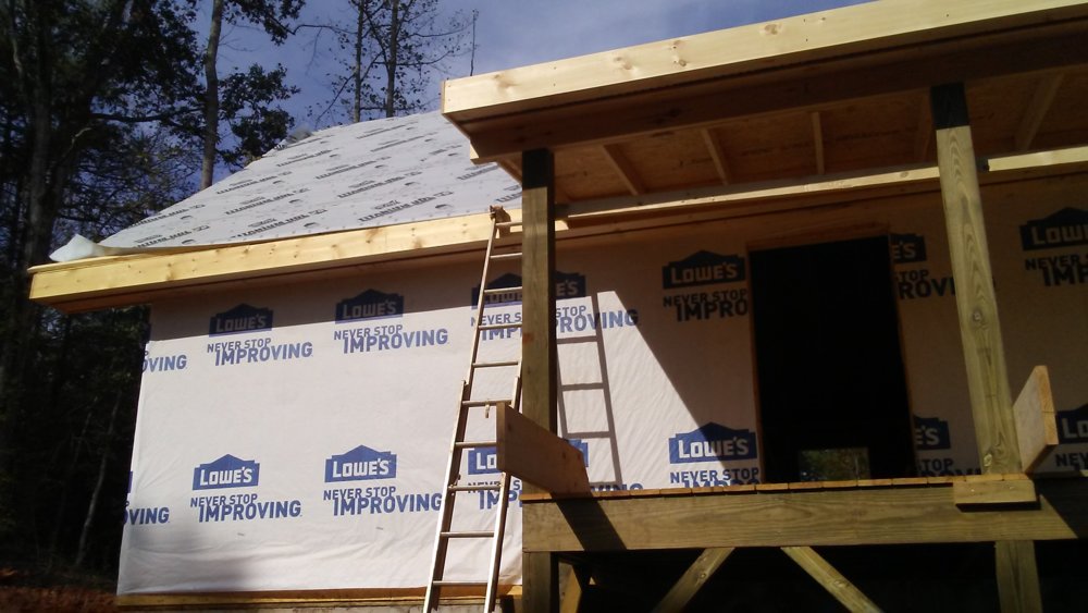

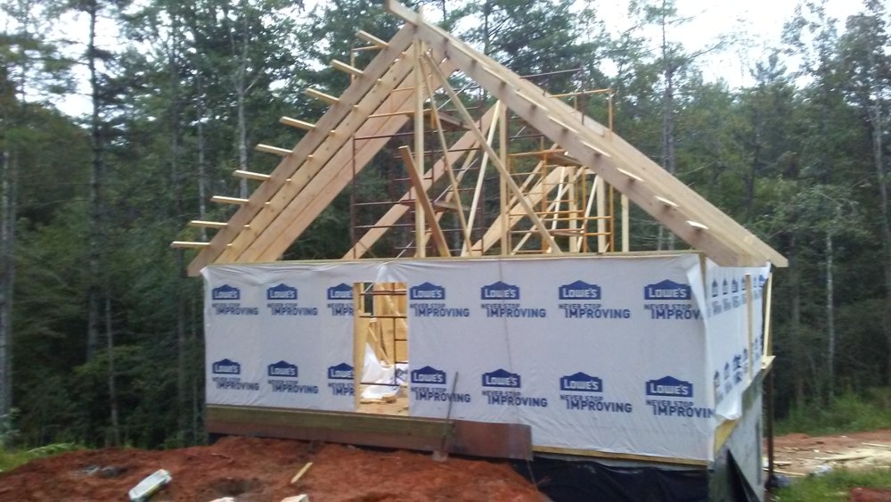

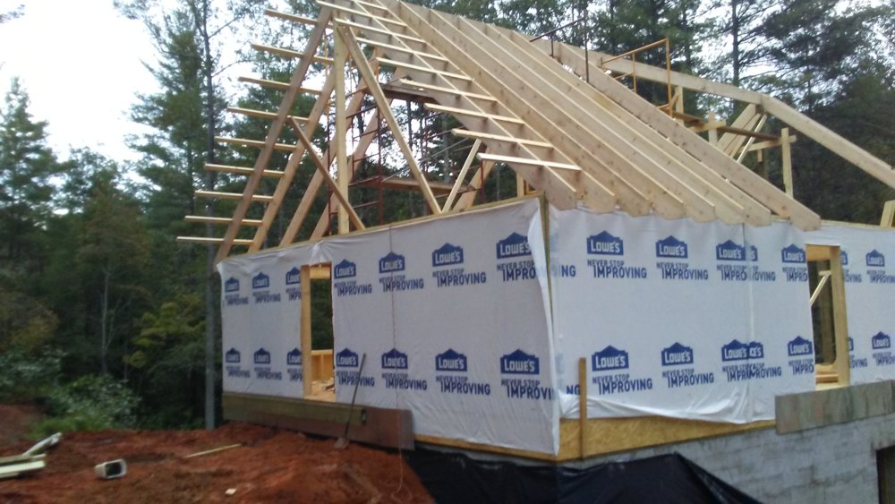

recent progress

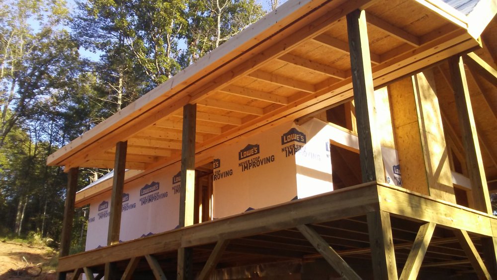

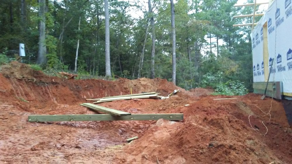

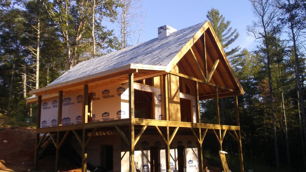

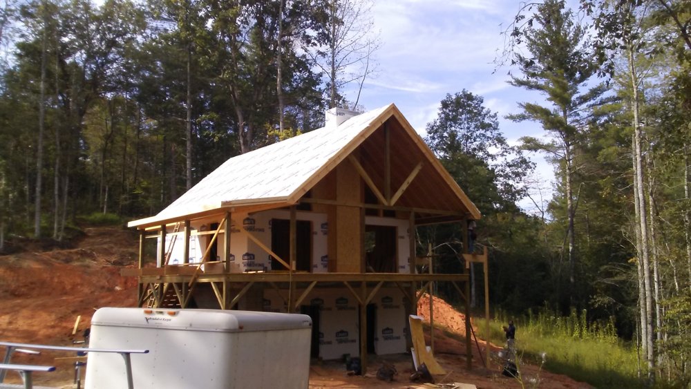

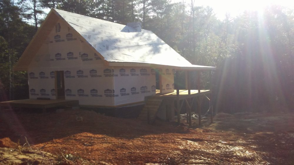

some more pics of progress on house and grading. Love the backhoe and money it has saved.
