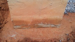

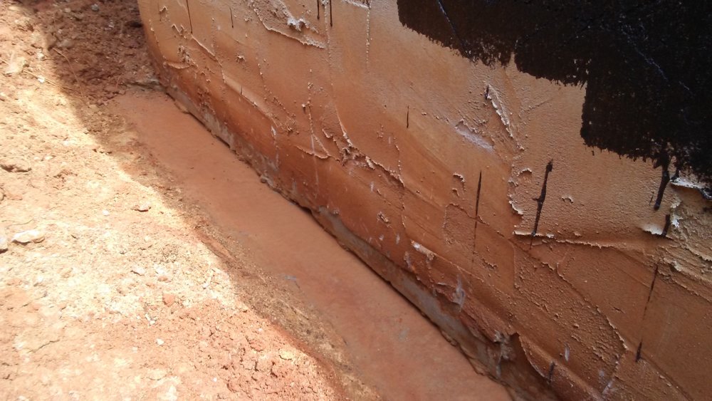

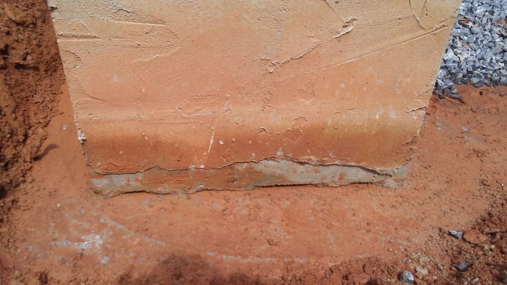

I hate to be so particular but I can't see sealing the wall to that slop and installing the drain line. It will need to come out and then grout the block at the footer and where he did not stucco the wall or fill the bottom joints.
What's really aggravating is telling them to clean up the slop and fill the joints and they still don't do it.

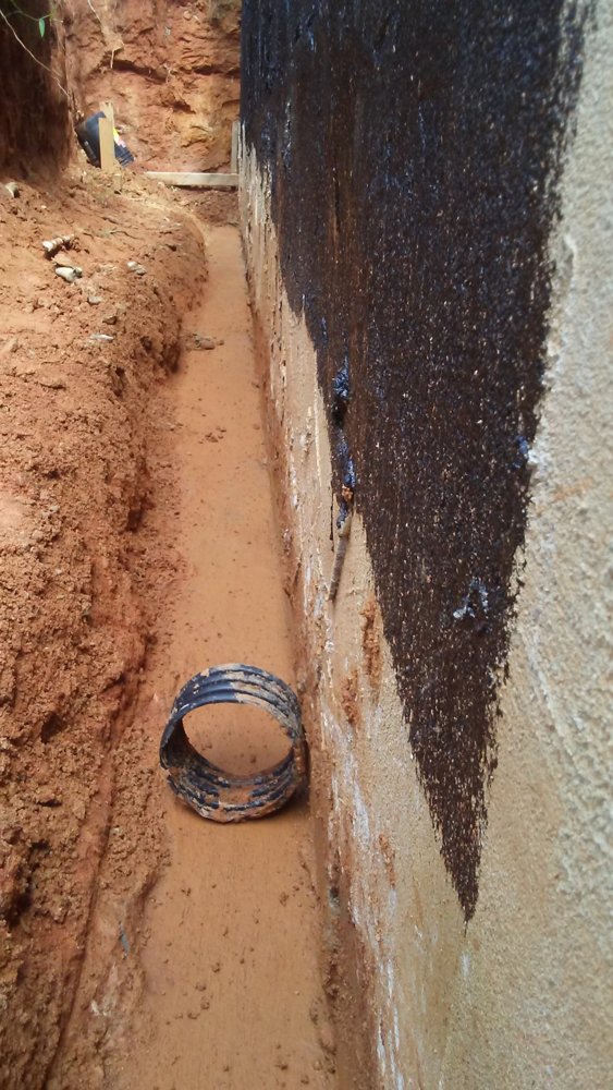

I cleaned off the footers and broke off all the concrete slop. Today I'm doing a final cleaning before the stucco guy/mason gets here to finish the last 4" he never did at the footer. Builder plans on wrapping the basement with plastic over the brush on rubber sealant. I've had a friend in the business say that many builders don't do that anymore because water gets trapped behind the plastic if it gets cut while backfilling or deteriorates. He claims it was popular during the 80's and 90's but is not needed.

Also, after cleaning off the 7-8" of dirt and slag from the footer there is a narrow trough for the drain pipe to lay on the footer. There is about 3-4" of space between the pipe and that dirt/clay bank that is 8" tall. Is that enough space for the gravel and silt cloth? I'm thinking a foot of gravel above the pipe and to the side of the pipe????

Mason's name is Charlley/Charlie Bradley out of north marion. He came by yesterday to apply the stucco to the bottom I had cleaned and prepped for him. When he got there the bug guy was there spraying the gravel for termites. Charlie went ahead and slapped some stucco on the bottom and by the time he finished all 3 sides, bug spay was washing out from under the bottom block and backfilling up the footer about 12 feet x 1.5" deep. I only saw fluid coming from that one area so maybe I can just re-mortar that section. Had a big storm last night and all my clean footers have about 2" of silt on them.
Next step is re-shovel and sweep clean the footer, apply the rubber sealer lay pipe ad rock and silt cloth...
