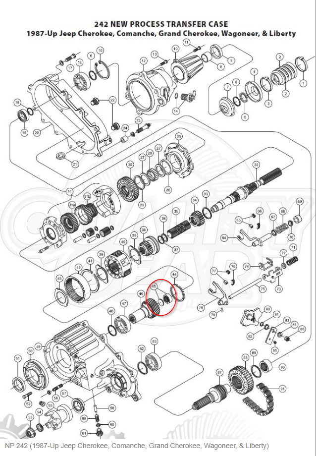

Reading through this thread, everything in my head points to T-case bearings on the output side. You said it was originally vibing around 70. Then switched from 3.73 to 4.56, and the vibes dropped down to the 54-60mph range. 3.73/4.56*70=57mph, dead in the center of the 54-60mph you stated earlier, and the 55-58mph that has been stated more recently. So its at a particular driveshaft rpm zone. That pretty much eliminated anything from the carrier downstream. And this mostly rules out engine and transmission, unless the harmonic just doesn't present itself in the first few gears. One way to eliminate those for sure is pull the front driveshaft, put it in 4low, and drive at about 20-22mph, in OD gear, which should be the same RPM (assuming 2.72 t-case gears). If the vibe is there in 4low at same rpm in top gear, then its transmission output or t-case input. Honestly, could be something as simple as the front bearing on the t-case rear output shaft being worn and allowing some harmonic oscillations, especially since that end is pretty much only supported by another bearing.
That's the kind of thing that would not show up with a runout check or a low RPM, but would really start to show itself at higher speeds.
