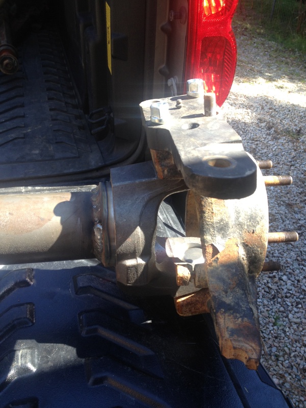

Got 9" out of truck and into garage

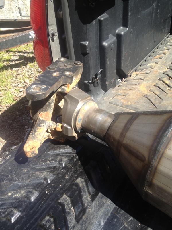

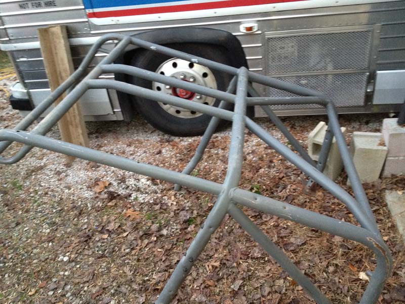

also better pic of cage

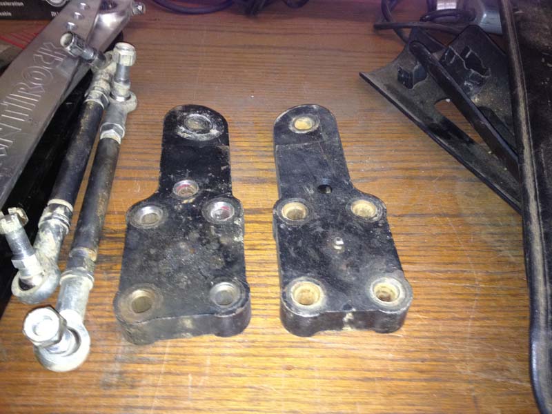

and got high steer arms in the mail

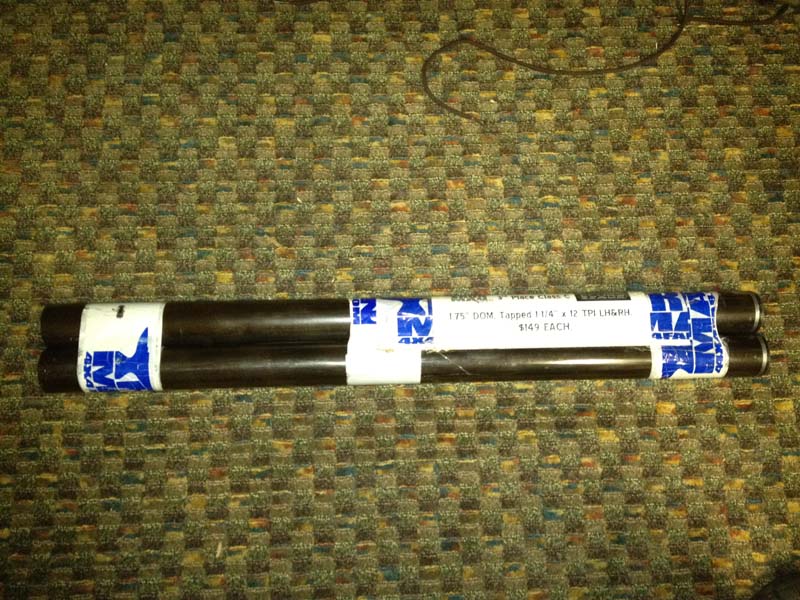

and got some extra tube..
You going to use both the sway bars? Or you interested in saleing a set? Interested.
I am leaning towards running both.. just have not decided yet and will be a long time before I make that decision

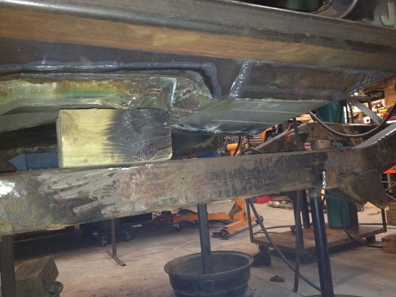

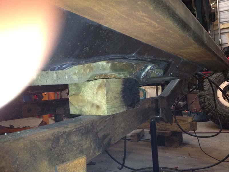

Well finally got the passenger side floor finished..next is to start drivers side
here is how the outside looks when done, so you can I get the angle I wanted so I can then build my boat sides below this.

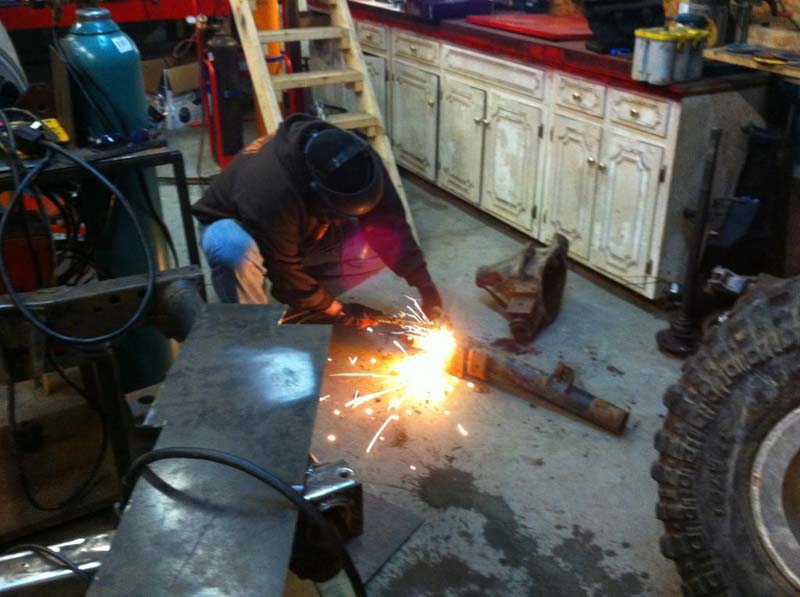

well spent some time organizing garage and then decided to start cutting inner C off old axle to start the prep of new front axle
but ran out of oxygen for torch.. gonna fill that tomorrow

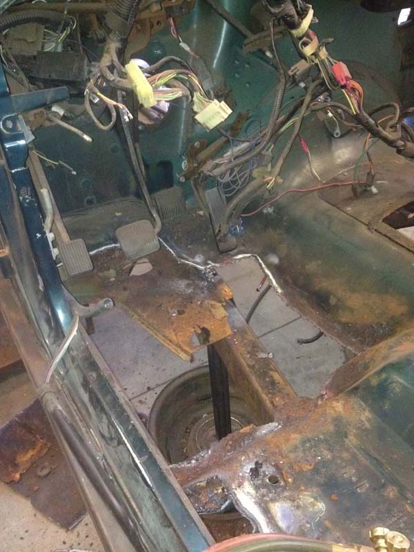

I had intentions of getting the entire drivers side floor pan done.

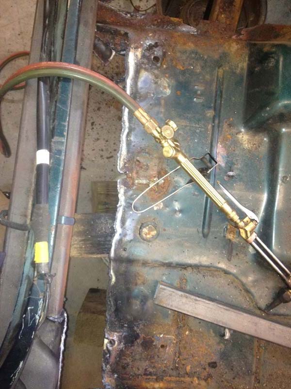

so I start cutting floor and fine TONS more rust then I ever thought so drivers side will need a lot more work then passenger did.. then while using torch I set evaporator can on fire.. flames 6 feet tall 1 foot wide.. I figure no biggy I will grab my extinguisher and put it out.. well I hit handle and damn it is empty and flames are getting bigger..
at this point all I can see is garage burning to the ground so I bolt out of garage to house grab hose and run like a fireman with hose over my shoulder and as soon as I hit the garage floor I am in full water spraying mood, spraying the entire tub. lets just say it was smoky as heck and everything was soaked..
as after all this I figure well I can still cut some more.. so I proceed to cut more and bam some how a slag bounces up my chest behind my full face shield and hits the corner of my eye/nose area and burns it.. GREAT.. so at this point it is now 12 noon so I just screw it and quit for the day.. went and run errands and visit friends..
oh well maybe the next time I am in garage it will be a little better
now on to some pics I took.. these were before fire and before I cut all the rust out

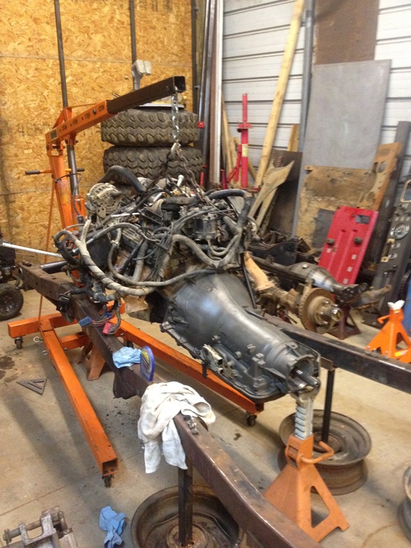

last night I put new tranny on back of engine, modified mount for dana 300 got engine and tranny pretty close to where I want them, now need to make mounts tonight..and then hang dana 300 on back of it all.

Switched to Chevy 95 350 with auto behind it and Dana 300
A few suggestions, though Im sure you are aware of them...
- to get it as low as possible, I suggest putting the front axle, tcase & driveshaft in place, or atleast a proper replica. This will allow you to shift the drivetrain around some to make sure everything clears
- also recommend putting another crossmember between the frame rails before sitting the drivetrain weight on them... might want to push them apart some. stock tcase mount might be a quick fix for this until your finalize tranny/tcase mounting
