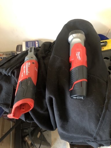

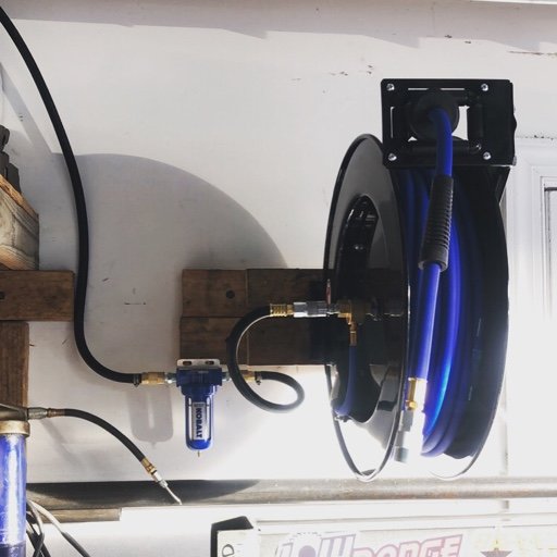

Got my hose reel mounted, and I’ve gotta head back to Lowes, I’m out of Teflon tape. Plasma works but I’m gonna switch the plug to 220v so I stop tripping my breaker for the garage receptacles, the compressor runs off 110. I can deal with unplugging the welder and plugging the plasma in for cutting. I know that dryer isn’t going to catch all the moister so I’ll likely have to drain the tank once a month or so but it’s there and seems to already caught a little moisture.

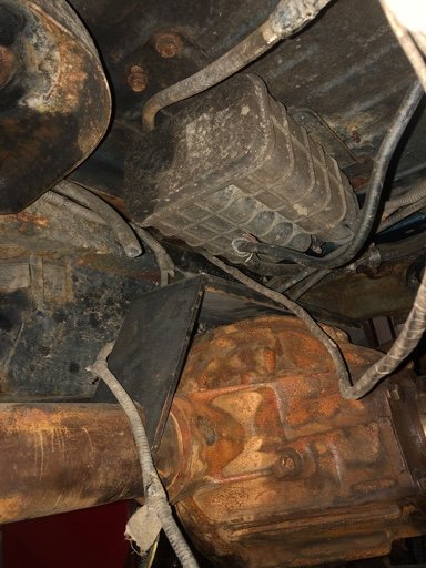

So far I’m happy with these, plus I like my Milwaukee tools. I’ll keep cleaning up the garage tonight and I’m thinking tomorrow I’ll tear down the 14 bolt and start putting the gears and Detroit in it.
Also got a traction bar setup minus the DOM for the rear. Gonna look at doing a small truss just to tie the tubes together, and I’ve got a pinion support I’d like to make it tie into the truss. Then build my track bar off of that, not only to be strong and tie the traction bar into both tubes, but also so it doesn’t see a bunch of misalignment in the joints/bushings with it being more center mounted. Sounds good in theory, no telling if it will help.
I’ve got some 60 housings in the garage that I need to clean up, I figured I’d just build one, and swap it under the k5 instead of fighting setting up the gears on a creeper. Been feeling pretty old lately with my back giving me more trouble. So it’s a lot easier setting them up on my axle stand.

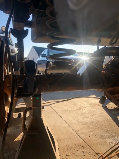

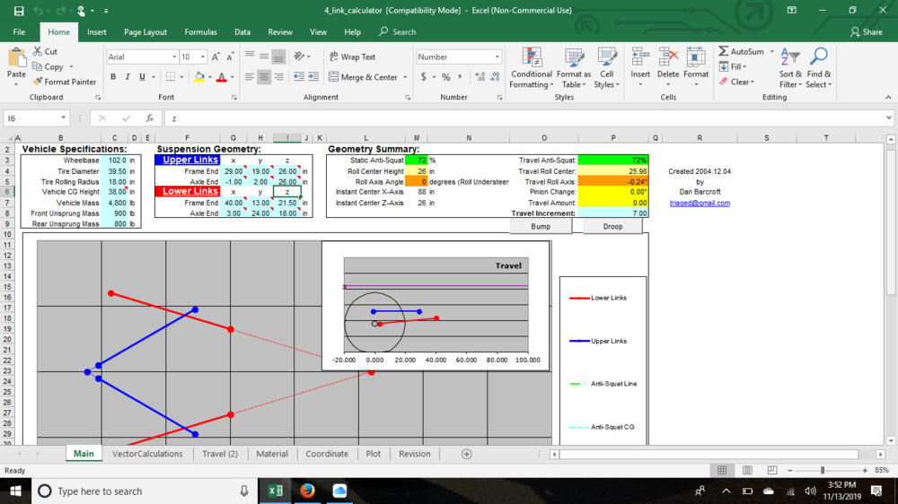

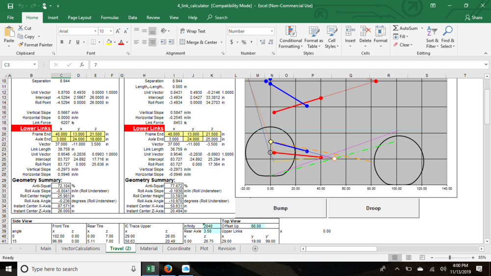

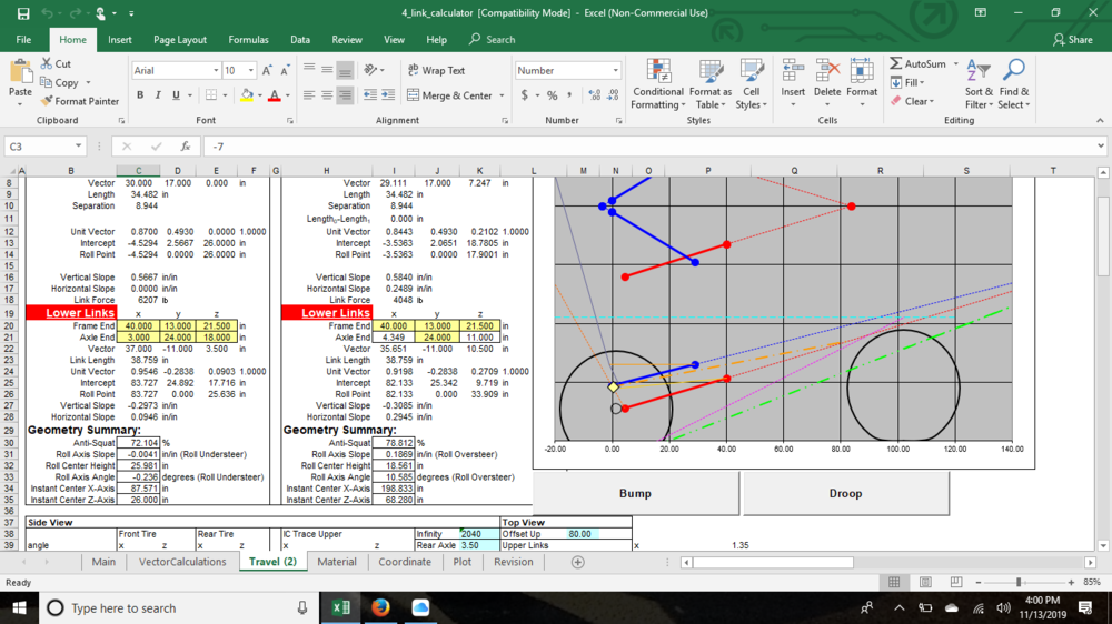

So I started measuring and plotting the 4 link for the JK today. Found a few things I'm going to have to cut out to make my upper links fit. Mainly some floor supports I may have to cut into the floor a little bit, but I'll make a patch panel to cover the upper link mounts. This is based of a belly height of 20 inches, I feel I can maintain 7 inches of uptravel and 7 inches of down travel. I know I'll have to cut fenders when I finally get some 39.5s or 42 TSLs for it. I also plotted it based on a 36" height to compensate for aired down and offroad. Full bump and full droop its 78% anti squat, and 72% at ride height. I'm still learning this stuff so if you see anything out of wack or have any suggestions I'm all ears. Here are the screen shots of what Ive plotted so far.
full bump:
at ride height:
full droop:
Area of the floor that will need clearance
Clamped brackets in place just to pull a tape of them and see where about my links will end up after seeing the lengths on the calculator.

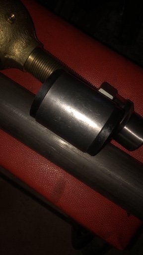

Gonna run enduro joints at one end and bushings at the other
Mainly because I’m Jewish and I figured when I either build myself a fuel tank after I learn to TIG weld I’ll look into adding enduro joints in place of the bushings so I can also stretch the rear another 4” that way. I’ve thought about sleeving the lowers with some 1.5 x.120 wall DOM, mainly Bc I’ve got some laying around. It would likely be complete overkill though.
Tweaked my numbers in the calculator some more last night. I feel pretty happy with how it will be and 3 adjustment holes for the uppers will in theory help if I go wheeling out west and need less bite, or if it’s slick as eel shit I can up the anti squat if needed to get more bite.

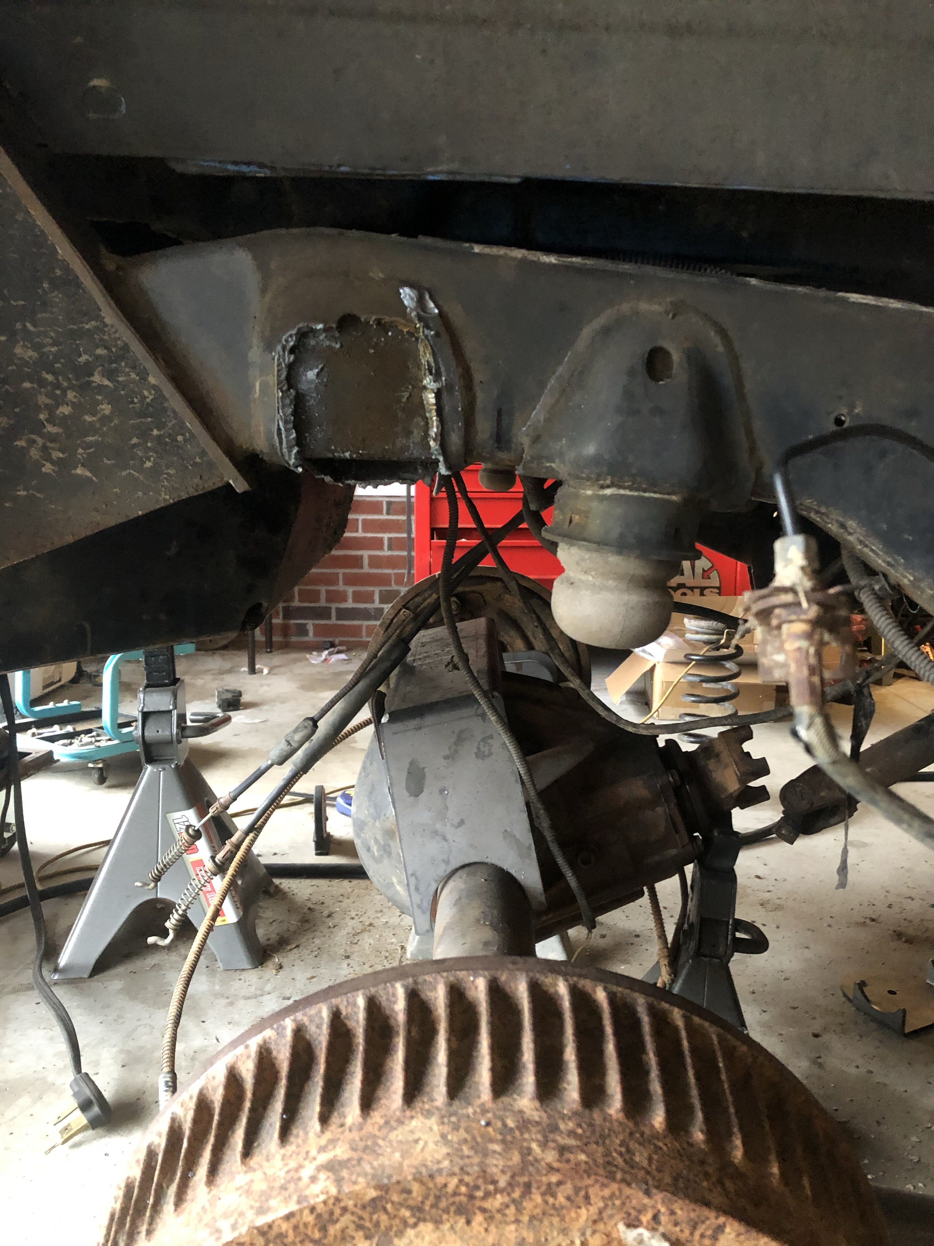

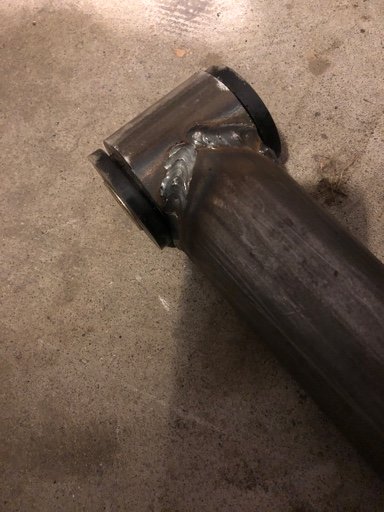

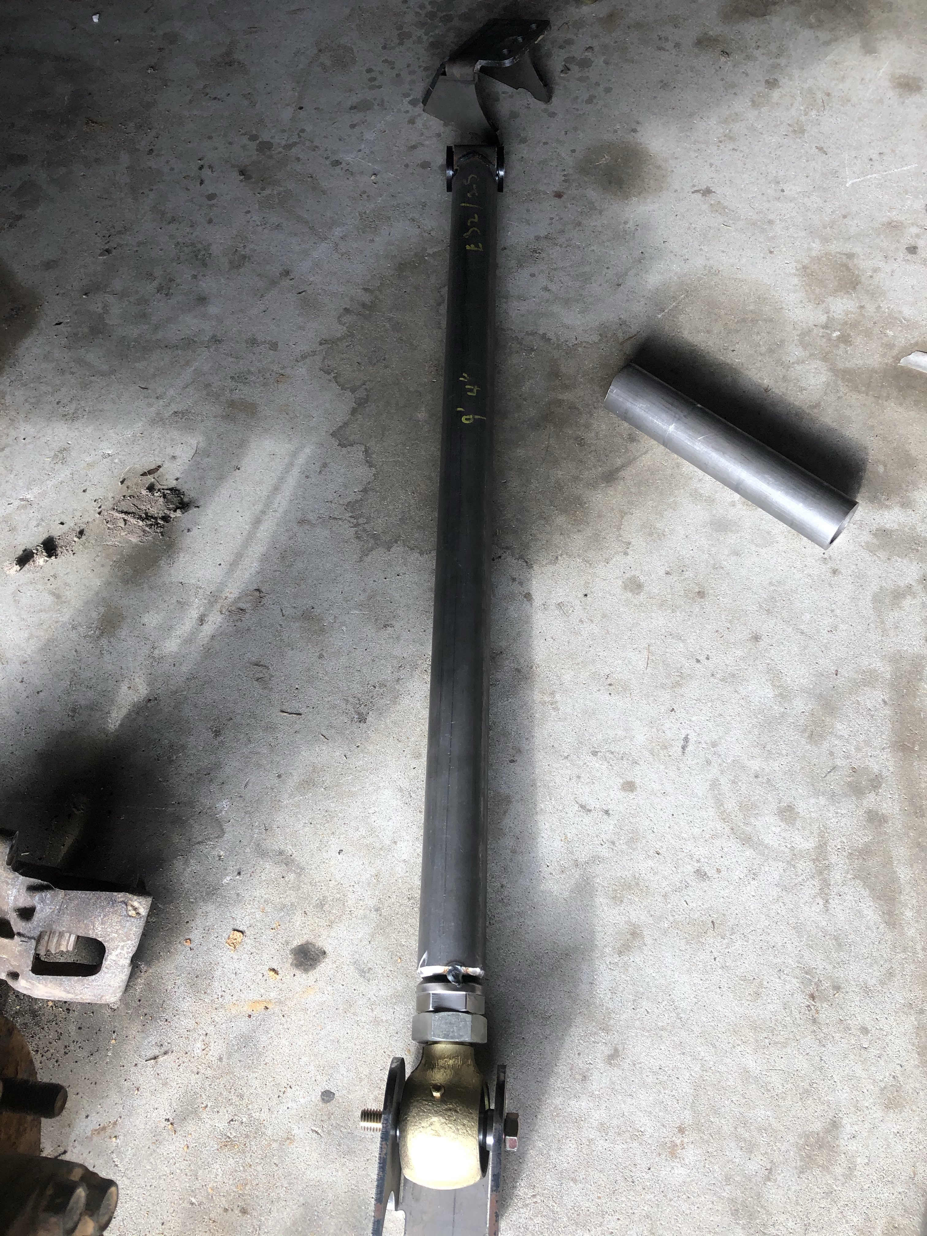

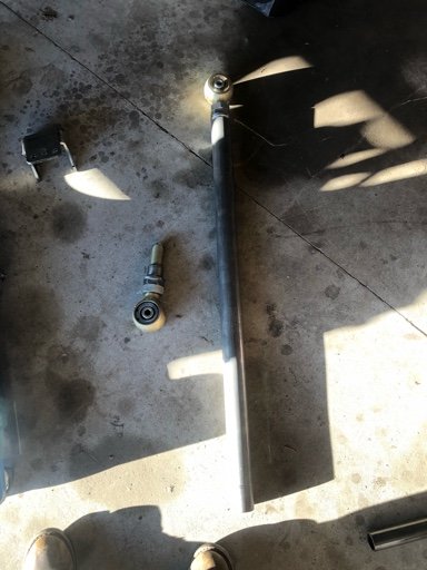

Made one of my lower links, just tack welded the bung for right now till I verify all my crap will clear. Got the DOM cut for my uppers and the barrels cut so I can make my bushing ends. Realized my harbor freight chop saw sucks a big fat one so it was easier cutting it with a cutoff wheel. Also my POS notcher can’t handle 2” DOM, so learnt myself the chopsaw method, which turned into chop saw scoring and finishing with the cutoff wheel of notching tube.

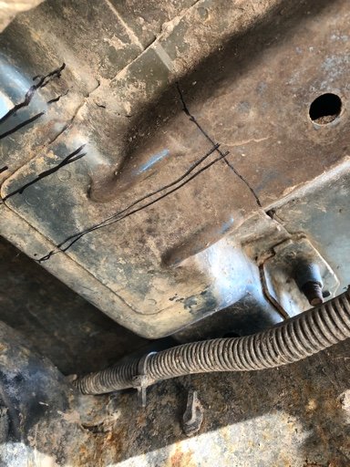

It’s official, no more rear track bar. Glad I finally bought a plasma cutter. Even if this ain’t the fanciest one, sure beats the black lung from using nothing but cutoff wheels and sawzall like I have for the last 6 years.
With the axle pushed back 2 1/2” I’ll be 2” from the factory bumpstop at full stuff. And just so happens the lower link mount will be fortified with a bumpstop pad and eventually I’d like to run coilovers and hydro bumps out back. But not in the budget for this phase.
I’ll have to relocate my relocated evap canister to clear upper link mounts. I only threw this truss up there because I had it in the garage. I’m planning on building my own and hopefully it’ll be kinda nifty.

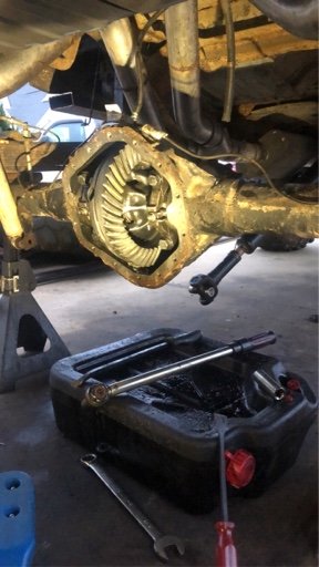

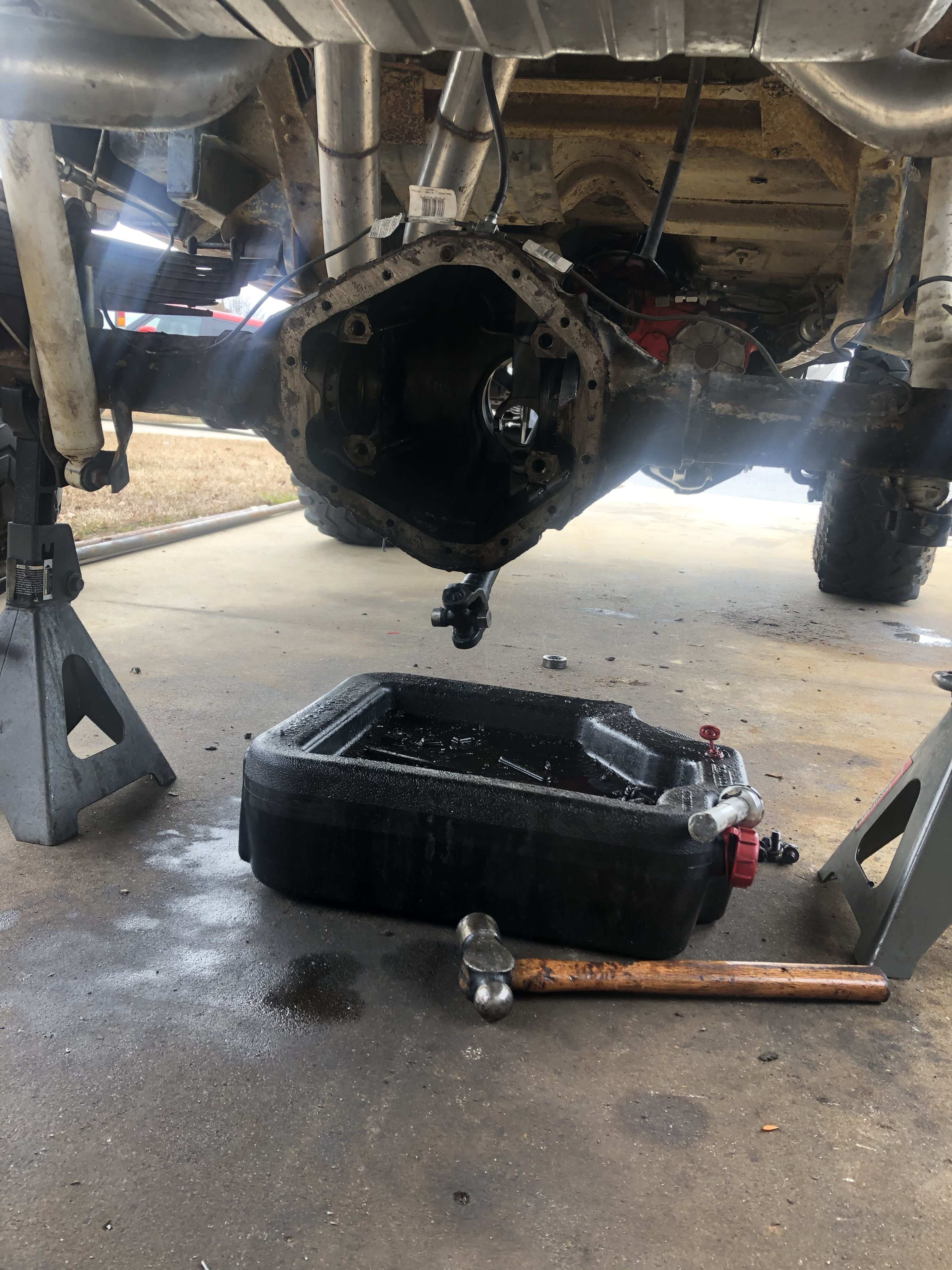

I put a diff cover on the k5 before I took it wheeling in April/May. It was dark out and I was on day 4 or 5 of a 2 week thrash session working 18-20hrs a day on it to get it ready. Well I guess I missed the fact it’s got a g80. Thankfully I’ve got another 14 bolt in my garage so I robbed the open carrier out of it to slap my Detroit in it.

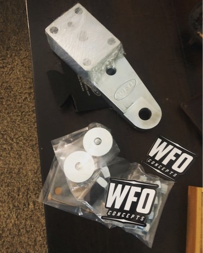

Oh and new goodies just arrived from WFO. I started using their products when I was stationed out in Cali, and honestly its good quality and I know the pitman arm and steering arm were the correct lengths. I went with springless to see how they are on the street, still the stock style bushings. Wasn’t too sure how the bronze ones would be over kill. I just need to get the housing on the axle stand and get it cleaned up and painted today. Then we can see what kind of shit pattern I can make. I’ll get a picture of this one so I can be judged.

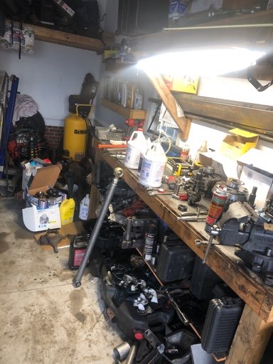

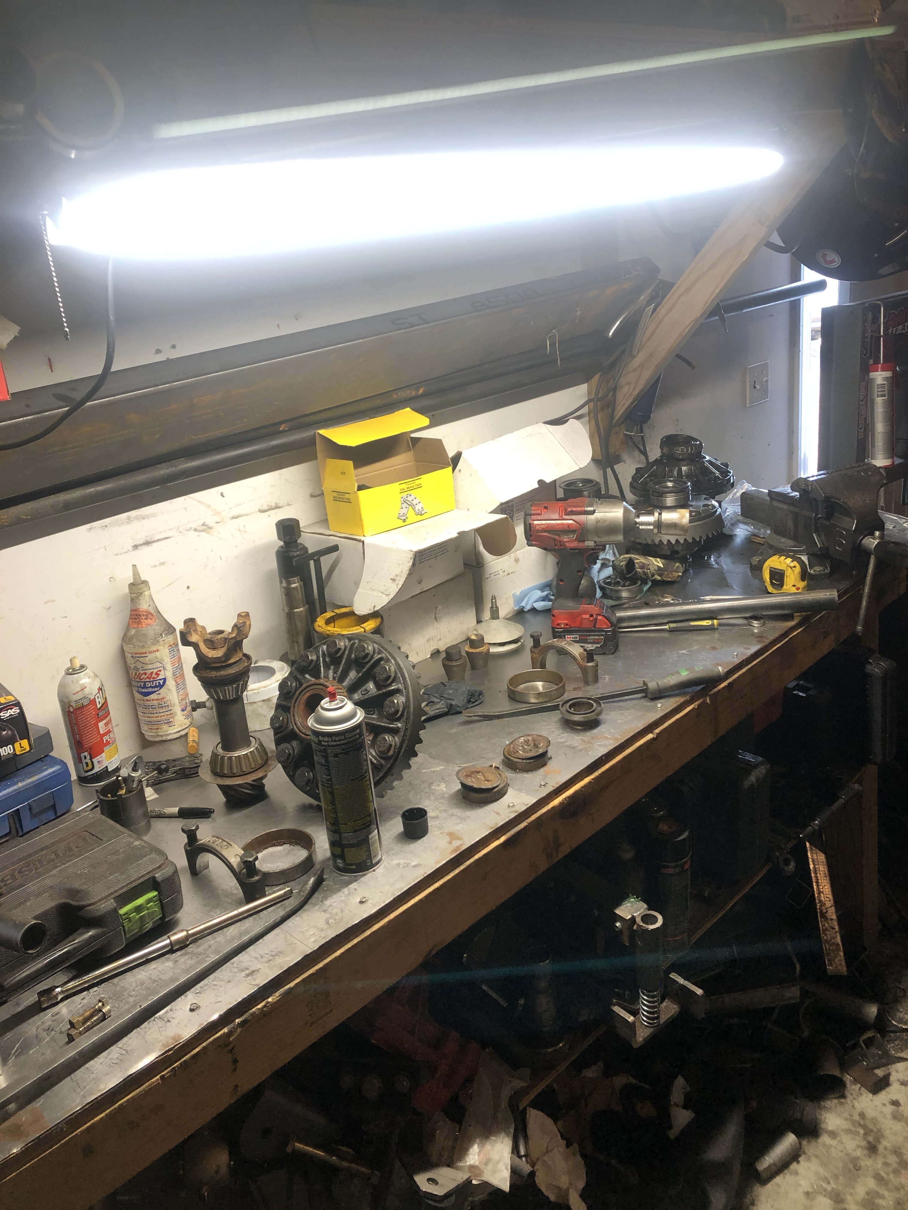

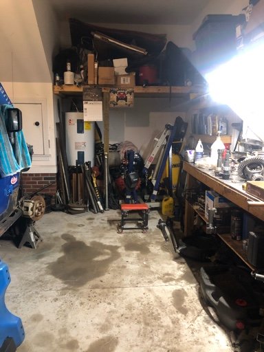

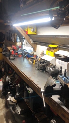

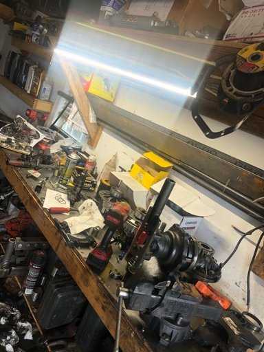

No matter how big or small the project, every time my work bench ends up in a cluster.
If I would finally get those caddy calipers on the 14 bolt under the Jeep and swap them on the back of the k5 I could create more space.

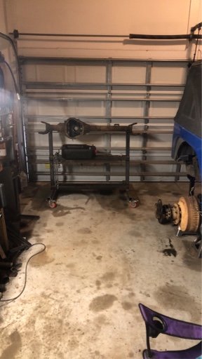

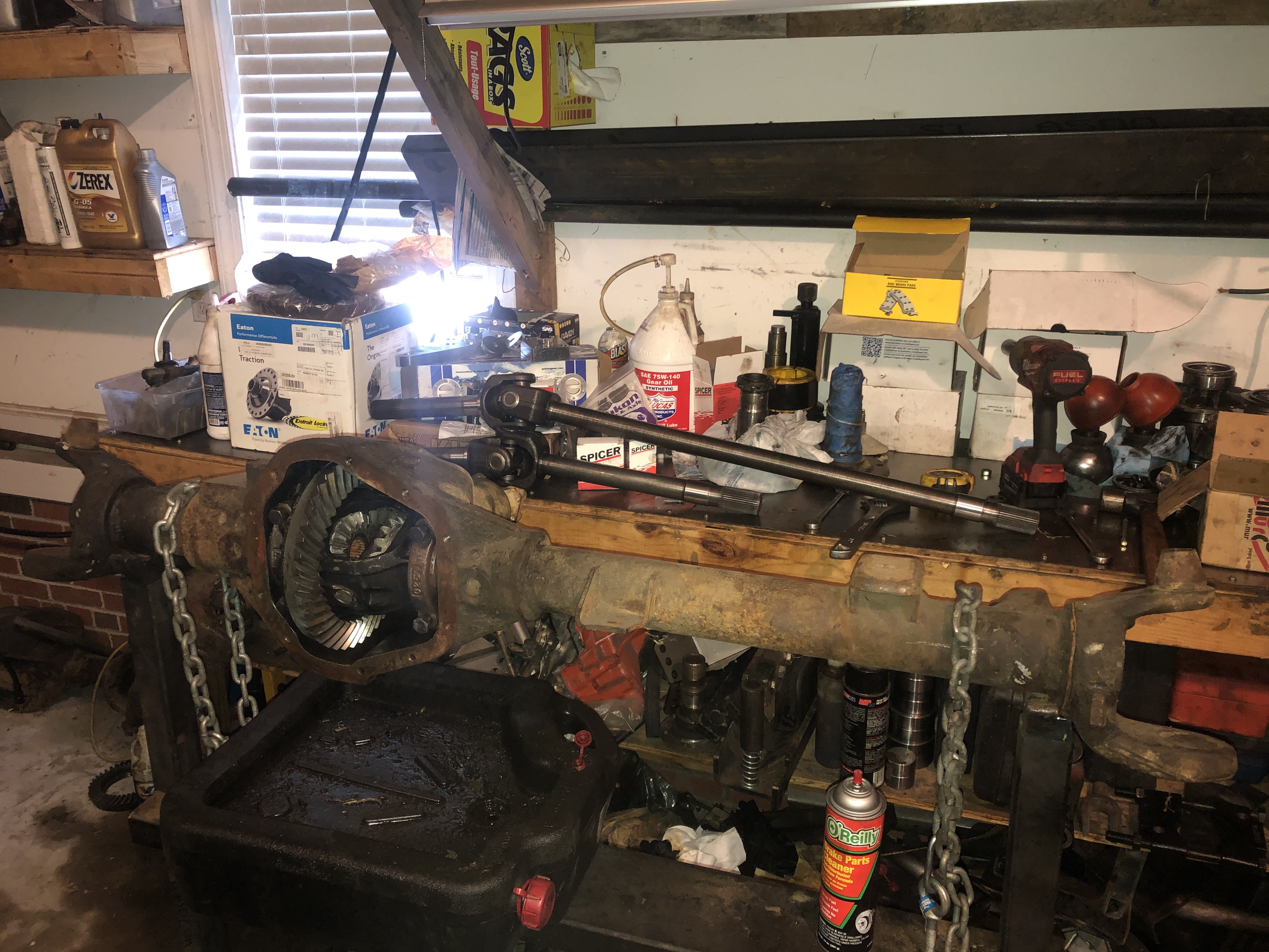

Cleaned up some to get all my parts gathered up from their various storage places in the garage. Need to just put the housing on the axle stand so I can wire wheel it, clean it inside and out, paint it, then 5.38 gears, USA standard rebuild kit, Detroit locker, 4340 Yukon shafts, spicer Forged non greasable joints with full circle clips, WFO springless arms, spicer king pin rebuild kits, new spindle bushings, some used spindles from a member on here, and some used knuckles I’ve got laying around. I’ll have to swap over my lug nut 4x4 3/4 ton brake setup and my SRW hubs. I’ve got some Yukon hardcore hubs since the stubs are now going to be 35 spline. I’m planning on upgrading the u joints once I got to 40s or 42s. Figured I was safe on 38s but I sure need to get a 1410 slip yoke for the rear driveshaft, that way I can ditch those straps and bolts and get a 1410 u joint with u bolts.

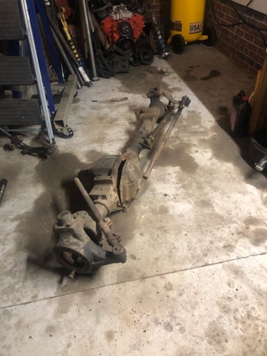

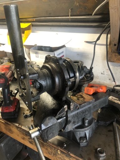

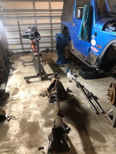

Got the 60 on the axle stand today, so I could start the tear down

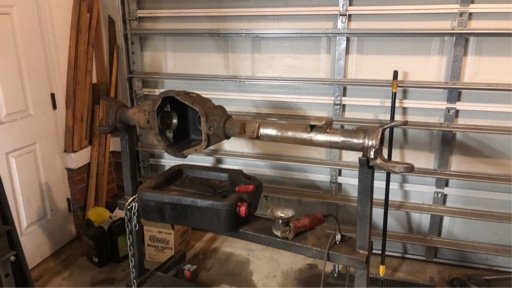

Everything came apart great. Need to clean the tubes out and I’ll throw a stock 60 cover on it, then start wire wheeling the housing to clean it up. If I can get it painted tomorrow and start reassembly I’ll be stoked. Thursday afternoon I’m getting the k5 tuned again. Took the step up box for the speedo cable off. Reading 60 at 55mph so not too bad. Cruises great around 60mph. Doesn’t feel like it has to try hard to propel the k5 down the road at all. If you let off the throttle hard it’ll change lanes from the Detroit unlocking but it’s easy to anticipate.
Overall pretty stoked I’ll finally have lockers front and rear and be able to wheel it pretty decent. Still need to finish up my mini boatsides and relocate my battery to the back. Then I can do my inner fenders, even though I can’t decide if I want to do those without doing then front clip portion of the cage first.
I made a little more progress on getting the housing cleaned up, got side tracked when my gf kept wanting to help in the garage. Which just turned into me cleaning up the garage, putting a scary amount of stuff on my storage area and organizing my under table storage better. I am wanting to change my layout some in my garage to make better use of space. But it’s gonna have to incorporate an axle stand, and I need to get rid of some junk or make some parts find their way into a project vehicle. But anyway here are a few pictures
Got most the bulky stuff off, probably have another hour or two with a wire wheel tomorrow then I’ll clean it up with some acetone best I can. Hopefully I can get some paint on it tomorrow and it’ll dry so I can assemble it tomorrow night.

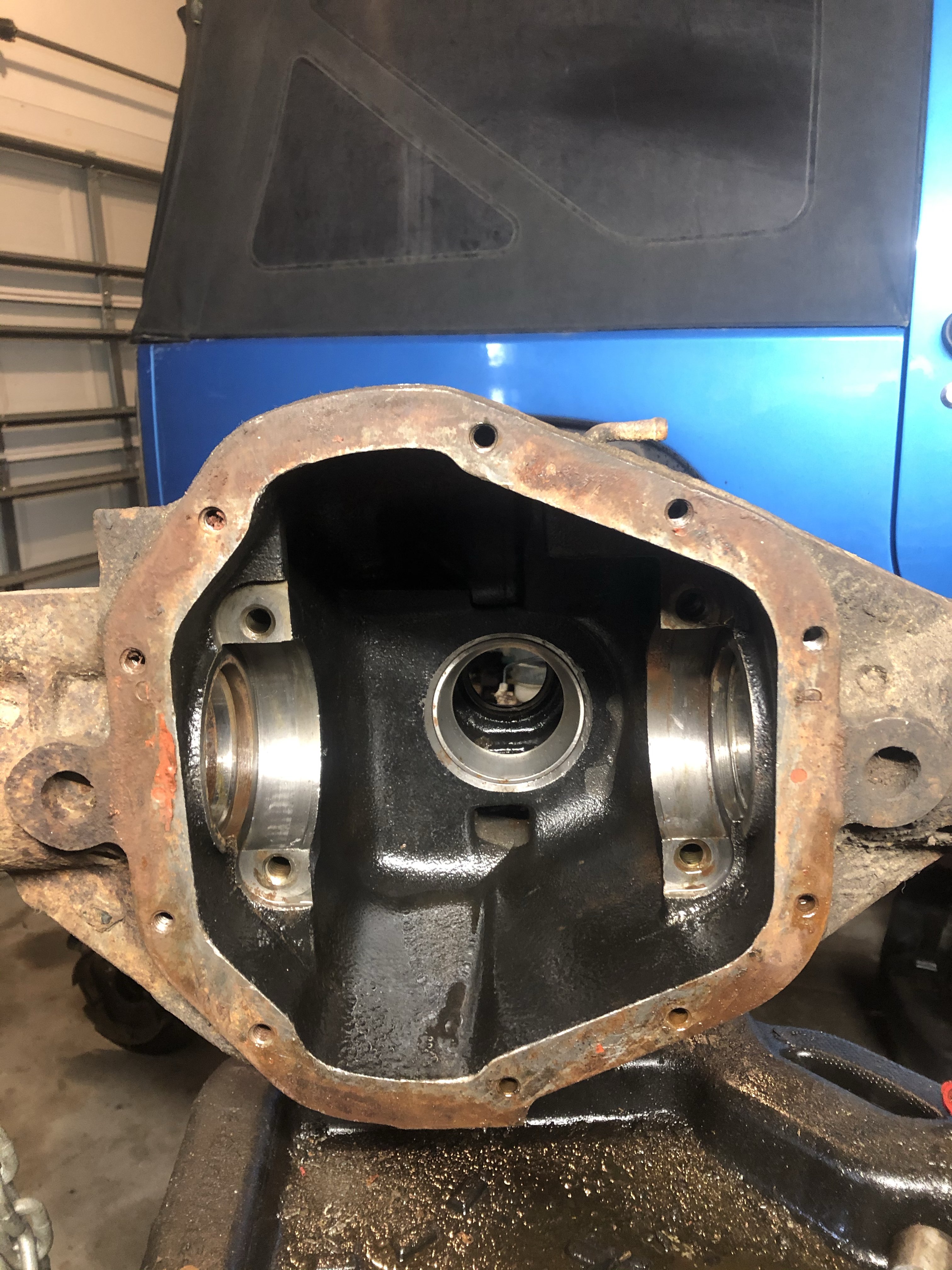

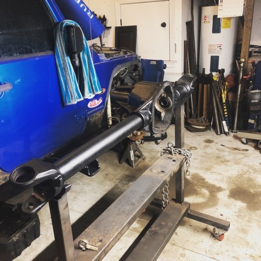

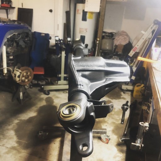

Got the housing pretty cleaned up and painted. Waiting for it to all dry and I’ll be starting the reassembly tomorrow most likely. Tuner canceled on me and wanted to reschedule for Sunday. I’m hoping I can have this axle built before then, get the tune mid day, then swap the axle in that afternoon. Then hop back in the mini boat sides before the clubs “crawl in”. Havent made it to the last few for various reasons.

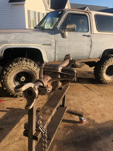

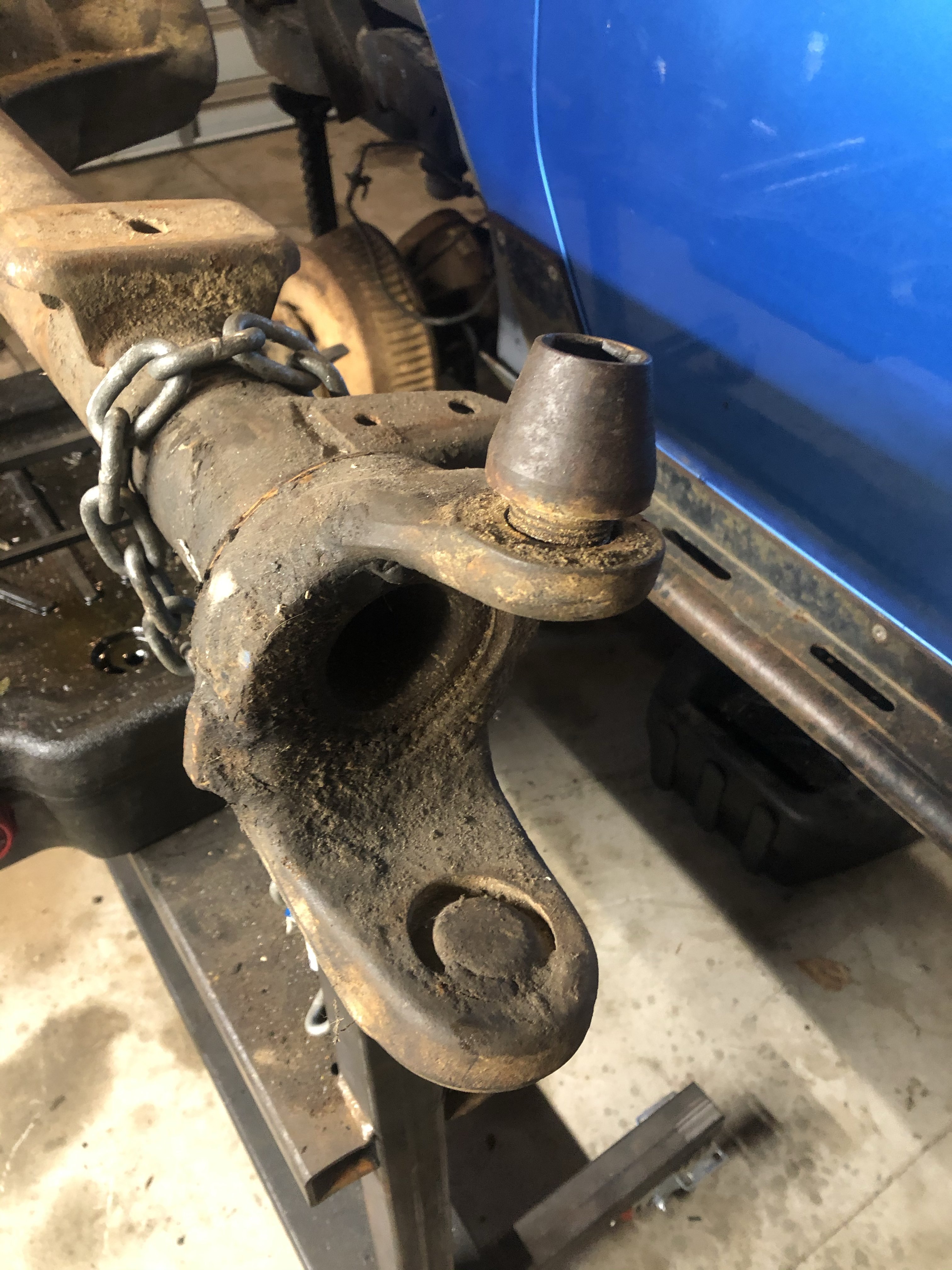

Had to rob the knuckles off this asshole. Had to beat it off, I even used both hands.
Got the lower kingpins together. Nice little paint run too, that’s the bottom though. So screw it. I’m debating on ordering up some knuckle gussets. $50 and some time ain’t too bad. Or I can stare at some for a bit and get some flat stock and make my own instead of being a lazy ass. I can’t justify Reid’s yet. That’s $600 in knuckles. I’m not planning on wrinkling it like a tin can. But one weekend I feel like beating off my knuckles, with both hands, I’ll throw them in the oven to piss of my ginger girlfriend.
