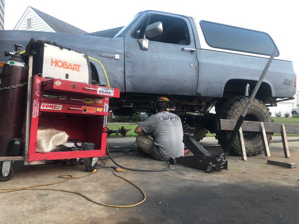

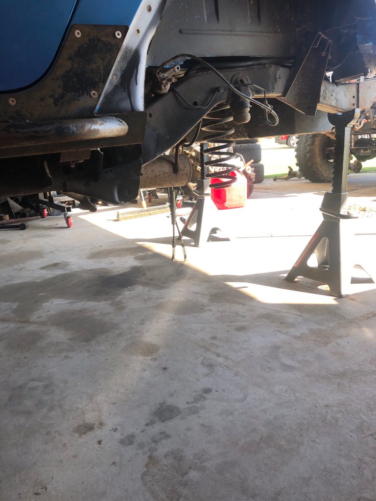

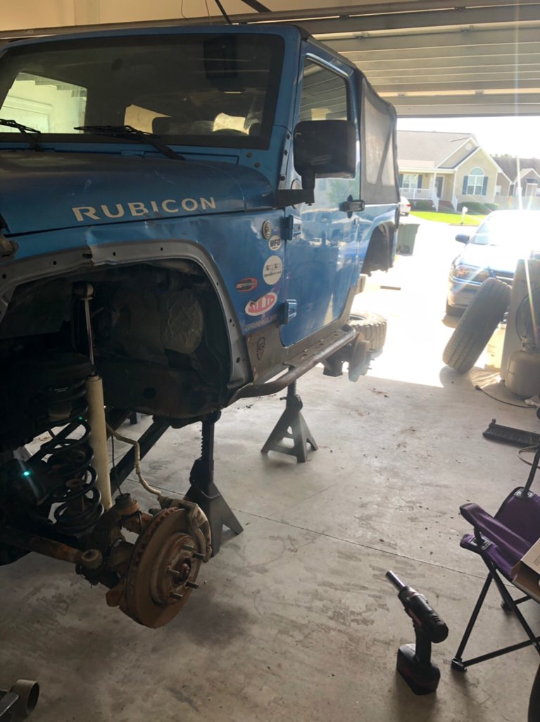

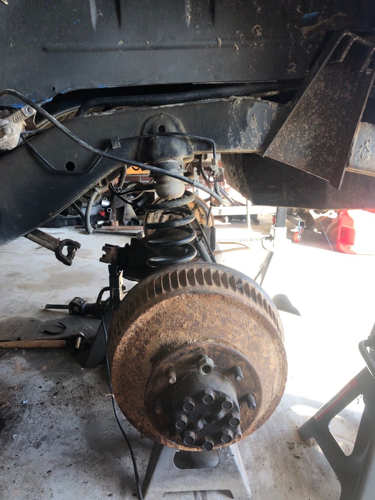

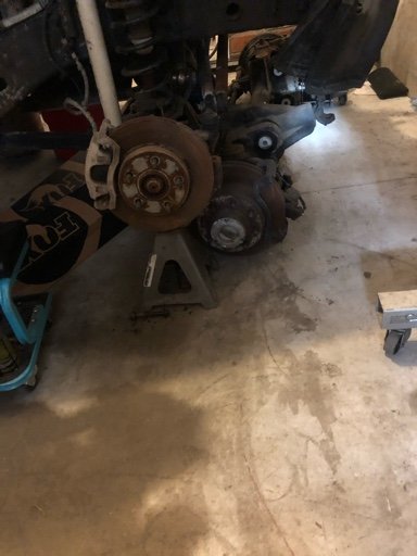

Got the JK in the garage this afternoon. It’s full on hover Jeep right now with all the suspension bolts soaking with PB blaster on them. I’m gonna go ahead and pull both axles tomorrow and start regearing the rear.
But I’m this weekend I hope you to start my mini boat sides on the k5
Well the JK is LT Dan’n it now.

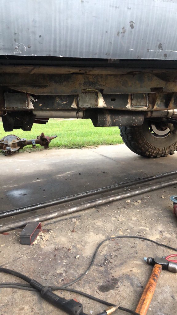

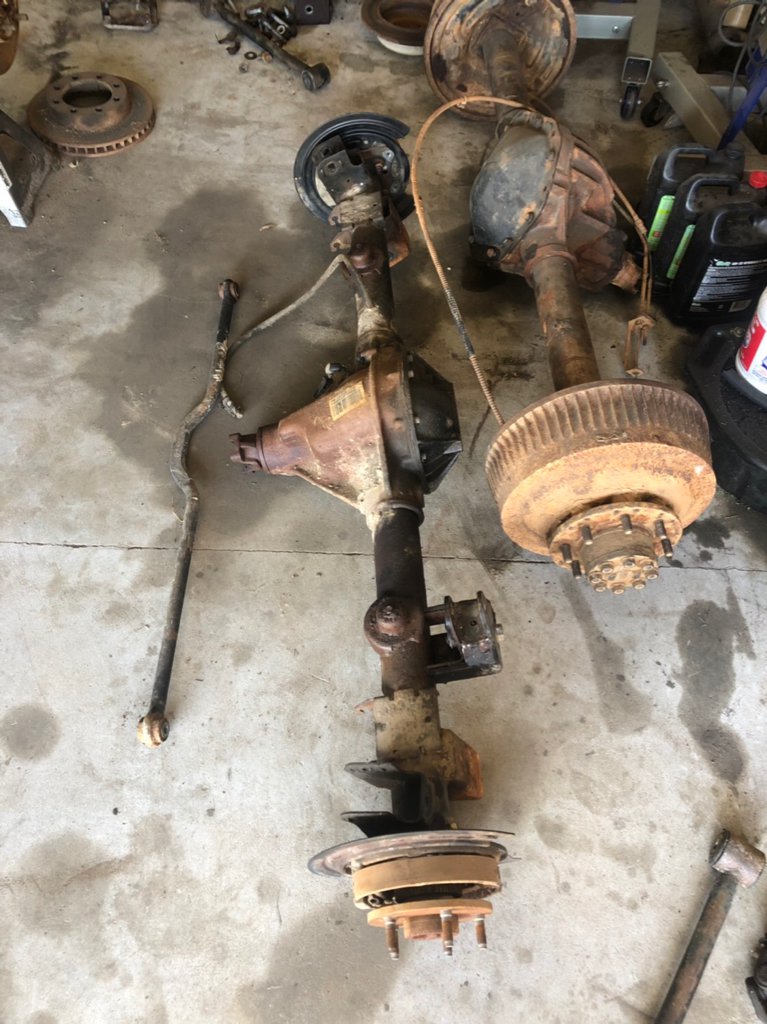

Two things in this photo are definitely not going back in it. Can’t wait to be on team no rear track bar.
And eyeballing it, looks like I can push the rear back between 2 and 3 inches with just a factory TJ tank. Seems that my educated guess was correct that if I wanted to use a gen right stretch tank I could push it back much further. Maybe Santa will bring me one.

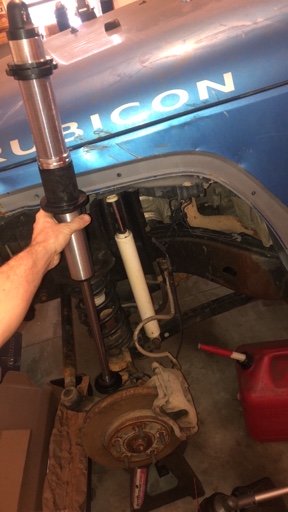

I think I talked myself into cutting out those rear frenched shock towers and building taller ones for more uptravel. I’ve got some 14” stroke Fox 2.0 smooth body’s that Are suppose to go to the k5. But since I’m going coilover up front and the mounting widths are the same. I may go ahead and set it up with the clearance that if I want to bolt in some coilovers when I’m ready. Hopefully it’ll be a smooth transition.

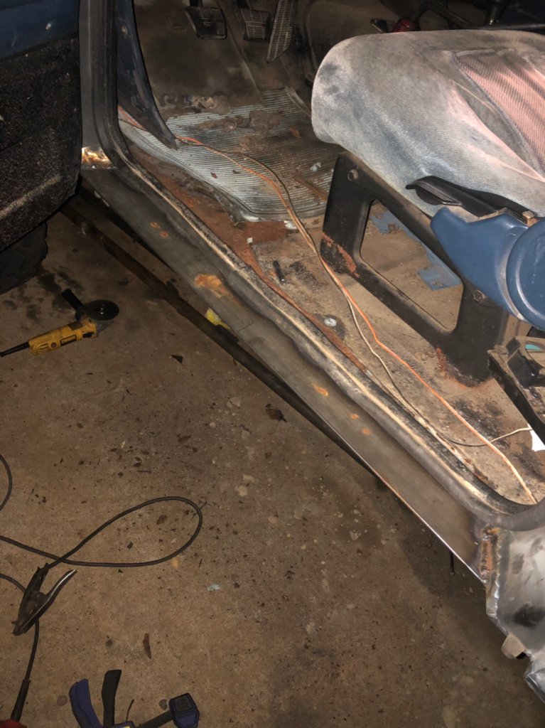

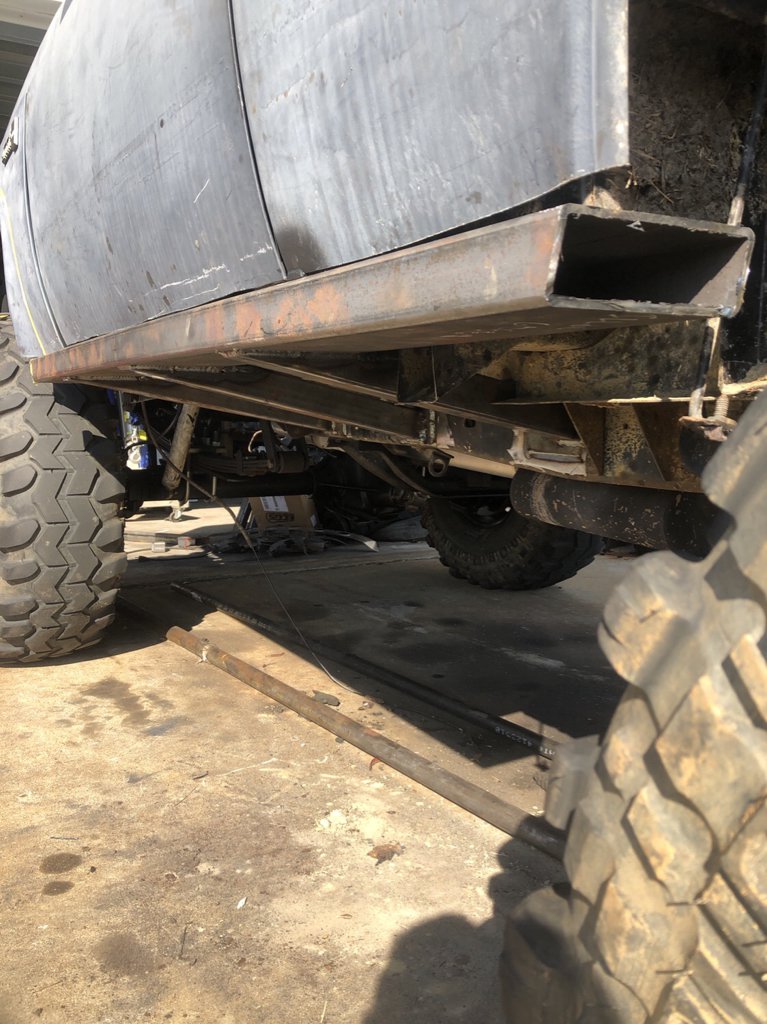

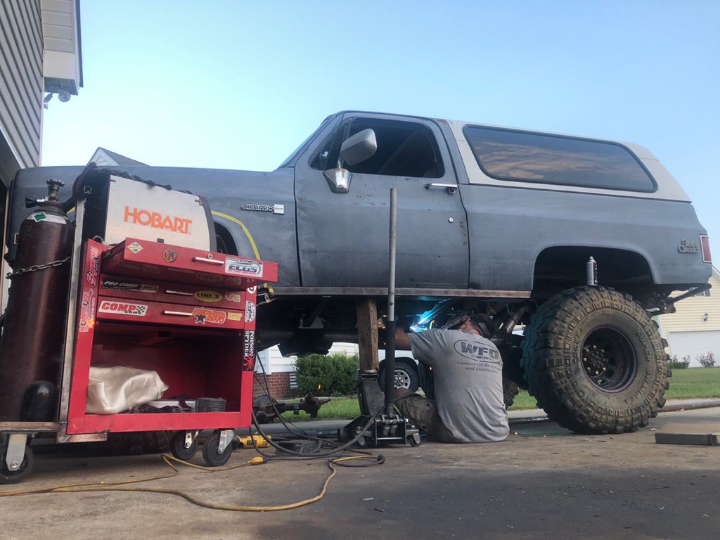

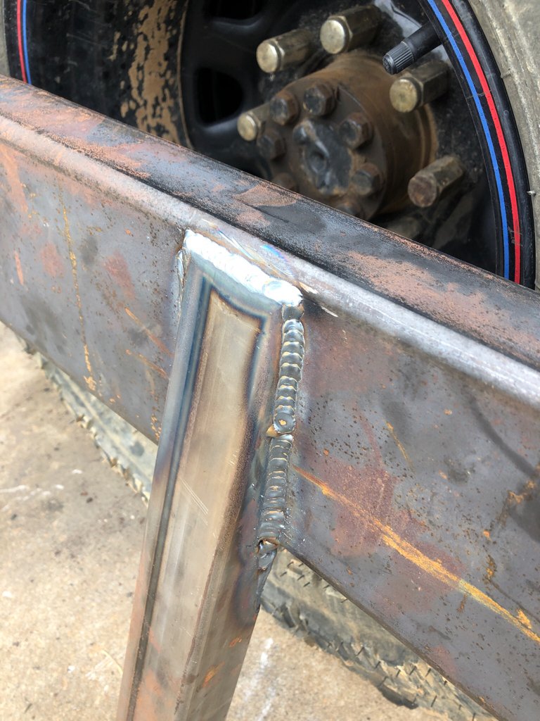

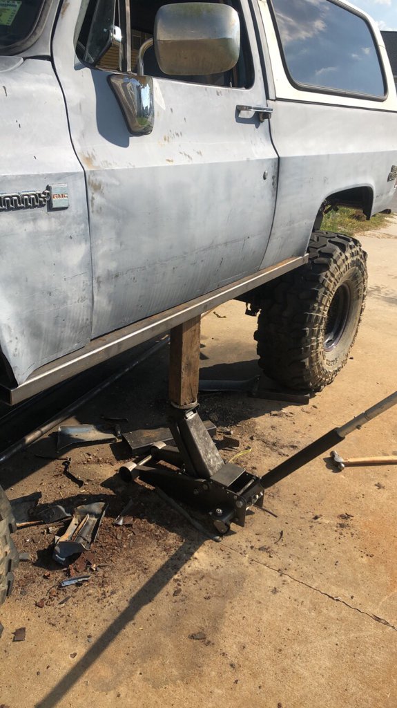

Started about 2 hours ago. Taking a break for lunch then I’ll see if I can finish this rocker up today and start cutting the other side. If I can get my patch panels made up real quick and get these 2x6 rockers mounted solid to the frame this weekend I’ll be happy.

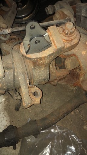

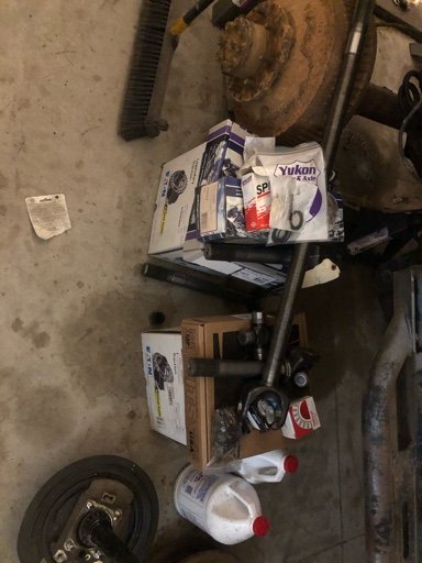

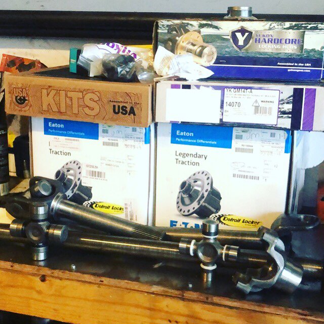

Waiting on my long side chromoly shaft. Found a Detroit on amazon for $458 brand new for the 60 front. I couldn’t beat that so I said screw it. I’ve still got to decide if I want to try a Detroit or grizzly locker out back. I’m hoping to do the gears/front locker/shafts on Sunday/Monday. I got hooked up with my tuner. It runs smoother now, still needs some tweaking mainly calibrate the MAF and he wants to tinker with power enrichment mode because with a normal 5.3 tune it’s driven different with a 4L60 behind it and it’s not even used like with the cars.

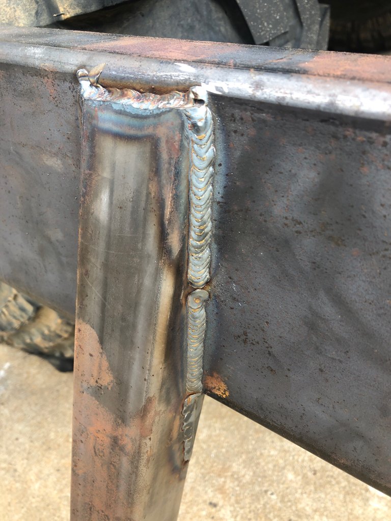

I think these tied into the frame in 4 supports of 2x2 .120 wall. Should be plenty, but I wanna build that 1.75 x.188 wall slider.

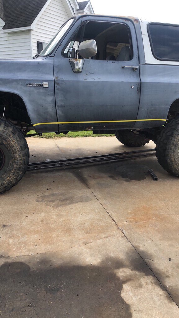

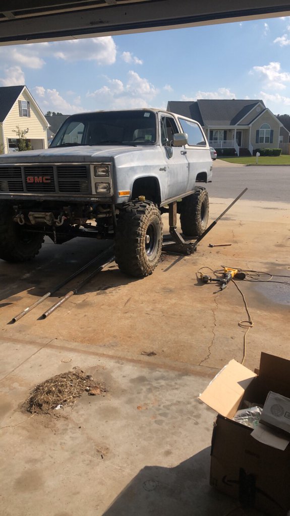

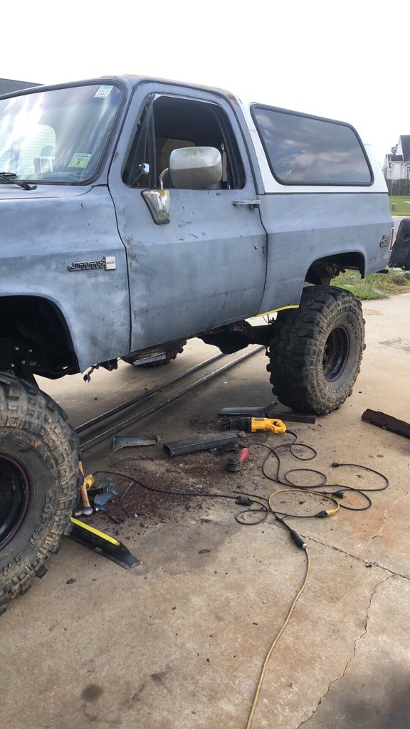

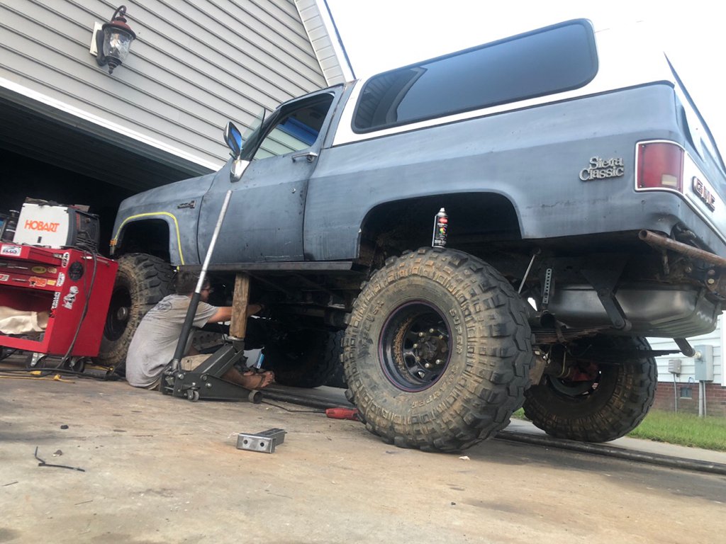

Neighbor looked at me funny when I took a sawzall to the side of the k5
Making a few gussets and also gonna cap off the body separate from the new slider. I’ll start on the other side tomorrow. I need to hurry up and get this knocked out so I can move onto other things.

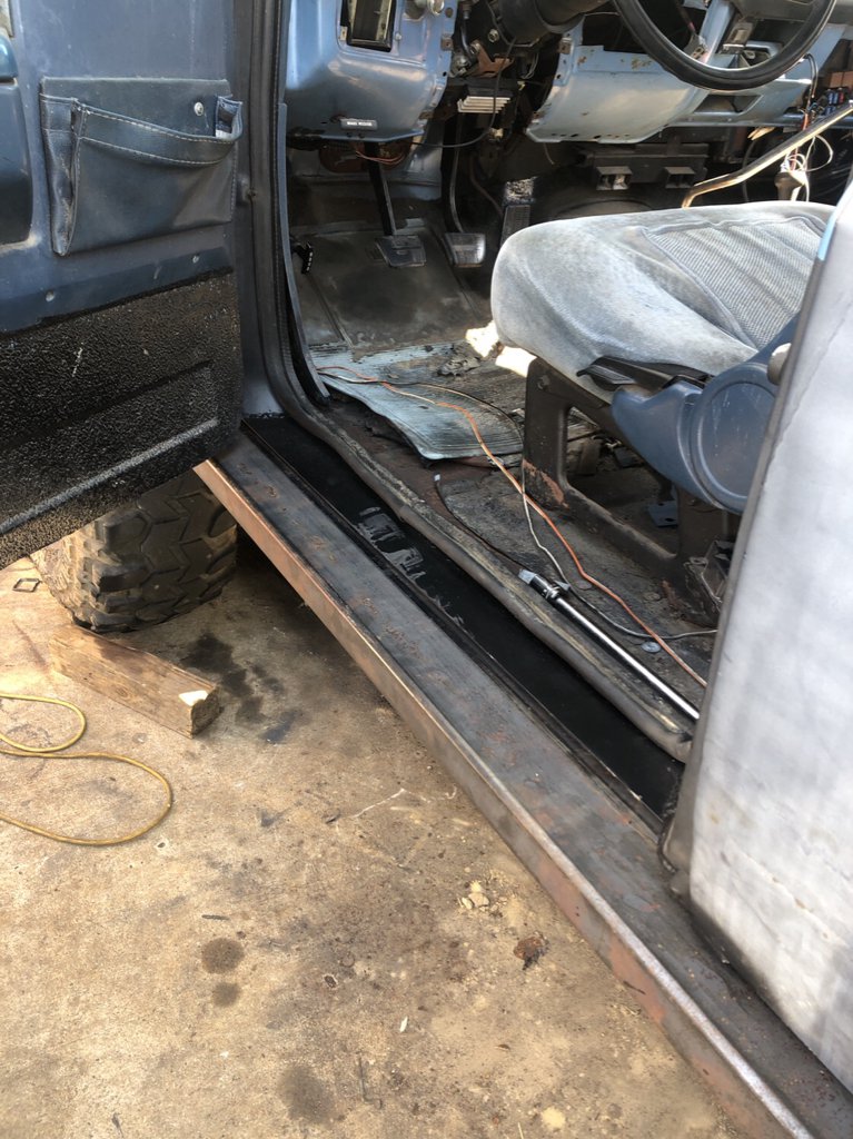

Started building some new sill plates and redo the weather striping channel. Well it looks cool there but sucks balls being 22ga. So just went and picked up some 1/8” I’m gonna do basically the same thing. I’ll do the panel in the door out of 22ga. Even with the dimple dies it was no where near strong enough. So stand by for my 2nd swing at it. Hopefully I can finish this side today and move onto the other. Really feeling like I won’t be making my planning trip next weekend.

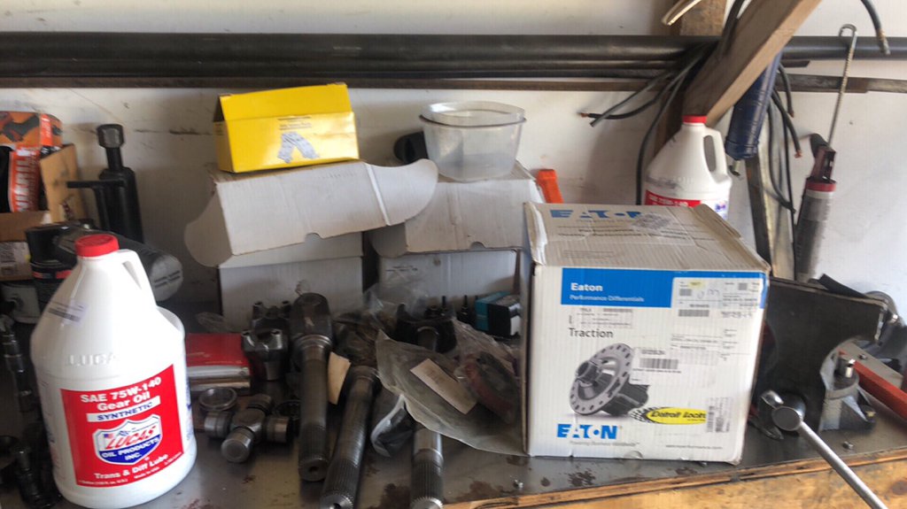

The rear Detroit showed up a little bit ago. So as soon as I finishing screwing around with these sliders I’ll jump onto gears and lockers along with some front chromoly shafts.
Okay much better. I’ll paint it tomorrow when I get done cutting the other side and welding in the sill plate. That side doesn’t have any rust at all so hopefully it’ll be less work. I need to cut out my mounting pads for the supports in the morning. I just don’t like working too late Bc I know neighbors have pain in the ass kids.

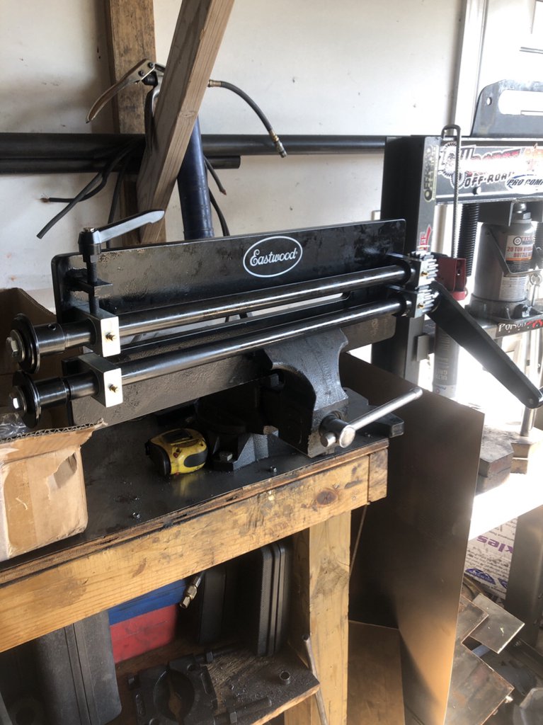

Well I got side tracked taking a dump after my coffee this morning and bought a beadroller.... didn’t go all fancy but got the Eastwood one. I know I’ll probably have to modify a few things but it’ll help when I do the inner fenders for the k5. And I can scratch that how the fu*k do they do it itch from seeing some of the build threads up here. found more rust I’ll have to deal with around the B pillar area. Kind of a bummer but oh well I got some sheetmetal I can form and stuff now to fix it. My creepy ass ginger girl friend took some pictures and a small video of me welding the frame plates for the slider. Was running out of gas so I’ll probably have to redo them. Or at least ground out a few of the welds Bc the wind kicked up and redo them. Still need to pick up some 1/4” 6061 or better aluminum plate to do my belly pan and now mini boat sides with. Got a bunch of counter sunk Allen head fasterners. To make it appear fancier than it is. Might even polish the aluminum for that mall rated stuff.

I’ve got to figure out a stand for my bead roller and sheet metal brake. Really it probably needs to be a welding table I can affix every one of those tools on or store under in shelves. Bending over welding on my knees and shit is getting old. I’m getting old, I need to change it up but need to empty out some left over parts and stuff first. So I’m debating on rebuilding a few extra axles to resell. JKd44 rubicon front, GM 60 front. I’ve thought about picking up an 8.8 building it up an offering it and the JK rubicon front as a package deal if I could get the 8.8 slightly wider through C clip eliminator and wheel spacer/adapter to correct the pattern. And gear them to 4.88s with an ARB nobody will buy for $500....

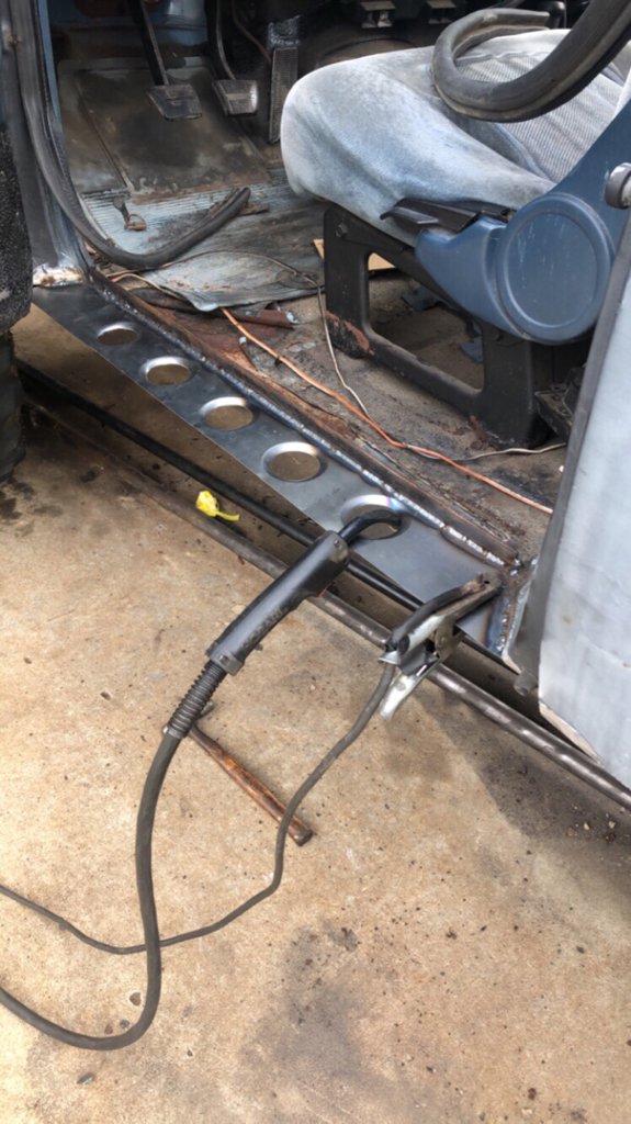

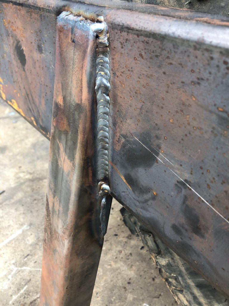

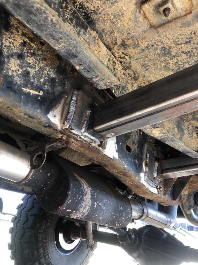

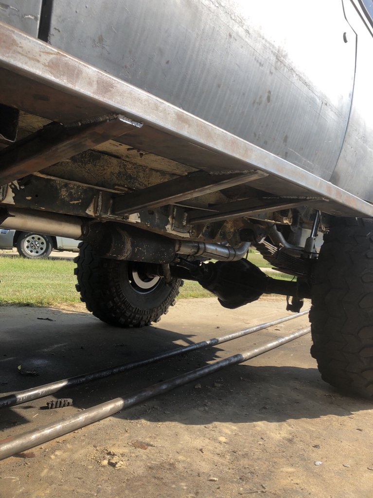

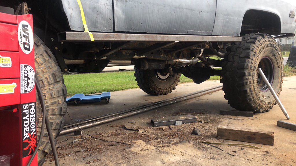

Got one side on. Need to still fur the supports down to the bottom of the frame. And I’m going to add to the frame to build it up and make a flat belly.
Forgot the pictures.
I also might add in 2 other supports on both sides because I can see the frame flexing some. Another reason I want to box it and gusset the shit out of everything. She’s a big heavy girl and it needs to be build accordingly.
I did get my bead roller in. Threw it together but need to go through and adjust things

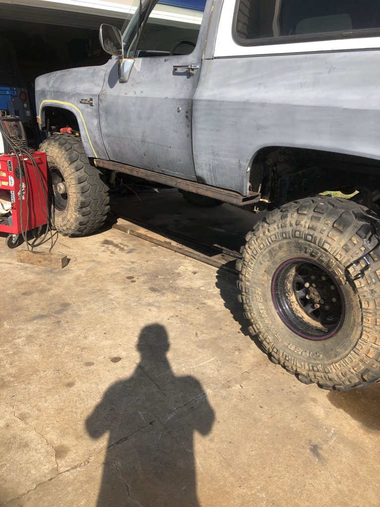

The rocker doesn’t look too bad now, but need to build a cap for the bottom of the door. I’ll probably use the 22ga sheetmetal I’ve got for it.

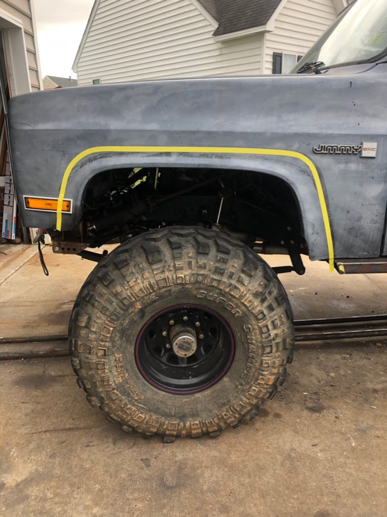

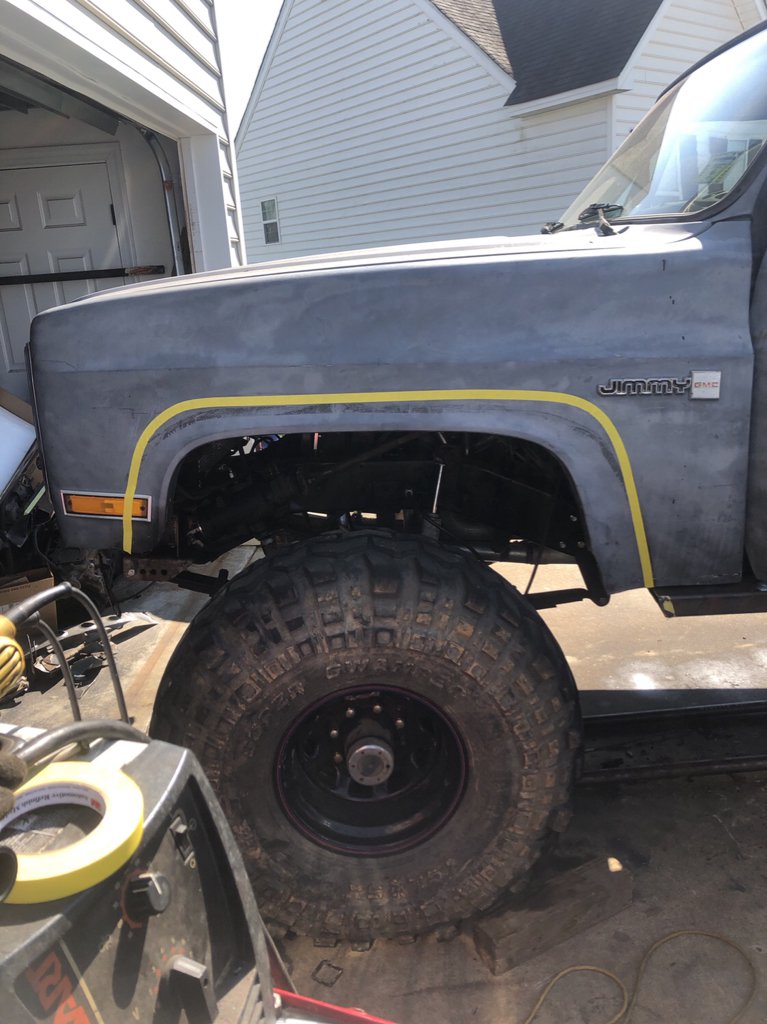

I’ve changed my cut line 3 times now. I think I’ve narrowed it down but we shall see. A lot of time between doing the rocker/slider, and doing both axles.
I haven’t decided what I will do with the side marker though. I could just delete them, or find a smaller light and graft it in. But I need that clearance just for full stuff with these. My original plan was to section the fender but I’ll save that for another set of fenders and do that. These have some rust in the bottoms of them. It’s my fault it sat with mud in the fenders for about 11 years or so.

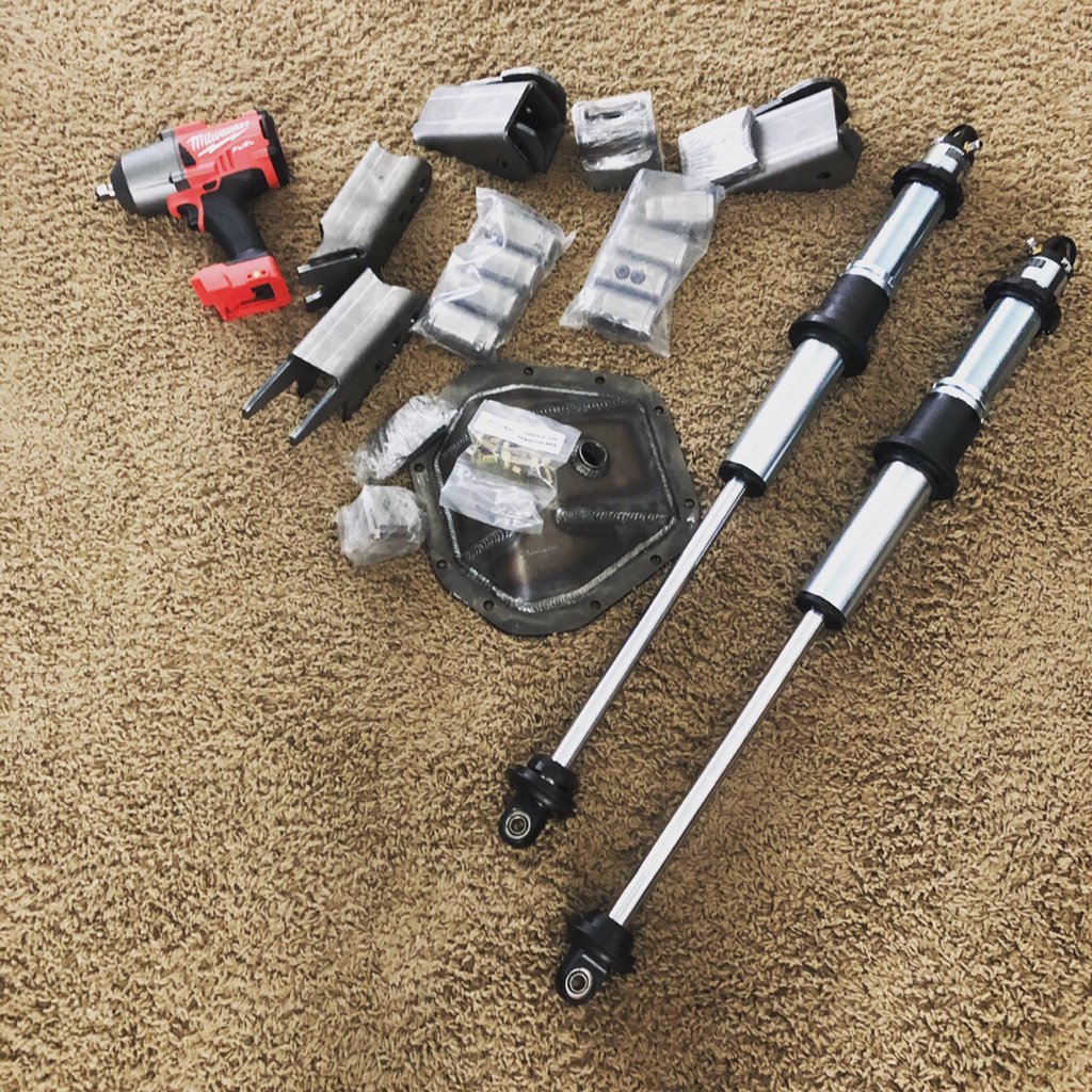

And I’ve got a bunch of stuff showing up this coming week for the JK. Oh and a few tools, I just couldn’t help it.
Got the passenger side rocker about out, it started raining maybe I’ll finish it later on this afternoon. The trifecta dropped off today’s offerings

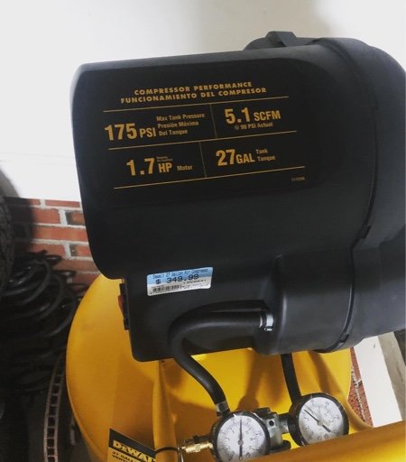

Picked me up a compressor and man it’s quiet, I wrestled it back there and had to move around some winter projects.

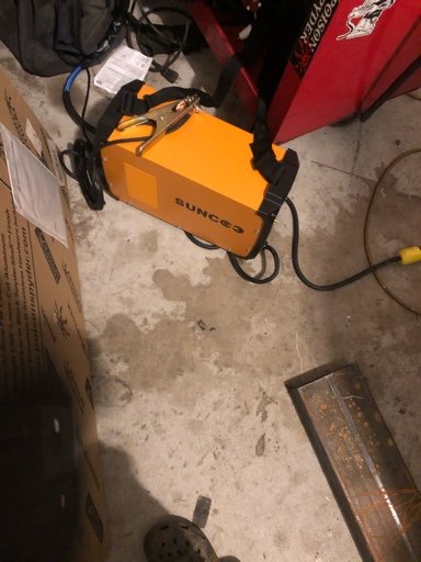

Picked up this cheap plasma cutter because a few people I’ve talked to have had good luck with them. I’ve got a lot of stuff I need to do and I’m just growing tired of the cutoff wheel life. Can run 110/220 bunch of consumables, haven’t ran it yet I’m setting up my hose reel.
Picked up a dryer and the plasma cutter came with a regulator/dryer with it.

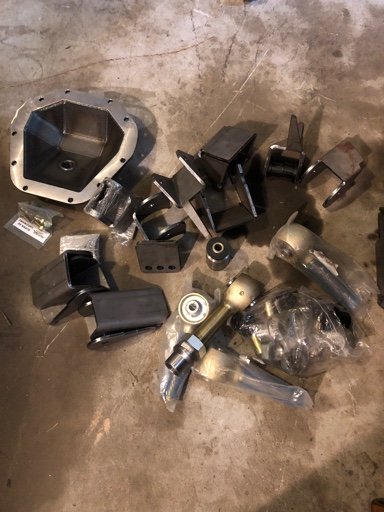

I’ve got the brackets for the lowers for the JK. I figured since I’m gonna build my own trusses I’ll just make the upper mounts integrated into the truss to make it look cool and be strong.

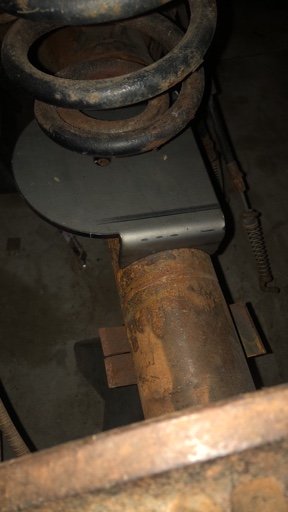

I decided I’m gonna mount the coilovers to the factory coil mounts on the front 05- up SD60. And if it’s technically under the Jeep does it make it a 1 ton swap? I want to see the tops of the shock hoops and coilovers through the hood. But I still want 6” of up travel minimum. So if the frame rails need to be modded, I’ll fire up the tubing bender and make some cool shit forward of the engine mounts.
