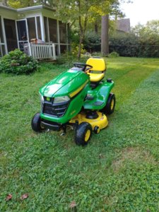

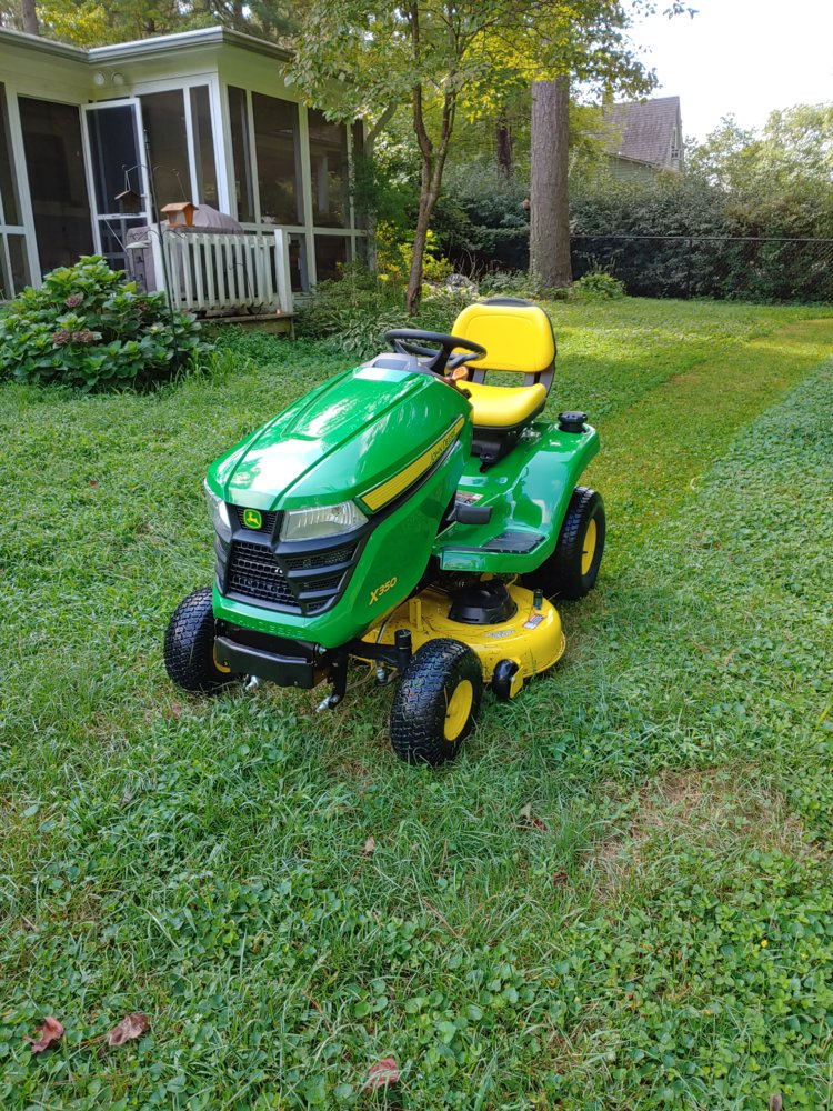

Christmas came early. They had a delivery fall through this morning and dropped it off today. I freaking LOVE this thing. Next on the list is a backpack leaf blower. Either a Stihl BR200 or 350 (it will be the 350 because I overbuy everything).
Now that I have this, I can finally start to get serious about having a nice lawn.
