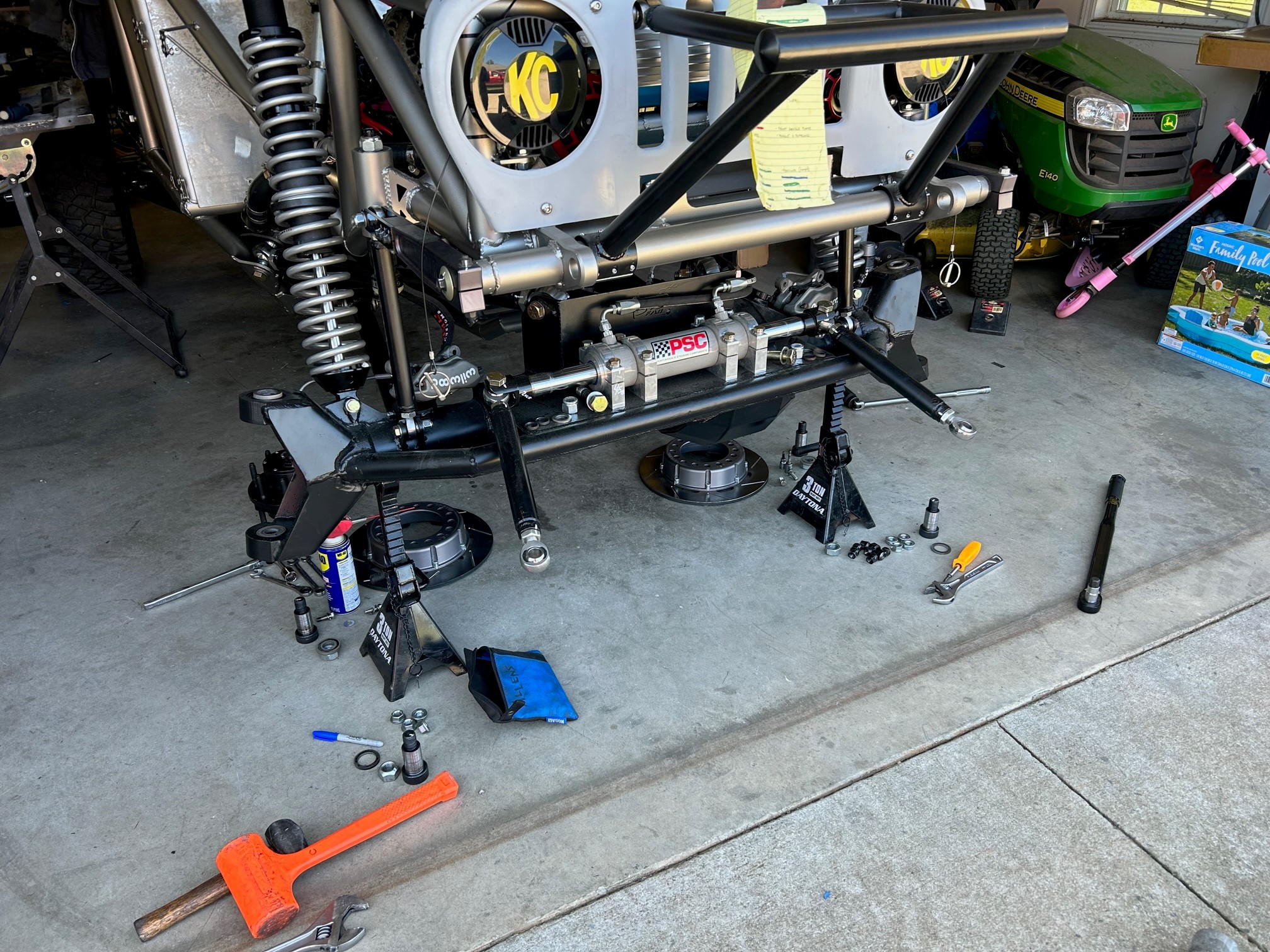

With the exhaust done, it was time to start knocking out and finalizing the suspension. Coilover springs, tighten bolts, nitrogen charges, etc. Not going to lie, I was originally going to have someone charge them for me local since I didn't have anything to do it, but after calling around, there's literally no one (Scott did message me back, but it was too late). So I made a quick decision to order everything and pick up a tank at a local welding supply place and within a couple days I just filled everything myself. I also added the secondary springs on the front and rear, while torqueing bolts and installing the limit straps. Although a little light on the spring rates on the front, its close enough for now and the rear seems to be perfect.
.... part two below...
This part two is where things turn...
While working out some parameters in the Holley system, I was able to get her leaned out a bit with the new exhaust. I was playing with this in order to help cure the exhaust wrap and of course hear what the final exhaust sounded like. She's definitely built for the track, not the neighborhood lol. Regardless, I was happy with the end result. Now, in my efforts to make April 1st, I took time off from work again in hopes to finishing up enough to go play. As the saying goes, things were going good until they weren't. There were just a hand full of things on the list to take care of and I figured I could knock them out within a couple of days. The biggest on the list was the front axle. I saved this for last because I needed to strip off the knuckles and add additional plates for strength, which meant I wouldn't be able to move the chassis. So I needed a good amount of time to take care of this. Luckily I was able to make quick work of the teardown and knuckle gussets/plating. After a quick coat of paint, I started the assembly. This time included the front axle shafts which is where this story takes a turn. I wasn't able to get the axle shafts seated all the way, they would seize up when I started tightening the unit bearings. After some careful inspections, I noticed the actual axle shaft was hitting the inner axle tube. Since I put this axle housing together, I didn't know how far the axle shafts would sit in the housing and I didn't allow for enough clearance. My first thought was to just trim the shafts, but knew it wasn't the correct fix, so I started the miserable event of cutting out the 4" axle tube. I removed 3/8" from both sides in order to have enough clearance for the shafts. This setback costed me over 8 hours in total, which meant I didn't get everything else done on the list. To say the least, I was completely exhausted, bummed, and a little mad about my mistake. When you don't know, you just don't know.

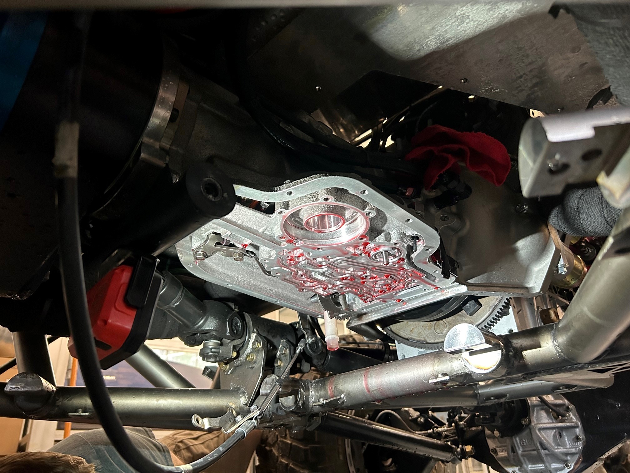

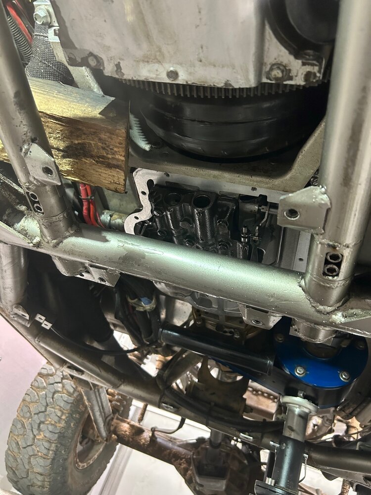

Well, as you can see above, I was able to get Tinkerita running and driving... unfortunately I was unsuccessful at getting reverse with the transmission which is a huge issue. Therefore in a last minute decision, I loaded up Tinkerita and headed back down to Digging Deeper Race shop for some transmission fixing. After some pressure testing we dropped the pan in an effort to modify the reverse servo, we were still unsuccessful at getting reverse. Therefore, we had to drop the transmission and get it shipped out. As you know, the Rush race is right around the corner, so time was of the essence. Luckily, Fritts Transmission Shop hooked us up in a last minute upgrade/rebuild. Was only a few days and we were reinstalling the Th400. We shouldn't have to worry about the transmission ever again.

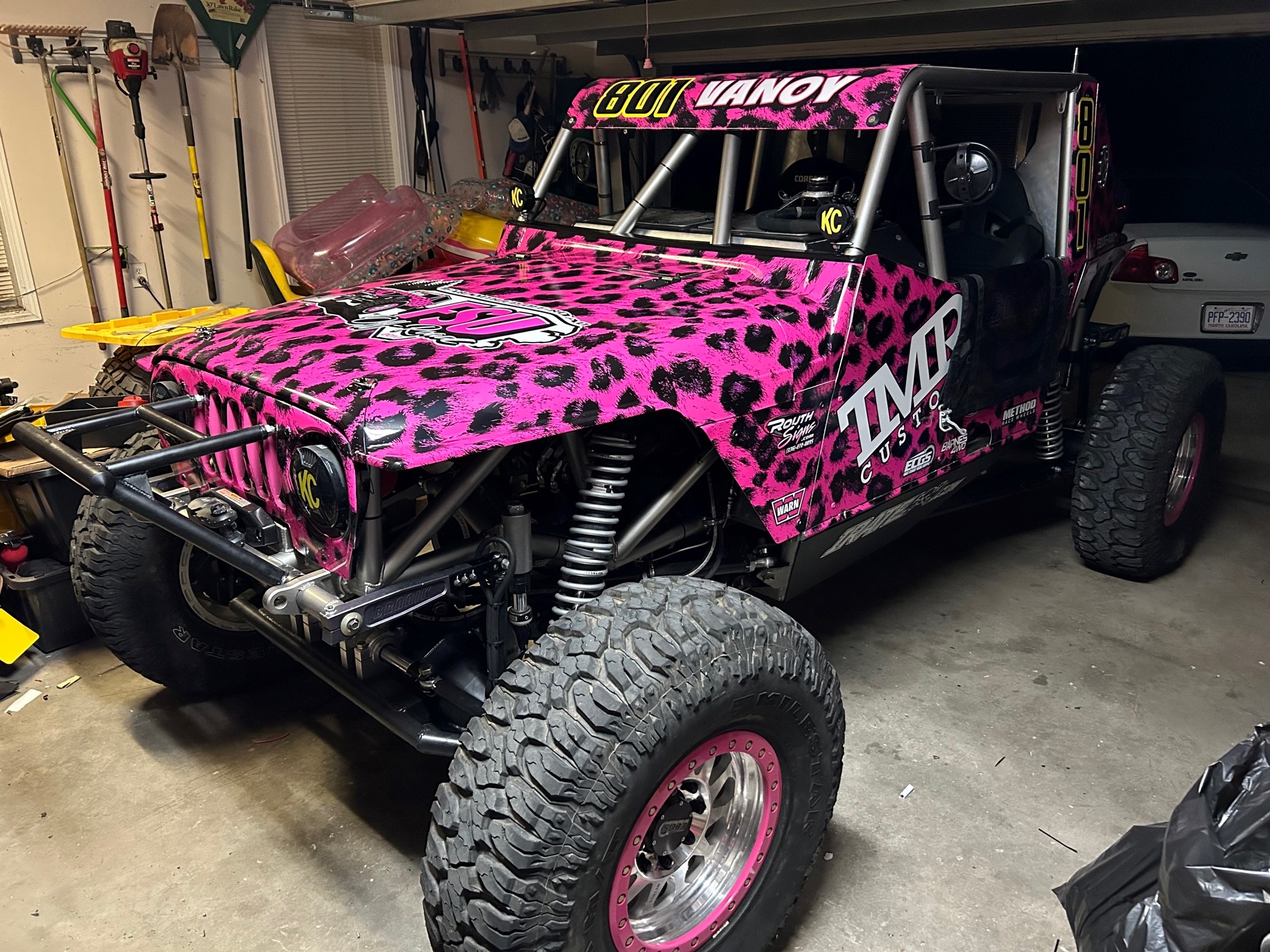

This past weekend I managed to jump back on the horse and make some small progress on the race jeep. I was able to diagnose the problem child, and unfortunately in a rush I missed a bead roll on a coupler. That's what happens when you're in too big of a hurry, however it was a humbling experience regardless and it taught me a lot. None the less, I rolled Tinkerita out of the garage to clean up and prepare for what's to come next.
Although not perfect, the overall profile turned out better than I could have imagined. Aside from some more sanding on the bondo, the last thing to complete the look will be our wrap. We have the designs almost completed, trust me, we're going to stick out for sure. That'll come with time thought, right now I'm working on finishing up everything to get this thing race ready. Obviously I'm planning on going through the cooling system again, just to make sure, however I'm still a little limited on leg mobility so I've been focusing on stuff I can accomplish standing. This includes getting all the components on the dash installed and wired. Thanks to Rugged Radios for getting everything shipped out in a quick manner. Had we raced Rush, we would of had them with time to spare.

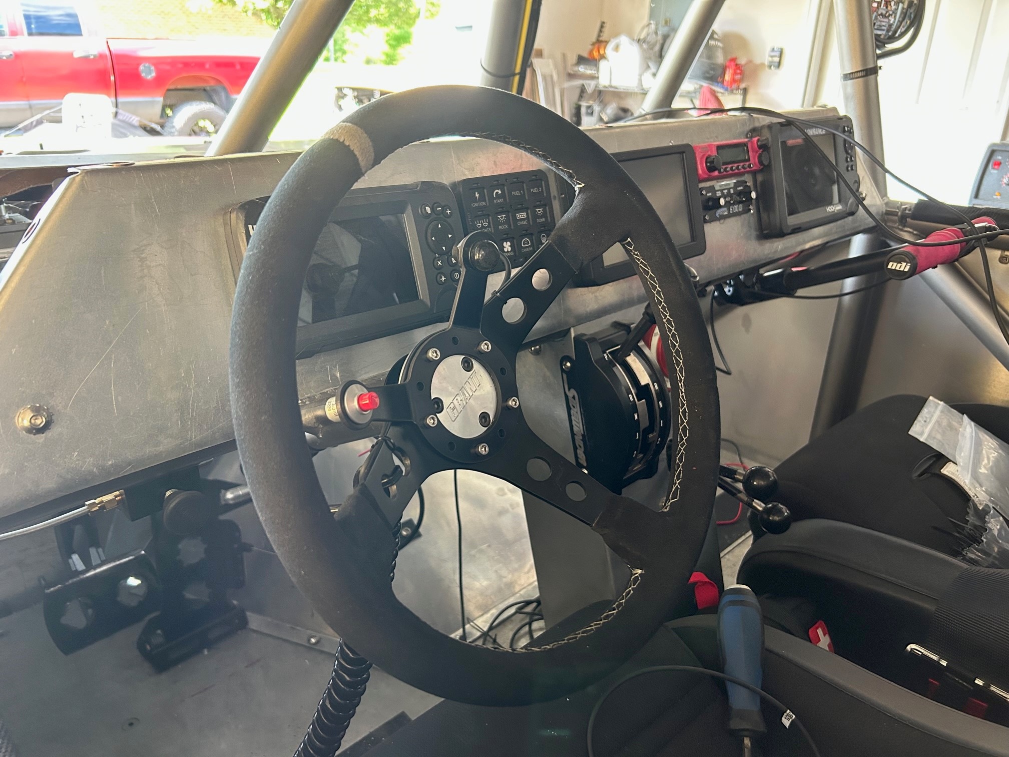

Aside from a few additional switches, the dash is pretty much completed. There's just a few things to change up and add to the chassis before she's tech ready for racing, but it won't be long until we're officially done the build. I cannot wait to have this thing on the trails and track!

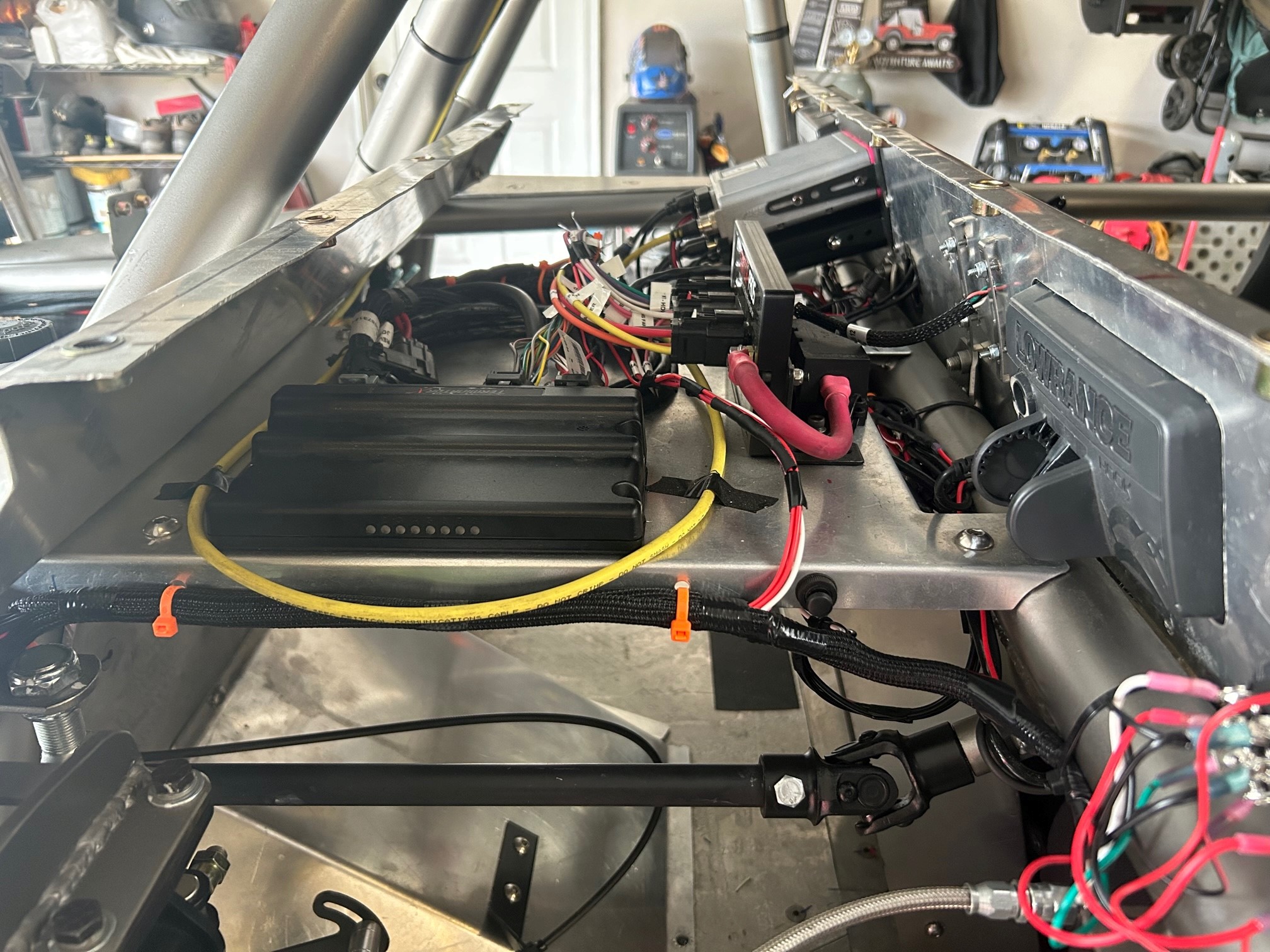

Over the past weekend, I was able to finish up the wiring under the dash. In order to utilize the Switch-Pro to its fullest, I changed some trigger wires around and was able to use them elsewhere. Also installed the 5V Autosport Labs sensor for the transmission temp and uploaded everything in the Holley system. The last thing I completed was getting the in-cab winch controls installed and pre-ran to the front. Since I'm using my old Warn winch, I needed to have a grounded momentary switch. Last thing to do will be to simply install the winch, but that shouldn't take too long. After getting everything buttoned up and secured, I finally installed the dash for the hopefully the last time.

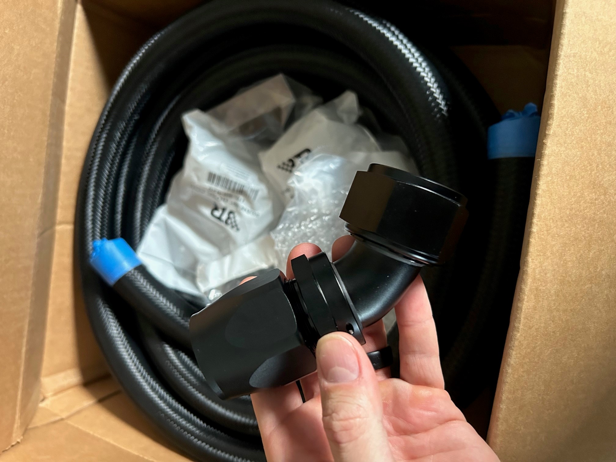

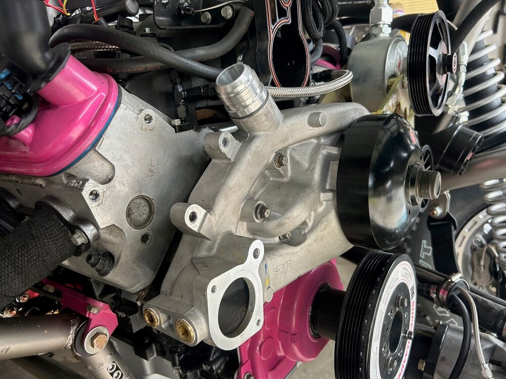

Now for the biggest and most needed upgrade yet... -20AN coolant hoses. From this point forward, no matter what I do, I'll utilize -AN fittings for everything especially coolant lines. It might be more expensive, but I assure all of you, it's cheaper than the hospital bills. So, in order to convert everything over, I opened my wallet one last time in hopes to have enough to pay for everything lol. I had to remove the radiator, all the existing couplers, as well as the water pump. Cut off the existing inlet and outlet on the radiator to make room for the weld bungs and took it to a buddies shop for some tig welding. He also welded up the thermostat housing and the inline vent housing we're utilizing. After that, it was a simple fitting install to make sure we had everything where it needed to be before we ran the big hose. After multiple measurements and installs, we got the completed lines installed.

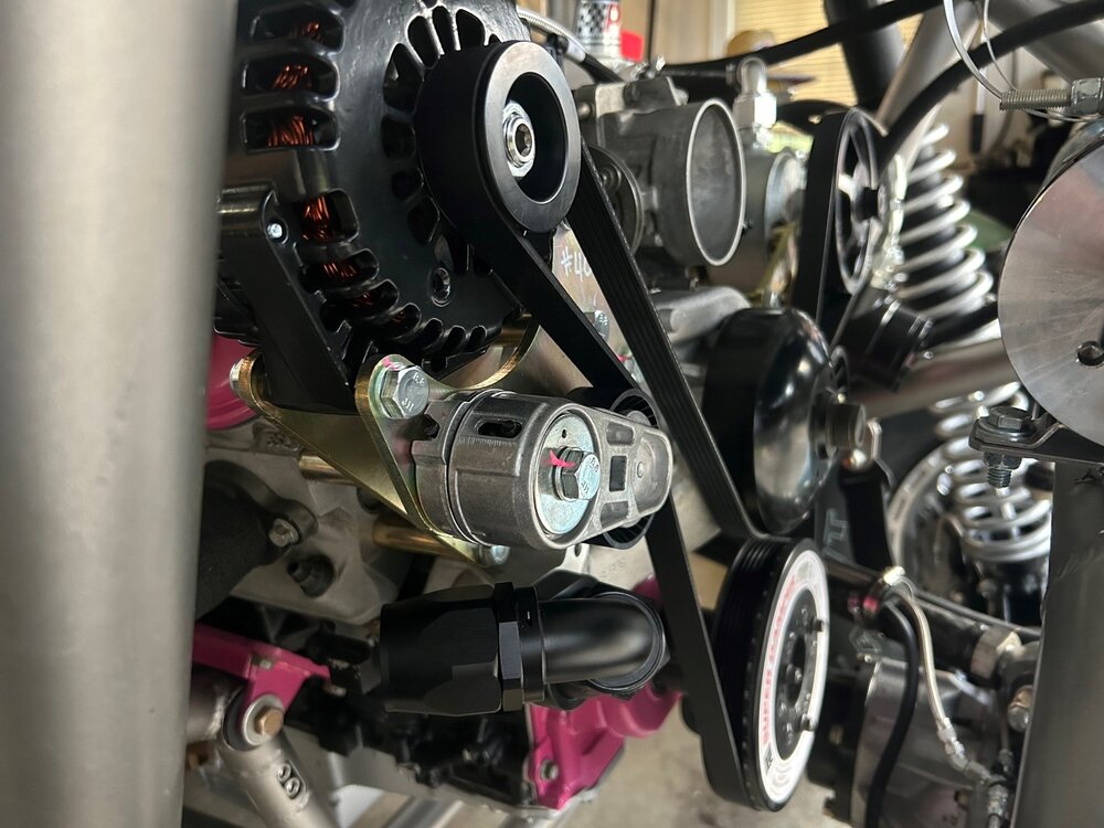

Also while installing the water pump with the AN conversion, I also installed a new alternator, tensioner, belt, while triple checking all the bracket bolts and marking them. It was super short notice, but I was able to finish the AN conversion on a Friday afternoon with plans to take Tinkerita out the following Saturday morning. Although mostly complete, I still needed to install the new oil pan seal, skid plates, flush the coolant system, and triple check the oil. So I worked diligently into the wee hours of the night.

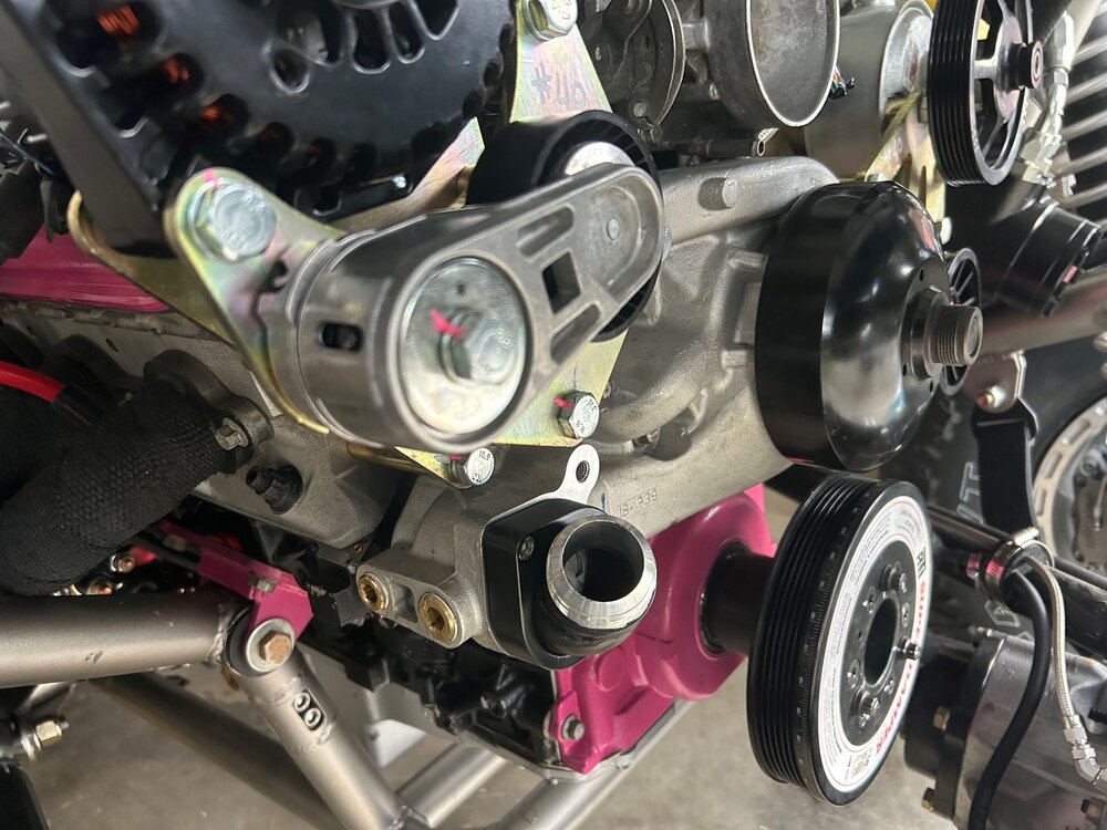

Could you post a couple of pictures of the water pump so I can see how you managed the inlet/outlet AN conversion please ?
Looking at your pictures above I'm curious how you managed to achieve some angles.
I know with mine, WOD sells a -20 thermostat housing and I bought the water pump neck that presses in. No welding required.
Not a problem. Since my original thermostat housing was a swivel design, I simply cut it at the base in order to install a weld bung. My clearances are super tight between the upper link and the belt tensioner, so having the swivel design was important to me. It allows just enough clearance for the tensioner to max out and about 1/8" from the upper link at full bump. Then just utilized my AN fitting to get it out of the way. As for the water pump, CBM Motorsports offers a press in style design for both front and top LS water pumps. It's a super tight fit, but worked perfectly for what I needed it to do. Just specify what opening you need, they offer different ones as well as different AN sizes.

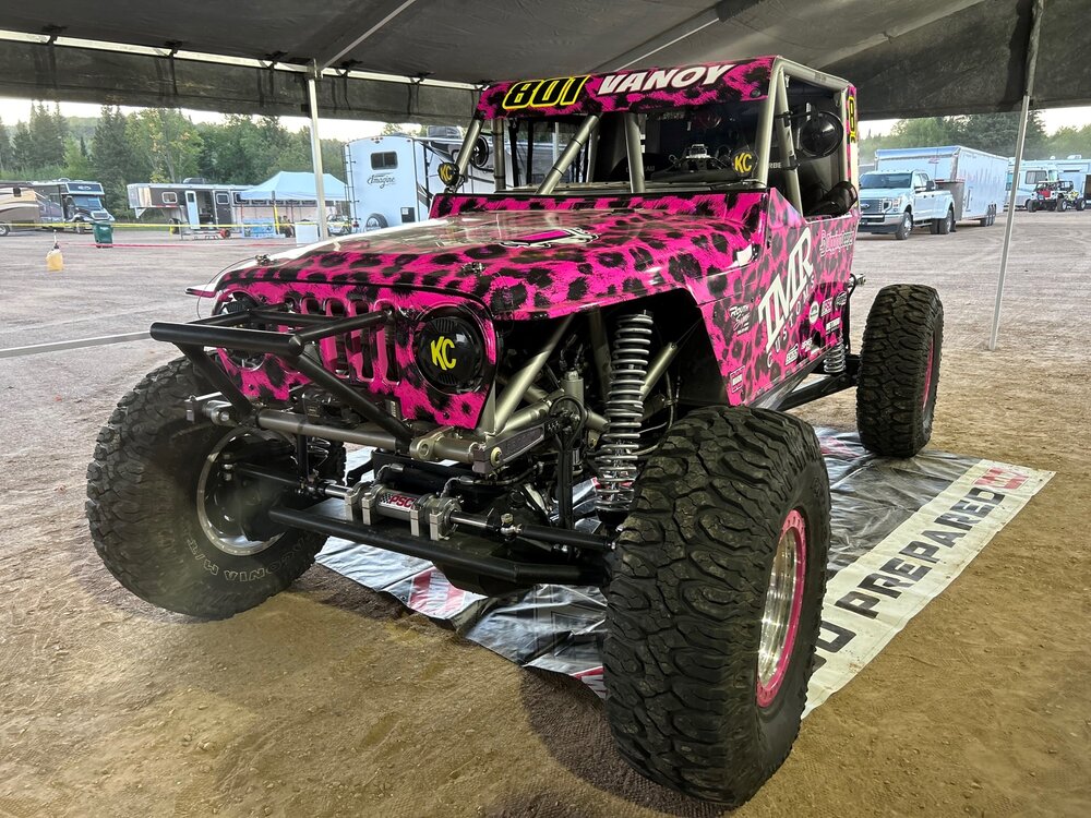

Sorry everyone, I know this has been long awaited. A lot has happened personally since we returned from The Big House, but things have stabilized now and hopefully I'll get back to enjoying race car things and social media stuff.

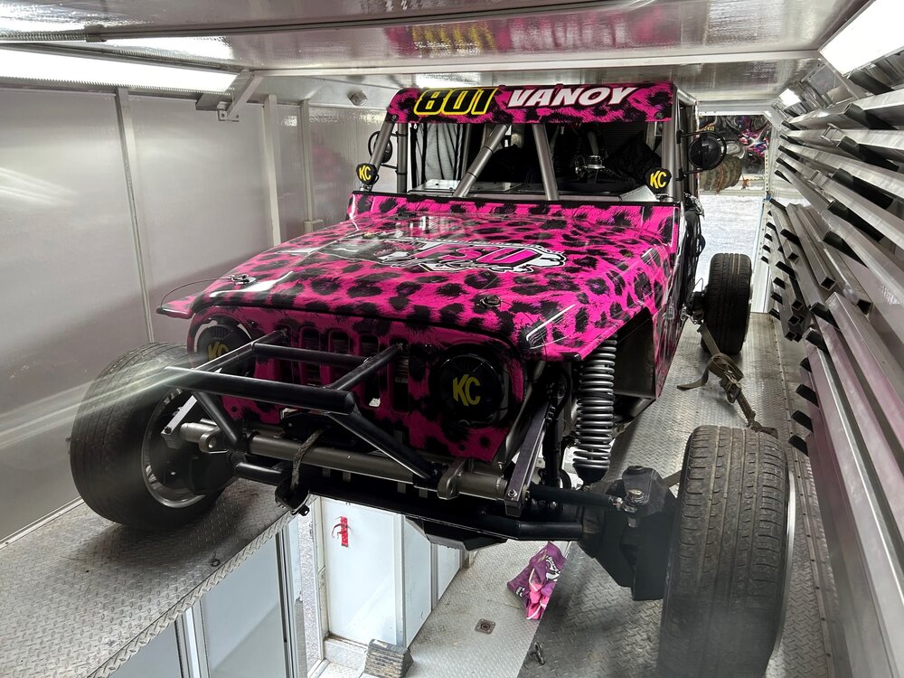

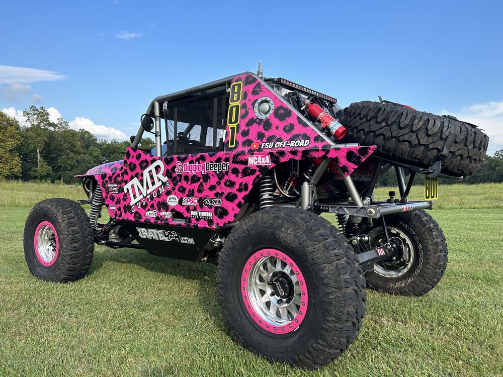

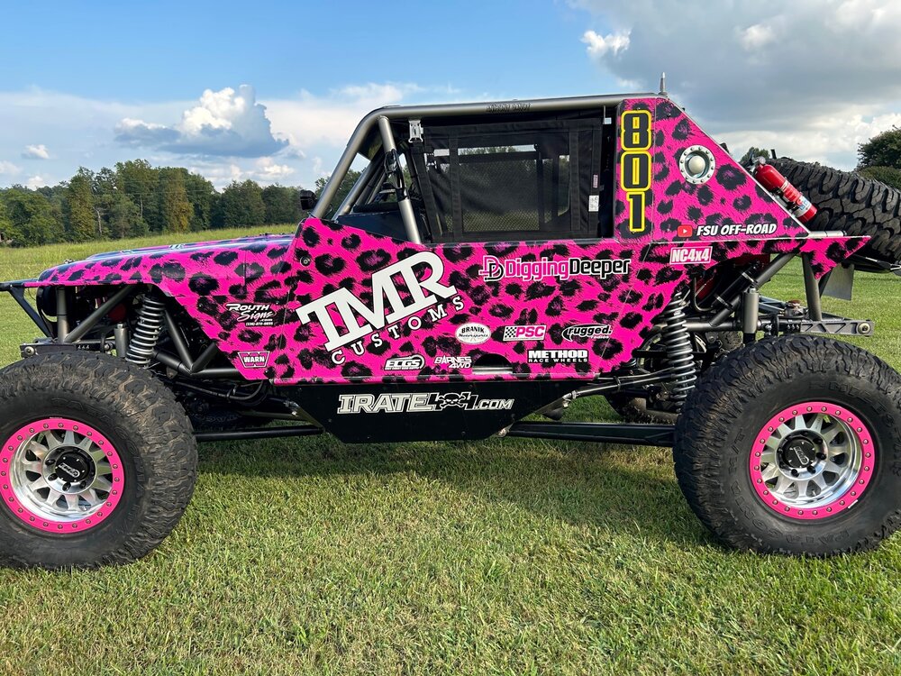

Prior to leaving, I did take some pictures of Tinkerita all ready and of course, loaded up on the way! Thankful for a great support system and team that we have in place. We were able to take the toterhome and stacker trailer to have some creature comforts. Was a tight squeeze, but we made it work. Very thankful for this because this came in handy at Crandon. None the less, 18 hours later we arrived and started the unloading process.
To date, we've never had the opportunity to have these comforts, so it was a huge blessing to have at Crandon. I didn't realize how far we jumped into the deep end until we got there. If anyone ever gets the chance to go, do it! It's literally a mini Hammers and a huge event for the area. Absolutely awesome as a driver and a spectator. Regardless, we made it through tech with no issues and were tagged to go race. After doing some adjustments, we were off on our first practice session. Thankfully it started out slow, because I wasn't prepared for the full-on assault that was to unfold. The car handled very well and the faster I drove it in the rocks, the better the suspension worked. Was on the very last lap where our first issue would arise, on the homestretch rocks, the throttle cable came off the pedal leaving me stranded. Thankfully it was the last lap and an easy fix. The crew towed me back to camp so we could fix the minor issue.

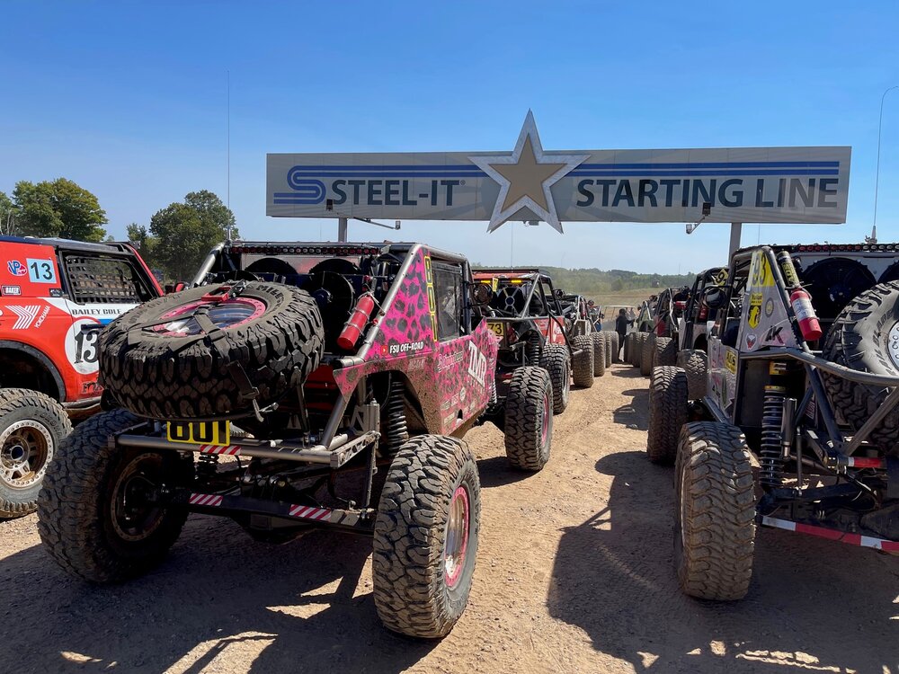

Thankfully it was a quick fix as our second practice was qualifying for the Friday afternoon short course race. As posted earlier on the thread, we did well for our first time qualifying. The more seat time I got in the car, the more comfortable it became which allowed me to go faster and faster each lap. I was pleased with our standing and we as a team were excited about what was to come!

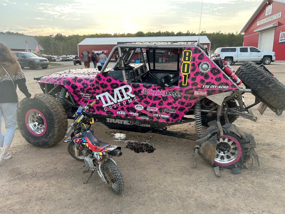

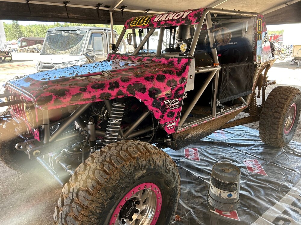

Now for the good stuff... I wish I could say things went perfect for our first race but that was 100% not the case. At the very start of the race, we made tire contact on takeoff which punted me sideways and put me in a bad starting position right out of the gate. I wasn't able to have that desired clean space on the track with the faster guys, so we had to push pretty hard in the rocks to make up some time. As most of you saw, around lap 3 we got a rear flat that slowed us down, but I refused to stop! I believe we made it 4 or so laps on the flat before total destruction to the car. Coming out of the homestretch rocks, I nailed the lower skid plate with one of the boulders which unfortunately bent up the lower link bracket which in return bent the crossover tube up enough to crack the transmission pan, puking ATF all over the place. Luckily my spotter noticed the fumes right away and I was able to limp it off the track on the backside. The track crew towed me to the start line where we could assess the damage.
I'm not sure how most people would react busting up their car, but I was so stoked about what we had just accomplished. The first time racing the car was and unbelievable moment and I was so ecstatic to say the least. When the team drove up, they weren't 100% sure how I would react, but I believe my smiling face said it all, which I know eased the situation. And having so many locals come up after the race praising the pink leopard print car as something I'll never forget.
The car did have a lot of damage though and we knew we only had 24hrs to get it back to the starting line for the night race. We changed the busted wheel and towed it back to camp. This is where the stacker trailer was a life saver as we winched the car into the trailer and raised it up. Once we were able to assess the damage, we strategically came up with a game plan on what we were to do. After a little bit of work to get things torn apart, we called it a night as we didn't have what we needed to fix it. The next morning came early as well all had our jobs to get Tinkerita back up and running. Half the team worked on the coilovers and the broken pieces, others chased down parts, as the rest of us focused on the transmission and getting a replacement pan in there. Was a very long exhausting day, but with just a little bit if time to spare, Tinkerita was able to make it to the starting line once more.
