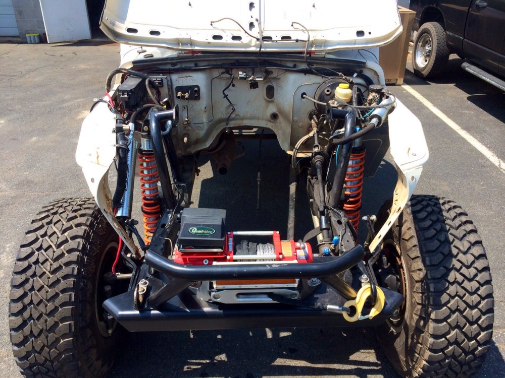

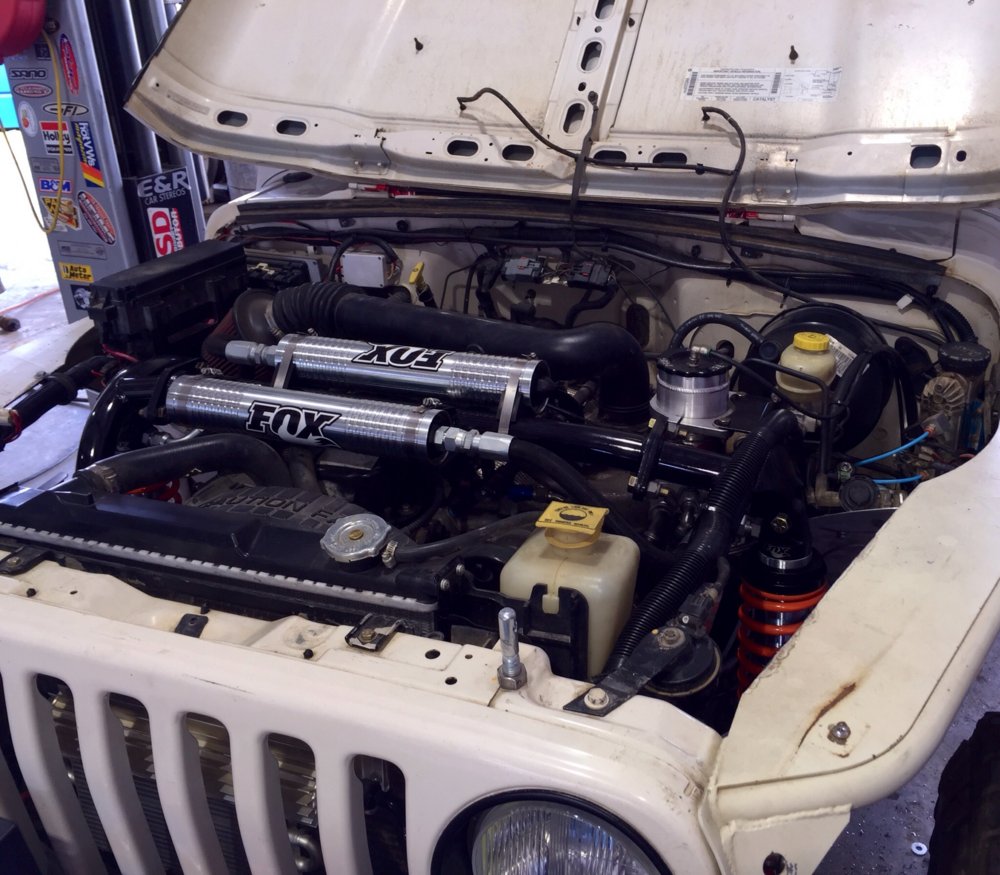

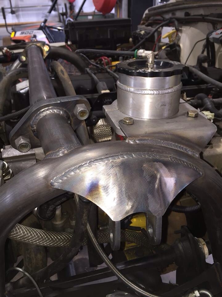

Also, Marsfab continues to make progress on the front end, working to squeeze Fox 2.5's around a full frame-
Like squeezing into a low cut, skinny fit, pre-shrunk pair of Prada leather pants, Marsfab was able to construct a way to get all of the Fox shock components and factory emissions equipment into the engine bay. Removing the inner fenders provided some mounting challenges, buts so far so good.
Planning to put a heat shield above the motor?
Maybe. I may just move the reservoirs. I'm pretty limited on space so I'm gonna have to play around with different placement and see what fits.

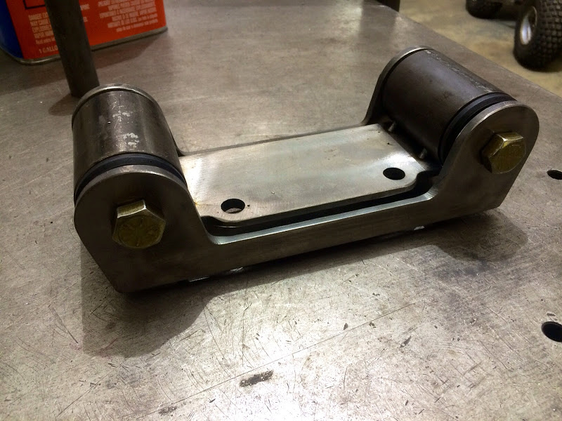

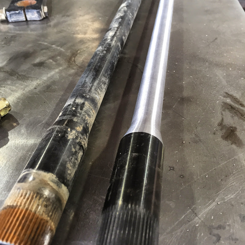

Tony and his crew milled down one of their sway bars to .875 for me, here's a shot of my Genright 1.06 bar next to the .875 bar:

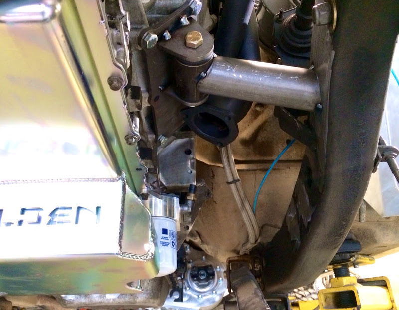

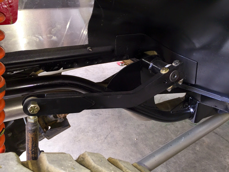

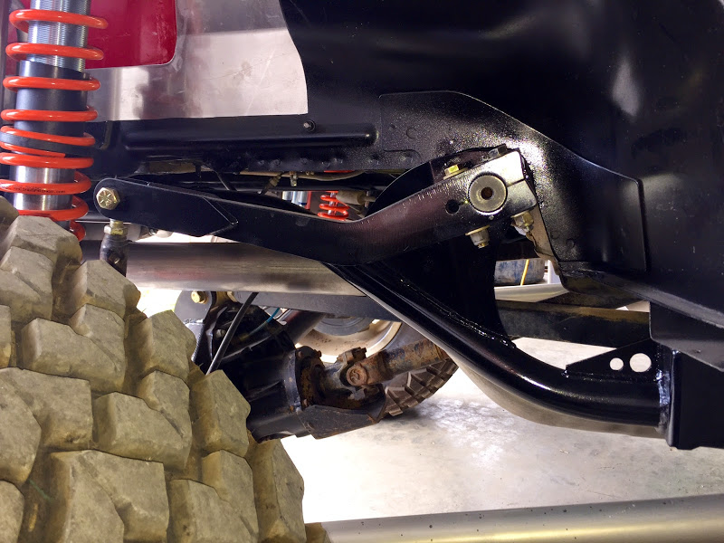

Annnnnd Marsfab installed:
alh4.googleusercontent.com__OhM1c6e9FBI_VR2oj5XDreI_AAAAAAAAFr516695f86f3a72a49c37278dce4105f9.jpg
alh4.googleusercontent.com__nA91qA5j2Bg_VR2onXuhftI_AAAAAAAAFrb89f391fcac436970567d4c0e17318c9.jpg
Very cool, but the correct term instead of milled, is turned. Just out of curiosity, but; What was the need for that?
Incredibly stiff at 1.06, the arms had to be shortened to 14", so we needed more twist in the bar.
The new shocks wouldn't allow for the arms on the bar to be the original 20" long. They could only be 14". Shortening the arms made the sway bar almost twice as stiff. Turning the bar down to .875 from 1.0625 softened it back up to very close to what it was before.

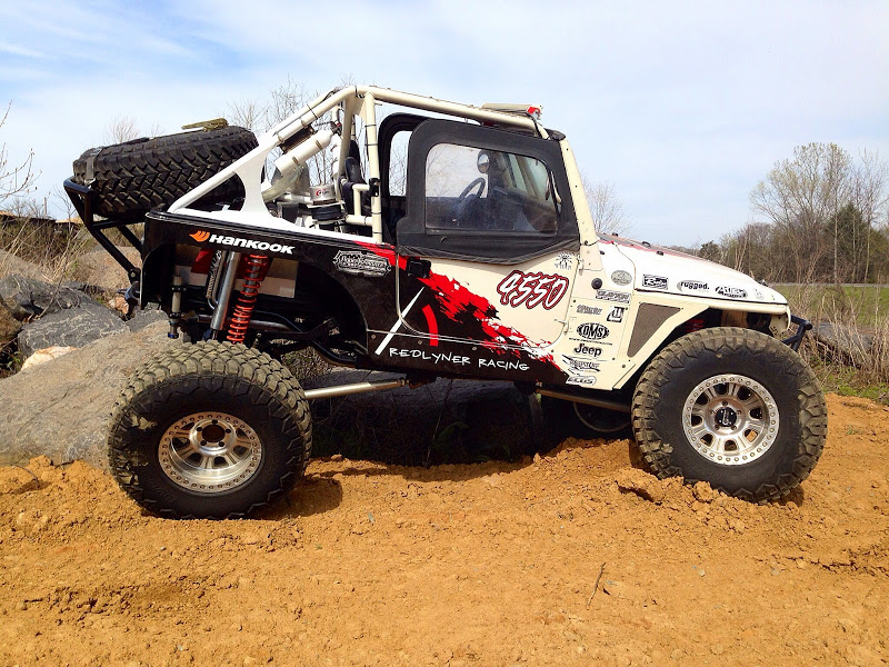

I picked up the Mall Crawler from Marsfab and after some flex testing in the rock garden, in true daily driver fashion, I drove it 52 miles home..... And then washed it, annnnnd then drove straight to the track. Spring rates might need to be changed out, definitely needs some tuning, but it felt good out of the box for a complete suspension change. Short day of testing, the rear driveshaft broke about 30 minutes in. Hopefully it won't keep me from the show and shine at Sonic on Friday.
alh4.googleusercontent.com__rx_FvjpVJIM_VSKIaQWICPI_AAAAAAAAFso_7GYzHgMRv1c_s800_image.jpg
alh4.googleusercontent.com__O8x5clGmKfY_VSKIZRlwRYI_AAAAAAAAFsU_R1aaPL3_B0c_s800_image.jpg

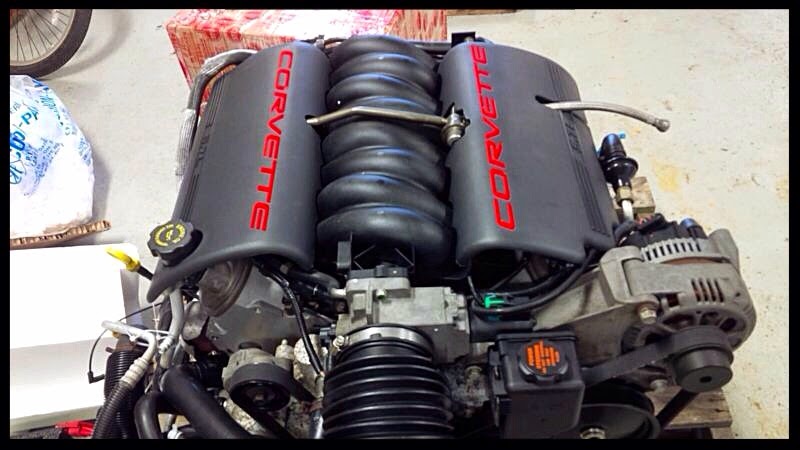

I came to the obvious conclusion that the Mall Crawler needed a Type R solution..............
alh3.googleusercontent.com___G7rCQiB5jo_VTWsQEXPVeI_AAAAAAAAFts_A5jxCdfRvfU_s800_image.jpg
This begins the next phase of the Mall Crawler Race edition, or Type R :grinpimp:
alh3.googleusercontent.com___hN0oqm59qk_VTWp8mT0WeI_AAAAAAAAFtQ_FvrJdGq_m58_s800_image.jpg

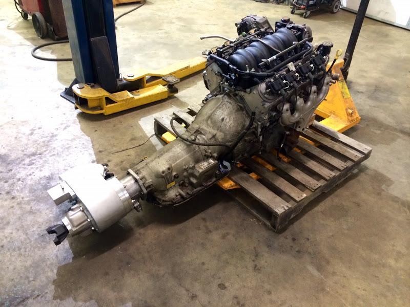

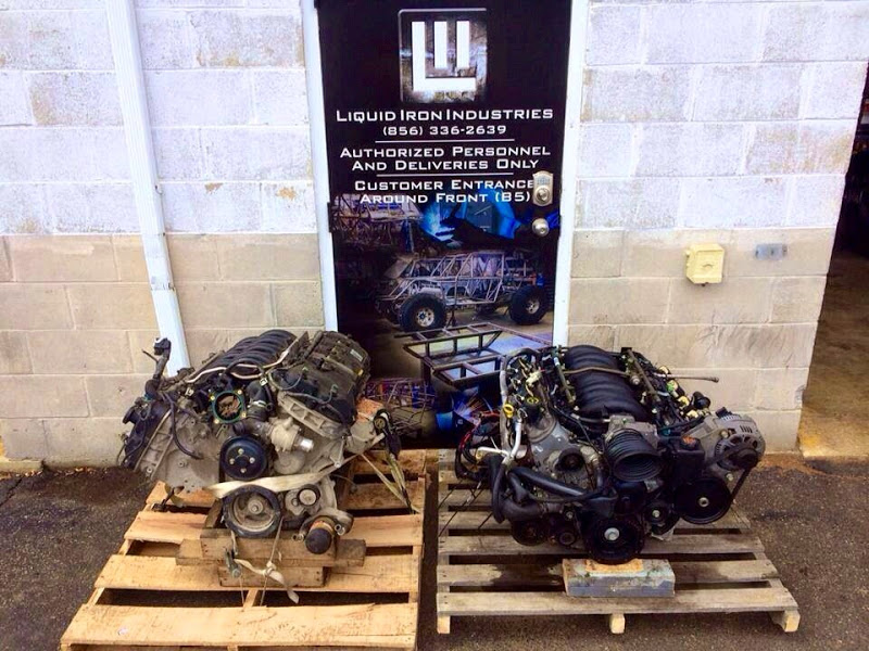

I had the motor shipped to my good friends at Liquid Iron Industries. As a huge fan of Tim and his crew's work, I'm super pumped for them to be cutting on the 4550.

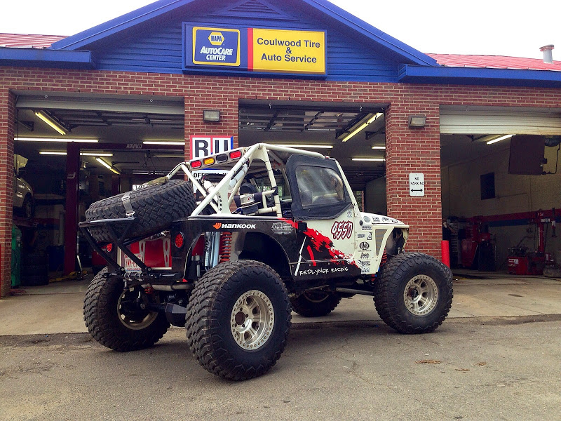

One last trip to the emissions station for the annual checkup. Time to get things packed up for the trip to Jersey-
alh3.googleusercontent.com__qfpgXIC1EmY_VTWsQJpjOFI_AAAAAAAAFtw_jByKG3R8vt0_s800_image.jpg

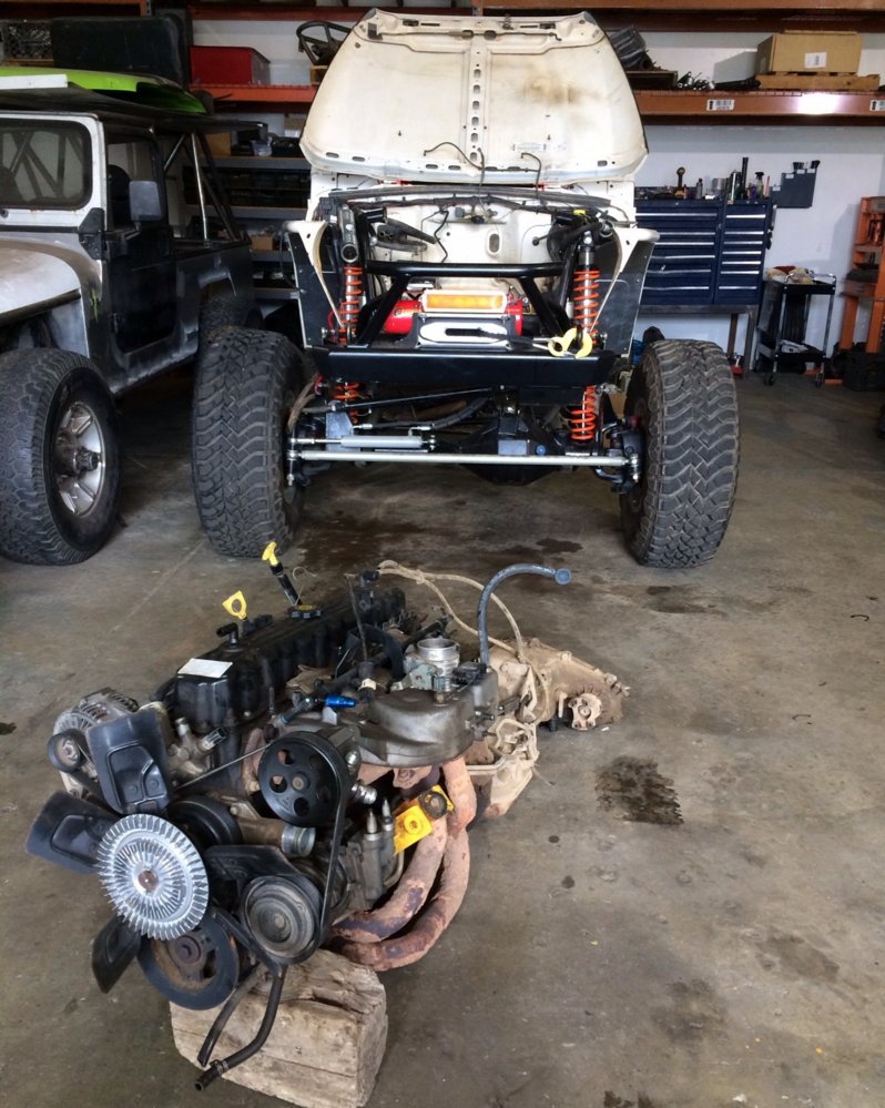

Tim @ Liquid Iron Industries went out and won the Line Mountain race on Saturday, then had my full drivetrain out on Sunday. He thinks by moving this along quickly, he won't have to deal with all of my non relevant gossip about the latest Esquire magazine (which by the way, Tim, had an amazeballs article on this years men's Summer fashion).
Non relevant? It's all relevant brah! Is pastel green in this year? Will it clash with my race suit?
Tim @ Liquid Iron Industries has the final prep for surgery completed.
It's like sitting front row at a Celebrity plastic surgeon- you know what ever is next is going to bigger, tighter, and more voluptuous.

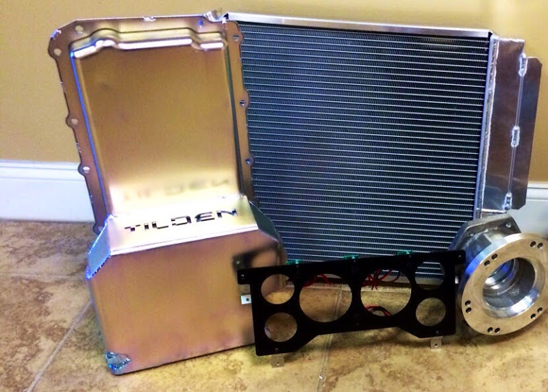

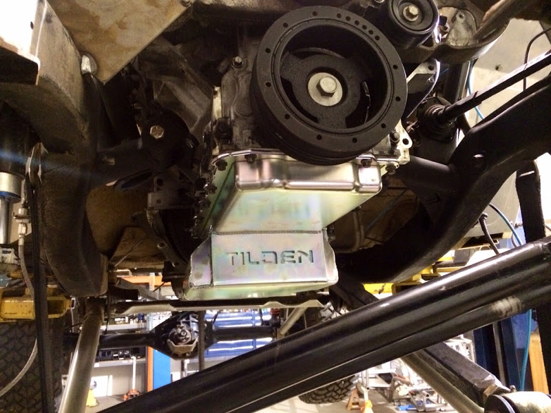

And speaking of beef, some parts are starting to roll in for my C5TJLS1TypeR swap. Tilden LSx Oil Pan- This was the shiniest one we could find. I'm not sure what else it does.
alh3.googleusercontent.com__KrPZyDGiV8c_VV9eua00VoI_AAAAAAAAFy4_zVtgCEdpHuU_s800_image.jpg

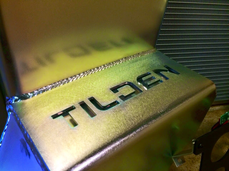

And speaking of shiny, Tim at LII picked up the Advance Adaptors LS Swap radiator for the C5TJLS1TypeR. Gauge pod panel arrived as well, but we haven't decided on which gauges yet. Any suggestions on which ones are most baller?
alh3.googleusercontent.com__CuVOkEP1Y4s_VV9evGswPzI_AAAAAAAAFy0_NUmyEh7TwsQ_s800_image.jpg

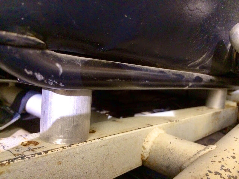

And speaking of cleaning things up, I've had a few nagging issues as well that Liquid iron Industries is addressing. One of which was my seat spacers (I made spacers out of a TJ Transfer Case Drop Kit), Tim had some slick aluminum spacers cut to clean up the area a bit.

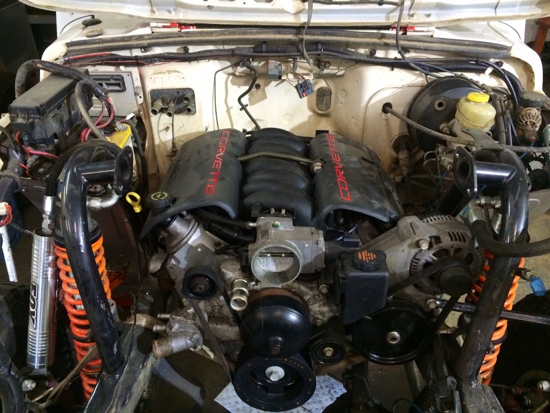

Test fitting is under way. I'm contemplating flying up just to detail the engine bay......

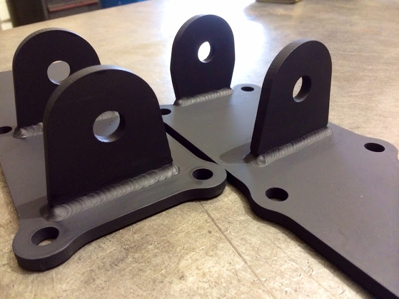

Bracketology brah. Tim at LII did a little cutting before the Offroad Expo to get the motor/trans/Atlas in place. We swapped in some hugger headers to clear the 3-link which allowed the C5TJLS1TypeR to slide right in.
