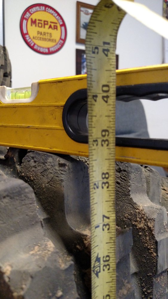

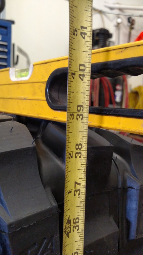

Jay asked me to post some tire sizes for reference.
The 37 Trep is mounted, at 25 psi and on a 4125# Ranger. It shows approx 1/2 wear.
The other 2 are unmounted. The Krawler is brand new and the Trep has 3 laps at KOH on it:D

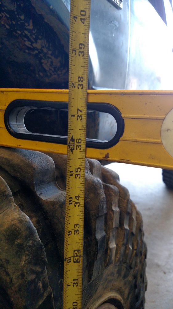

How is this for interesting:

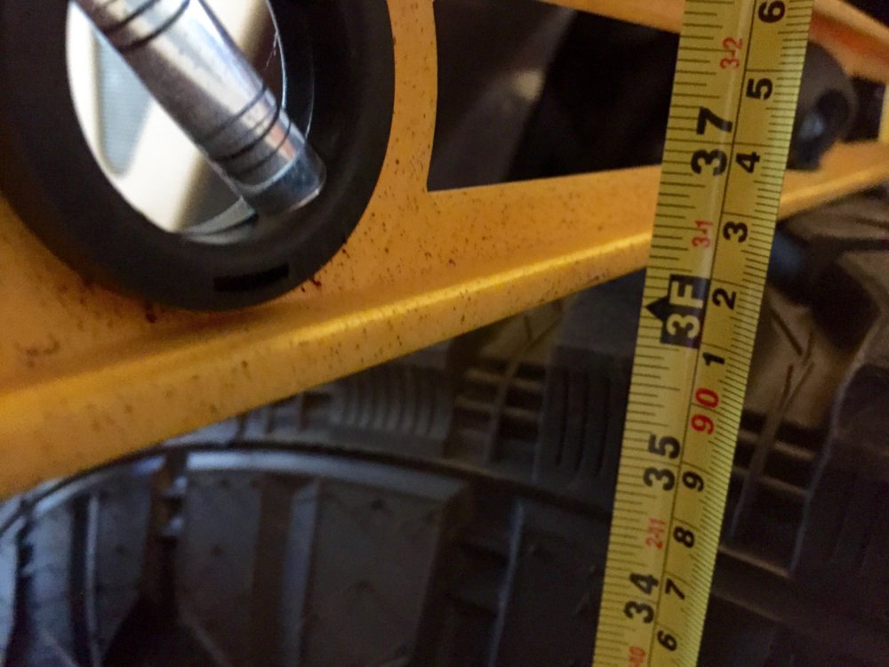

37" Hankook mounted on a 17x8.5 at 23psi. 36 1/4":

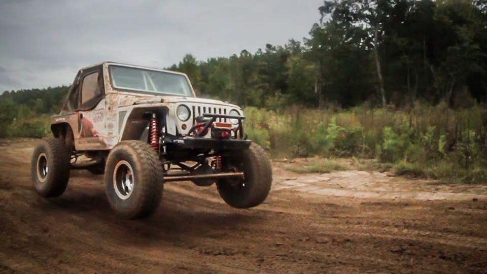

Regarding the pictures I posted- my first 4 or 5 passes the nose of the 4550 was diving pretty bad. Wayne kept adjusting the shocks, explaining that we want the nose high going through the whoops- pretty cool to see it react to the changes.
