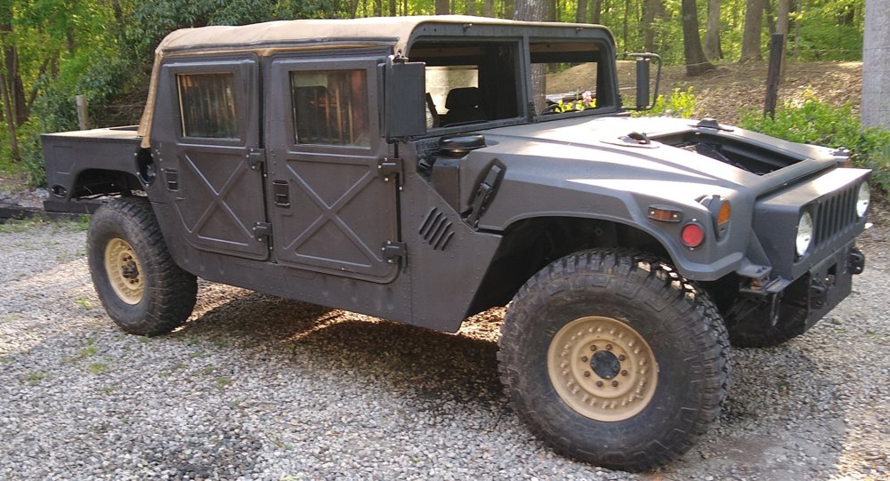

Took a deposit on this one thanks to @amcjeepman , I need to get my butt in gear to get it gone. I finally was able to drive it for the first time ever on Friday. Still have to install the transmission controller finish up some other things. I will be glad to get it out of my garage. 6.5 turbo/4l80e. It originally had a 6.2/th400.

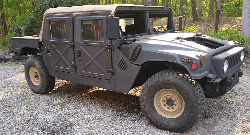

What's the deal with the schnoz?
That is a ECV nose/hood. They came on all the turbocharged HMMWV's so they could fit a larger radiator. I didn't change the radiator as it is not necessary (turbo H1's did not have a larger radiator). I like the look of the ECV hoods, but some people don't.

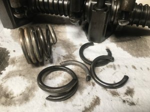

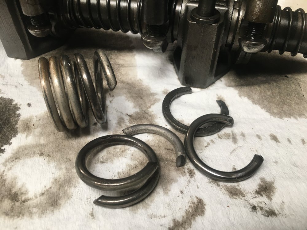

Took the ol fat girl out last night for a little shake down after the repairs. Held at 60 (+?) for a run down the highway. Its amazing what having all cylinders working feels like :rolleyes:
And this is what caused it to be down for a few weeks. #2 cylinder exhaust valve spring. A chunk of it was found in the oil pan, which lead to the search for what the piece was, where it came from, and what other damage had it done on the way to the pan.
Luckily, absolutely zero sign of any other issues. While it was down I also removed the flame heater, replaced a few sections of the fuel return lines, replaced hoses, had the radiator cooked/cleaned/painted, and started to chase the turn signal/brake light wiring issues.

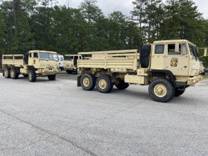

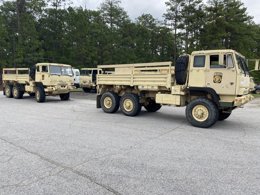

I’ve picked up two, 2009 BAE M1093A1’s for my FD through a state program. Can anyone point me in the direction of where to find operation or service manuals for this particular model? And If someone mentioned it in the 17 pages of this thread I may have missed it. We’re flying blind with these two trucks on operations manuals and where to look for parts. Any help is appreciated as we're pretty new to this end of the apparatus world.

Let me ask my motor sergeant I may be able to get you a word docx.

Nice! Those are some nice trucks aside from the fact they have the airdrop cab, but being a1's they have the 330hp cat and exhaust brake, pretty stout trucks.
