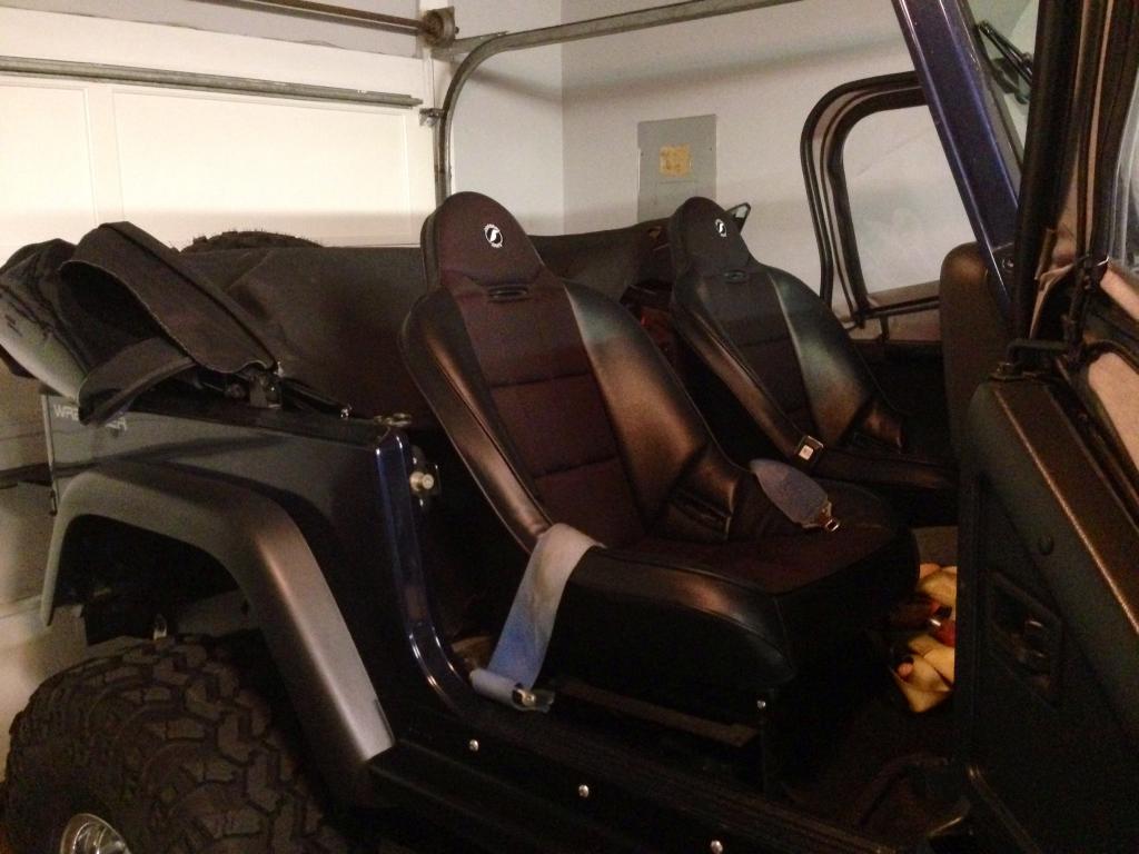

i love these seats. they are extremely comfortable which is much needed when running leafs!

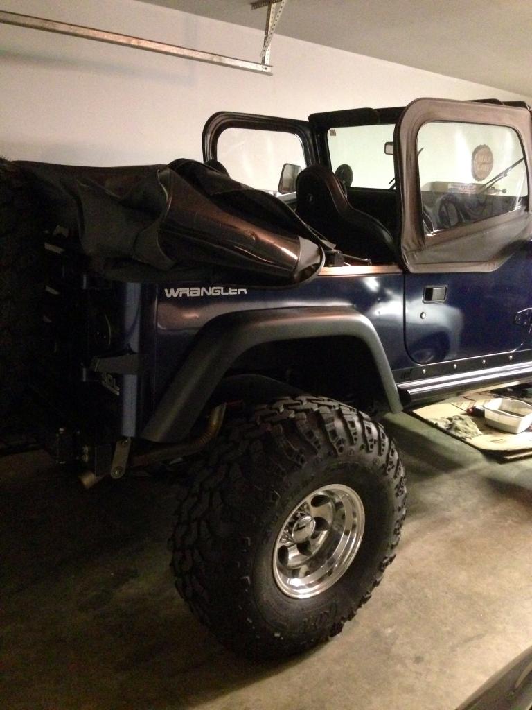

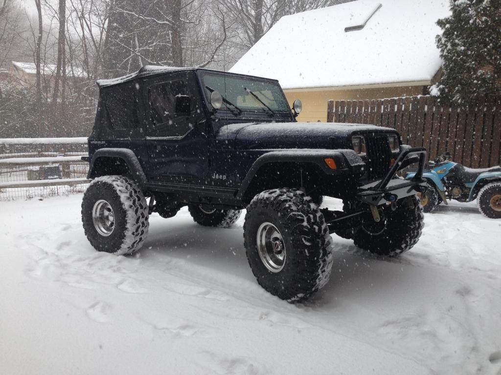

Back to working on this jeep a little bit. I have been happy with the whole setup for the most part. I plan to put some stock YJ springs back in my jeep so I can lower it down a little bit and make it ride a little softer.
Little snow action.

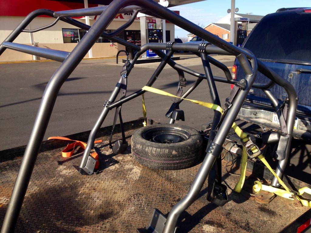

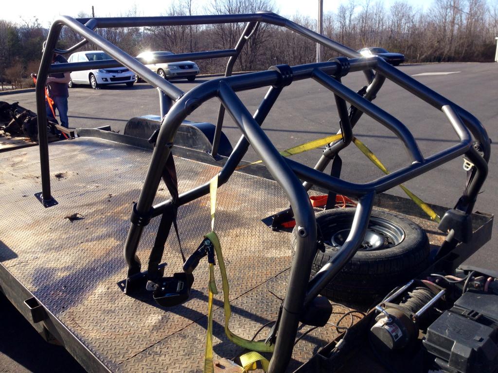

I sold my YJ cage that I built a few years ago. Last photos of it before it headed to WV with it's new owner. I can't wait to post up the new cage build that will be done by Chris at MarsFab in the coming weeks. It's going to be bad ass! I'll be taking my jeep up there in a few weeks for Chris to work his magic. I/we will post up updates once Chris starts on it.

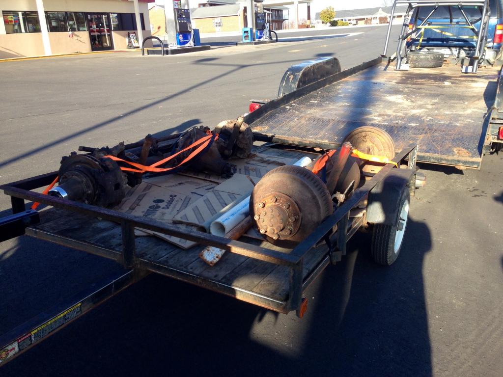

This is what I traded my cage for. Dodge Kingpin Dana 60 and full float Chevy 14 bolt. :D

Solid trade
Thanks man! I'm excited! I finally have big boy axles since all my buddies tell me I need to lose my 1/2 ton ford stuff for tons. I still haven't broken anything in my 1/2 ton axles (my postal actually gets wheeled and it haven't broken yet).

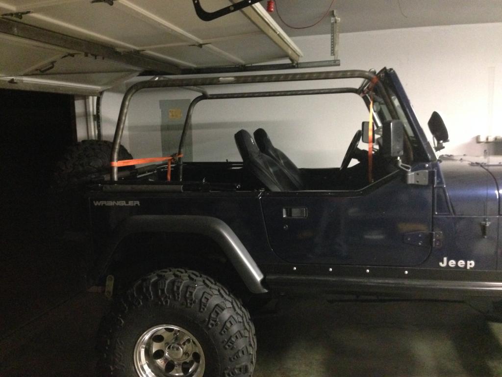

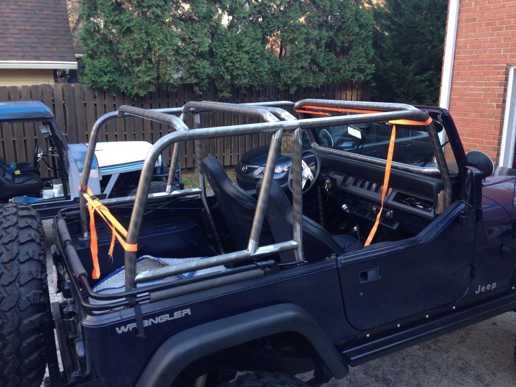

So some changes about the cage build. I was originally planning to have MarsFab build my cage because I believe he is the best fabricator around and I'd love to see what he could do with it. BUT I just couldn't find the extra funds to get it done by MarsFab so I'll be spending the next few weekends building my own. It is a fun project though because I haven't been doing any fab and I've missed it. Here are my photos from this weekend.
I picked up 100ft of 1.75" .120 wall DOM tube. Some design, assembly, cutting, notching, bending and re-notching, welding, etc needed.
ai1024.photobucket.com_albums_y309_95builtjeep_jeep_20build_202010_photo311_zpsd11cad5a.jpg
At the end of day #1 in the garage.
ai1024.photobucket.com_albums_y309_95builtjeep_jeep_20build_202010_photo312_zps90ac651e.jpg

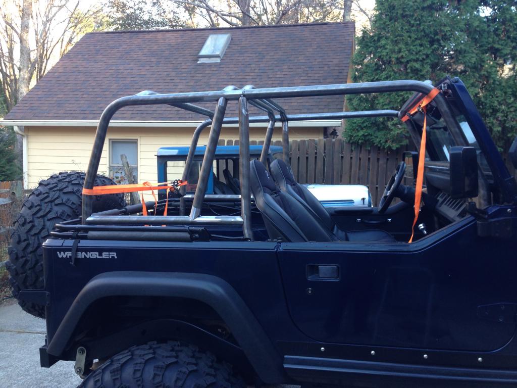

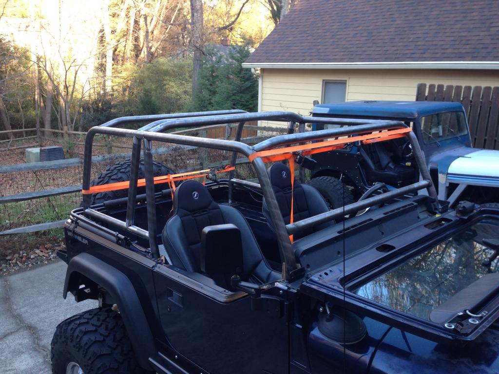

Another. I'll be adding in a ton more tubing. This is just where I stopped for the weekend. The side pieces are bent with one piece of tubing to eliminate splices. The one side has one splice but it'll be braced at the B-pillar similar to production cages that are on the market.
ai1024.photobucket.com_albums_y309_95builtjeep_jeep_20build_202010_photo313_zpsca335dcb.jpg

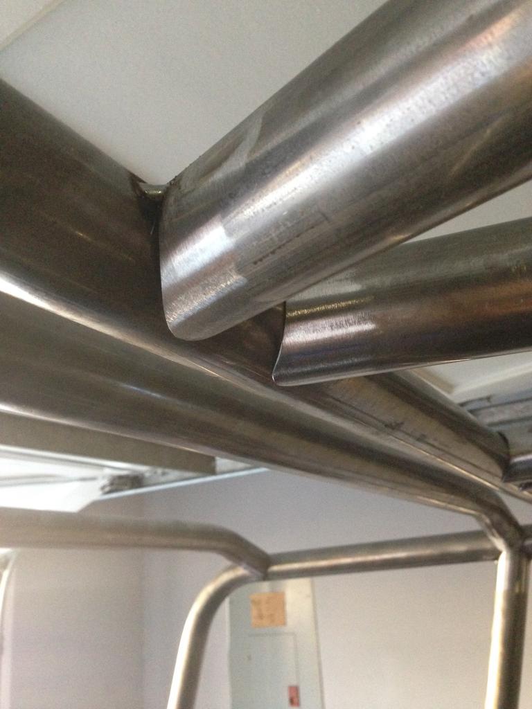

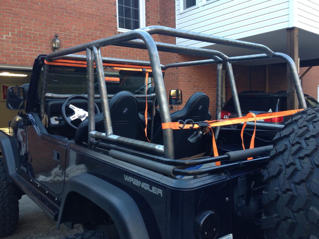

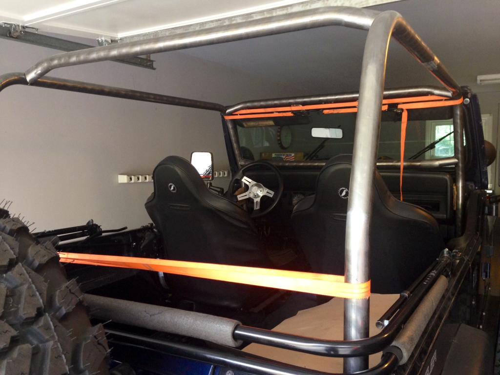

Well...had another garage day on Friday since I took the day off. I got a bunch done with the cage. Still lots to add but it's taking shape and I'm happy with it thus far. I never liked the look of a double B-pillar (as my friends know) but I do like the strength of it so I tried something a little different to see how I liked it and I'm pretty happy with it. The soft-top still fits and no rubbing on the dash or door inner panels. The B-pillar goes to the floor on some custom plates I drilled out to bolt to the factory location. The double B-pillar will have a down tube that attaches to the tub fender well. Onto some photos.
FYI...Don't worry. I'll have overhead cross bars, behind the seat cross bars for harnesses, etc. Basically, I know I need more triangulation. :flipoff2:

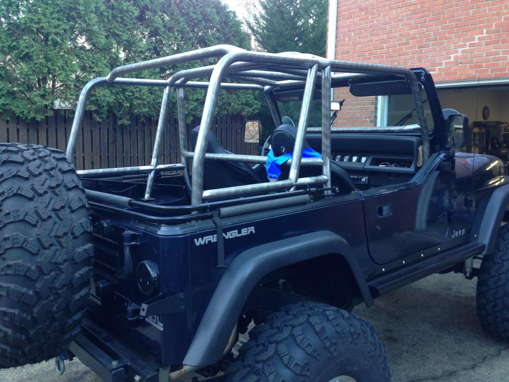

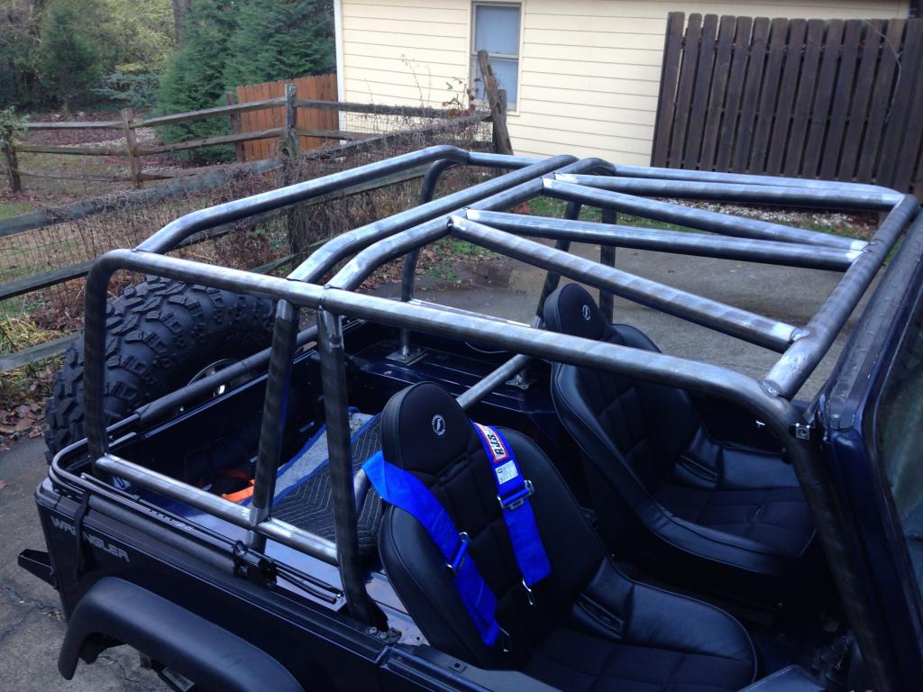

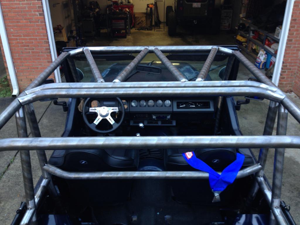

Got a little more done on my roll cage last weekend over the Thanksgiving holiday. Still more to add but it's getting there!

Any more info on the tire carrier? Looks simple, effective, and cost efficient.
It's an old Big Daddy offroad unit. Super simple 2"x4" rectangle tubing and 1.75"x3" tire carrier tubing. I picked it up from Tarheel 4WD several years ago. It doesn't rattle or squeak and you can actually haul something with the rear recovery point since it's built so stout unlike the Warn rear bumpers that are rated for towing (which is silly for a rear receiver hitch point in my opinion).
