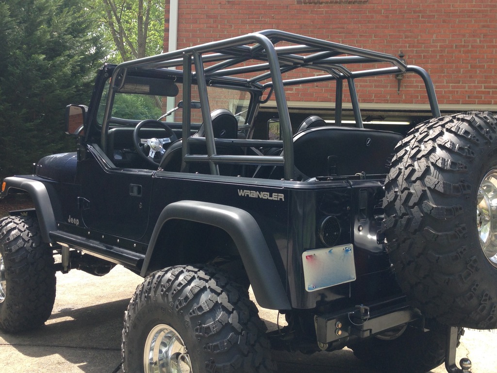

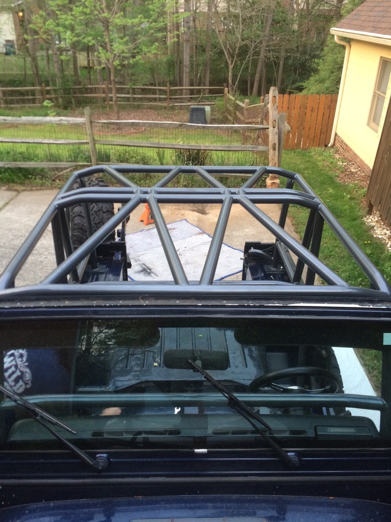

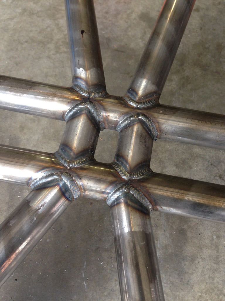

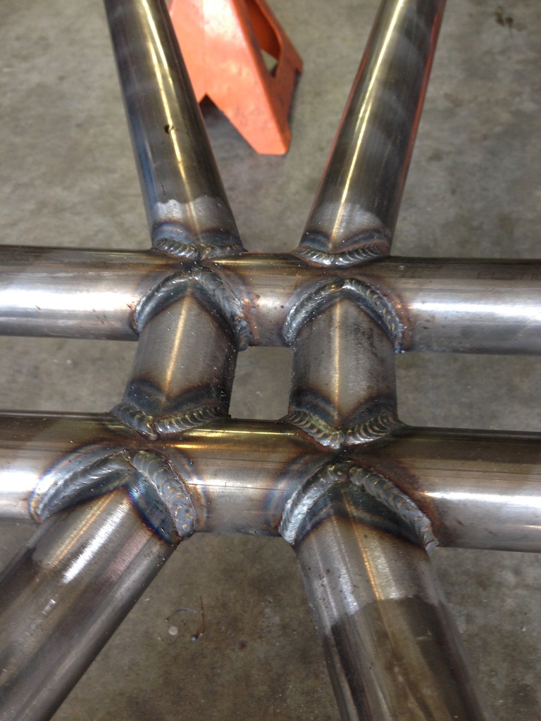

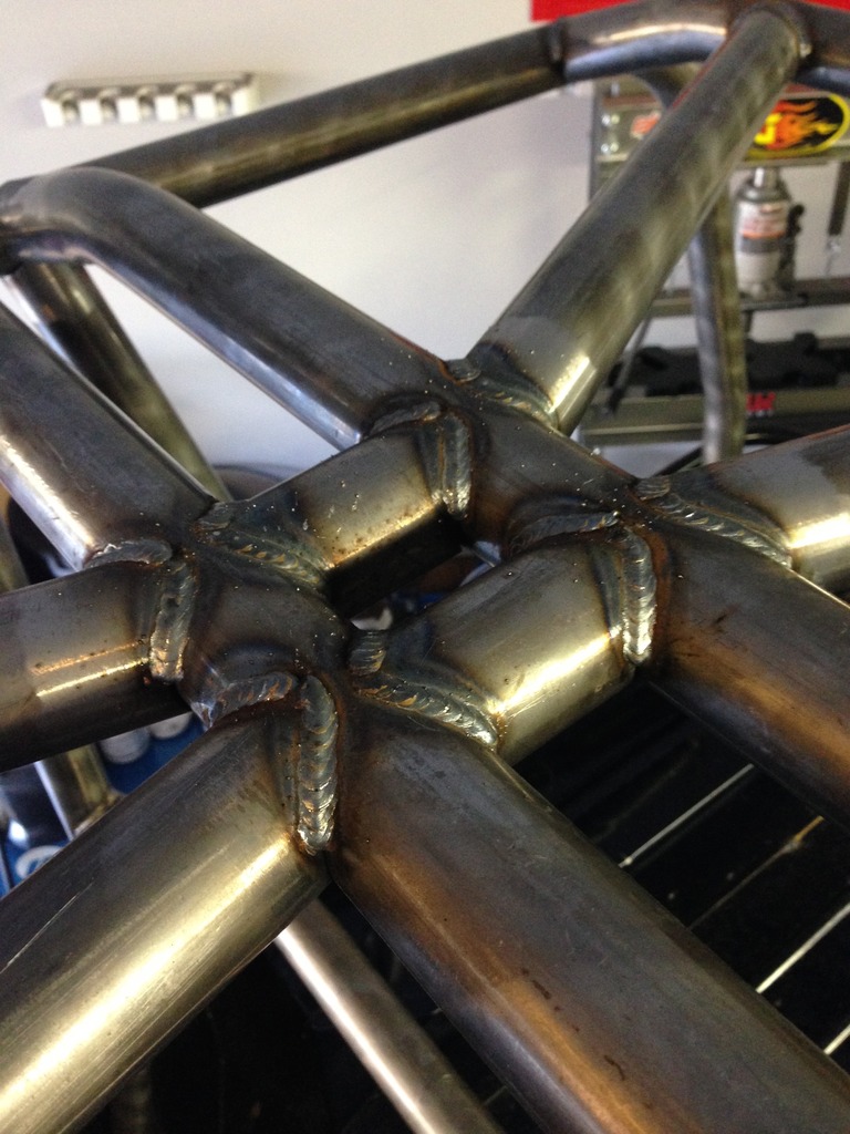

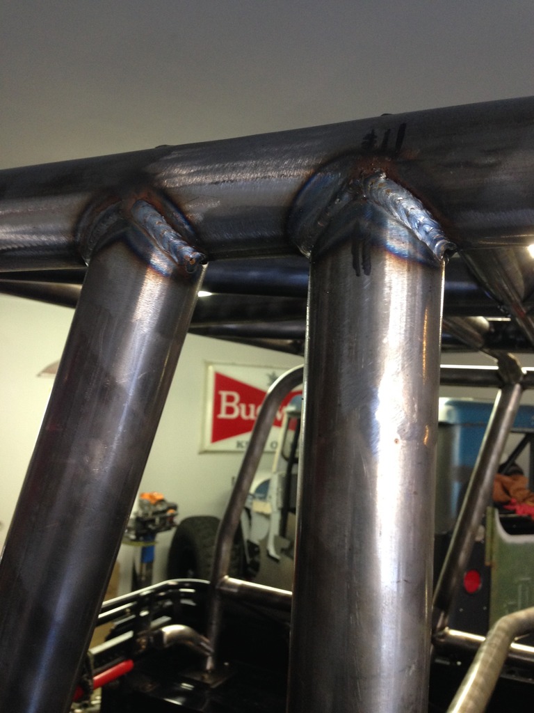

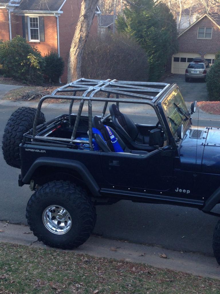

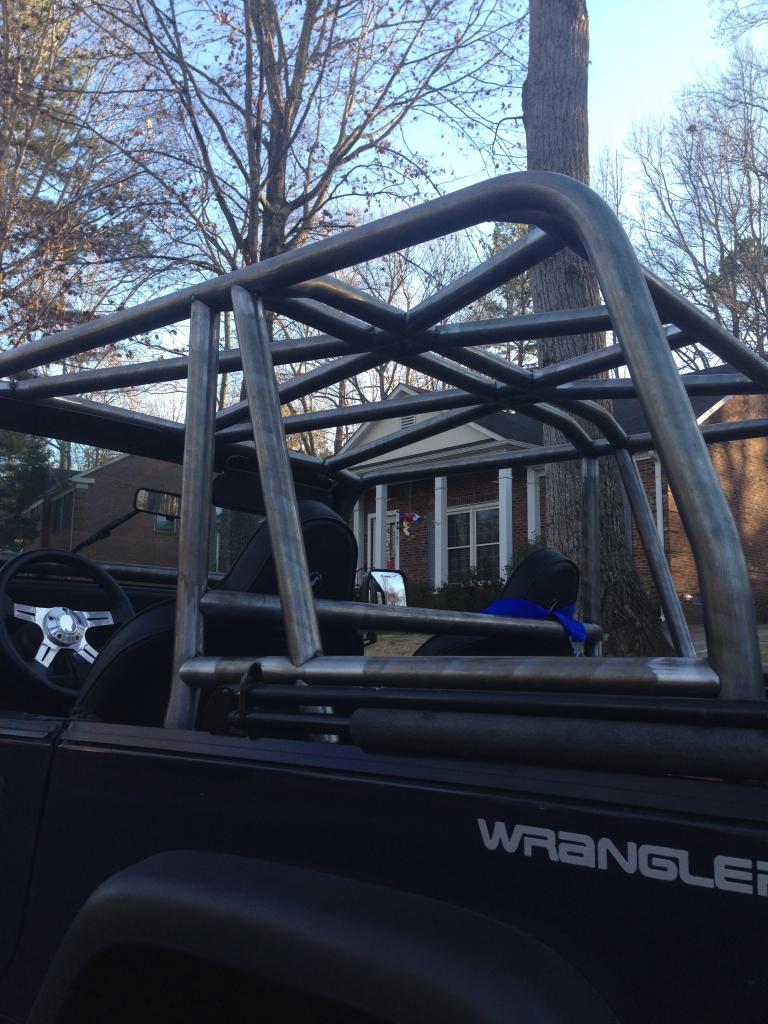

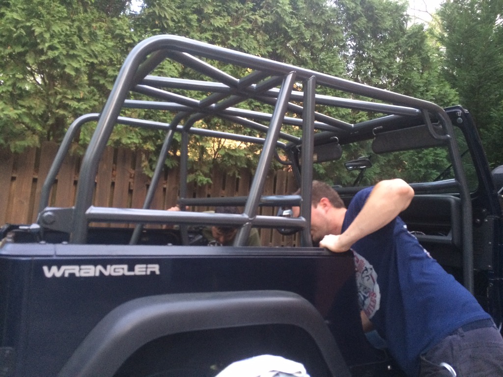

looking good. why not bring the outer overhead bars to the corners of the cage? i know it would be more work, but would make the whole design stronger.
Thanks! Main reason I didn't angle it to the very corner was due to head room and looks. If I angled it over farther it would have angled downward based on the look I was going for and it would have been in the way of your head when getting in and out of the jeep. I will look at it and possibly add a corner gusset piece of tube to attach to the corner. Thanks for the input and idea.
