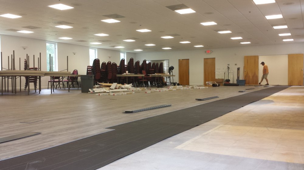

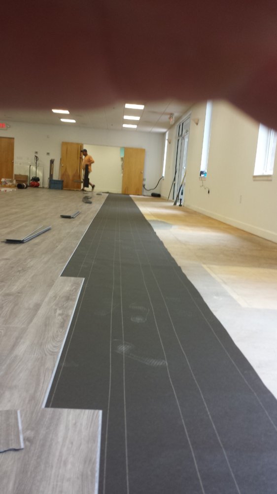

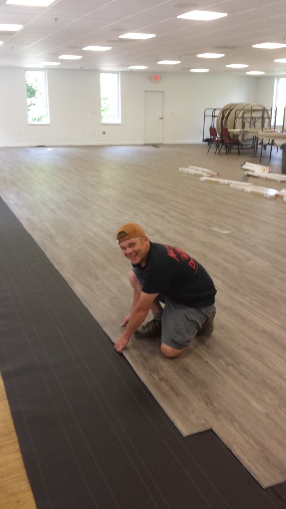

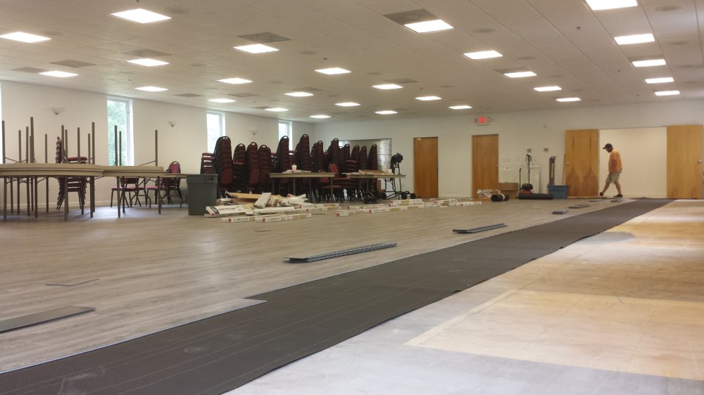

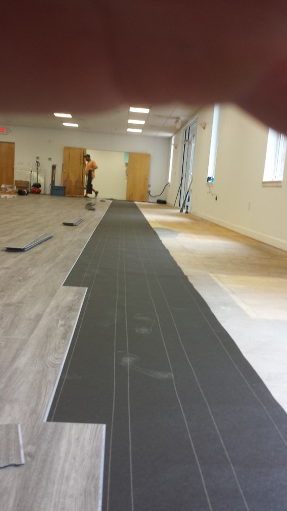

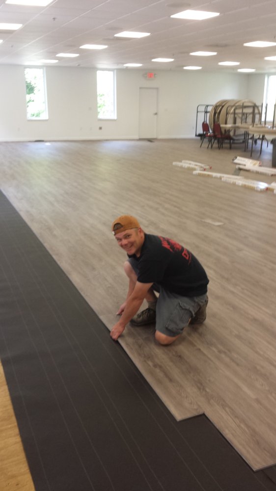

3400 sq ft of vct take up. Using machine and flat hoes.(Followed by at least 14 sheets of underlayment /remove and replace. Lastly covered by 3400 sq ft of lvt or luxury vinyl tile (plank)..move 40 tables..175 chairs twice.and all new mouldings.
And with a 50 ft hallway entering this room, 30 ft sock feet slides were in order. Until bobby busted his ass and cracked his phone.
View attachment 219082 View attachment 219083 View attachment 219091 3400 sq ft of vct take up. Using machine and flat hoes.(Followed by at least 14 sheets of underlayment /remove and replace. Lastly covered by 3400 sq ft of lvt or luxury vinyl tile (plank)..move 40 tables..175 chairs twice.and all new mouldings.
talk to me about that underlayment.
LVT direct on concrete feels like shit under foot.
I want something to "deepen" the pace feel. What are you putting under that in the photo?
Thats #15 roofing paper. We only used it to cover the somewhat sticky residue left from removing the vct. This was a wooden subfloor.
And it depends on who's lvt you are using. This particular brand didn't allow for any padding at all. The locking mechanism would most likely break down over time from the joint flexing when stepped on.
I have installed others that allow for pad and claim it will not harm the locking mech. But it's a thin pad..mostly used for sound dampening
Long story short...read manufacturers instructions on your particular brand.

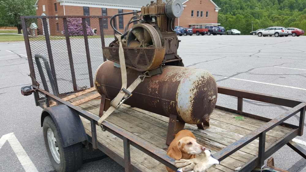

picked it up for free at my wife's uncle's old place. it didn't work in the beginning but then I found where mice had built a nest in the motor. I pulled all of it out and cleaned it and that's when I found one of the wires had come off the brush. Hooked it back up and it took off.
That's an old Gilbarco compressor, now owned by Quincy. They still make that exact compressor and parts are readily available. I bought one in similar shape and had to do a lot of research before I found anything.
that's awesome. thank you for letting me know. I figured it was one of those oldies but goodies and you better enjoy it because the parts are few and far between.

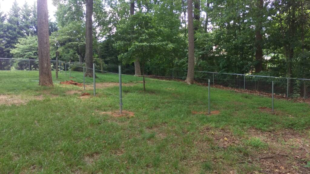

Started my fence relocation last weekend. I took down some existing fence to make my dog lot smaller and give the kids a little more yard to play. The one that's up is a temporary divider. The last pic is of my daughter helping with concrete..

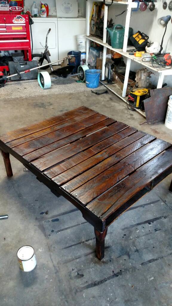

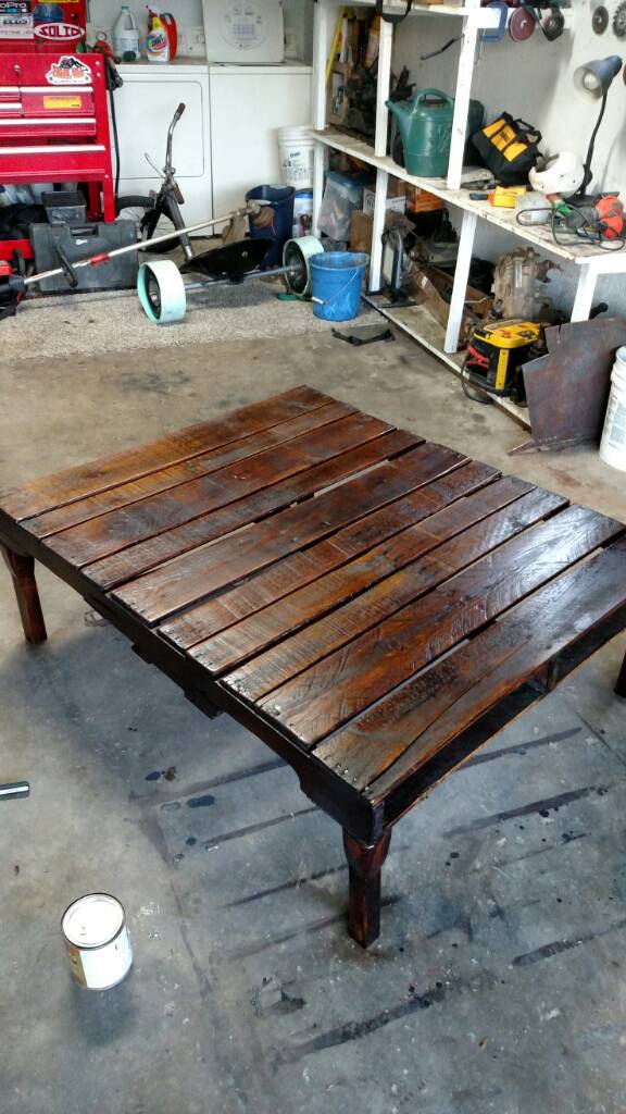

Girlfriend been on my ass for over a month to make her a pallet coffee table. Took a pallet I used to hold firewood all winter and this is what she ended up with
I like the look of that. What stain/poly combo did you use? Got some things I'm gonna be staining soon.

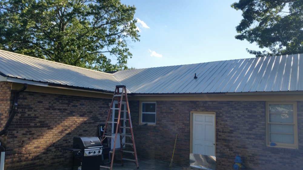

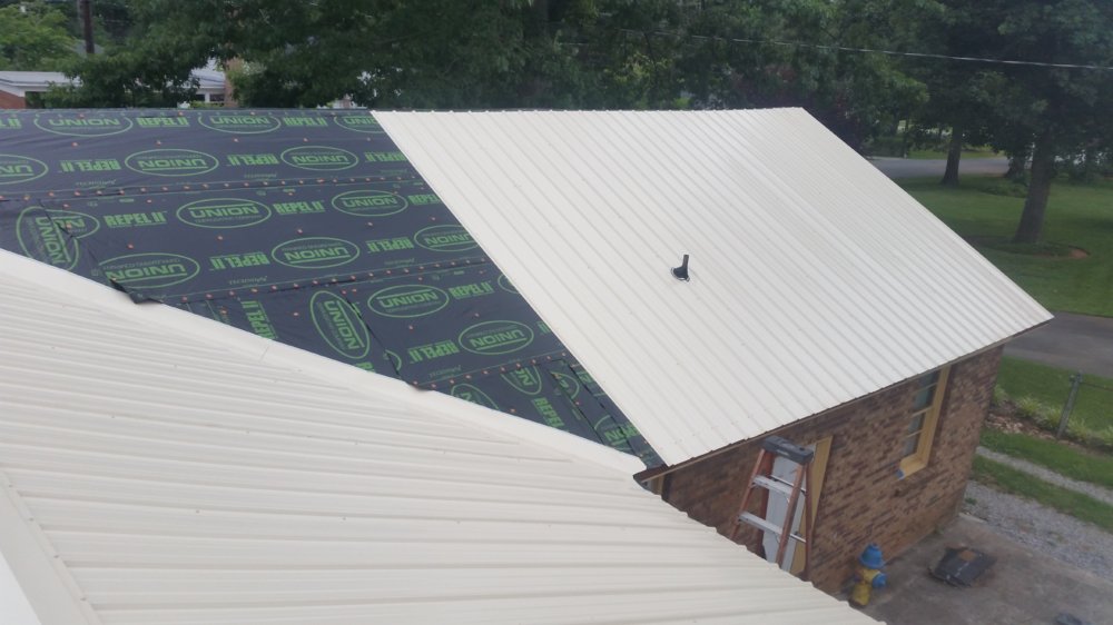

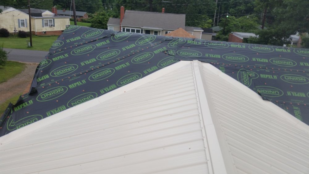

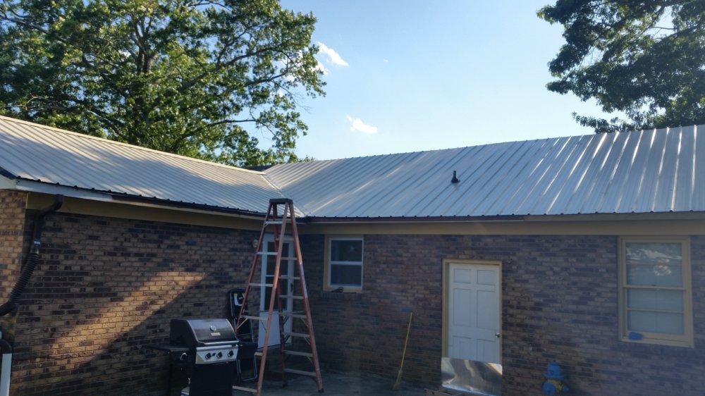

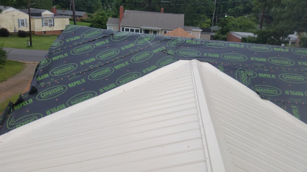

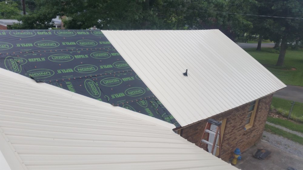

Roofing my house, started Friday at noon last week. Back side is finished other thaN the trim. Will begin the front tonight. This weekend will be brutal in the heat..
That light color is gonna help in the summer (so I've been told)
That's exactly why we chose the Ivory. Highly reflective, blinding when I am installing on a sunny day. But hopefully it will keep the attic temp. down, thus less radiant heat from the ceiling. Lower summer electric bill.
Did you lay out the tar paper nails with a tape measure or did you use a story stick? :huggy:
It's not tar paper. Synthetic under layment to go right over the old shingles. Story stick? I just rant it according to the over lap lines printed on it. Just at an angle on the last of the main roof. seemed easier than cutting small pieces to gut up the valley.
I was referring to the almost OCD attention to placement of the nails. Looks fantastic, like you've done that a few times.
I would take credit for that but the under layment is printed for the nail placement. However I have done many of this style metal roof. Just not on old houses, mostly storage unit buildings. Back in the mid 90's I build about 90% of them in Lincolnton & surrounding areas & several in charlotte.

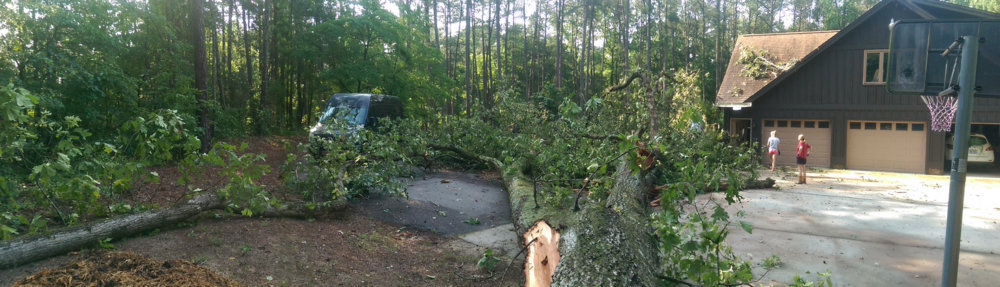

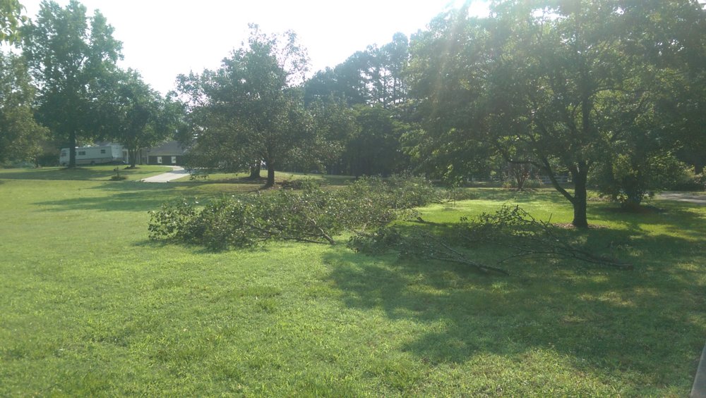

Last Friday's storm cracked one of the Bradford pears at the street in two. Limbed it up and drug it out of the road at 10pm in 110% humidity. Spent the better part of Saturday dragging it down behind the house to the chipper and turning it into mulch.
