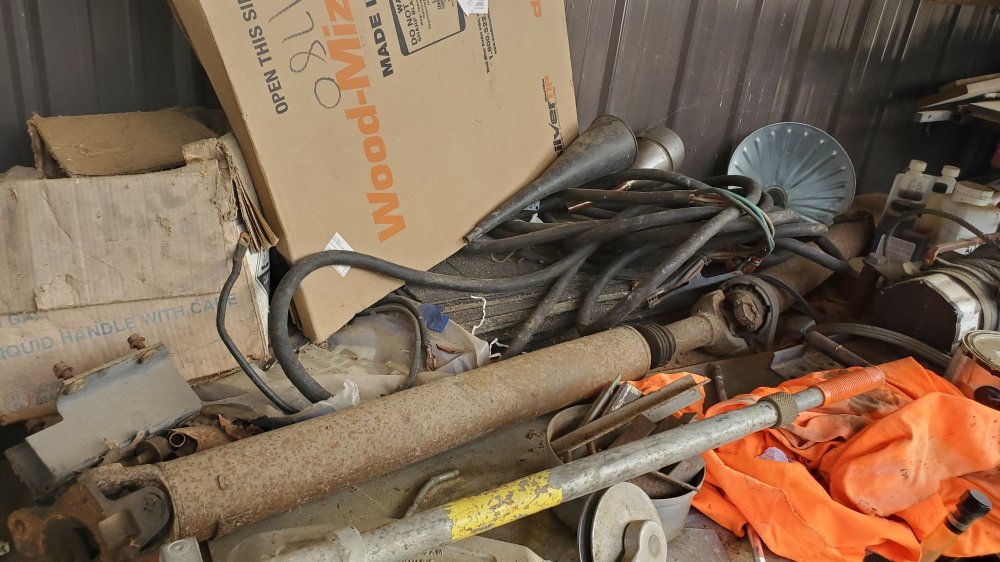

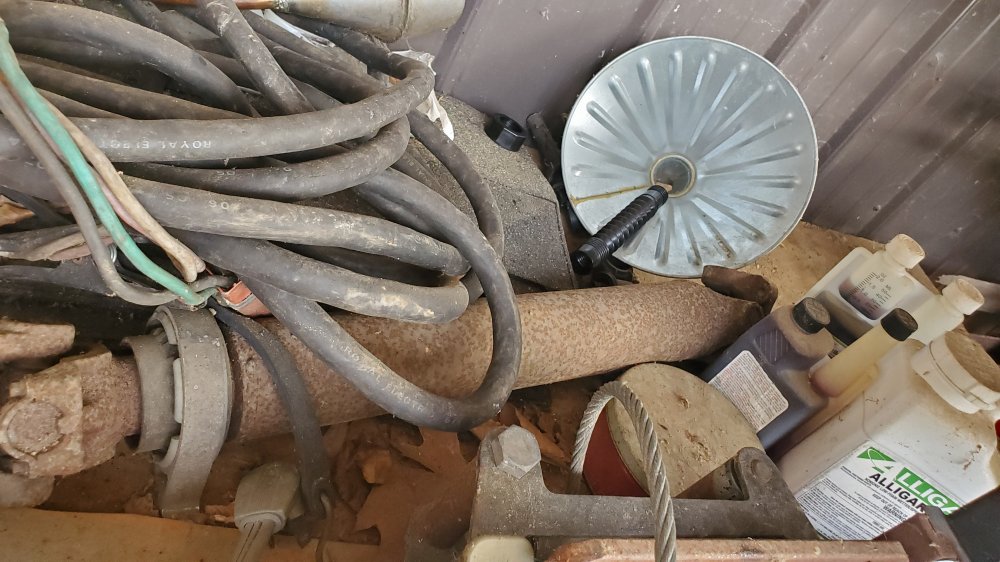

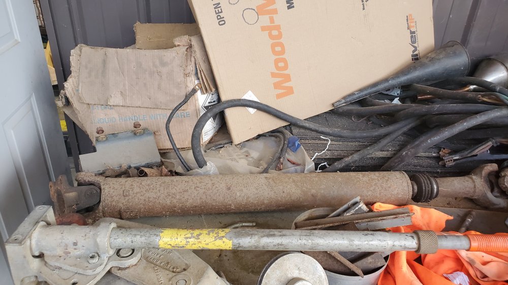

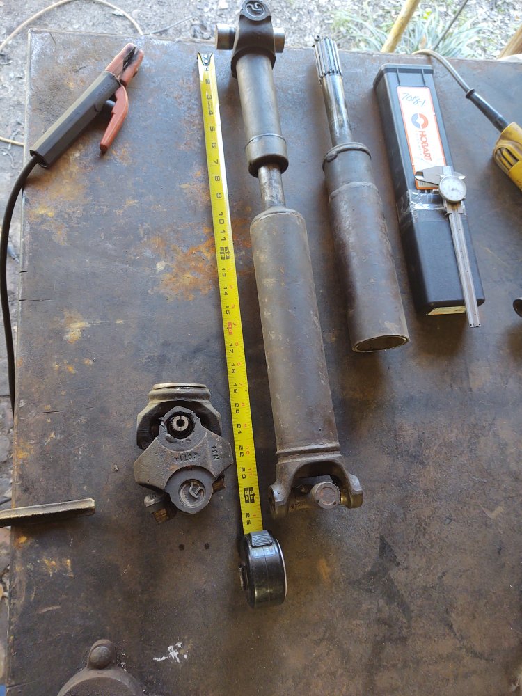

Spare parts for the win, again. I love NP205s, especially the Ford models. 32 spline outputs front and rear with a convenient selection of interchangeable yokes. What I did here was use my old front driveshaft that has 1330-1350 conversion joints in it, and spliced together a combination to get me by for a while. This is when being a parts hoarder really pays off. All I gotta do now is burn a few 7018s and go for a test drive. At an overall length of 24.5" (cap to cap) with some very careful sleeving, I can usually get it close to true. I will have to adjust my rear pinion angle a bit going from a CV shaft to a double joint style, but I've got all day to fine tune it.
Well, the ghetto riggery worked. It got me to work. That's the important thing.
