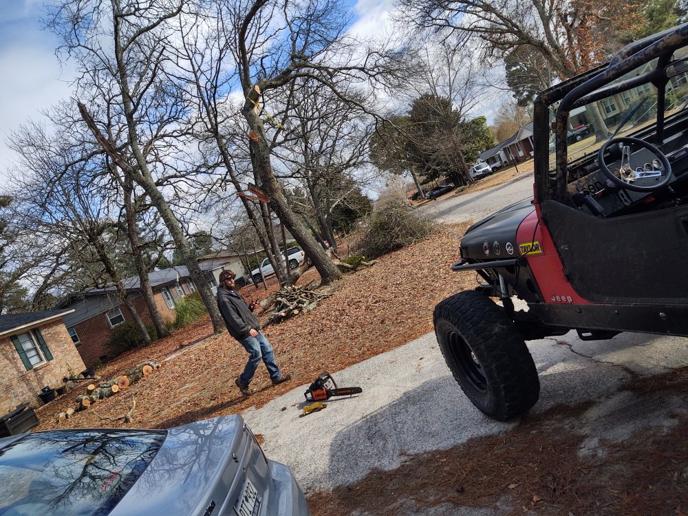

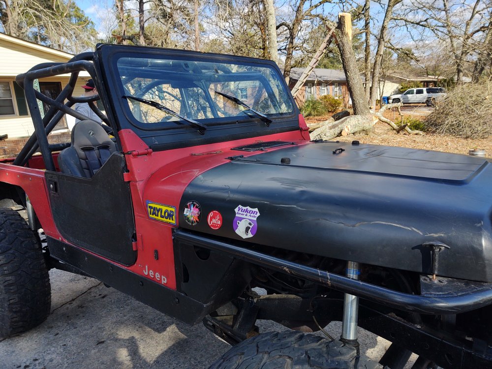

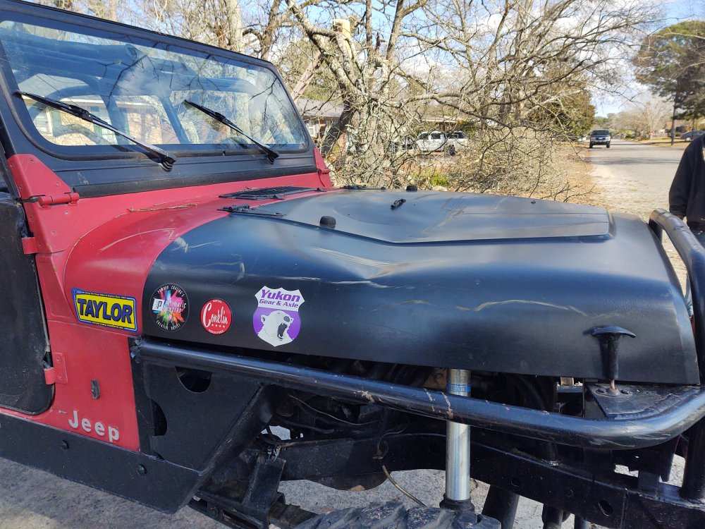

Went over to some friends' house to take a 50+ year old oak tree down.
Who was there?
Dieter. Stuyck company's old powder coater.
Jeff (CNC programmer and manager over powder coat and sandblast now)

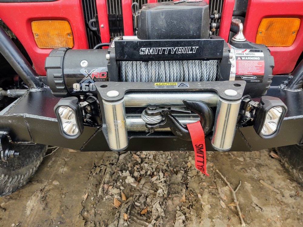

Smittybilt is working just fine.
Tree fell on the Jeep.... Fuck it. Where's my hammer?

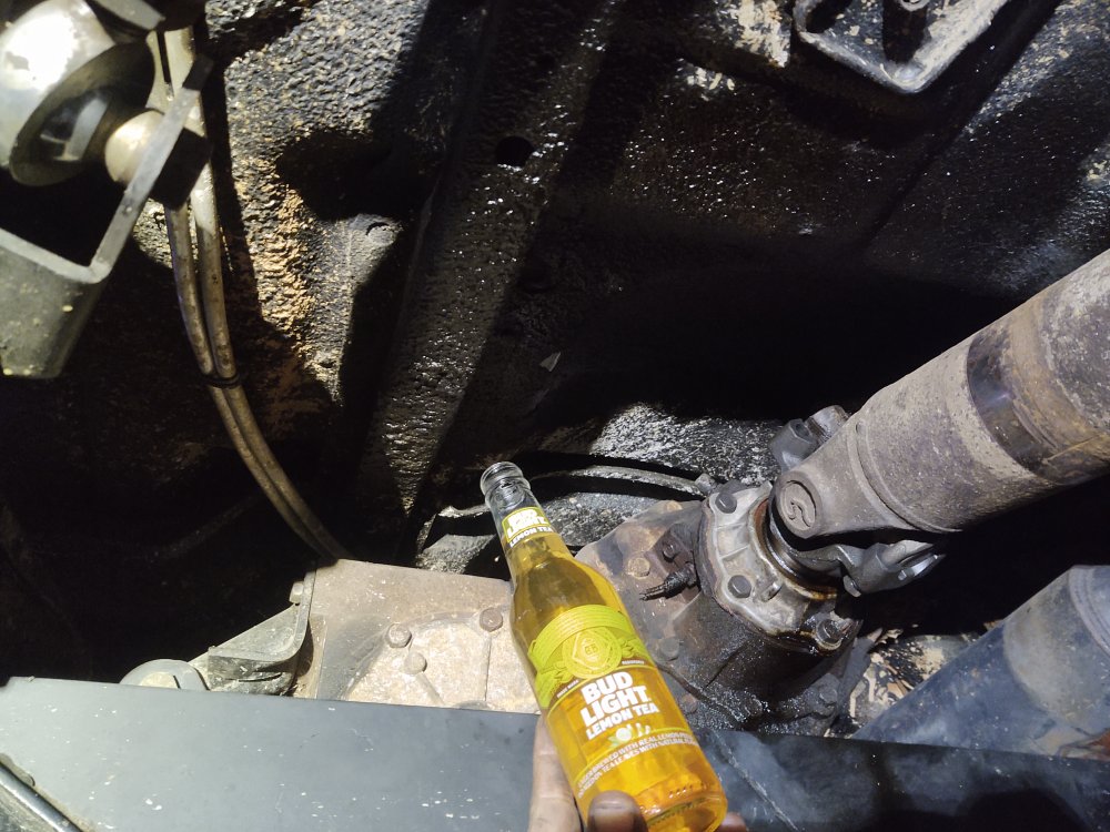

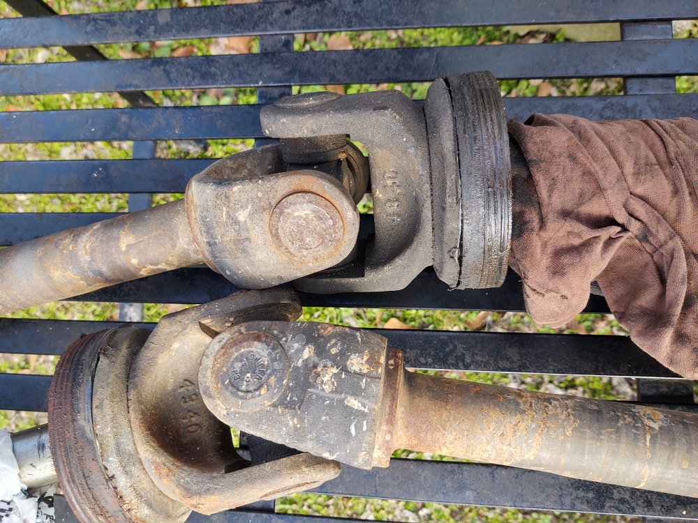

My new junkyard 1410 SD driveshaft has been great. The breakages I've endured in the last few months have taken their toll on the NP205 rear seal and/or bearing. Resourcing my spare parts cases for the bearing, and opening up Amazon boxes of 205 seal kits to stop this irritating leak. Cold beer, cold nights, wrench parties in the backyard. Who still does this? It's starting to feel very lonely.

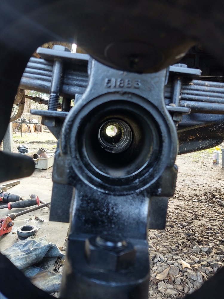

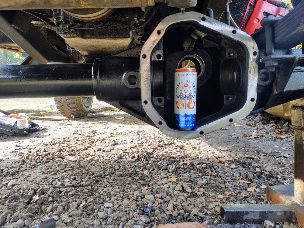

Yesterday I did a full strip down on the 60 front, all but unit bearings obviously, just because I fully intend to head up to head up to Morganton to finish my gear install. Fuck doing it alone in my back yard.
Got yet another parts list to order for miscellaneous 60 stuff.
The more I poke around, the more I find to upgrade and replace. That's the Jeep life. Again, it's starting to feel very lonely out there.

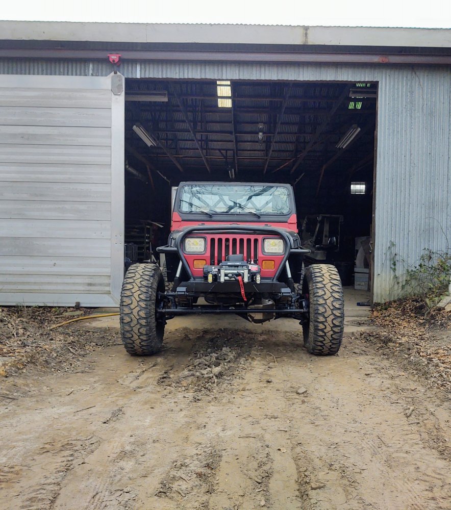

Here's a few miscellaneous things I've done lately. I haven't spent hardly a dime on the Jeep aside from gas money. The front axle is still stripped down until I can get around to doing the gear and spool install.
I noticed last time I used the winch that the 90 degree fairlead mounting plate is prone to bending under off-angled load. I remedied that by adding 45 degree gussets to stiffen it up some. While doing that I also used them as mounting tabs for some front facing LED lights, which will come in handy for trail use. Normal headlights shine straight out, rock lights shine straight down. I wanted something in between.

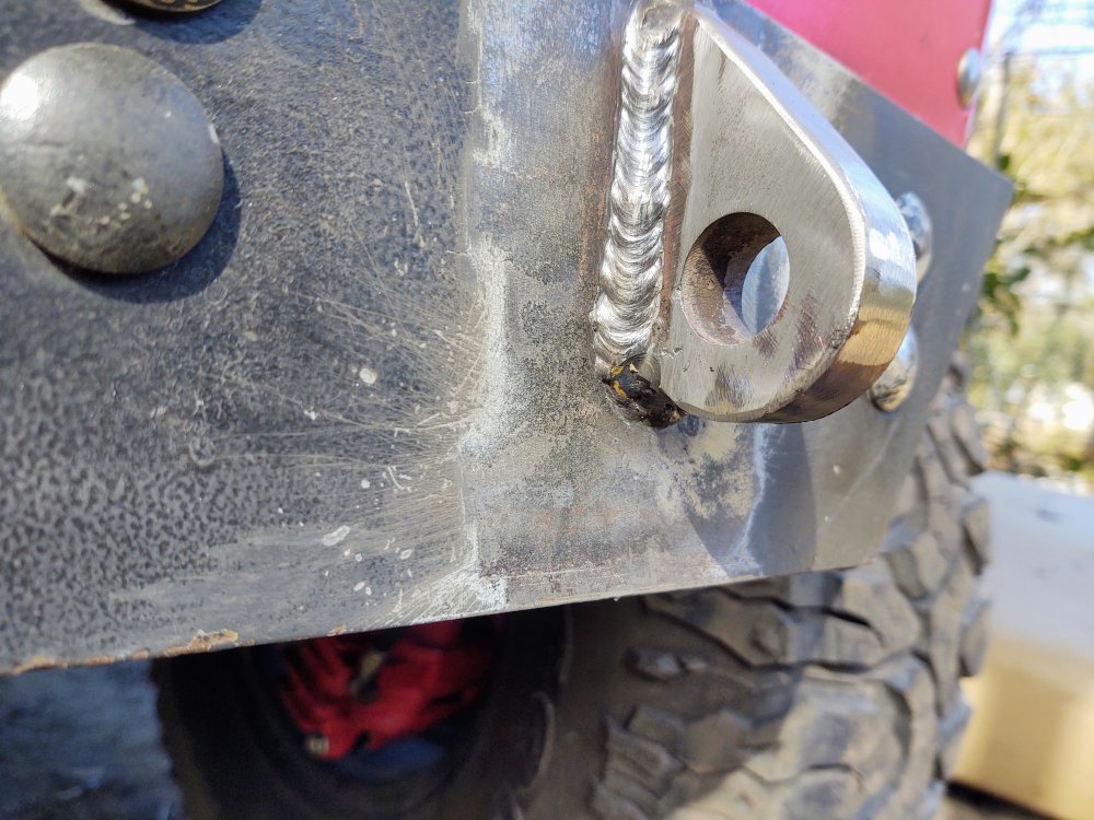

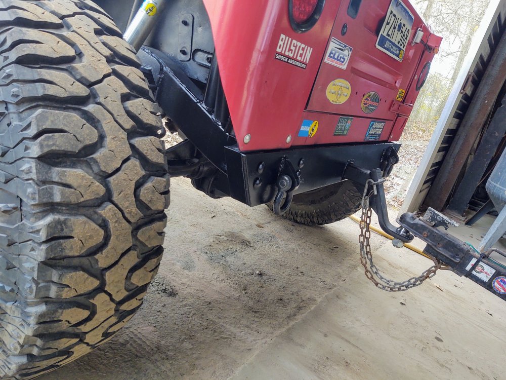

I also did a few reinforcement gussets on my rear bumper. As it was, the bumper was only secured to the frame by the 8 factory mounting bolt configuration. Any heavy pulling or snatching I did was starting to fatigue the factory frame tabs, so I welded gussets from the bumper directly to the frame. And I also added some 3/4 D-ring tabs that I had just laying in a box.
It's great not having an expensive list of things to buy and being able to enjoy just driving it.
Using E7018-1s. The D-ring tabs are 3/4" thick A572 steel, heavily beveled and multi passed welded to 5/16" base metal. 100 amps DCEP.
Awesome! I feel like if I did that I would have some undercut issues bothering me. You tap the amps down a tad for this and hold a super tight arc?
I kept the same amperage, just on the last pass I clamped up an 1/8" rod. The ones beneath it are 3/32". All 7018

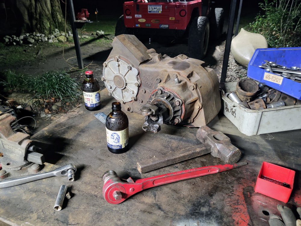

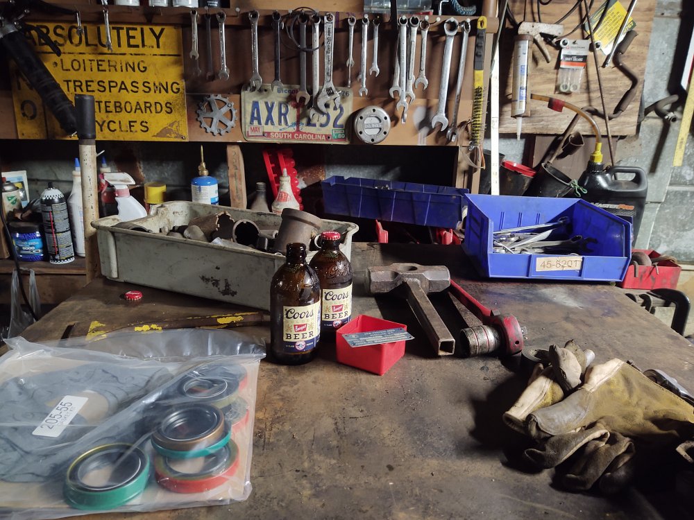

In other news, I'm building another Ford NP205 to replace the one that's currently in my Jeep. Not that there was anything wrong with it, but since I have the luxury to bring it into work and sandblast it on lunch break, may as well. This one is out of my friends '78 Bronco that I got for practically nothing just for pulling it in the rain.
Also got a seal and gasket kit waiting for it after I sandblast and paint it, just chilling here on my backyard shop table.
Are you going to shave the top, to allow it to clock up higher?
I don't plan on ever clocking it. I use the wedge top for a torque mount similar to how it was in factory trucks. The fact that the bottom of the transmission hangs down two inches farther than the tcase does makes clocking the 205 seem pointless. Plus then I'd have to modify the shifter. I'd also likely have interference between the front driveshaft and the clutch arm as well. My belly is not flat by any means. With the transmission hanging down as far as it does, it would be impossible to get it all flat anyways.

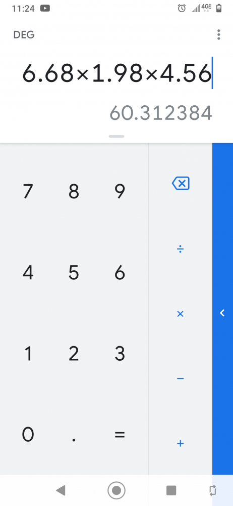

The time I've spent so far in 4-low has been pleasant back when I was 3.73. I'm 4.56 now. This is my crawl ratio now with 4.56 crunched in.
Also having a weighted flywheel helps. It's very hard to stall in granny or reverse even in 2wd.
