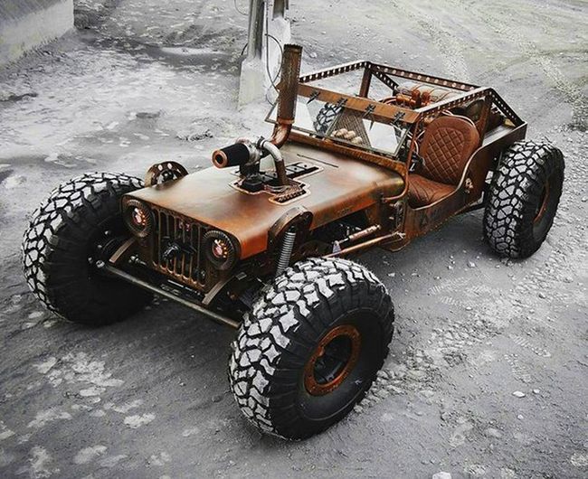

Saw this, thought you'd like.. Check out on You tube: A Steampunk Hot Rod That...Turns ? / Big Muscle
That's ashamed, apparently done before trouble, looks like he does great fab, just can't manage business.
