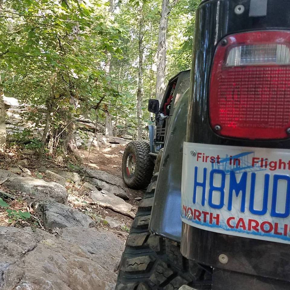

There is an open ride at the shop April 13th I'm shooting for..... care to join me?
Dang, I should try and go to that...that's my birth anniversary!
