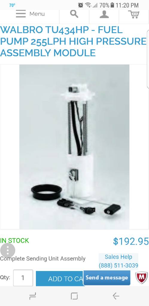

@scotch737 Do you happen to remember what year pump this is?

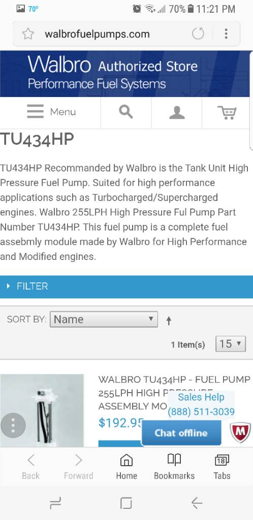

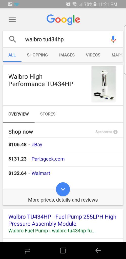

Is that a factory Chevrolet fuel pump to feed the ls? If so I can give you the walbro upgrade replacement part number with the 255lpm high output pump I'm using. I found it on eBay for less than $150 iirc.
Walbro tu434hp

Thanks Marcus. Let me get a price locally on just the sending unit and compare the travel logistics.

FWIW I paid 180ish dollars for a new pump/ sending unit at O'Reillys in Moab when my upgraded pump died on day 2 of the trip.
