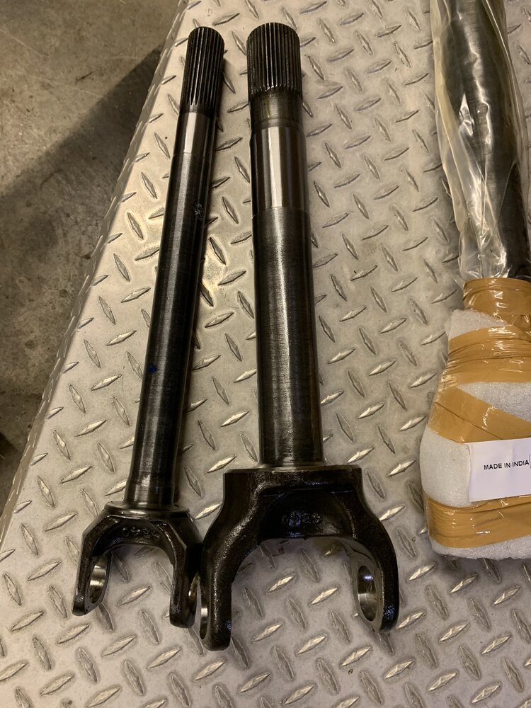

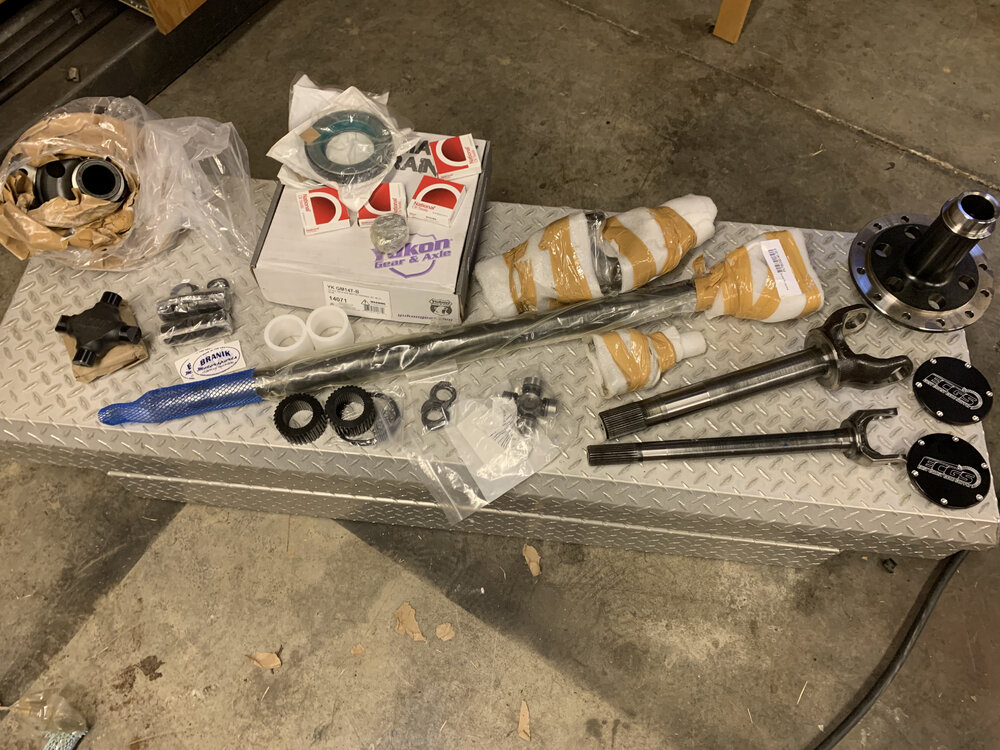

Do they make a locking hub for 40 spline shafts? I wanted to go with a spool for strength. I do think they make a 40 spline grizzly locker now for a 60.Spool and slugs? You may not see a lot of pavement, but there’s probably enough “green” trail between Harlan and Windrock to maybe rethink that decision. Just my $.02
He'll be fine with full hydro and a front digs.Spool and slugs? You may not see a lot of pavement, but there’s probably enough “green” trail between Harlan and Windrock to maybe rethink that decision. Just my $.02
I think he meant locking hubI believe ARB has a 40 spline model.
Edit* Eaton, ARB, and Yukon all make 40 spline lockers and are ECGS website.
Make sure you have your U joints phased the same when you install the shafts and that will help with turning and binding a lot, as @adamk learned.
I haven’t even thought of that. ThanksMake sure you have your U joints phased the same when you install the shafts and that will help with turning and binding a lot, as @adamk learned.
Moving parts scare me inside diffs. I feel like a spool is simple and strong. Also cheaper.I believe ARB has a 40 spline model.
