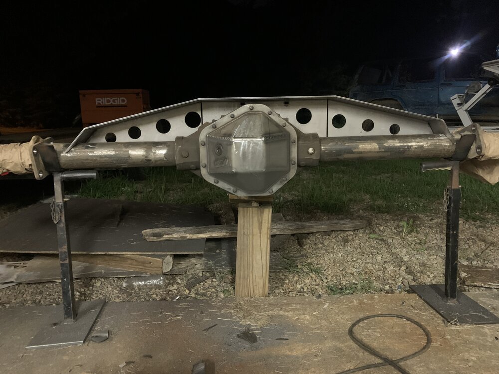

Rear axle ready for truss. Need to weld up where the drain plug is on the newer axles.

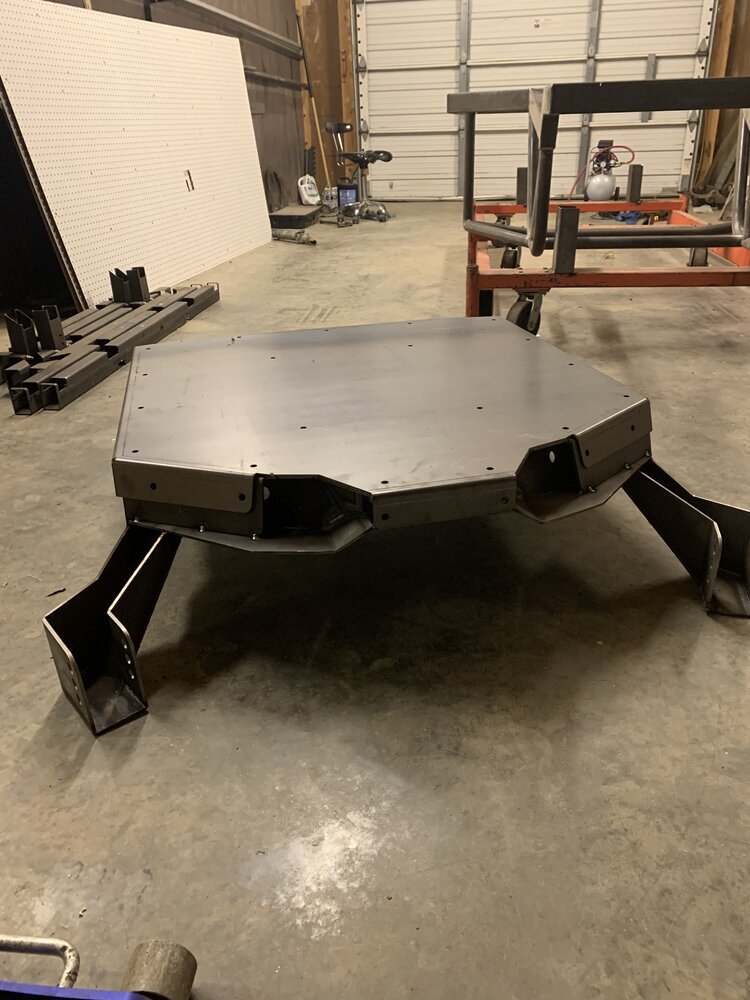

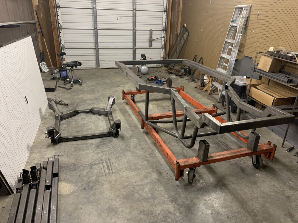

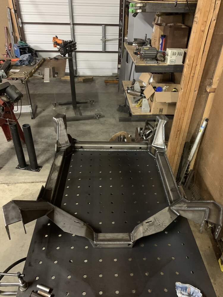

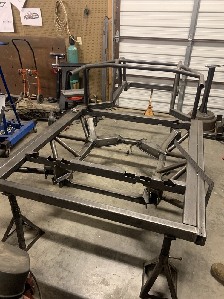

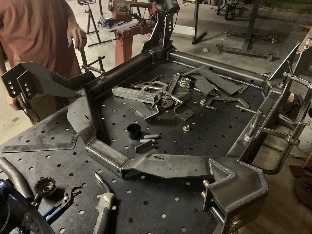

Subframe is almost done. Chassis is off the jig. Making a little progress. Hopefully going to be done by January 2023 for KOH :smokin:
I’m sure you can tell which welds are mine and which are @hurt4x4 ’s

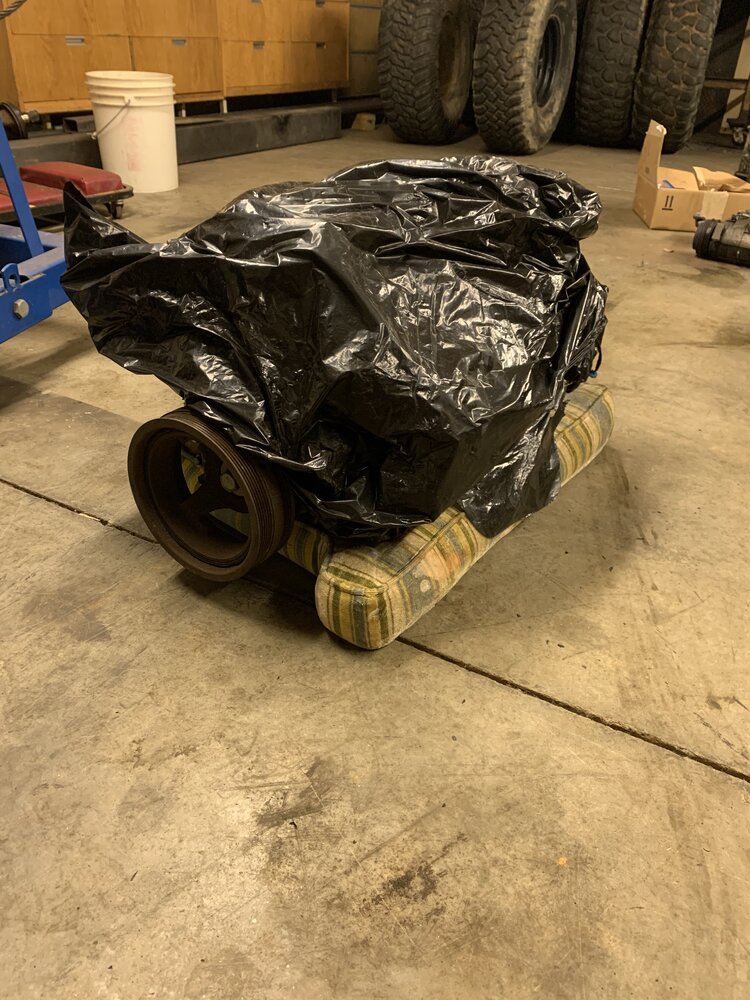

Finally brought my motor home from work.

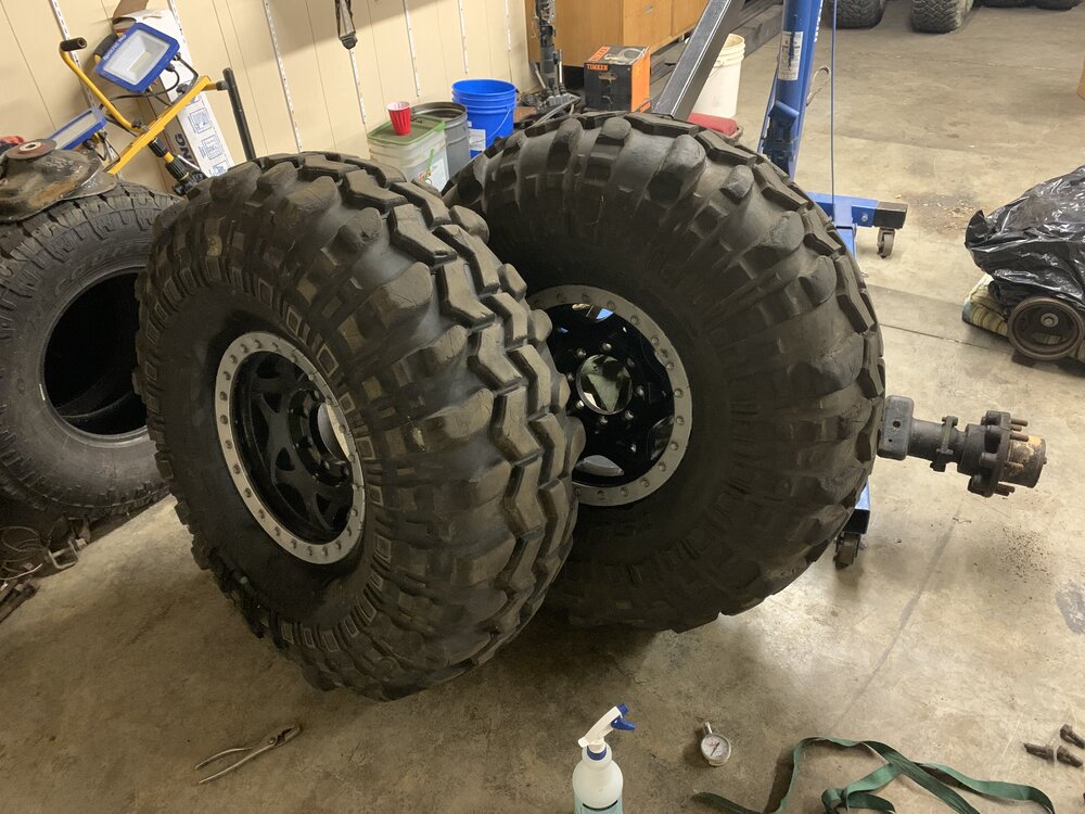

Mounted a couple tires up. Need to repair the other wheels so I can mount more tires. The Walker Evan’s beadlocks are bent and cracked on the inner lip.

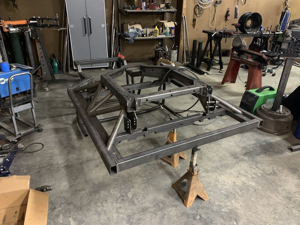

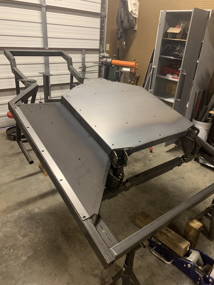

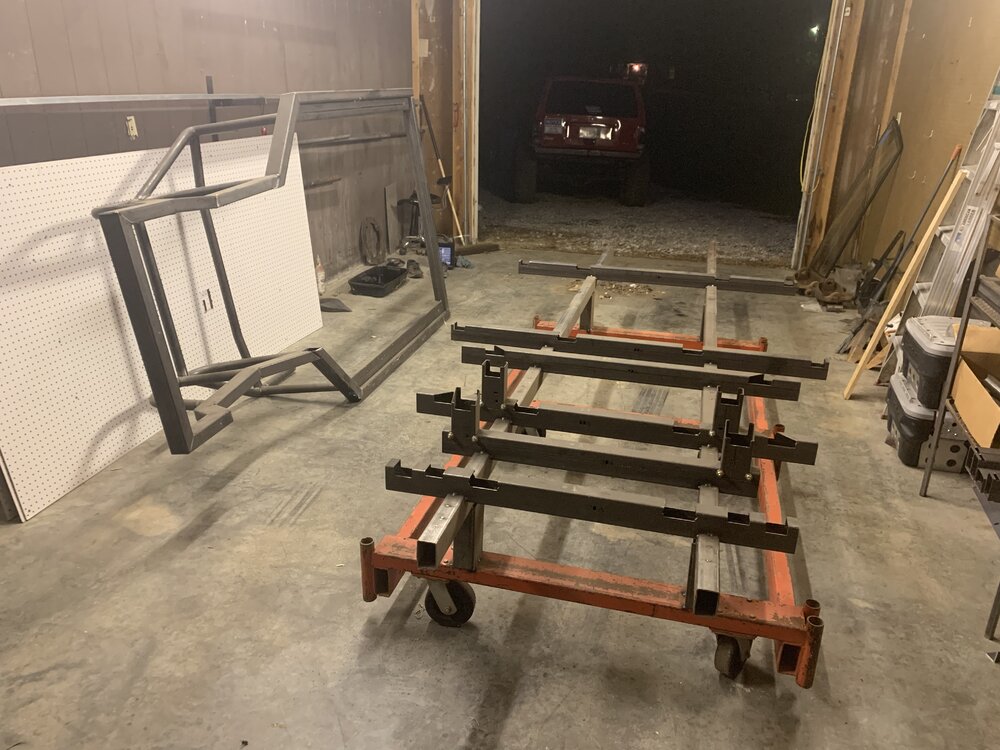

So much welding on this thing. Feel like we are making progress though.

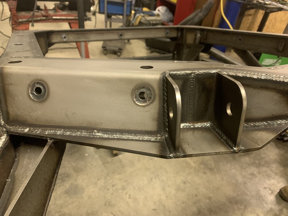

The rear crossmember is going to have to be modified. The upper link is going to hit if I want to keep a lower belly height.
I’ll address that down the road.

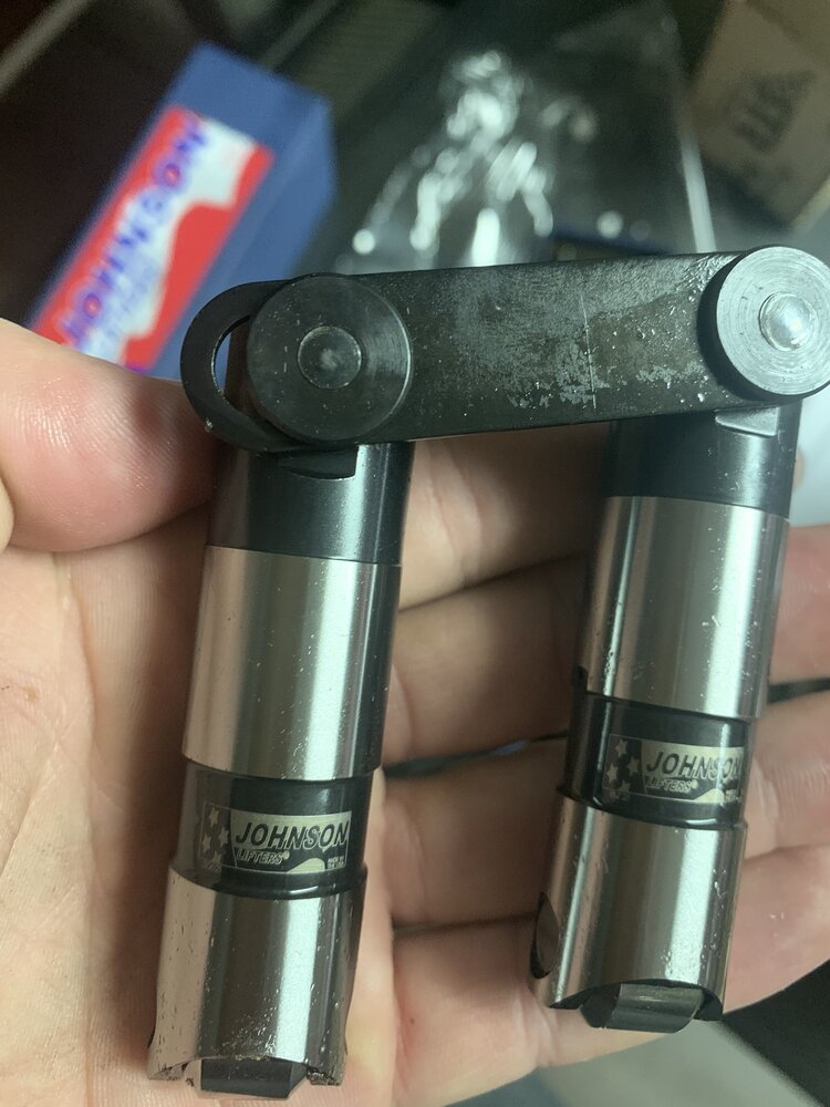

Custom cam, Johnson link bar lifters, CHE trunnion upgrade, springs, new push rods etc. are on the way.

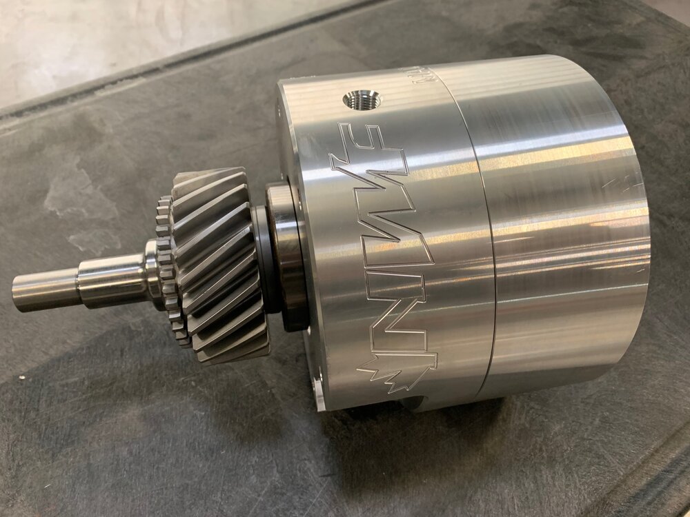

Also decided to go with the new NWF ECO 205 range box cause it is much stronger than the traditional eco box I have. Should have a true 4 speed case now.
Once it comes in, I’ll be selling my current eco box.

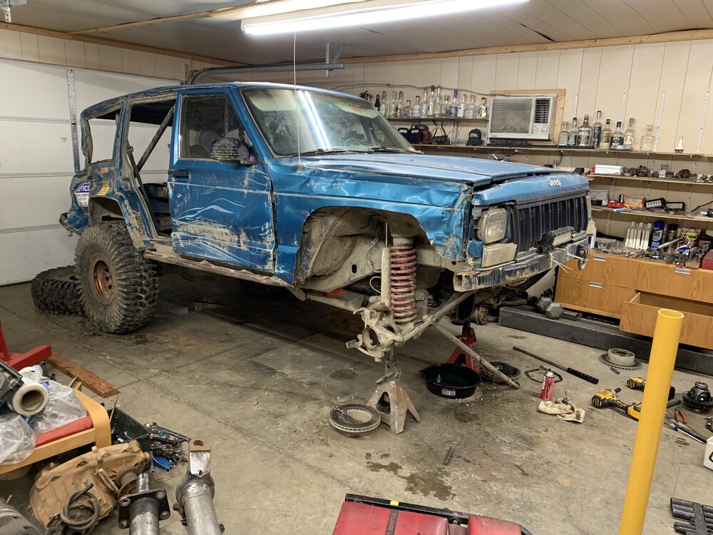

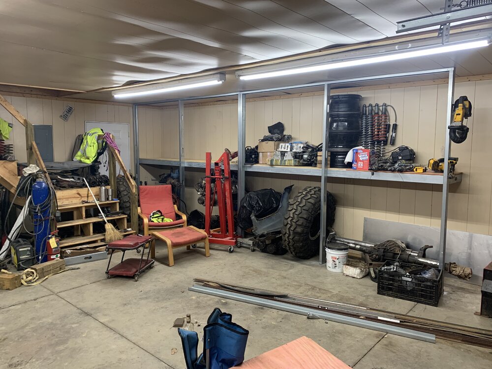

Parts are trickling in. Cam, lifters, etc. are here. Shocks made the ride back from KOH. Cleaning up the shop to get ready to bring the chassis home. Built some shelves to free up some space.

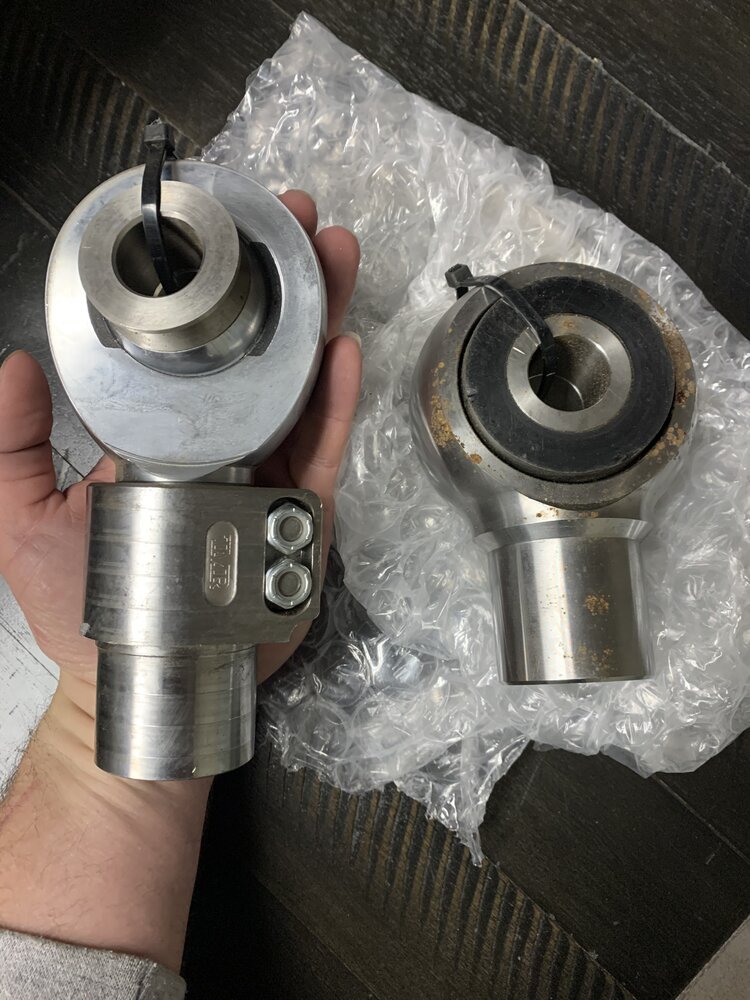

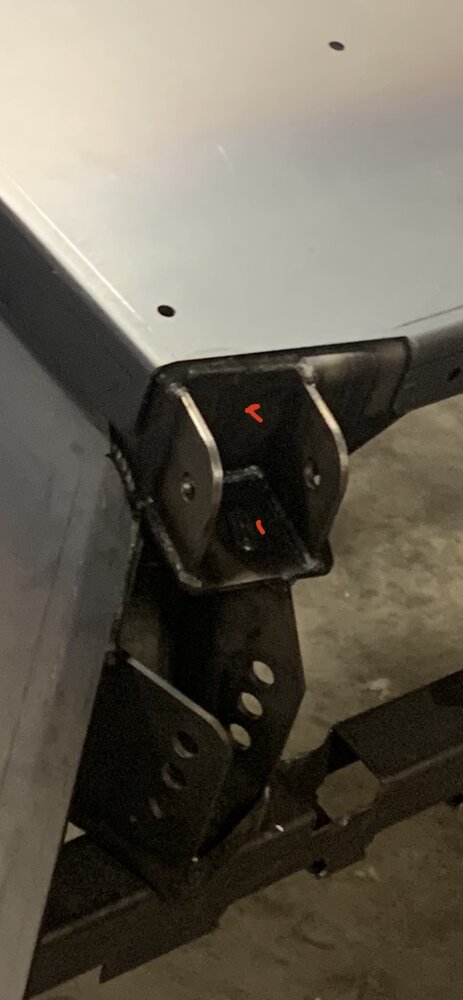

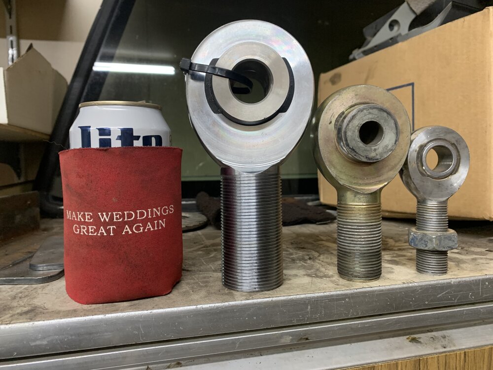

The joints I got for the trailing arms hit the chassis where the red dots are drawn below. Guess I’ll sell these and order the TMR trailing arms.
