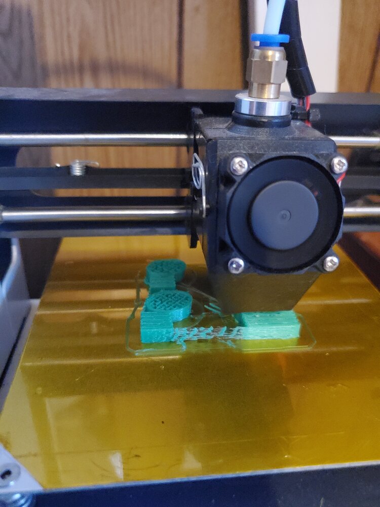

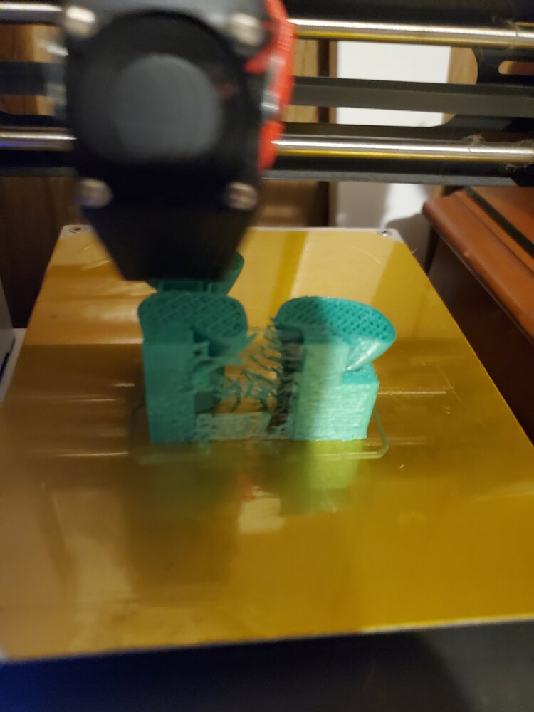

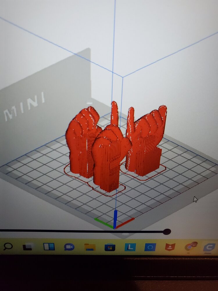

For anyone curious, I'm printing my wife's initials in ASL. We are teaching munchkin and learning ourselves. Need to work something out on the "J" , as it's currently an "I" lol

It looks like you have some dialing in of your retraction settings to do. You might need to get that worked out before taking on such complicated models
You would be correct. Thought I had it dialed in, but looks like it needs more adjustment. Any tips?

The J requires motion to complete the ASL sign. Does your wife have a name symbol you could use instead? They usually do not require motion. Suggested by my wife, who is an Occupational Therapist and occasionally works with deaf people.
yea thats my dilemma is that it requires the motion to complete it. But no, we havent gotten that far yet. David has learned mom and dad in the last few days though.

Here's a great guide if you're not familiar with it already
I'd download one of teh sample models that is a set of pointy towers. Then do a series of tests, varying your restriction distance and speed.
i'm just guessing based on that stringing thats what your problem is, but if you have not yet, before you even do that, do a temperature tower to get it dialed into the right temp.
In my experience the actual "good" temp range of most filaments varies widely by MFR.
Also - is that regular PLA? Is so... my personal suggestion is, get some PLA+ or Strong PLA. Its stronger, more robust to UV, and more importantly prints hotter and is less susceptible to warping AND is more robust to temperature fluctuations.

Awesome! Ill look into that. I know absolutely nothing of 3d printing that I havent learned on youtube. Very good with 3d modeling in solidworks and other programs, just never messed with the printing side of it. As for the PLA, Im honestly not sure. The guy gave ith to me and said "this is everything to do your first print". Which was true. I popped in the SD card and hit print, which resulted in a pikachu. I did order a roll of this
Amazon product ASIN B00J0ECR5I
that should be here today. I started with Cura, but am finding that mattercontrol is more natural for me.

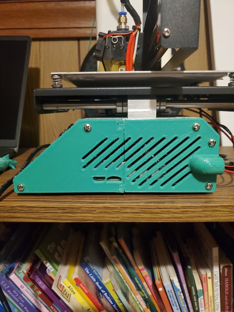

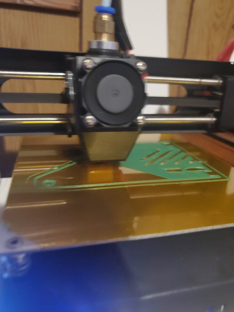

These came out decent. Still some work to do though. This is the fix for the wires fraying due to the way they are routed through the middle of the body.
cool!
I love it when you use a 3d printer to make parts for that same printer. It's proof of how we are definitely setting ourselves up for the Matrix.
Yea I thought it was really neat to use the machine to add to the machine lol. Got a few other mods on the docket as well. A new knob, filament guide, storage cup, and maybe a new spool rack.
shit starts to get real when you recide to start replacing the real parts - better hot end, new extruder, 32 bit motherboard, adding touch sensor for auto bed leveling.
Eventually its the equivolent of a forme Jeep firewall buggy.

Print it as a normal "i" then mount it horizontal on a movable mount so it can rotate through the "j" motion.
It won't be perfect, but close.
