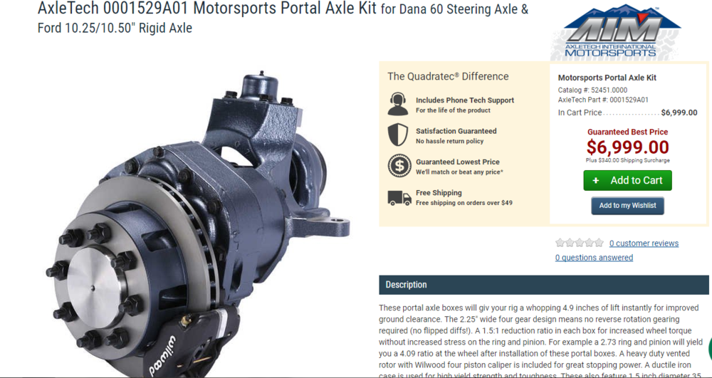

Hmm. So in my theoretical truck build I would still want to use it as a "truck". So the front could go full coilover linked suspension as the "load" up there is unchanging, just an engine, bumper, winch. The back would still do hauling duties though so the load is changing from empty bed, to bed w/ camper top, to bed w/ mulch, pulling a trailer, etc. It would still be empty probably 85% of the time, but to say it would remain that way is unrealistic and wouldn't be my intent for the truck.
So what, $10k to do the portal conversion, $5k for front coilover conversion at stock height and a rear traction bar, $2k for tires? Plus a truck?
Or, I could just do the portal conversion and rock the stock suspension plus traction bars for a while.. that would only be ~$12k

Who is still peddling those???
Edit.
Found my answer and the need for a bankers purse.....good lawd. I thought after a while if they didn't fold prices would have crept down some
What does spring under do to that equation?
Springs under is waaaay better than spring over. On a standard axle, the axle forces gain leverage by the distance from the centerline of the tube to the face of the big leaf. Figure 3" diameter tube, so for spring under its 1.5" to centerline plus another 1/2" for the spring pad. 2" total. With spring over, you add in the thickness of the spring pack, so you go from 2" to about 4-5".
Adding portals to spring over makes it more like 9-10". It seems possible with spring under that it might not be so bad since it's swapping sides. +2" for the tube, then -5" for the portal should leave a 3" effective distance, which really should not be that different from a standard axle. But it's 11pm on a Friday, so my math and thoughts might be less than perfect.
To add some more math, let's say your engine has 300ftlbs, 4:1 first gear, 2.5:1 tcase, and 4:1 axle. 300x4x2.5x4=12000ftlbs of potential twist on the axle.
From spring face to axle centerline, it's as follows:
At 2", that's 2000lb force
At 3", that's 3000lb force
At 5", that's 5000lb force
At 10", that's 10000lb force
That's also assuming all force goes to one axle, sufficient traction to handle the torque, midnight math is correct, etc
