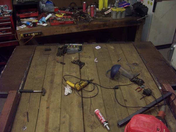

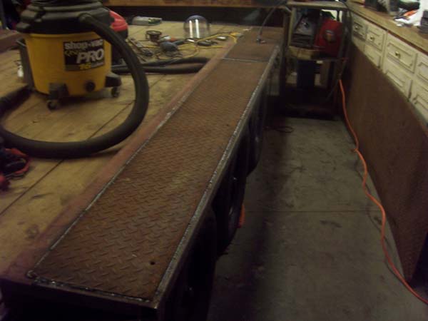

Well finally got some more free time..

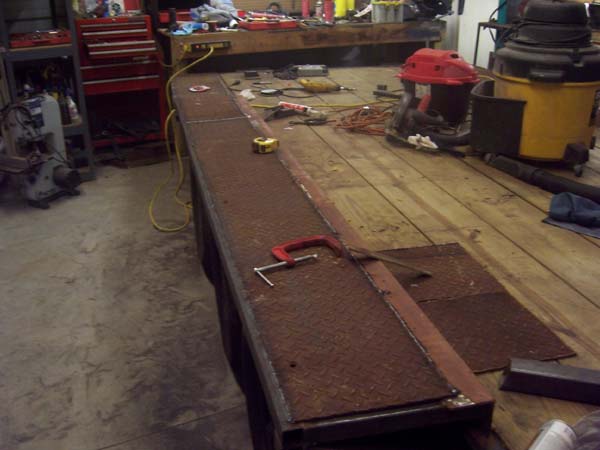

So I jumped back on the trailer.. trying to get fenders done so Jeep will actually fit :)

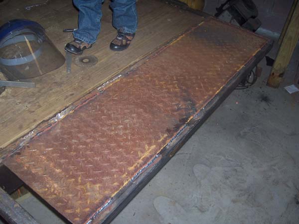

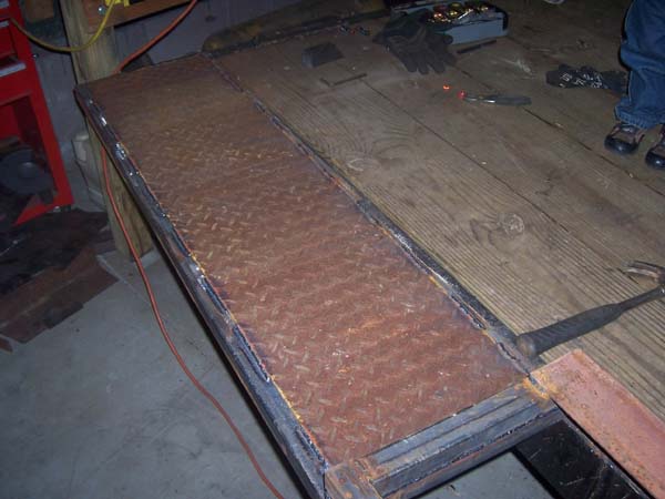

I got the very back rear section on each side framed and 1/4" plate welded on top.
do not mind all the stuff on deck.. big flat things turn into tables in my garage
and my son decided to play hide and seek in the camper

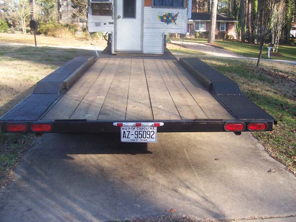

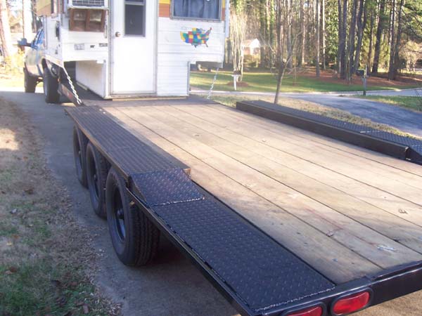

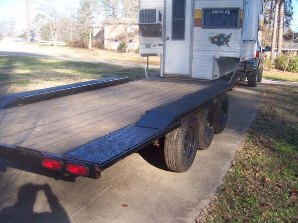

Had the day off.. so I got the fenders over the tires done.
hope to finish them tomorrow and get trailer out of garage..

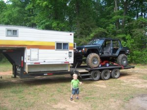

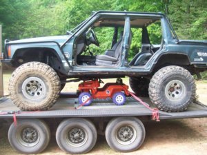

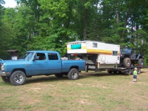

Well Since I took it out this weekend figured I should update with a few pics..

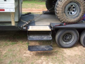

Put steps onto trailer a while back..
and finally loaded my jeep onto the back :)
everything worked great

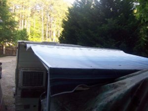

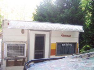

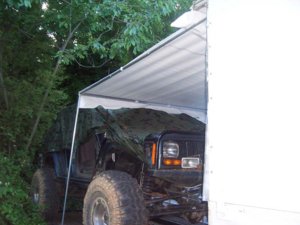

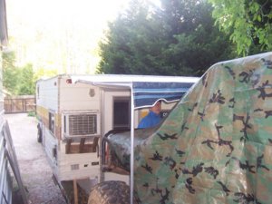

Today I decided why not attach the awning since I have it..
So here it is.
7'x7'
all closed up
opened

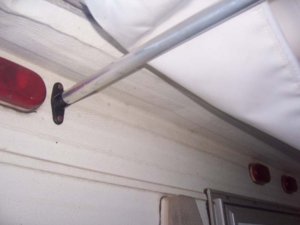

showing leg attachments to camper
