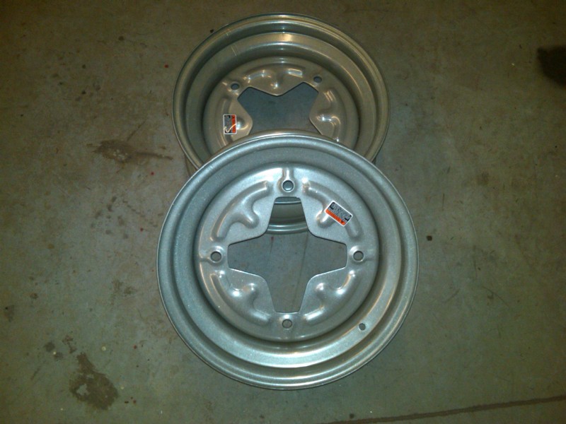

well found a place online that makes reproduction rims for my trailer
so I got 2 of them so I can have spares for next season

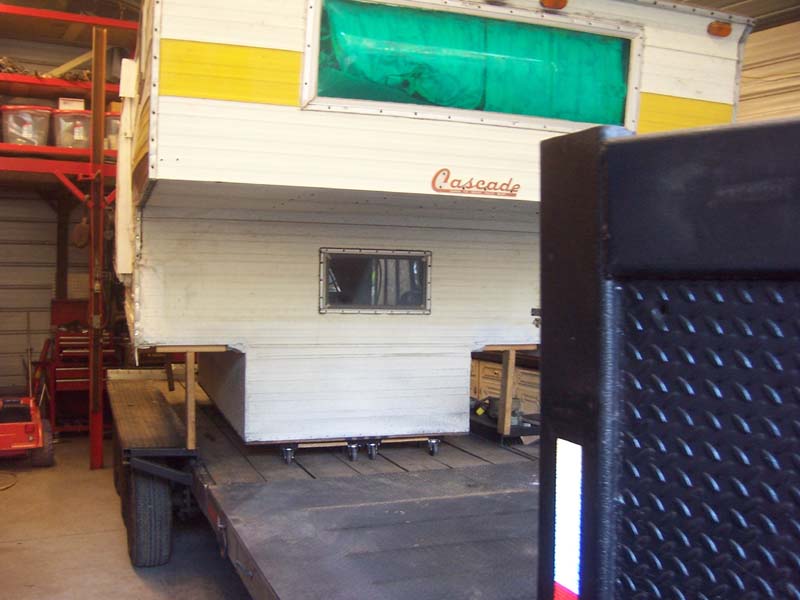

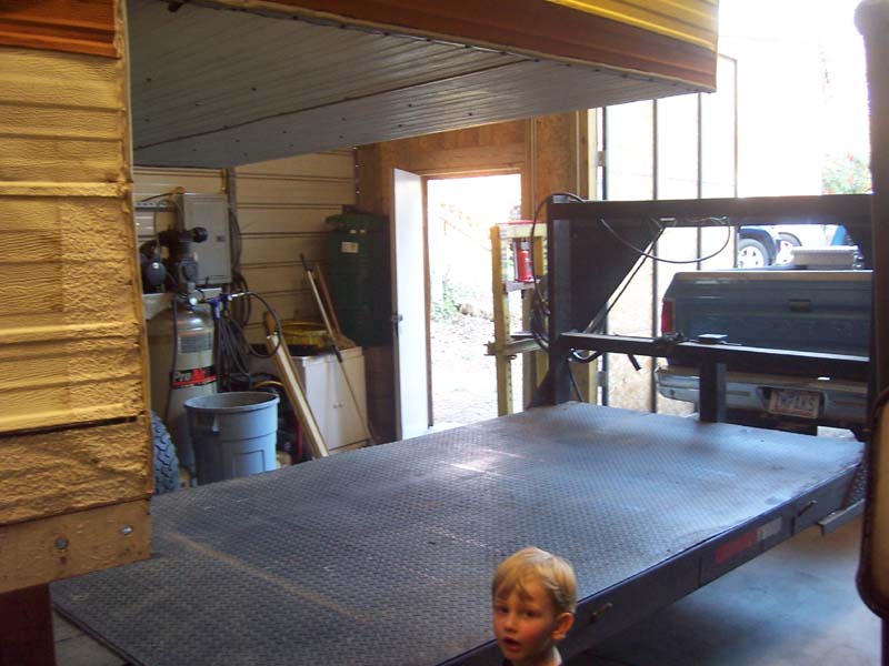

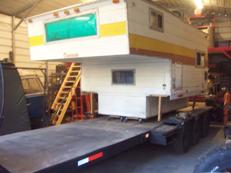

well it is time to modify again :)
lots of ideas in my head to make this even better..
to start I moved the camper back about 10 feet on trailer deck for tomorrows delivery
