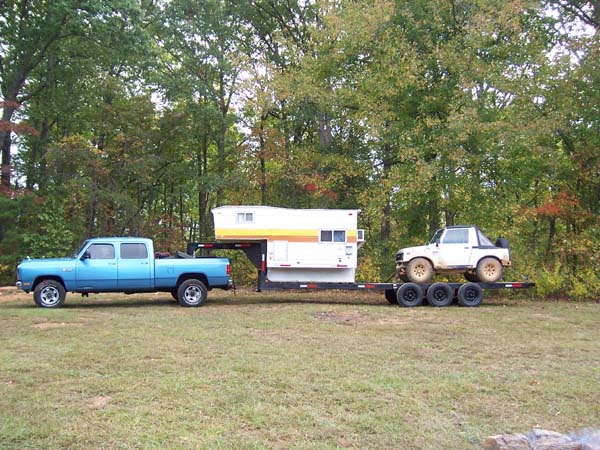

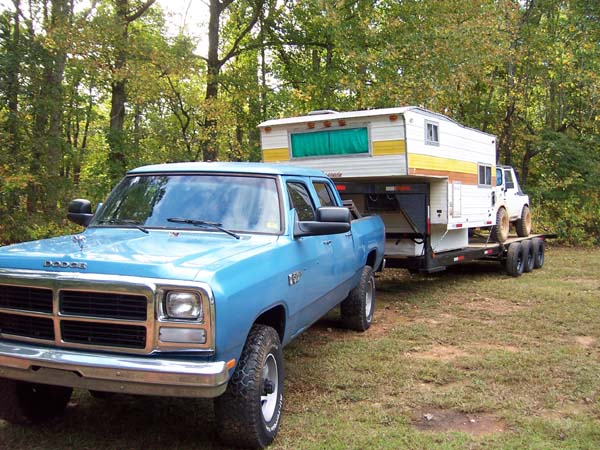

since I did not get the drive over fenders down I towed my buddies sami down instead
Of course we forgot pics going down so these are all loaded up coming home today

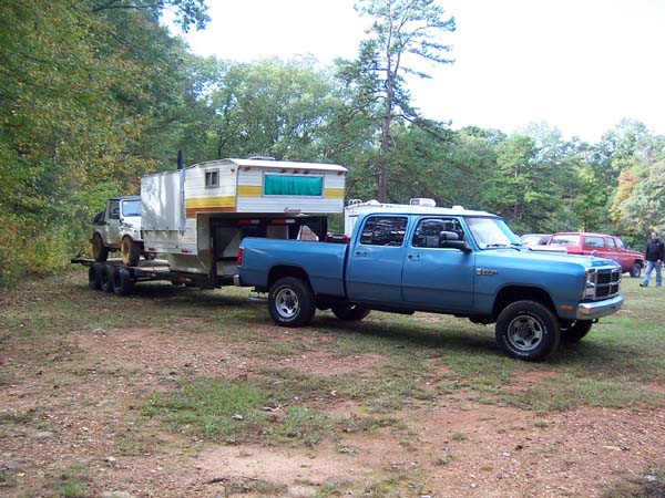

whole setup
Worked out great ken.
whats next fenders, and steps on the side? a removable railing would be slick.
yup.. need to get fenders done, ramps, ramps slide in trays, camper steps to get up into camper, and yes Jess has asked for a railing :)

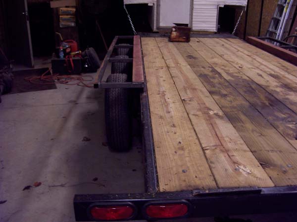

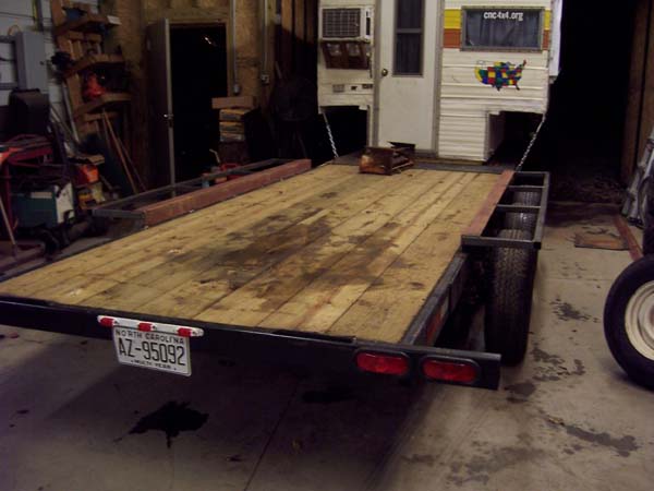

Well after a few days of work on the XJ I am back on the trailer :)
I am building drive on fenders.. got the main frame over the tires cut and welded on tonight. tomorrow I plan to do the reinforcement bars and make the frame area to the back of trailer.
I really like how you modified the neck. My tralier is also an old camper. The neck sits really low. I let a freind use it and he didn't pay attention...so I have a nasty dent in the top of my bed. What kind of metal did you use on the neck?
yes the frame and neck is all 2x6 1/4" wall tube..
I am going to add more bracing inside neck to hold stuff like 4x4 blocks, etc
what sort of bracing do you have in mind for the fenders? i dont know much about drive overs, but it looks like if you only brace it down to the bottom of the frame all that weight on them would try to twist the frame. maybe im over thinking that one, i have a tendency to over engineer everything i build and end up with a lot of unnecessary bracing.
It *will* try to twist the frame, but he has crossmembers running between the frame rails (beneath the wood deck), which should prevent that.
Or add more crossmembers if it twists. :)
i am going to add vertical and diagonal bracing..
the jeep tires will drive dead center on main frame rail.. not out by the edges so not to worried about weight by the edge.. but the bracing i plan to do will still support it
