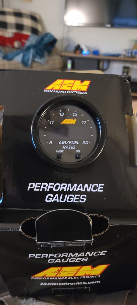

Finally got my wide band, been messing with some hp tuners.

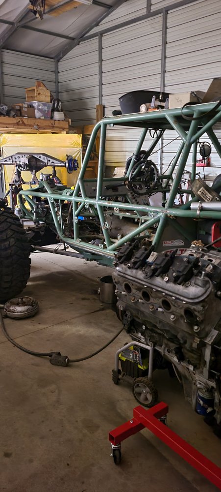

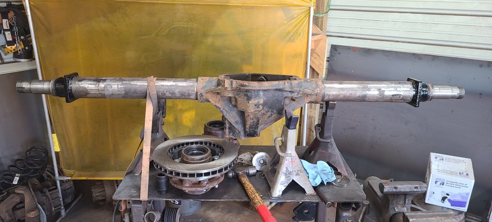

14 bolt setup, going in a LS powered TJ.

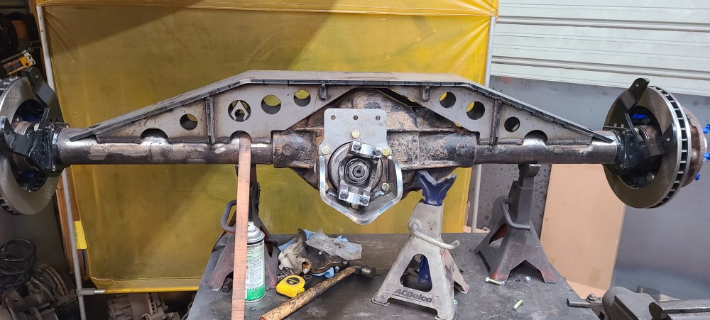

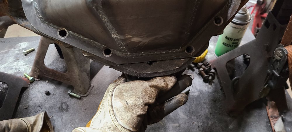

Artec truss getting welded on.

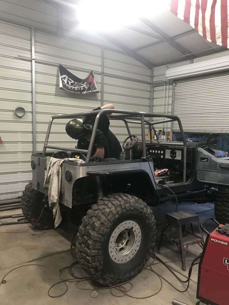

Cool shot of the shop, alot going on. Need to clean up a bit. Got stuff thrown everywhere.

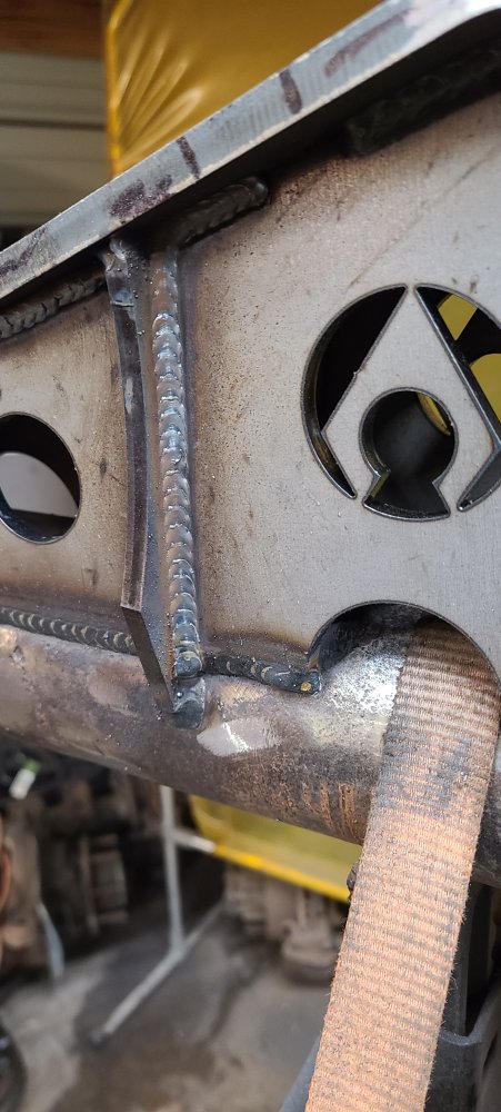

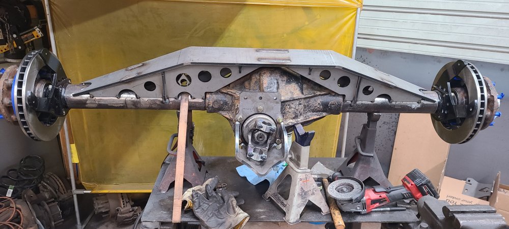

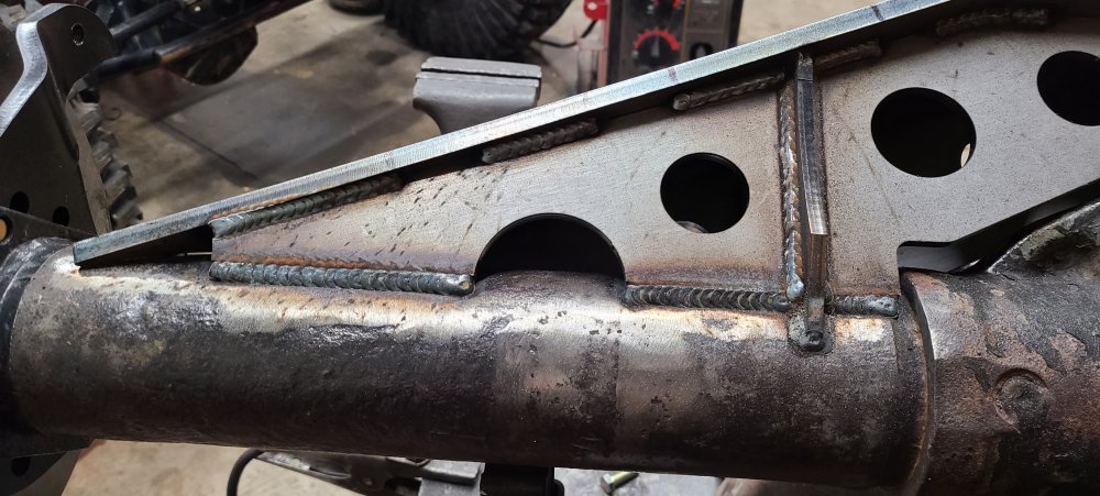

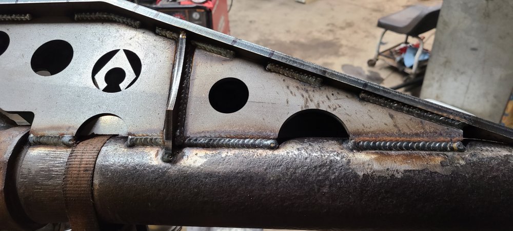

Truss glued all the way on and some obligatory weld shots.

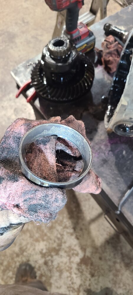

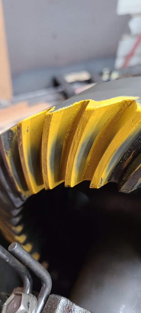

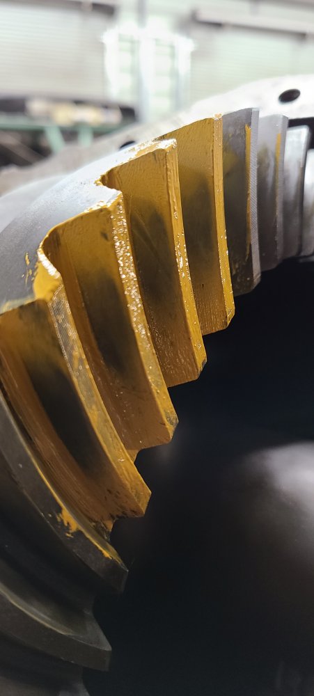

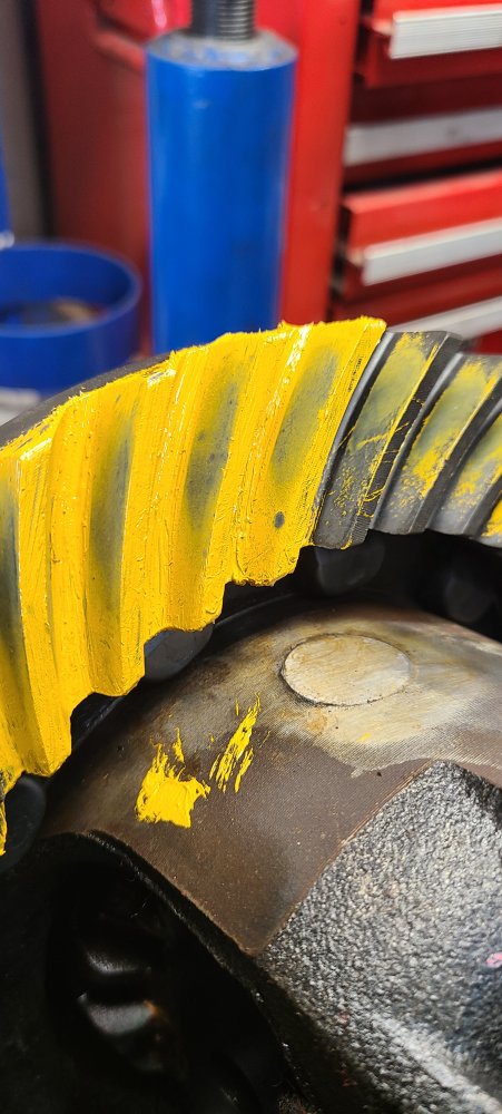

AAM 9.25 did today at work. Outside of the axle shaft seals a dumb easy diff to set up.

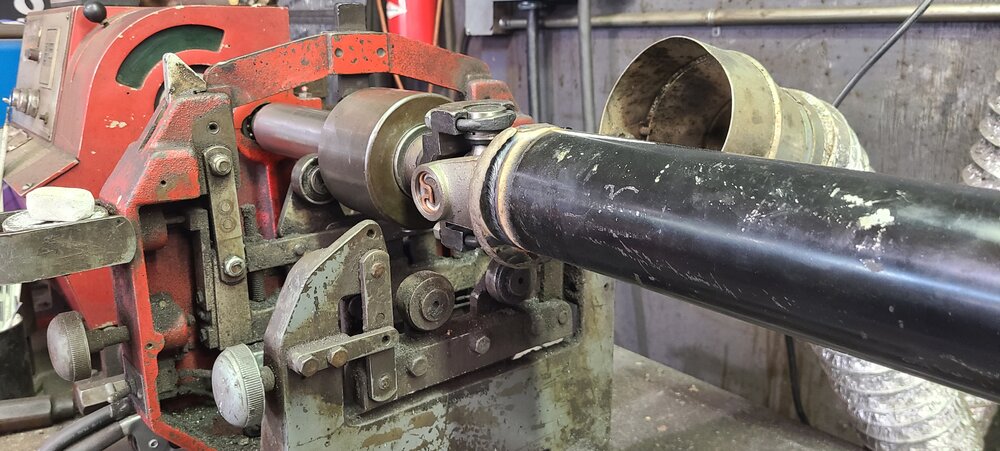

Which I guess I never came out and said it but I now work at Oliver's full time. Man what a refreshing change it was to go from Manufacturing Engineering to working in a shop full time. With that said if you need any driveshaft work give a ring.
Just some randoms from work.

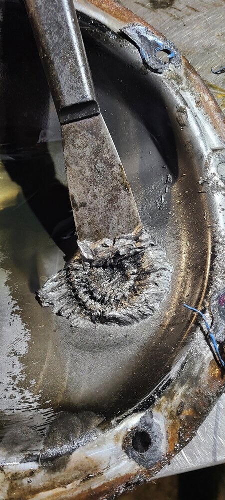

For when you really dont want to grab another rod.

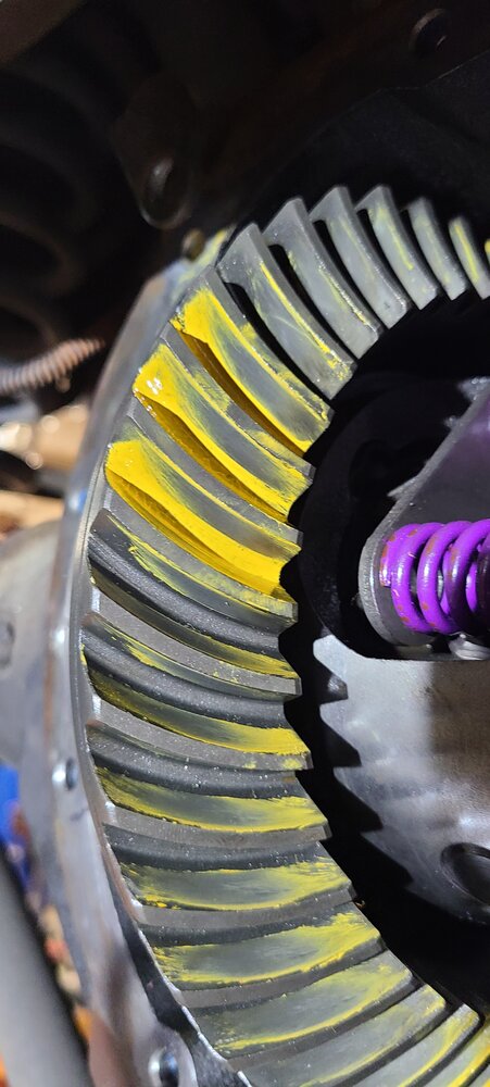

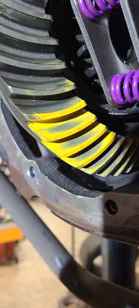

Little 10 bolt re-gear with a Yukon dura-grip. This thing was nasty, spider gears self destructed themselves. Took forever to get all the metal out of the housing.

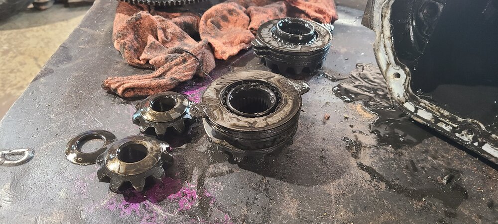

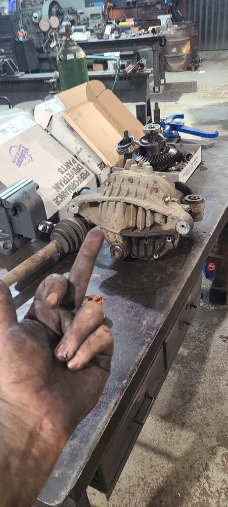

Finally pull the rear diff in my explorer, was a bit of a bitch to get out.

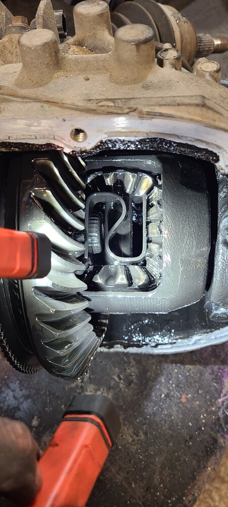

Spider gear said not today.
😳 yeah I'm sure this wouldn't make any noise at highway speed.
Limited slip clutches are toast, ears are gone on quite a few of them. Passenger side literally had no friction material left.
Gonna call ECGS tomorrow and get some parts on the way to freshen it back up. Luckily the gears are still fine.
