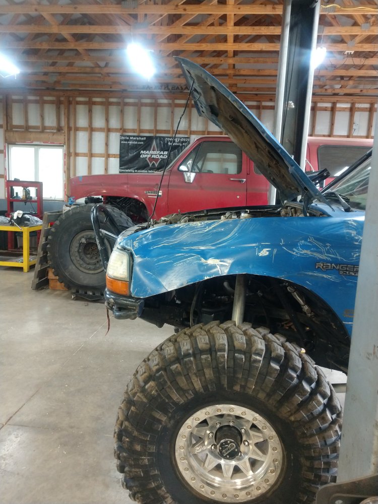

Hauled the ol girl down to Mars Fab today. The plan is longer wheelbase, lower COG, all new front 3 link, big aluminum radiator, new front tube work, all with the @MarsFab twist.
No rush, no buddy deals, just high quality work.

What is the current wheelbase? What is the goal for the new wheelbase?
116" now. Plan is to scoot the axle forward enough to get it out from underneath the oil pan. That way it can be lowered and gain needed uptravel.
If it gets moved as much as we plan, it will be around 122". Then it can be lowered 4" overall.
If you go that far forward is a 4 link an option?
