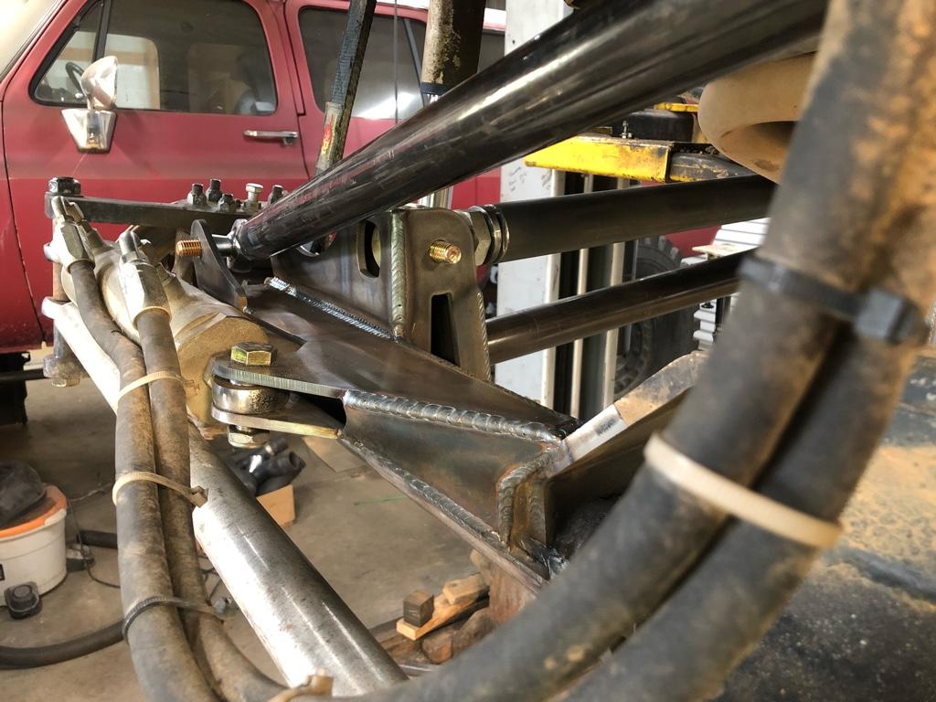

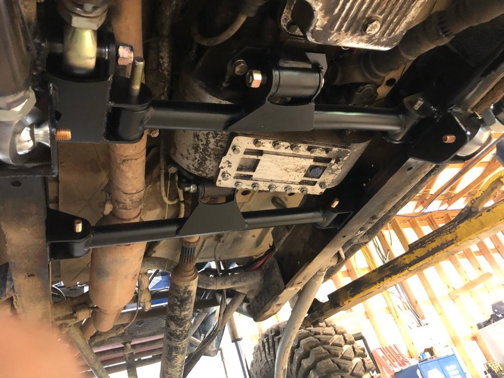

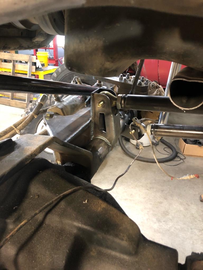

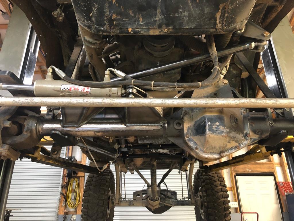

As of now I’ve built all new 3/8” wall lower links, .250 upper, gotten away from the dreaded Barnes joints that are prone to fail and gone with 1.25” heims (every one I’ve installed in the last year has failed, sorry guys/customers). I’ve pushed the axle forward roughly 8” which allowed the truss and portions of the diff housing to clear the oil pan and crank pulley plus I’m hopeful that it’ll not be so far forward that I can’t do something nice with the grill. We’ve not gained quite what Jody was hoping for but it’ll still be a big improvement in stability and uptravel. After looking over all the bracketry on the axle I found that the lower link holes were wallowed out some and the panhard bracket and the hydro ram bracket lacked much structure. So... 2 or 3 days were spent cleaning all that off and starting fresh. It’s getting new Lower link mounts with skids to protect the new heim joints and I’ve also come up with a design for a long side “truss” that incorporates the panhard, upper link and the single ended hydro cylinder mount. I’ll try to take pics of that progress this afternoon.
