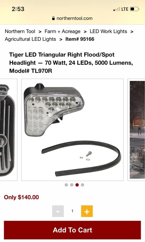

Any of you guys have experience with LED’s from northern Tool? These triangular lights to be specific. I’m looking for something to mount beside the grill on this thing to clear the tires with the new wheelbase. These are a little pricey but I’d like to find something fairly easy to source if one gets broken in the future. The mount and surround I build for it will likely be proprietary so it needs to be something that doesn’t disappear from the market as soon as I use them.
No experience with those but when I saw them and read your post, I immediately thought of Bobcat skid steer LED replacement lights. Quick search gave me this...
LED Lights for Bobcat Equipment
Which appears to be those same lights. I'd say if they're meant for Bobcat skid steers then you'd be good to go w/ them not disappearing from the market considering the countless skids that are out there.
Yep that’s how northern advertises them. They have pictures of them on a bobcat

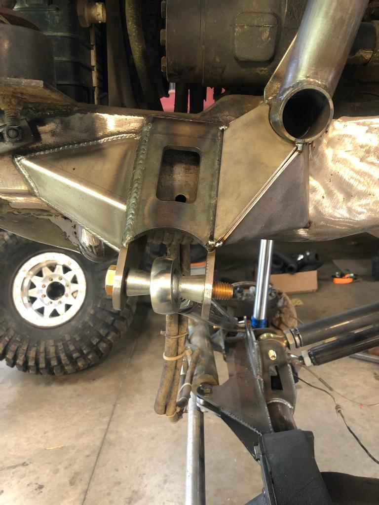

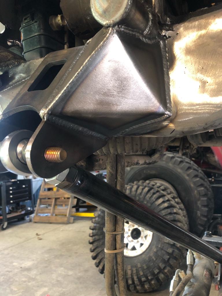

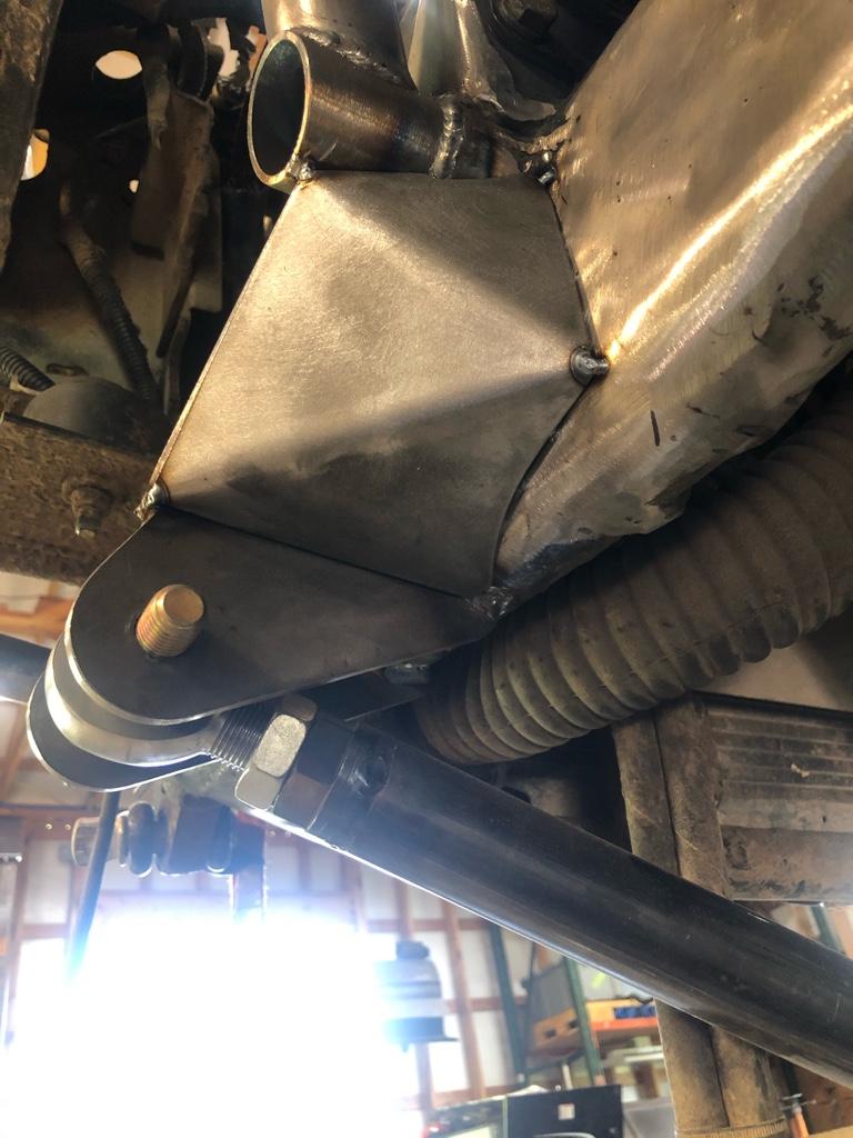

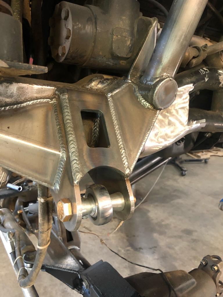

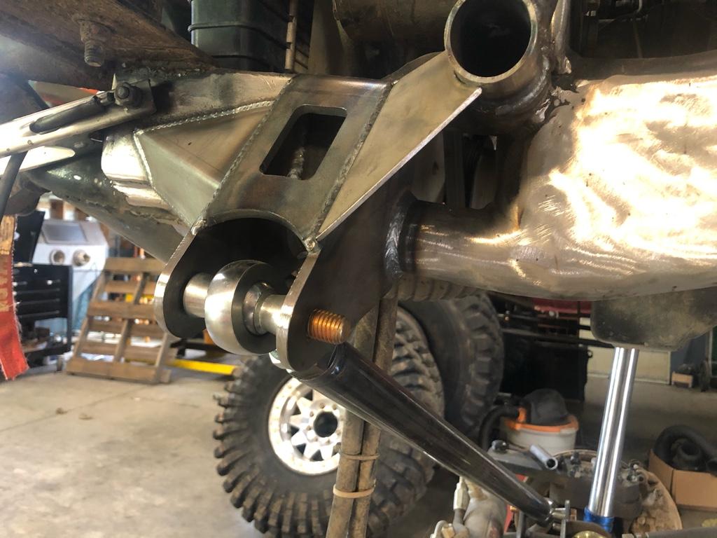

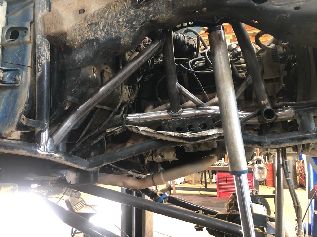

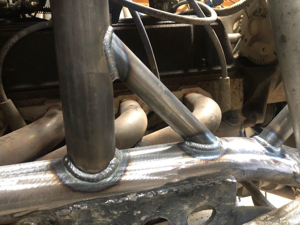

More on that panhard/shock tower tie in...

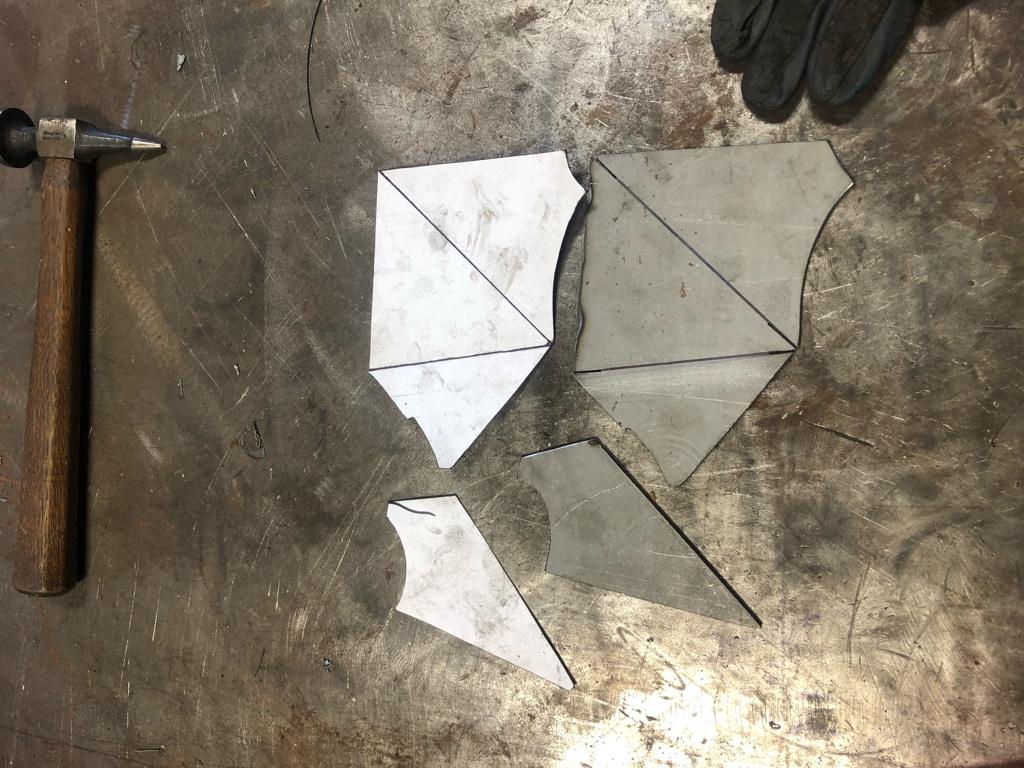

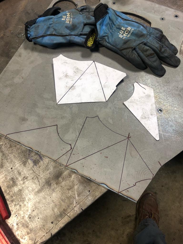

My CNC table is great but sometimes it’s more trouble than just breaking out some template paper and the bandsaw.
For some reason it seems like every front suspension I build I end up dedicating more time to the panhard mounts than any other part of the build.
Start to finish....
