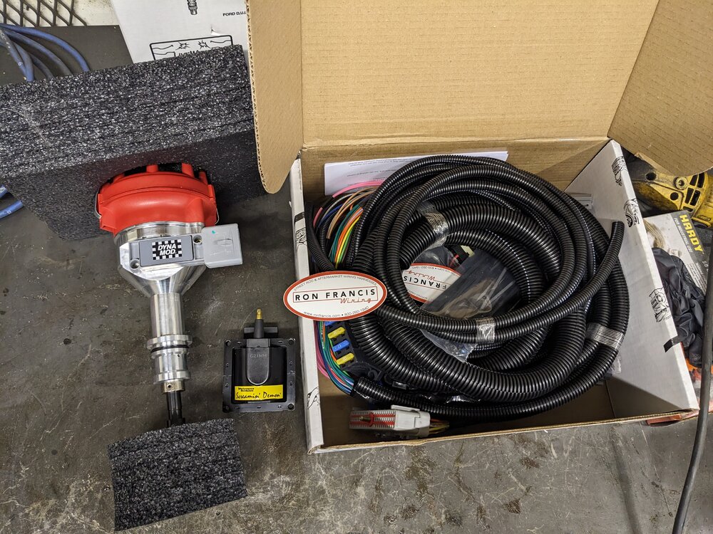

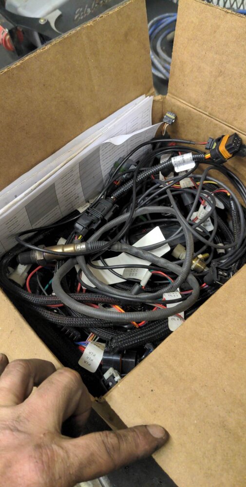

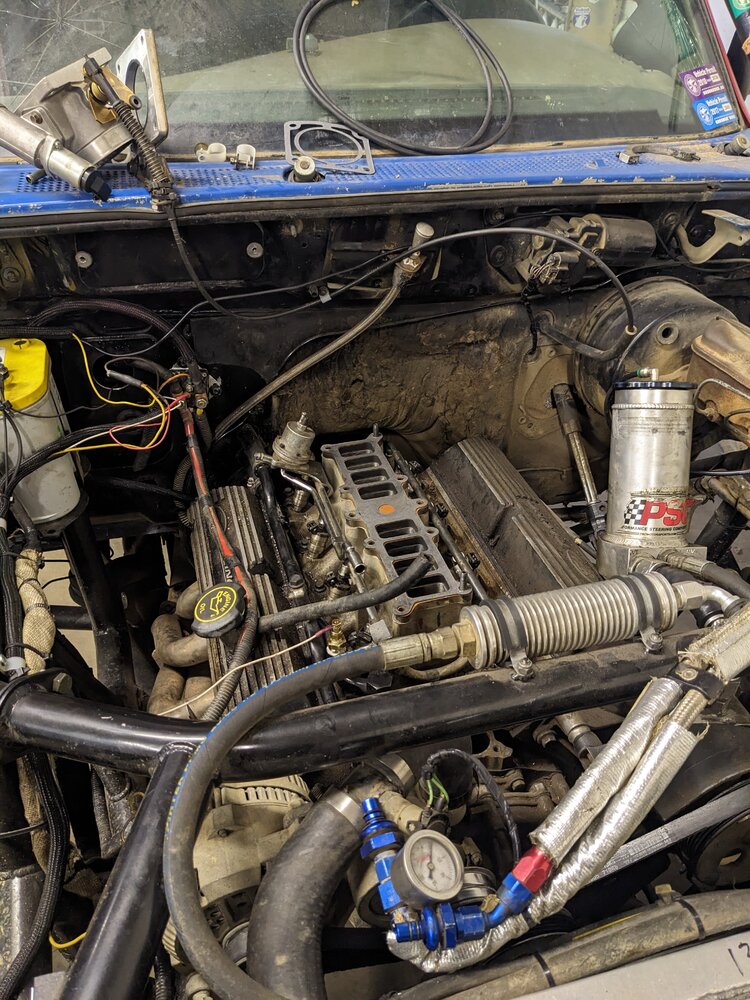

Progress.
Stripped the Terminator X out of the truck. Boxed it up and shipping to it's new owner tomorrow. The replacement harness and associated stuff arrives this week. Once I wrap up a 2023 Tacoma regear I'll get back on the Ranger
