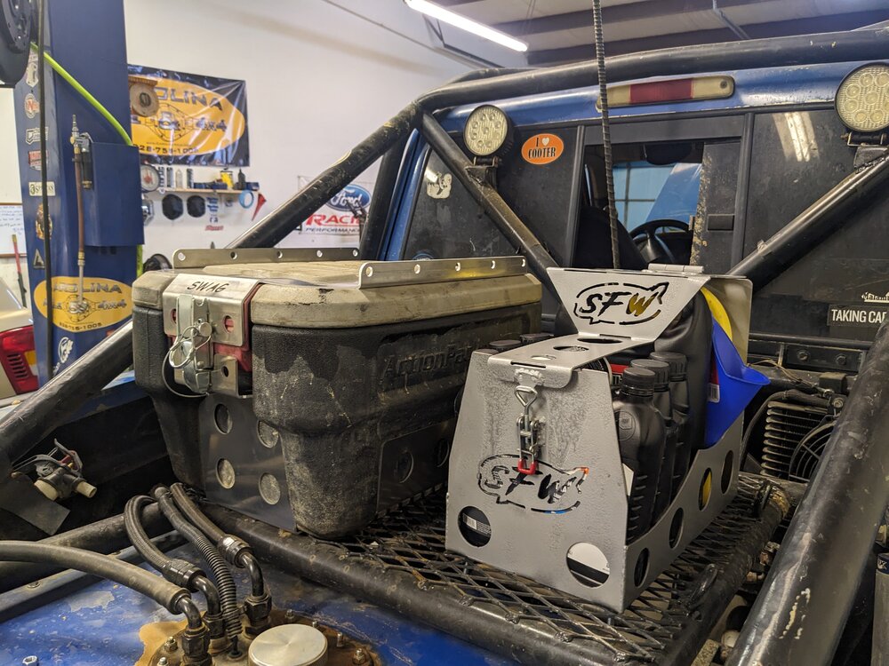

I'll be interested to see how you like that action packer hold down bracket thing, I have been eyeing that up.

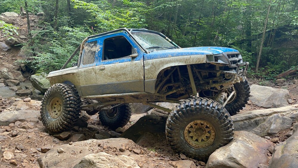

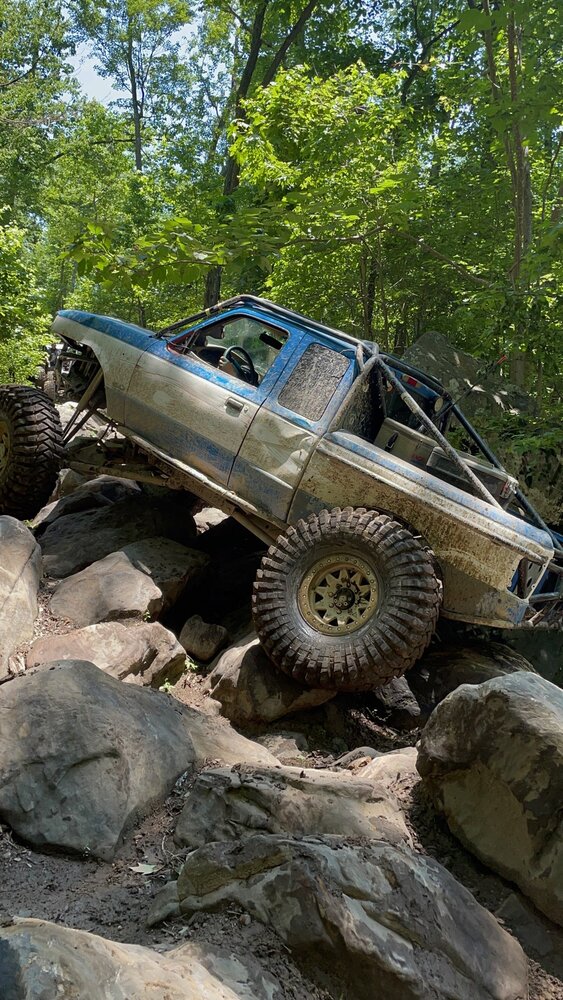

Solid weekend at Windrock. After a couple uneventful trips to Gulches as shakedown runs, I was ready for a "big" trip.
Truck performed flawlessly 🤘
Runs great, runs cool (195* at the top of the paved climb up from the General Store (if you know, you know), the suspension works great and had zero mechanicals all weekend.
We ran 16 Friday evening, Rail Trail, 3 and I hit the bottom half of Rattlerock on Saturday. Aside from my overall chassis width hanging me up on Rail Trail once and the same on one spot on Rattlerock, no winching or issues.
I lost 2 more door mirrors, the rear doors don't open, a cup holder broke and 5 rear axle shaft bolts disappeared on Rattlerock. Made it back to the trailer and awaits a nut and bolt check.

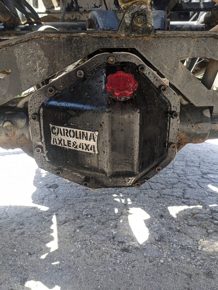

When I was on Rattlerock earlier this month, Lisa (spotting for me) said the rear diff was making a funny noise under load. It was still pulling, so we kept going. Made it to the General Store and noticed a major gear oil leak from the LR hub. Apparently, the noise she heard was the shaft walking in and out cause there was only 3 bolts (out of 8) still holding the FF shaft in. They were barely still threaded in.
I was hopeful it was just a fastener issue but feared I had a bent tube. Luckily, when a checked the housing is still (somewhat) straight. So I swapped in new bolts and added Nordlock washers. No uggas, I actually torqued them this time.
Installed new axle flange seals (no RTV) a fresh pinion seal and resealed the cover for good measure. After 7.5 years, the gears still look great. I added a 1.25" fill hole on the cover so I can inspect the gears w/o dropping the cover.
Washed off 2 Gulches trips and a Windrock trip and it's ready for the next outing.
Crappy pic, cover was still wet from washing. I was ready for dinner (see Vittles thread).
