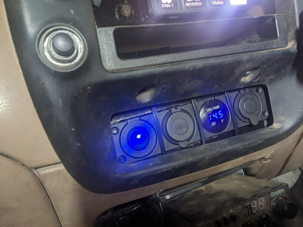

Bought a USB-12 volt charger 4 way outlet thingies a couple weeks ago and decided to install it this afternoon. Luckily, I dropped it and broke the voltmeter pod. Instead of getting a new one, I just applied some zip tie technology and finished the install.
Now when I'm videoing @ghost winching next time, I can recharge my phone afterwards 😃

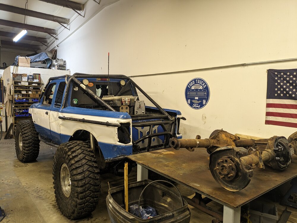

Well, haven't really had time to do any wheeling, so my truck has sat since September 😕. Damn work!

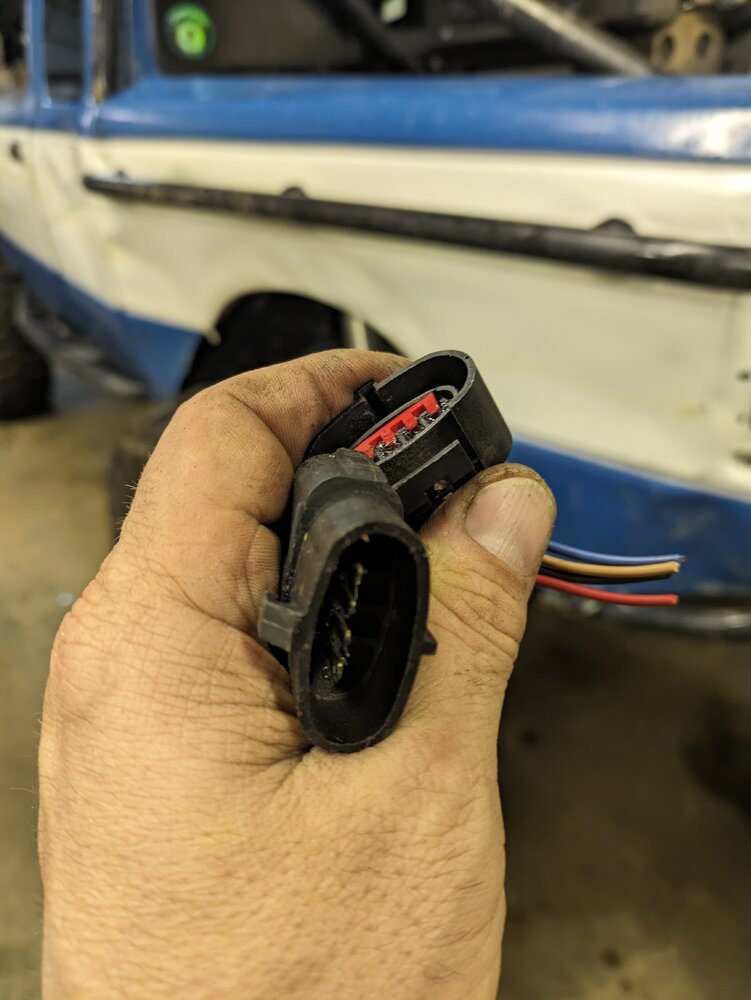

It wasn't running great recently and I knew it was time to address it. Randomly it would chop like a 3/4 cammed Big Block and then clear up. Turned out to be a loose connection at the MAF connector. My harness is a 4 wire and I use a 6 wire MAF (internal IAT) so it utilized an adapter. I soldered in a new 6 pin and called her done.

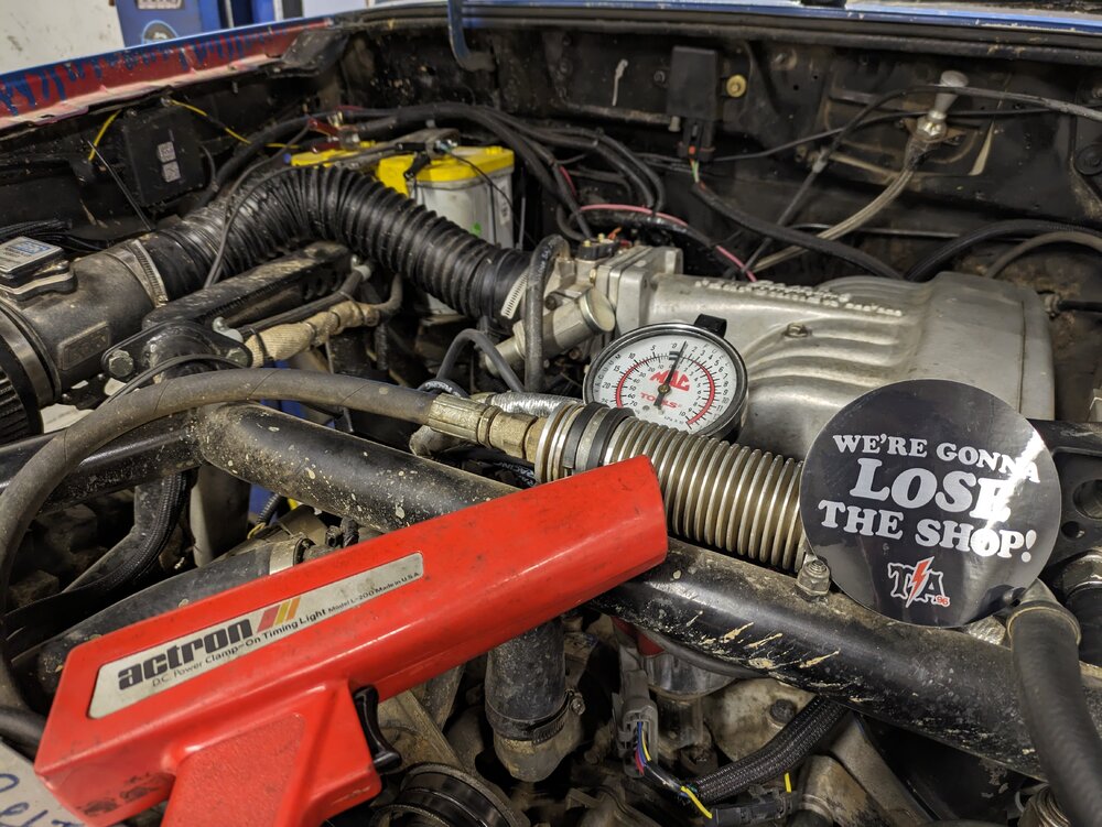

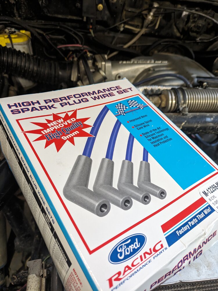

It was smooth but a little rough at idle. Vacuum gauge showed low vacuum at idle, so a valve adjustment and timing check was in order. 13* FTW! Swapped in a fresh set of wires and plugs for good measure.
