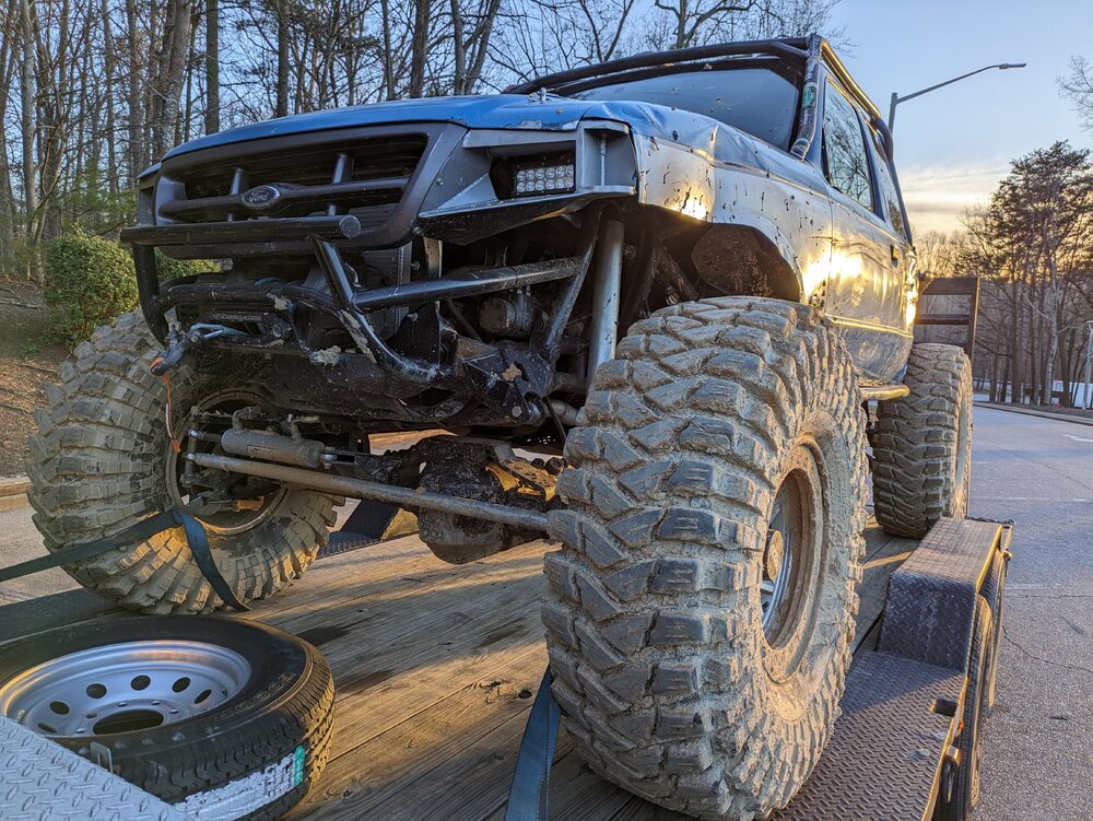

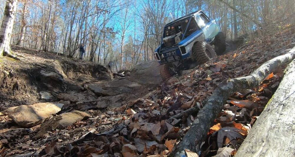

Yup, took a bad bounce on Hunter's Uh Oh trail and had to pull some cable. My wheelbase is just too long for that one. It's cool though, I have to bumpstop my pecker with my belly due to length as well 😜
Joking aside, truck kicks total ass. Really couldn't be more pleased with it. In the rare situation where it's too wide at the rocker or the WB is a hair too long, I get on a trail or obstacle where they benefit me. You can't have it all. But this one checks most of the boxes.

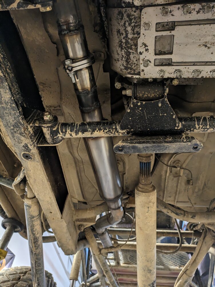

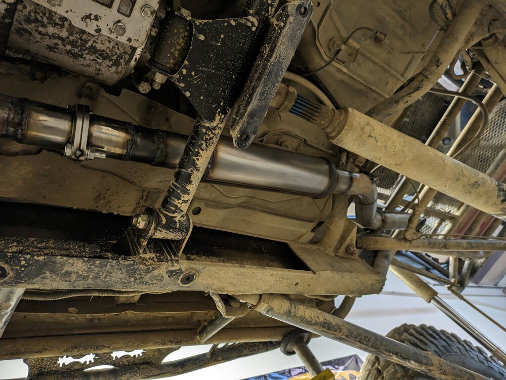

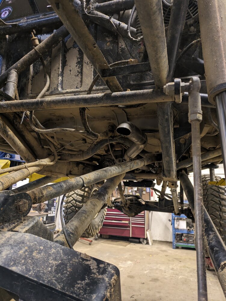

The mid pipe from the Y back is a combo of 2.25 and 2.5", cobbled together. The only part worth a crap is a small 4" section MarsFab sectioned in.
Currently running a round chambered bullet muffler with a resonator at the end to quiet it down.
Going with a Magnaflow round, 20" long and mandrel bent DIY pipes. Also adding a removable flange so I can drop the transmission w/o pulling the entire exhaust.

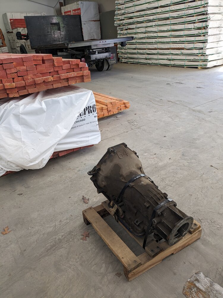

I'm having my spare C6 professionally built with E4OD internals and RFVB. I'll swap it in later this year.

Did you decide to go with Cook's on the transmission build? I'm sure you will, but let us know how it goes for you. I've been thinking of using them on my next build.
Went with Fritt's. He emailed me and apologized for the delay with an understandable reason. The fact they dyno test them first is a big deal for me.
$2800 fully built, with B&B pump, manual VB, rollerized, C6 internals machined for E4OD goodies, new cast pan, shipping both ways and 5 gallons of the fluid they want you to use.
I'll have PTC refresh my converter while it's out as well.
