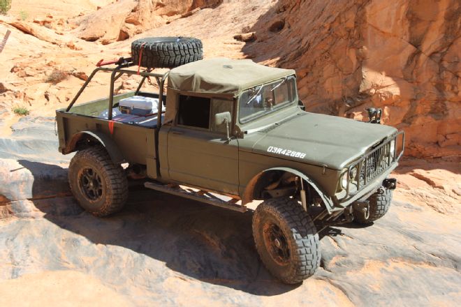

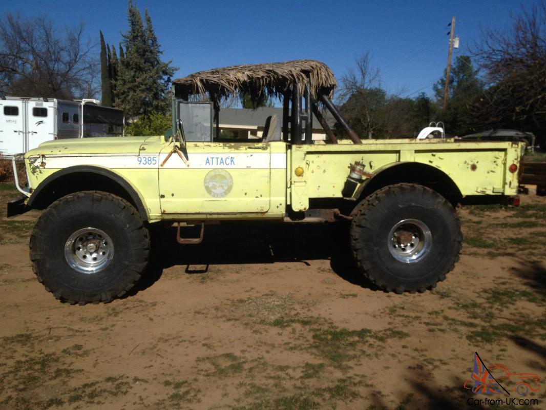

Depends on your budget...you could do some type of bikini top like CJ/Wranglers use, or go old school like the old M715 with rope and canvas. Welding on sheet metal would just get messy and probably result in a head lac...those leak like a mudder fugger, so....I wouldn't go that way.
Agreed.

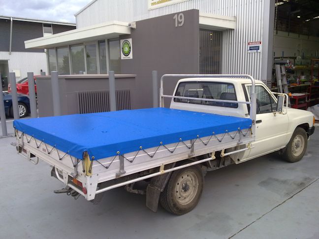

I like this idea, easy to fab up and add lacing cleats. Maybe not blue though, because it looks like a cheap plastic tarp.
I mean, it's not my vehicle so it doesn't matter how silly it looks. :D
Agreed.
lol true, I wouldn't go with the blue tarp look either...I was thinking the OD green canvas, but I guess that wouldn't match the tiger motif, now would it?
1969-kaiser-m715
Might could tie it in with painting some black tiger stripes across that too, who knows?
I swear I've seen an M715 with the top being what looked literally to be a canvas top with rope laced through cleats just as the pic you showed. I'll keep looking.

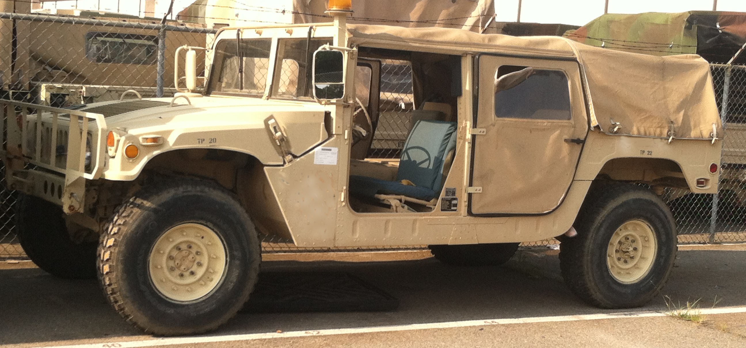

He did mention HMMWV style...memories of driving these old rattling loud bastards...
