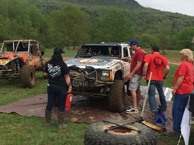

What a Great time at our second race of the season at at adventure off-road park in TN. First I am very thankful for all the family and friends that helped me get ready for this year's race season.
We did have an issues we had to fix before race day while pre running we broke a driver's side axle shaft and lucky for us our buddy Matt from @cutlerfab came in and towed us out and back to the pits so we could fix it and be ready for qualifying.
Qualifying: we lined up and I told Doug let's just do this at 75% because I did not want to break something again. Well we did and to our surprise we got the pole position. (hard charger award)
The other teams we we're helping broken stuff also. One broke a front axle shaft also and the other busted his steering bad. He helped them do repairs and we we're able to all start the race.
Race recap: we started first in our class and while lined up the came by and told us look for a guy with a yellow flag so we can take the bypass. Well we never saw him so we ended up doing the entire same course as the bigger class. Nothing better then bouncing a 4600 on 35's up some big rock trails.
This race course was crazy muddy and sloppy and to make it worse we lost all brakes at the first turn into the race. I knew with a 5 speed I could just throw it into 1st gear and let off clutch to stop which I did and it worked. Sketchy but worked.
After first laptop we pulled into the pit and they found a loose bango bolt so we tighten it and bled the brakes and we we're off. When we got to the first big hill climb the Jeep passenger tire hit a tree and climbed up and as it fell down the front passenger side axle shaft broke.
We winched to the top of the trail and then realized our spare shaft was back at camp not in the Jeep :(
So we turned the Jeep around and helped Dave Cole as a winch point for other races in our class and again for the 4400 race.
At the end of the day we got 2nd place in our class.

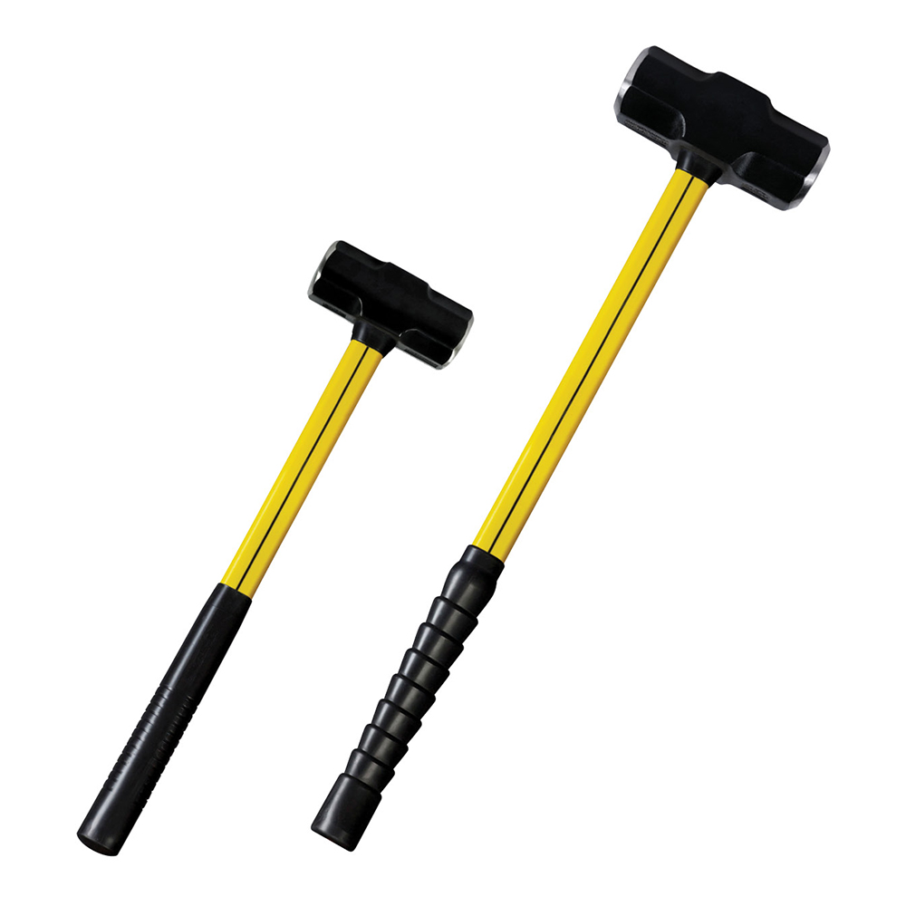

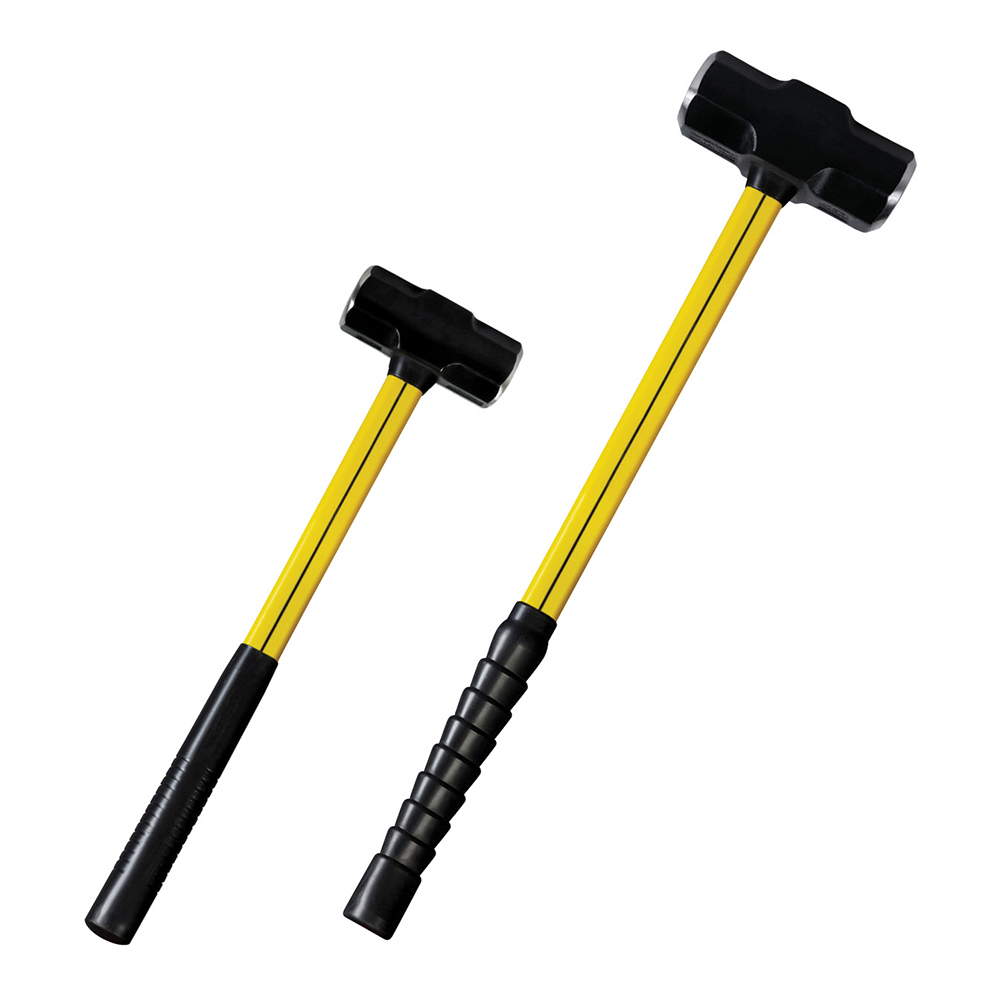

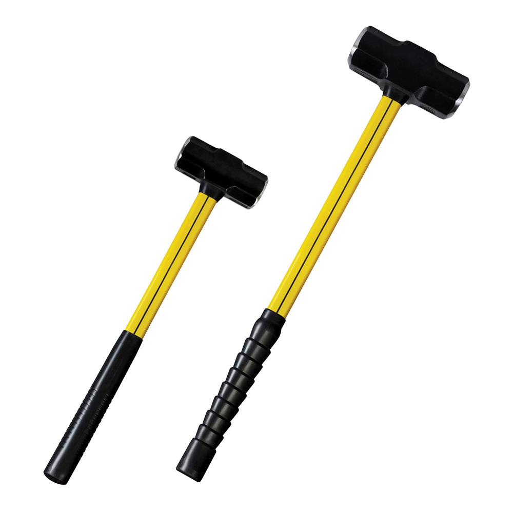

Body hammers?!?!
Always thought those were called "minor electronic adjustment tools," often used on things associated with computers.

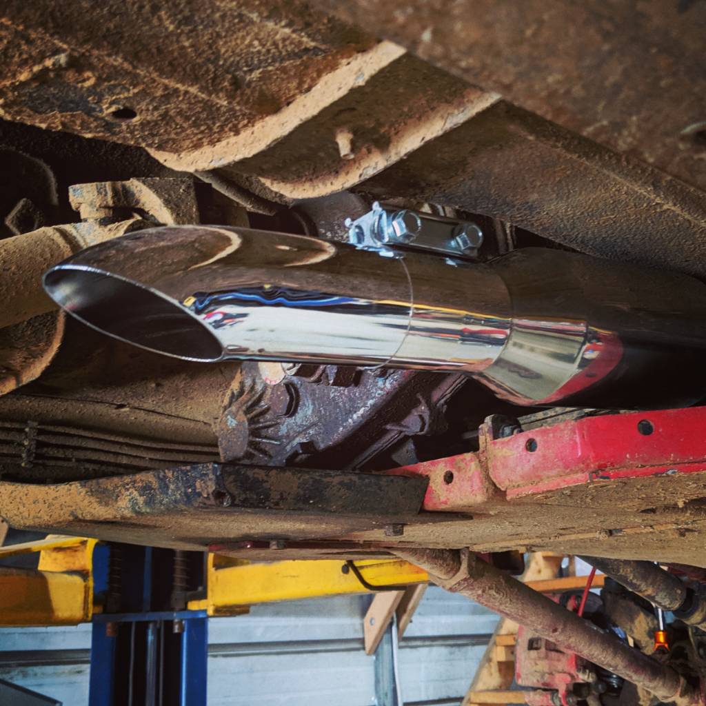

Added a little chrome to the race Cherokee. Hoping it takes us from 2nd to 1st in the next race :)

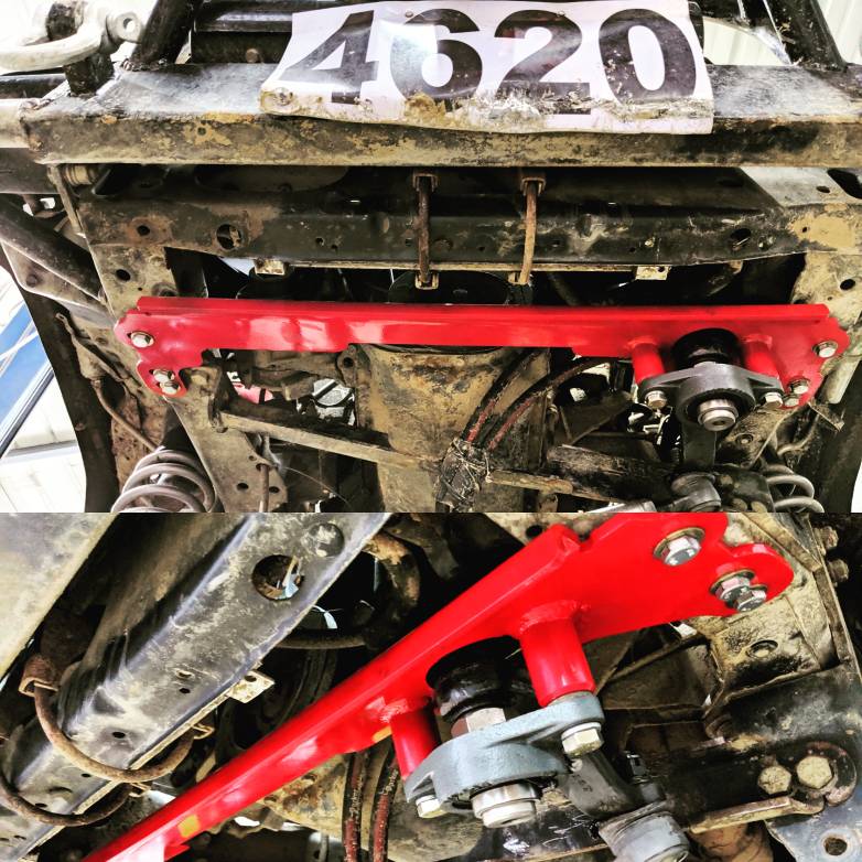

Thanks to a great sponsor we will have no worries about our steering box anymore.
@ironman4x4fab makes some beefy products.
#4620 is almost ready for Oklahoma.

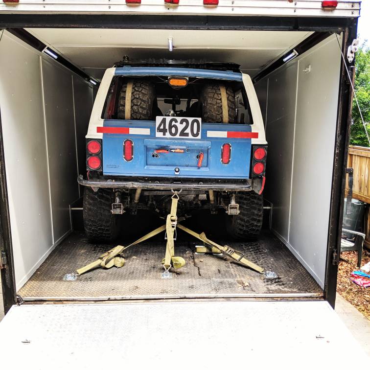

We are all loaded up for our next race
Leaving next Wednesday for Oklahoma.

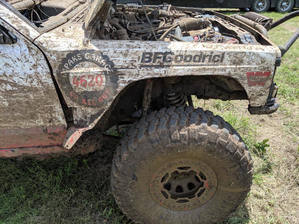

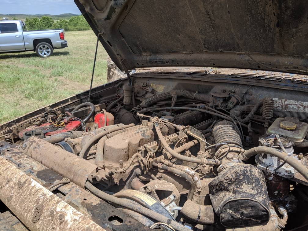

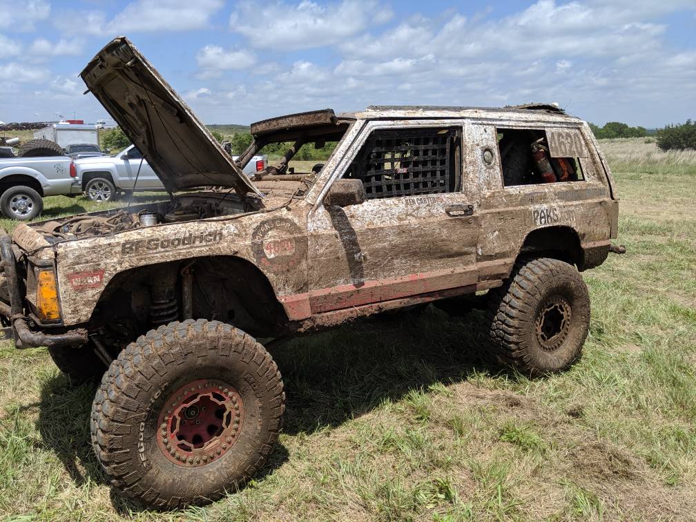

Another hard fought day racing.
We got stuck in two HUGE mud pits and had to winch.
We broke rear driveshaft half way up a long hill right after we lost our brakes. So we went 25mph backwards into a tree(that hurt)
Electric fan died and jeep started to over heat but we made it back to the pits.
We ended up 4th.
I really need to learn how to keep the passenger side of the jeep off stuff. :)
Time to drive 1300 miles home. Gotta be home for Father's day.

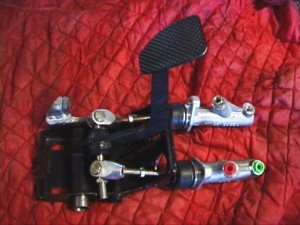

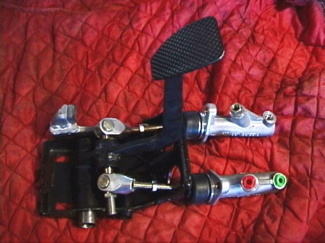

With regards to loosing brakes...
What about using a dual MC system so that the front and rear systems are completely isolated from each other.
This is what I did for the 914-6 track car.
In case of brake failure, my hope is to at least slow down a little before the wall.

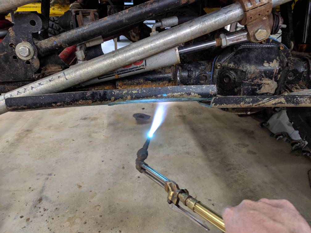

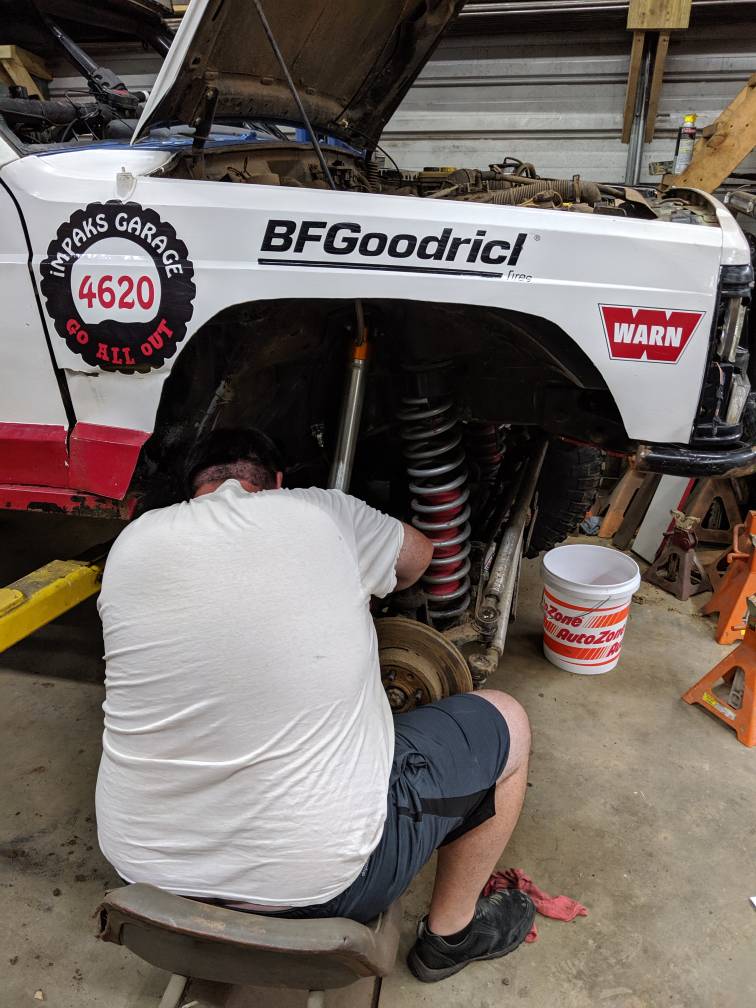

When this guy and the torch come together you better watch out. @blackbear for the win on wrench night :)
We also replaced brake caliper and rear yoke
