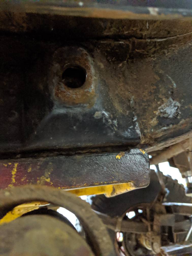

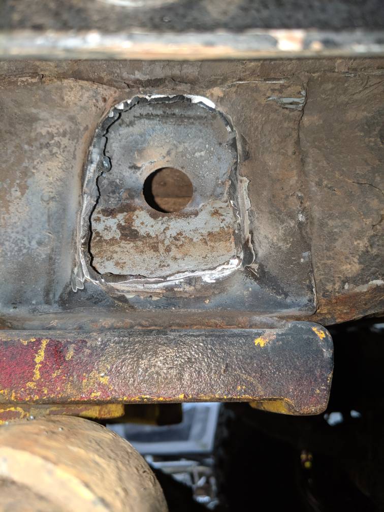

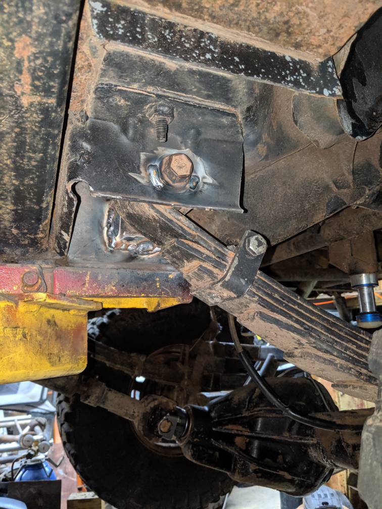

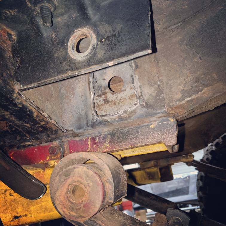

Leaf spring captured nut broke. So cut chop weld and all fixed.

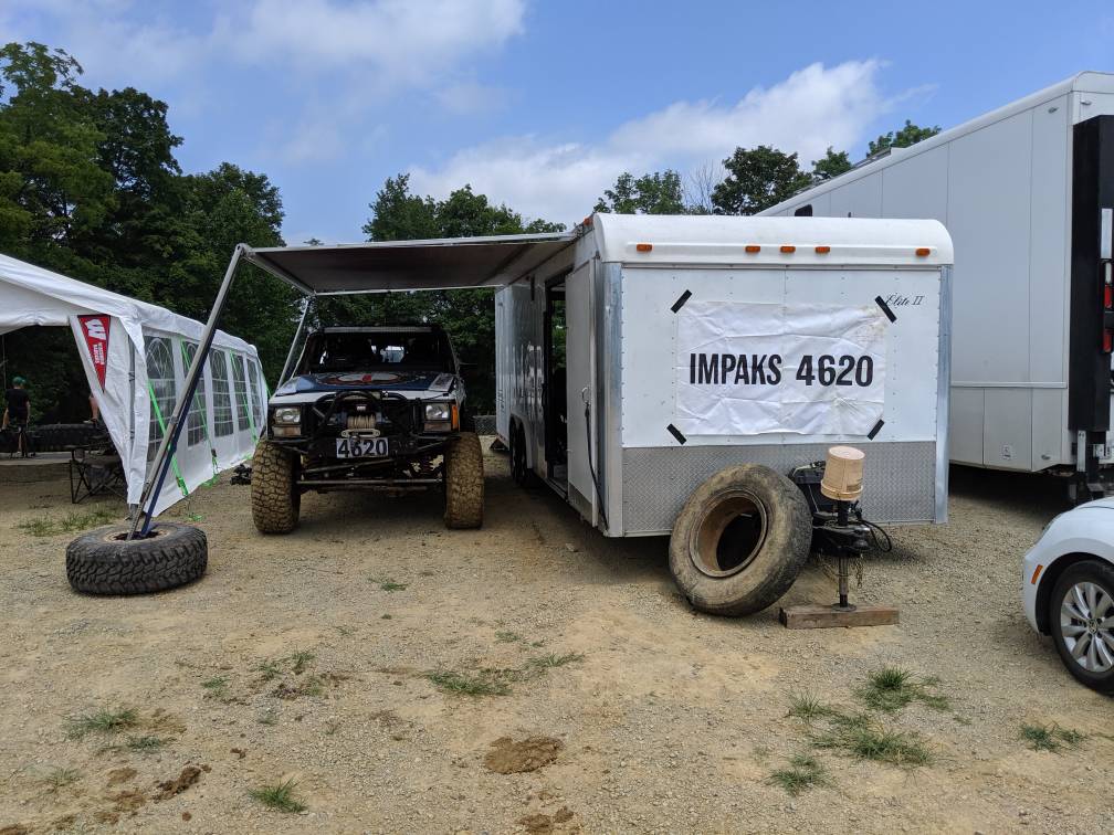

I will say we are not prepared as usual for this race. Life has been crazy busy.
Last night we hooked up bus to trailer and just issue after issue. So much so I put bus back and hooked truck to trailer and loaded everything. We got lucky and found a hotel that had rooms. So we will make due and do our best.
We had a terrible day of racing but had the best pit crew you could ask for. Lost the clutch and over heated the engine. Only finished one full lap. Another time and day.

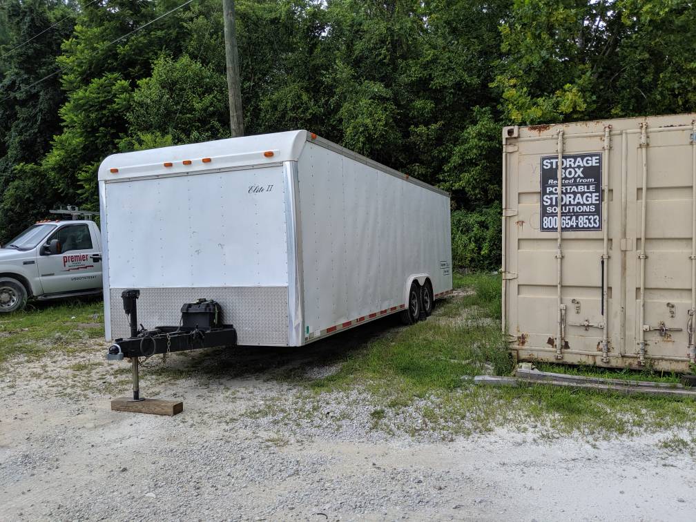

Left the jeep and trailer in Kentucky at a local shop hope they can replace rear axle and then I can go get it in a few weeks
If anyone knows someone with a lowboy trailer that can haul trailer with jeep I may need to go that route also if this shop tries to kill me on pricing

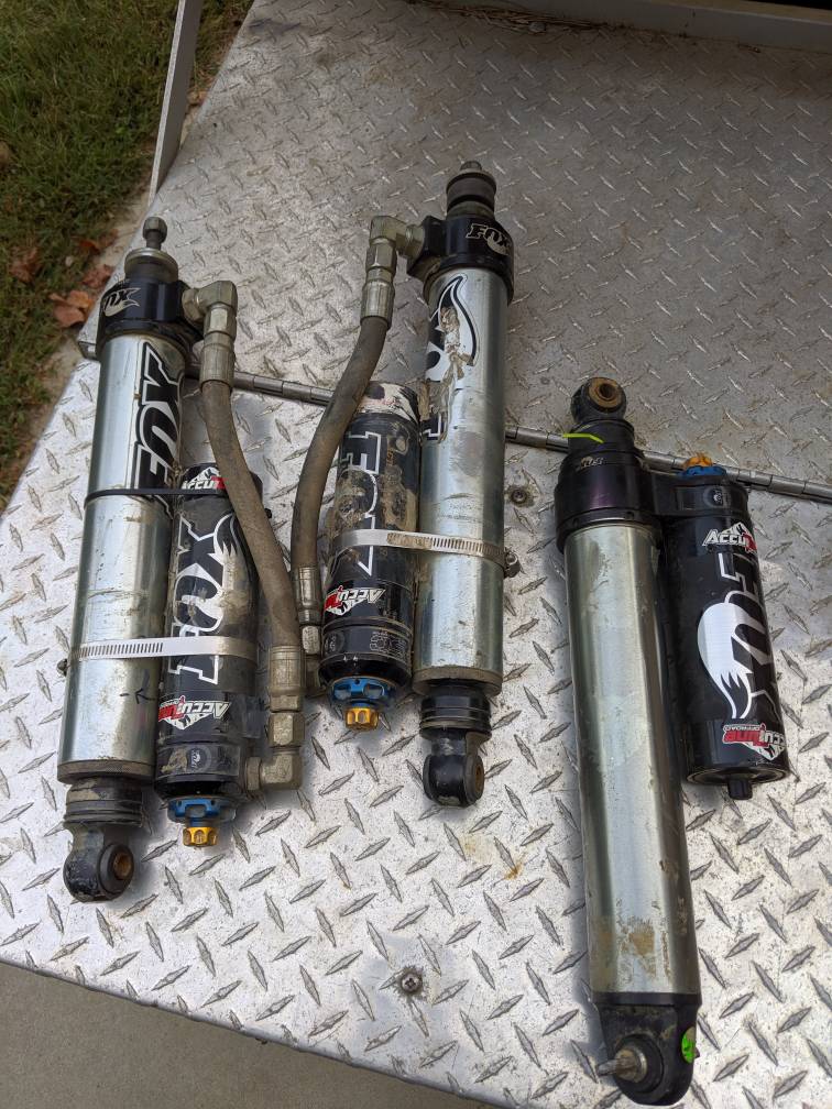

Starting to get some upgrade parts
2.5" fox shocks. And yes I have 4.

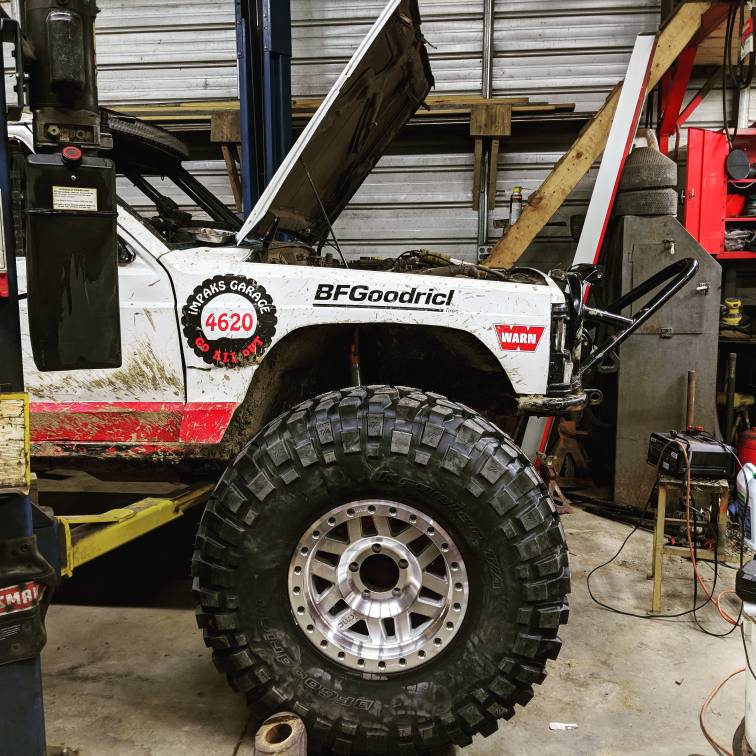

Is it perspective that's throwing this off? Or will there have to be significant sheetmetal chop to make those work
these are 39 BFG stickies. they would break every rule the stock class has. ( 35,s DOT, non sticky) it was just for a fun picture, even though I love the way they look on the XJ and maybe when it retires from racing this will be the next tire upgrade for it :)

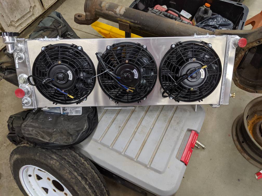

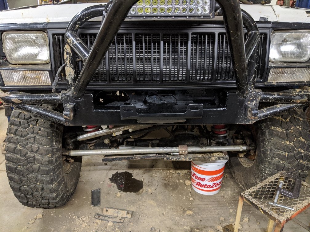

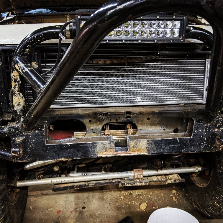

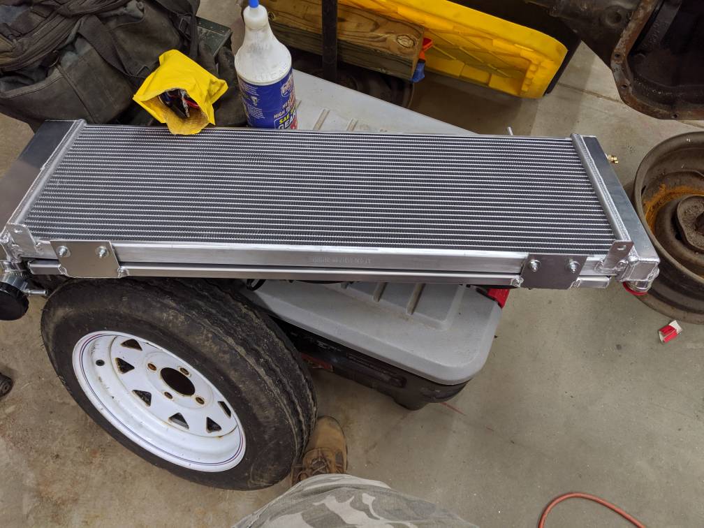

Cut front bumper to lower winch for better air, installed new clutch slave, wired new radiator

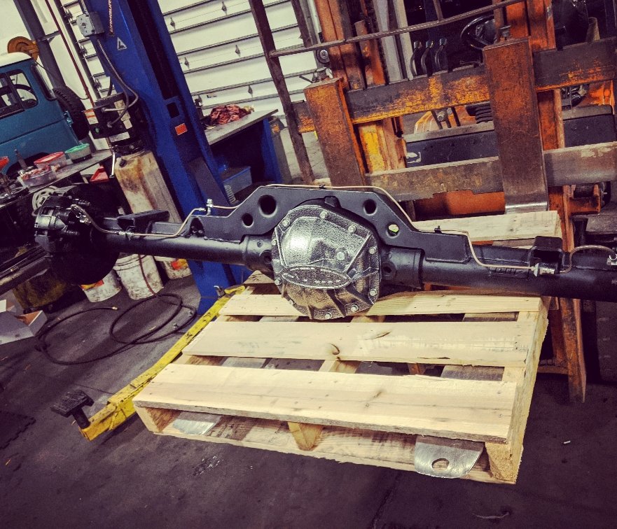

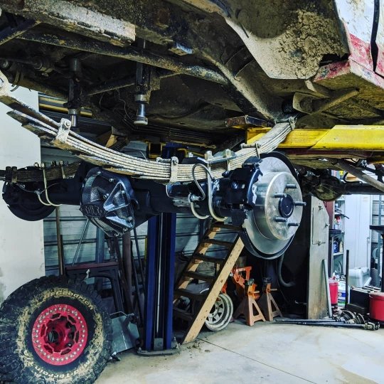

Stepping up our game. No more bent smiling axle. Dana 60 going into the rear.

Correct. You can run any axle you want and any transfer case. But engine,tranny need to be stock with 35" tire and stock style suspension and single shocks.

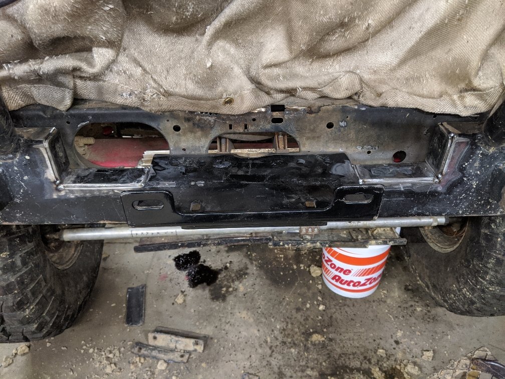

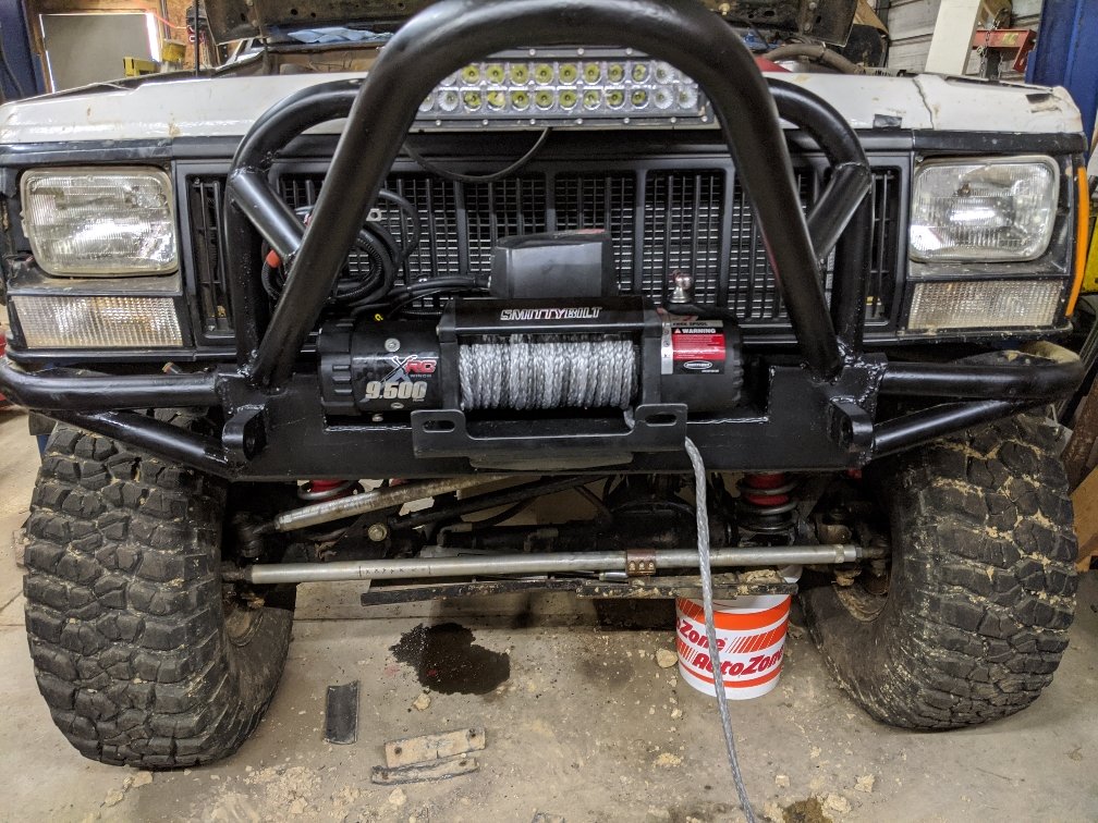

Front winch mount almost done

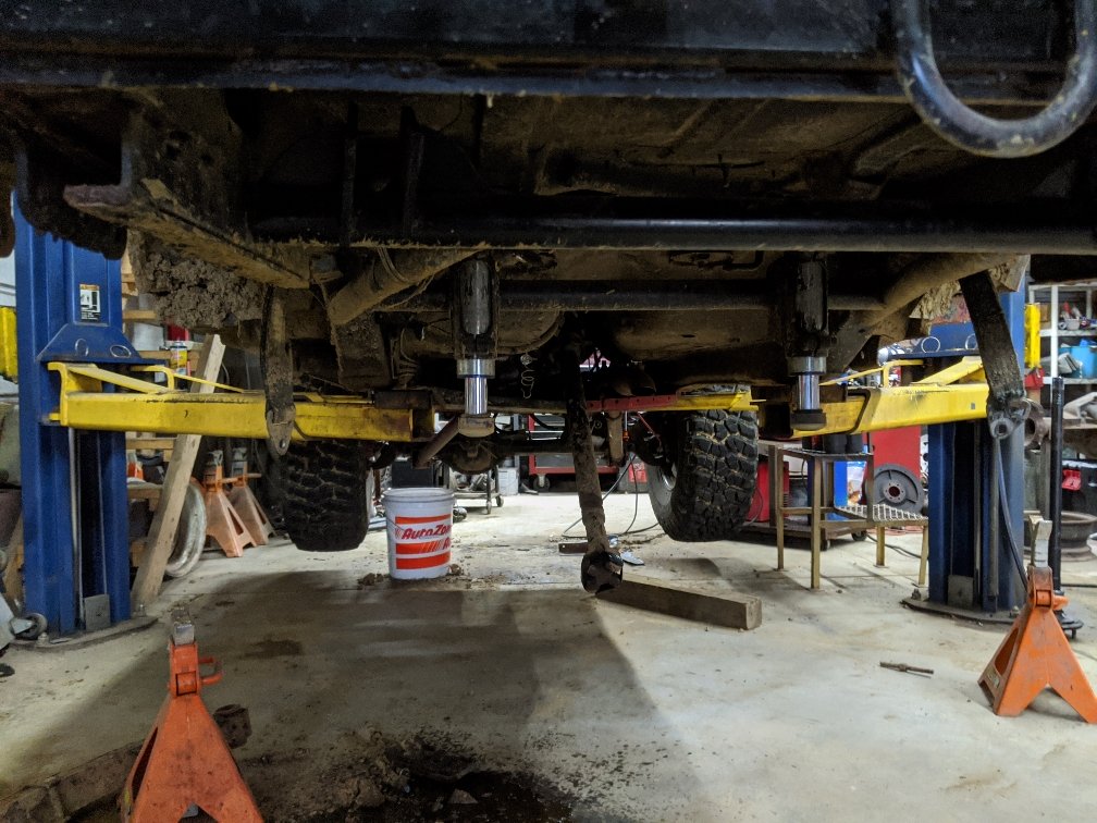

Rear axle ripped out. Prepping for new rear 60.
Radiator done and all wired up.
Winch mount done. More air to radiator now

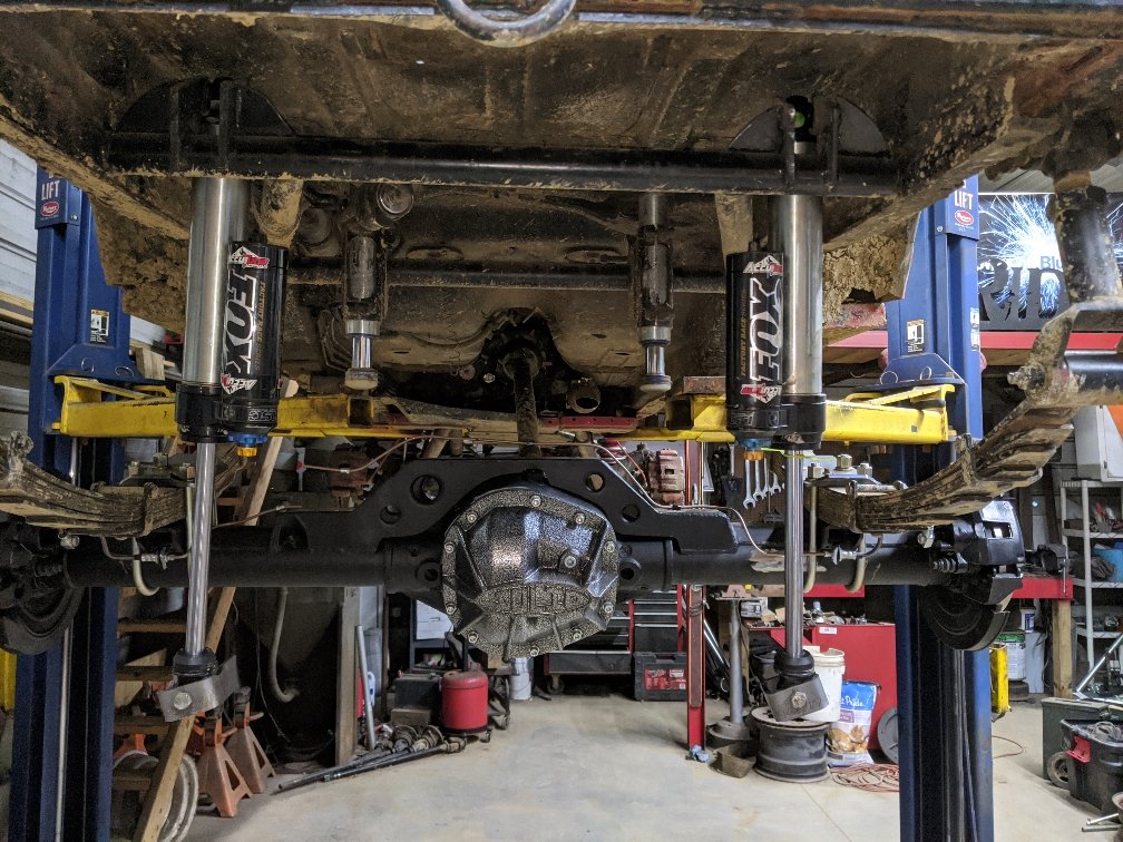

Dana 60 in, fox shocks, need to move air bumps, seats and harnesses done, battery terminals fixed.
