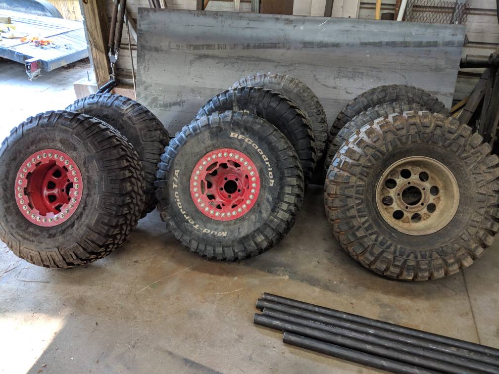

Were the tire failures bead related or slices or what? When you say toasted front what did you kill there?
Pretty sure tire issues we're due to me racing up the rocks to aggressive and I should have slowed down. Both have slices in them on sidewall. About 55 miles on each tire :(

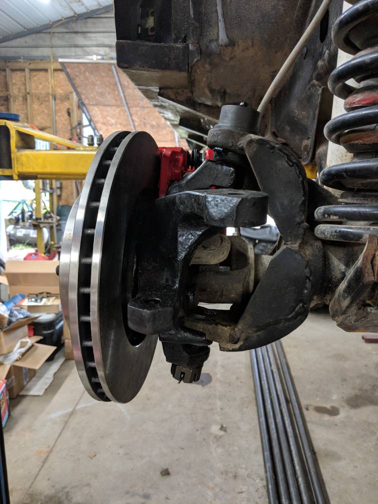

The.front I believe is wore control arms,bushing shot, steering loose, unit bearings done, etc. Front will need a lot of work.
Time to upgrade more stuff
And I still need two more tires :)

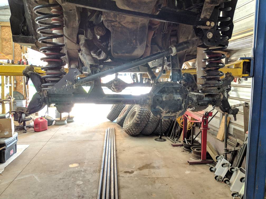

Going to rebuild entire front axle. Steering etc. Then we will be adding long arms and new suspension parts.

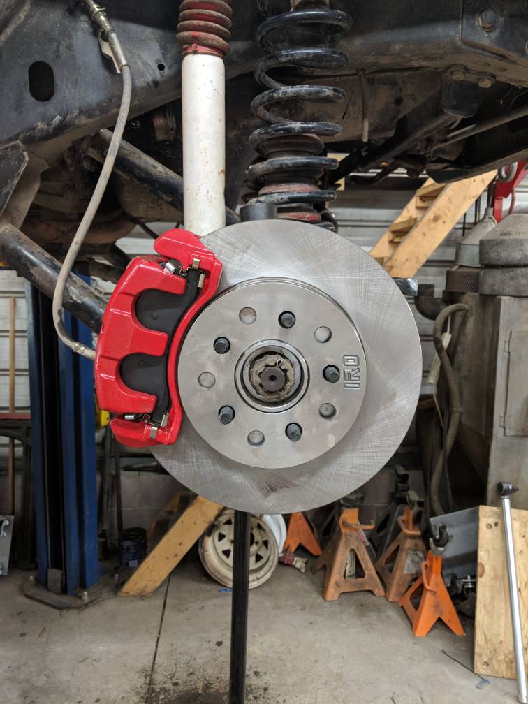

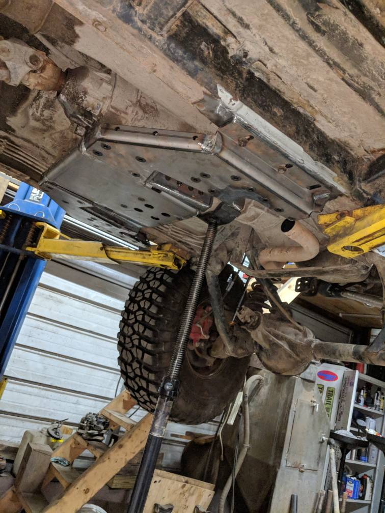

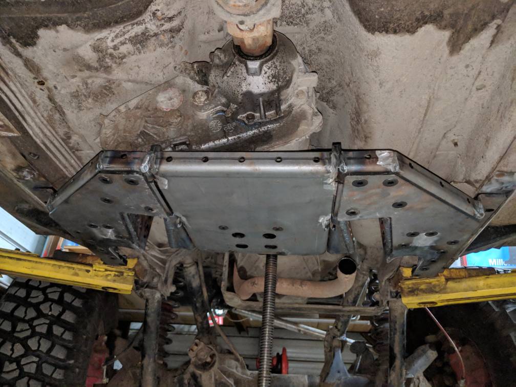

Did get wj knuckles on, unit bearings swapped, rotors and calipers on, and pulled off all skid plates to prep for new cross member from Andy @ironman4x4fab.
Hope to have new steering on later this week as I wait for the rest of the parts to show up.

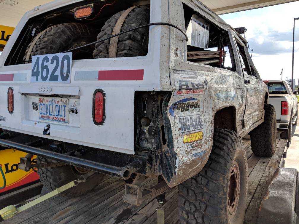

Well we drove 21 hrs to Oklahoma to race in Ultra4 Clash at the cross bar.
We ripped front caliper off during pre- run. Someone found it and returned it to us :)

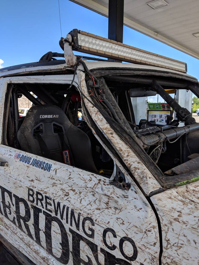

Got everything back together but front suspension control arm bushing we're shot (wish we had time to install the new long arms sitting in my garage)
I was iron Manning this race as my co driver's brother passed so plan was to do best I could and get points. Well we started last as I did not get a chance to qualify (fixing brakes).
Since I was not doing full race speed Everytime I saw someone broke I stopped and helped them. Gave 4 quarts oil, gallon of antifreeze out, serpentine belt, and couple waters.

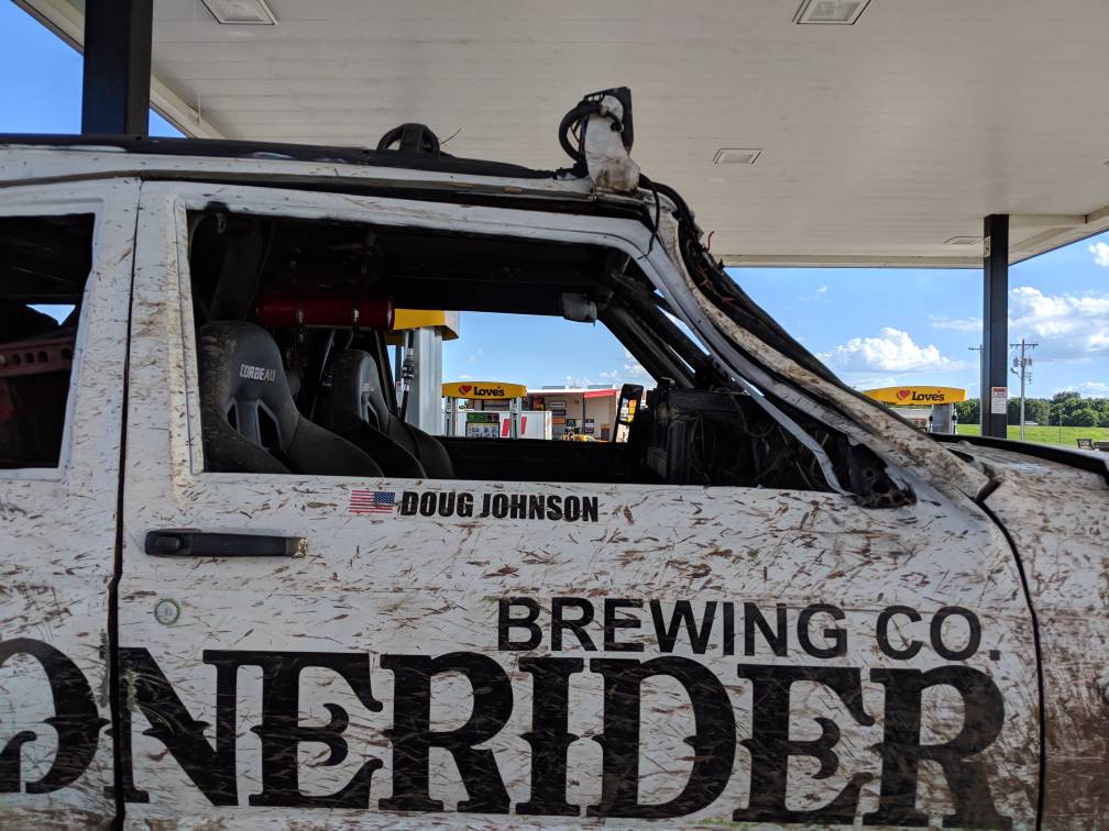

As made it around lap one I missed a turn and then started lap two. In lap two I hit a few trees but by driving into the trees it kept me from ending up on my lid. I can fix metal :)

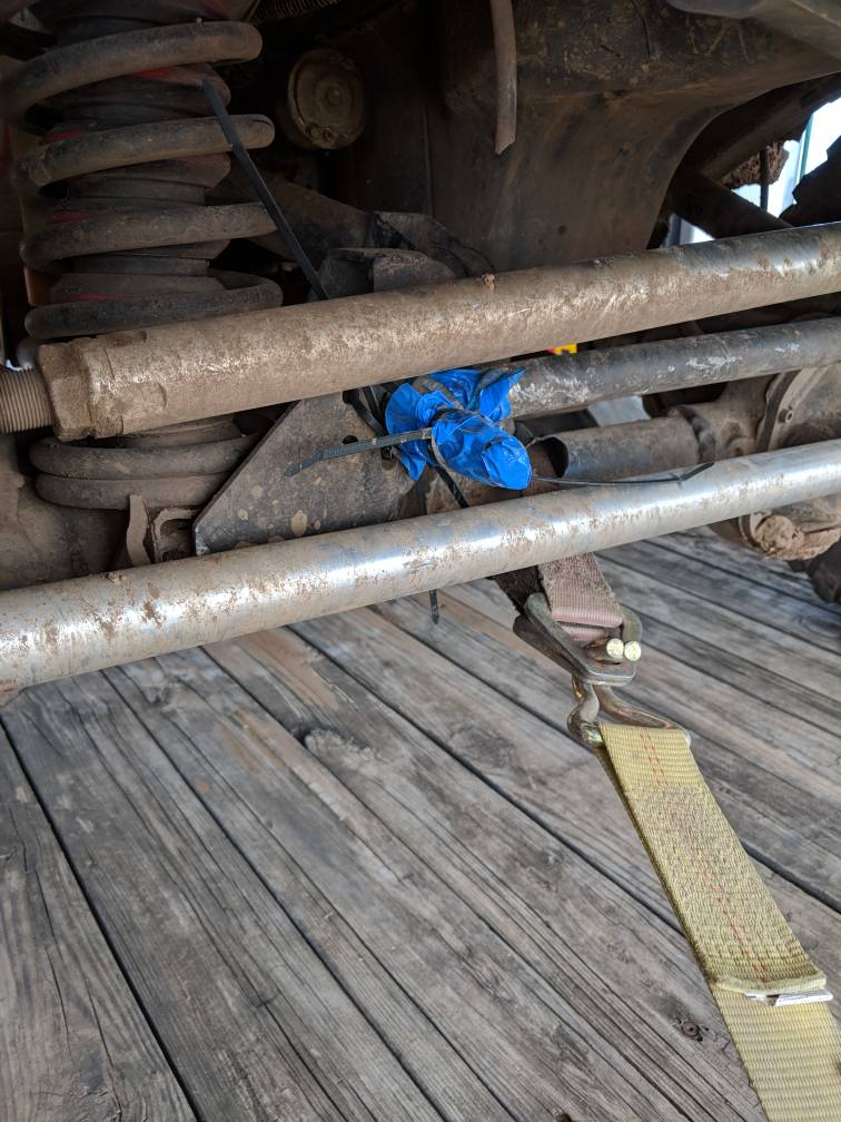

1.8 miles from end of lap track bar bolt went bye bye. So I rigged it up with a screw driver, duct tape and zip ties and it held.
Since we have a 21 hr drive home we headed out. So I don't know where we ended up.

Tack weld the TB bolt next time? Maybe just a spot on the head of the bolt?
Ya I tacked a bunch of other bolts so this one will get it also.
I guess I wasn’t sure with all the rules if that, being a knownweak spot on these platforms, was a no-no. Either way I hope it works out cause this rig is sweet and your ability to go race these courses makes me jealous so I really want to see you bring home a “W”! Safe travels to NC.
