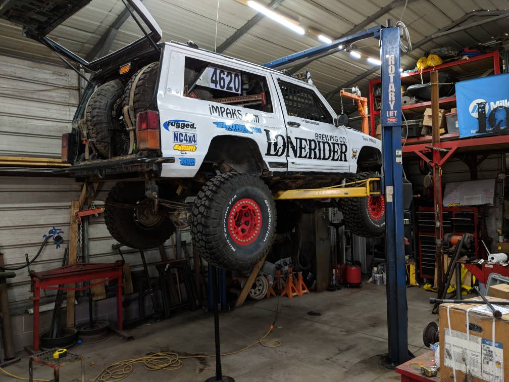

Found rear leaf spring center pin we're toast. Picked up a new set today at 4 wheel parts.
How does that happen? Were the U-bolts not quite tight enough to keep the springs from wiggling on the perches? Or just the stress pulling the nut off of them?
I once had a set of shims that slowly flattened out and allowed them to move around, it buggered up the pins in the process. Learned my lesson about AL shims on that one.
Well what I found was the incorrect u bolts were used by the previous owner and I never thought to check them. He had 3" axle ubolt and the axle is 2.75"
I think that gap allowed movement which lead to then loosing up

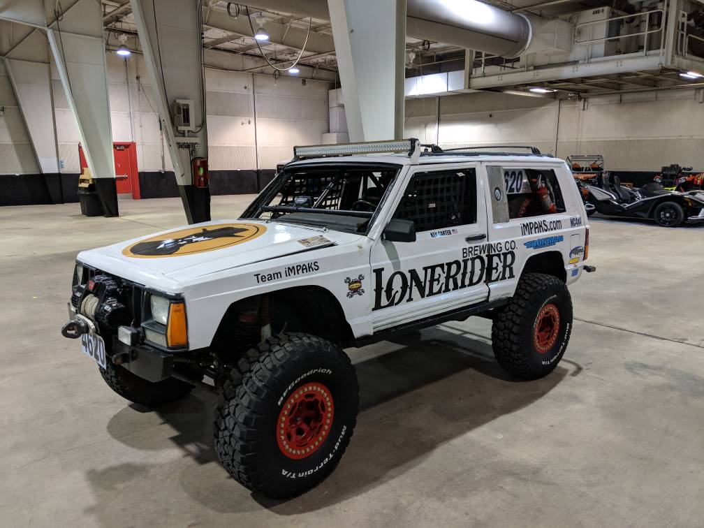

Jeep is setup for show tomorrow in Jim Graham building.
What was it? Based on the 9am-noon schedule, it sounded like a cars and coffee type thing.
It was an indoor car show. 1990 and newer rides.
Lots of lifted trucks and lowered cars.
4wheel part had a booth and so did Super Trucks and a few others.
This was there third show. They do it Sunday after the antique car show.
