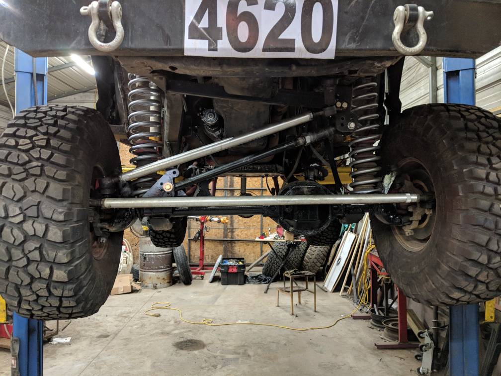

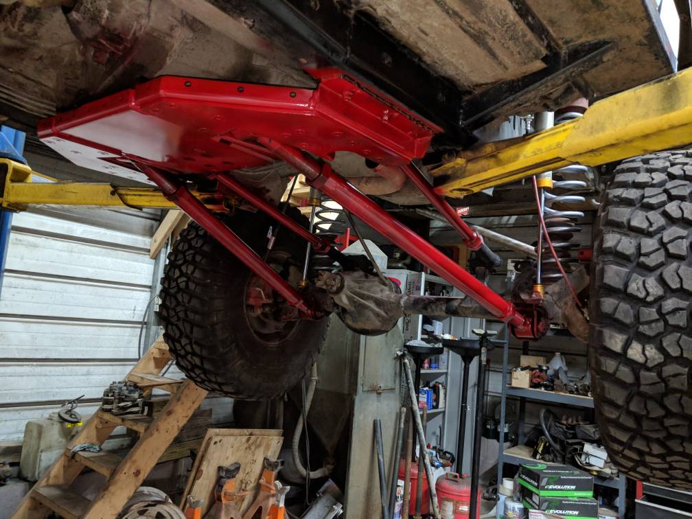

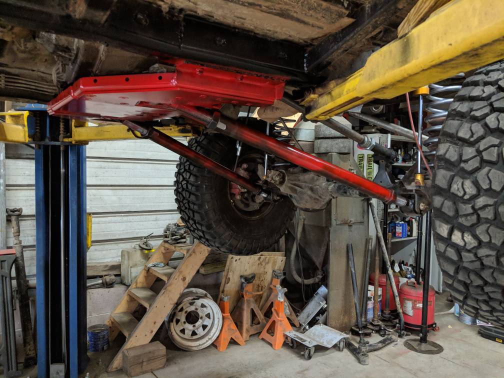

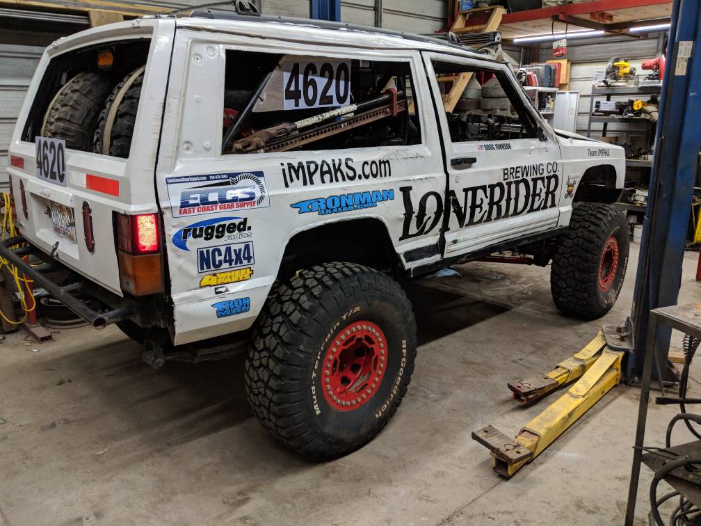

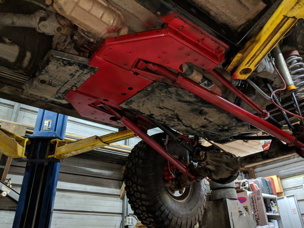

Stock class XJ build.

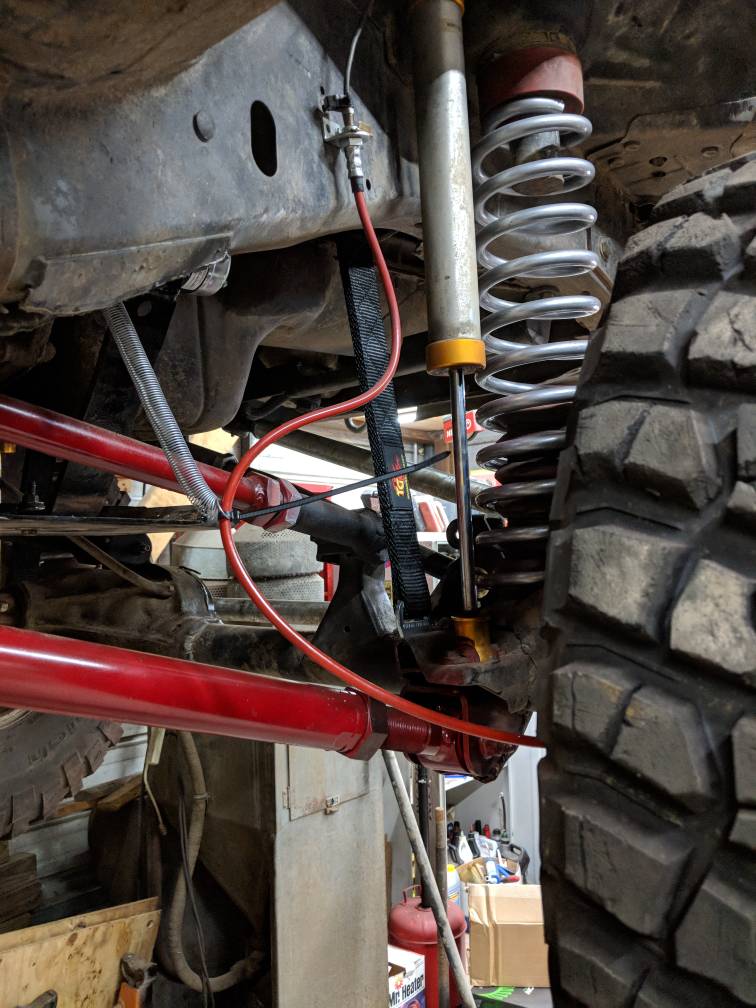

Long arms on but ran out of paint.

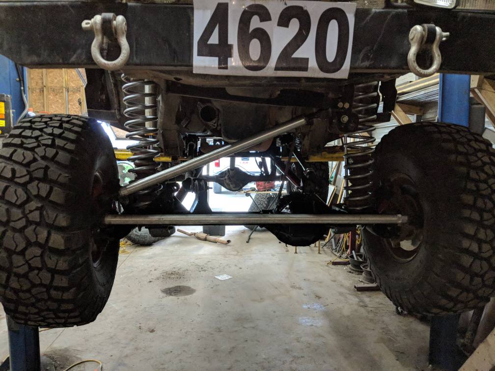

New coils are in. Waiting for track bar and front will be almost done.
What coils did you go with?

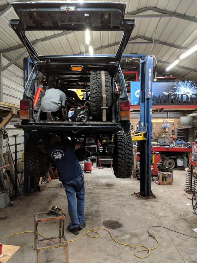

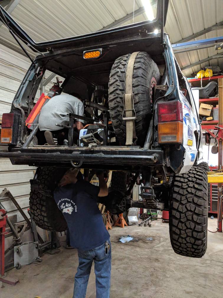

Son helped in the garage tonight. Love working with my kids

Time to pack the tools load the trailer and go racing.

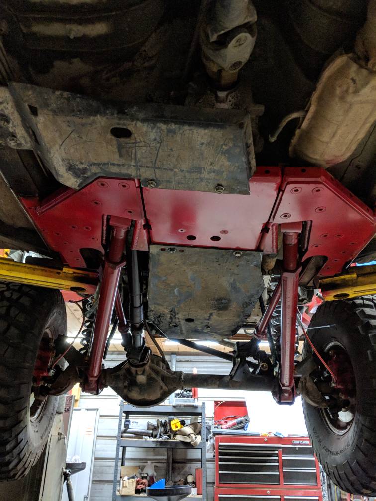

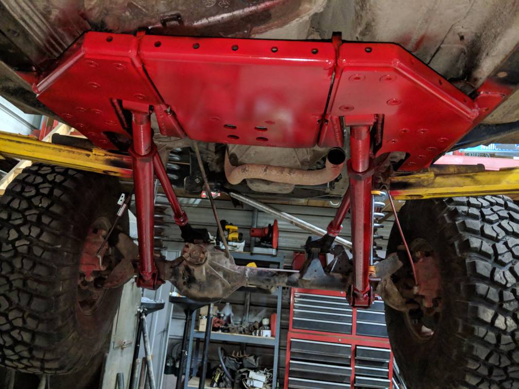

Things changed since last race:

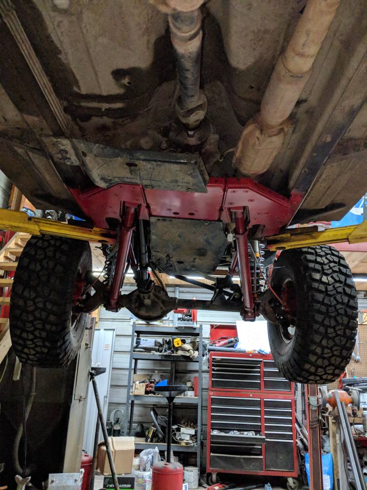

Iron Man 4x4 long arms kit with new crossmember.
Added skid plates to it.
coils.
brake lines.
Limiting straps.
Modified track bar.
Extended driveshaft.
Spark plugs.
Wires.
Dist cap.
Coil.
Starter.
Fixed a pillar.
Fixed LED light bar.
Fixed race helmet wiring.
New trailer tire.
Lots of work but as they say winning starts in the shop.

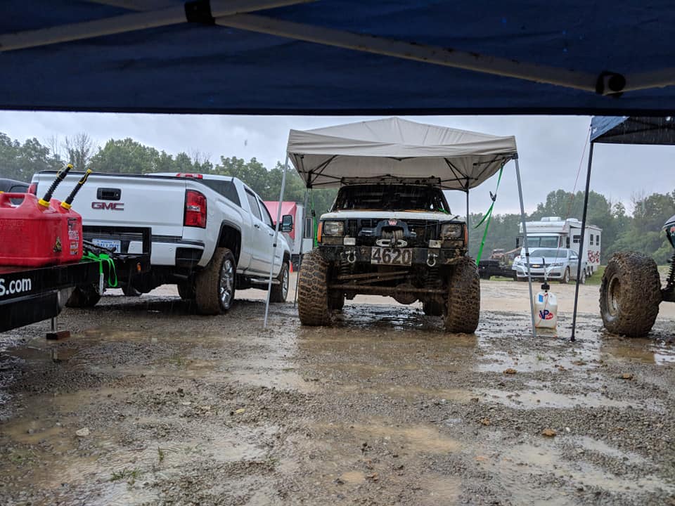

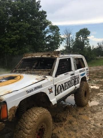

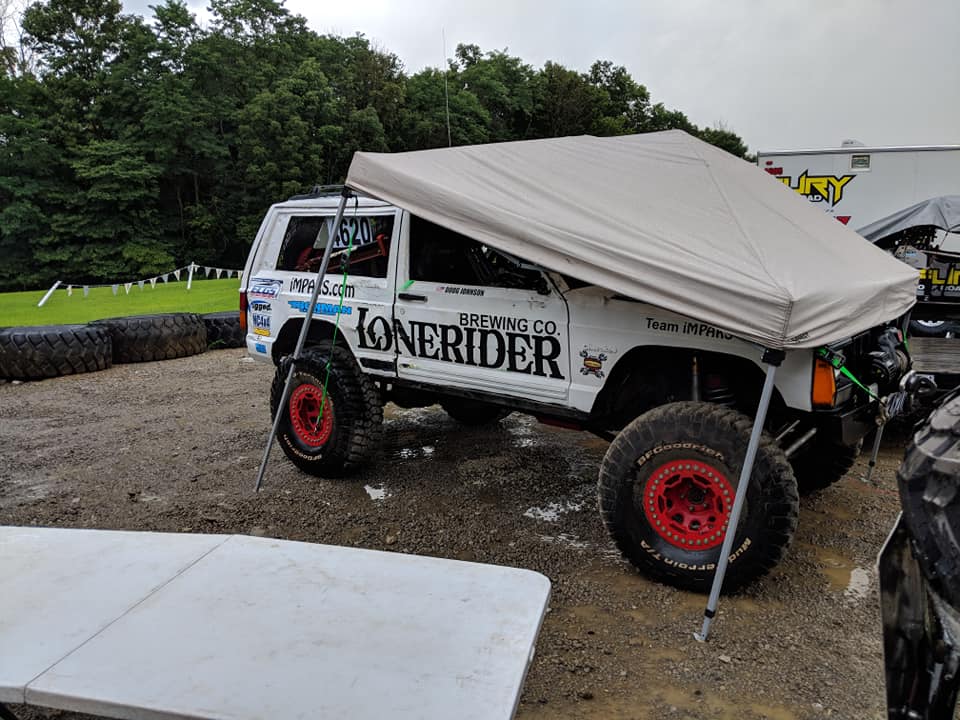

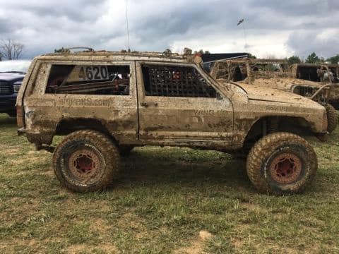

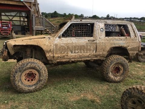

Wow is all I can say about the KMC race in bluegrass. We worked hard to make sure the Cherokee was 100% for this race and it worked great in pre running. The bad part was it rained like crazy and the race course turned to a slippery mess.
The one issue we had was if it stalled we could not restart without waiting a few minutes. We believed it to be the fuel lines getting too hot. So we wrapped them with insulation hoping that would fix the issue.

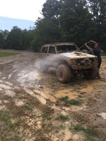

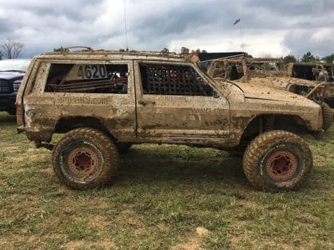

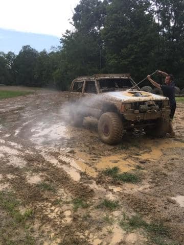

We decided to qualify as we felt good about the jeep, so we did and we found the front engine skid was hitting the front driveshaft. We ended up in 4th 15 seconds from 1st for starting order. So we had a guy power wash the Jeep so we could work on it as it was NASTY
Race day started with us 4th off the line and we decided due to sloppy mess to not run at 100% speed and be conservative for a while. Once the race started we hit the hammer but under control. Within 1 mile we had caught the third place car and passed him and by the time we came to the start/finish line we were in 1st place and held it all the way into the third lap.
But then the dang fuel issue caught up to us and it stalled and we had to sit for 10 minutes for it to cool down. This happened three times which let everyone catch back up to us and we ended up in 4th place. It is hard knowing you had it in the bag and such a small issue lost it.. but we will find the issue and fix it for next time.
We had a blast and the Cherokee is almost at 100% and once it is we will be a force to be reckoned with.
Thanks to our families for letting us go after our dreams.
And a huge thank you to our sponsors. Without you all this would not be possible.
LoneRider Brewery, IronMan4x4Fab, Rustys Offroad and Rugged Radios

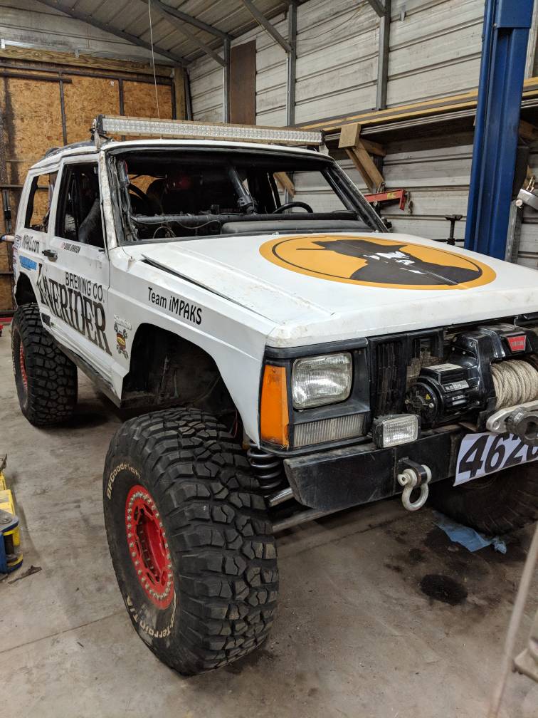

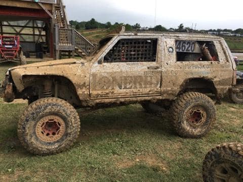

after qualifying
after the race

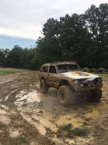

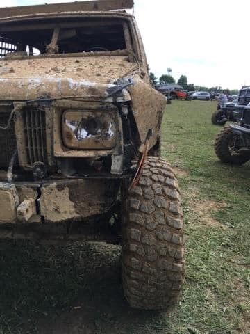

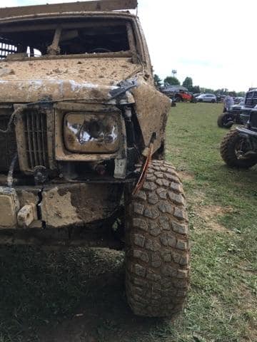

oops we hit a tree

I also need to put in a new radiator as it cracked when I hit a tree and then change out location or air intake filter also..
