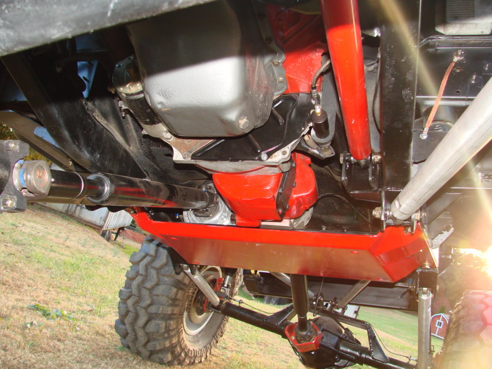

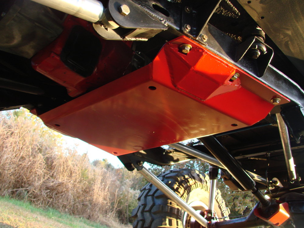

I guess today was one for my record book. I worked 19 straight hours on the jeep except for a quick lunch and dinner. Hopefully there won't be anymore days like this one.
-Front seat belts completely finished
-front upper control arm shortened slightly to correct caster
-rock lights are mounted and wired completely
-skid plate fab work completed (needs painted and installed)
-Hi lift jack is painted and mounted
-tightened all control arms completely
I'm sure I did more but I'm just to tired to think.
